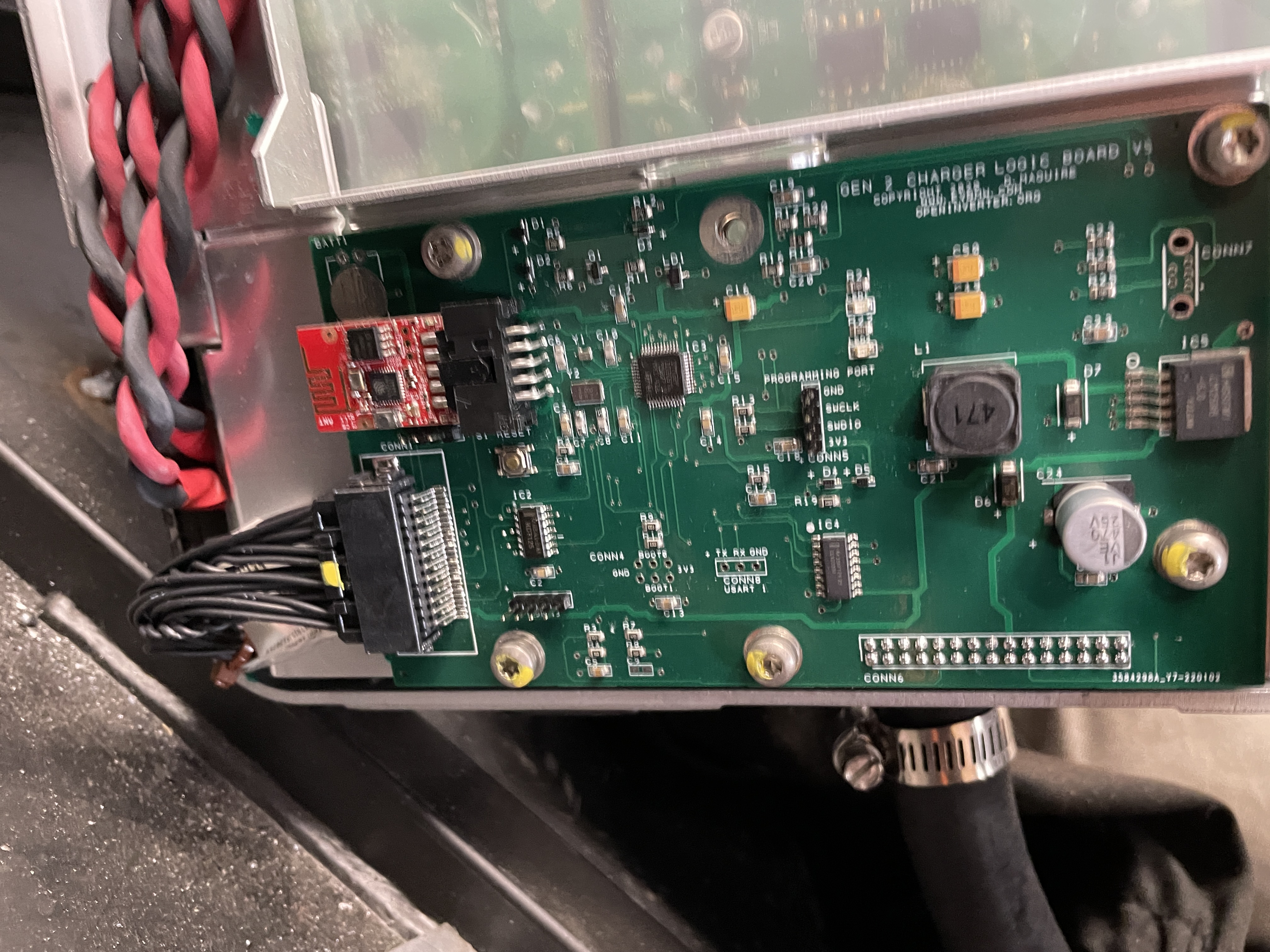

UPDATE
Worked on the HVJB for the Tesla drive unit as well as got the charger logic board working. I sadly need to add a few parts to I had to pull it after I took that picture. I'm also building the negative HJVB (since I am using 3 separate parallel strings. This means that I need to move away from the Orion BMS and instead will be using ZEVA BMS24 as well as some custom firmware that I will have to write up to support 3 parallel strings since that is not incorporated.
I sent the CV half shafts out to get a custom hybrid. This saves me a bunch of money since a set of custom full axles would set me back $2K from the driveshaft shop. Dutchman Axles should be about $1K all said and done (including the axle stubs).
I also swapped the IVT-S for Sendyne SFP200 current sensors since I was able to get a good deal on them. Because of this, I am selling my IVT-S.

UPDATE
I got a VIN! Luckily the CHP didn't care much for body panels and just riveted on the VIN no problem.
I've been really quite since I'm diving really deep into embedded systems coding. I decided to redo the BMS system and instead leveraging chevy volt gen 1 BMS modules (since the CAN network is completely reversed engineered). I bought most of the LTC6802-2 ICs on eBay and lets just say that although most of them worked have some had some pretty wack mem register values when reading cell voltages this reliably issue caused me to swap. I have 3 months before college starts so realistically I don't think I can finish with how much more I have to learn in the coding department. I'm now using a TMS570 MCU with 4 CAN peripherals. Its a really cool chip that has dedicated ECC memory for each CAN message box as well as super robust watchdog/hardware level clock protection. CCS and HALcogen is still super confusing to me so don't expect any sort of serious leap forwards anytime soon haha.
