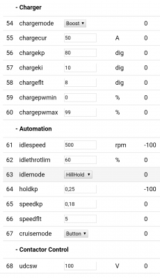

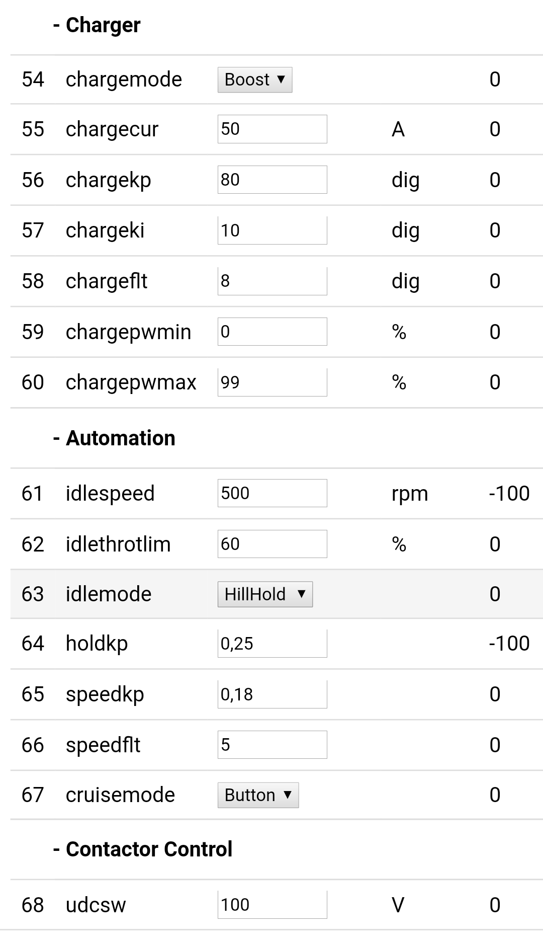

Worked on hill hold a bit and I think I can release it now. I took away the possibility to stop forward motion as that is awkward to use and introduces some additional issues.
So to enable it set "idlemode" to "HillHold" and configure a sane value for idlethrotlim. I use 60%. holdkp can be tuned between rolling distance and oscillation. The high, the less the car rolls back but the unquieter operation becomes to to amplified sensor noise.
