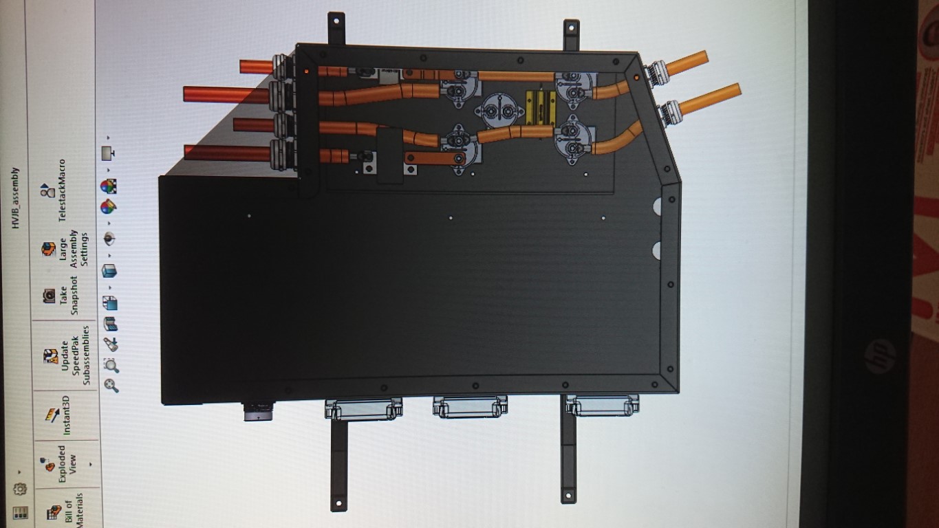

HVJB / Electric:
Maybe a little prematurely (some layout mods being discussed in previous posts :) ), but I've been looking at a neat way to house the TM3 PCS, the VCU and controllers, and contactors etc in the engine bay. With no batteries being mounted in the engine bay, this leaves a lot of space above the motor. I have a rough idea where things like the steering pump and brake vacuum pump and accumulator are going so time to get things mounted.
Originally I had planned for the battery and precharge contactors, as well as the CCS charge contactors to be housed here, but after some suggestions on better layout, I'll see what I can move to the battery boxes and this will free up space for the BMS possibly. The VCU, PCS controller and LIM will mount on the outside edge of the enclosure near to the RRV engine electrical box
Played around with a number of layouts. Plan is for the CCS combo charge port to mount at the front, somewhere behind the front grill. Was a tight fit where the original fuel filler would have been, and makes it tidier to have everything close in the engine bay anyway

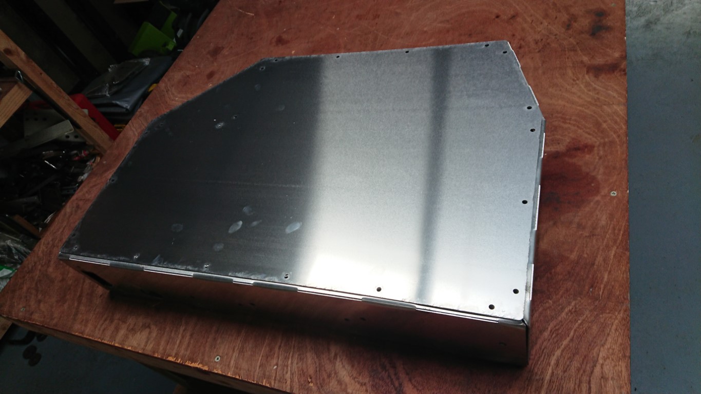

HVJB / Electric:
Drew up an enclosure to be laser cut in aluminium. I didn't have a way to fold properly, so I stitched the fold lines to allow it to be folded by hand and these would have to be welded later on. Was looking for a clean design (to bug anyone looking for the V8 later on :twisted: ) but wanted to steer away from just rectangular. This added complexity to the flat pattern and folding etc, but as its one piece and hand folded it worked out. I have a single aluminium lid for now but could consider smoked perspex later, depending on what might be worth seeing inside
Some test fitting. HV battery cables through the rear as well as the feed out to the inverter. CCS charging HV cables in through the front. Reusing the TM3 connectors for 12V, auxiliary, AC charging, cooling, etc so essentially remaking a Tesla Model 3 penthouse!
Electrical components will mount on a removable backplate. M6 rivnuts used to give threaded mounts for the lid and controllers. Not good for the IP rating but thinking about what to do for that
Welded up

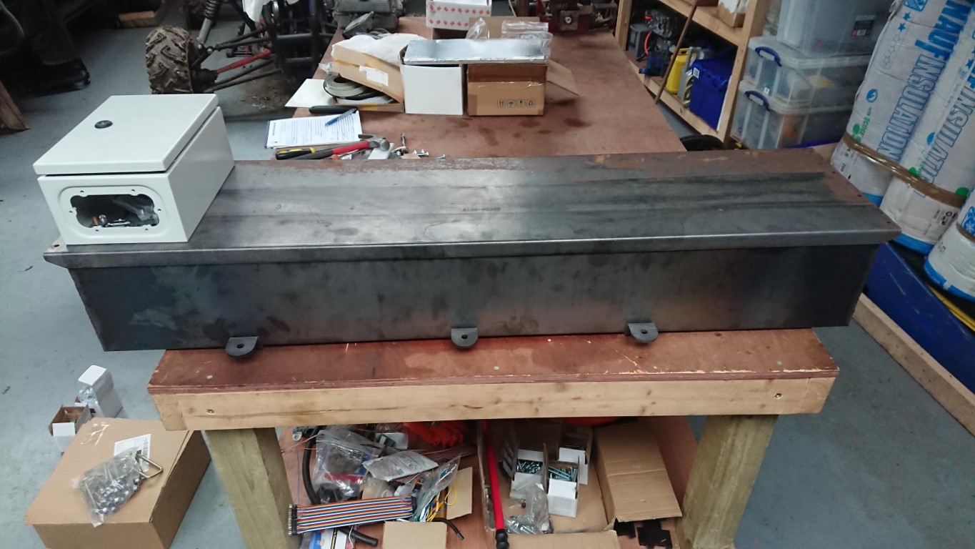

Battery Boxes:
The battery boxes are designed to accommodate the stubs for the battery module terminal connections as the space available for the batteries meant the overall length was restricted. This will allow me to work with the contactors etc on top of the battery boxes and this fits in the space where the fuel tank would have been
The idea was to let the stubs protrude up through the lid of the battery boxes, along with the mid pack terminal connection point and possibly the BMS harness
Looks like a standard enclosure could work well for this, and provides a back-plate for the contactors and fuses and leaves an easily serviceable access point rather than having to remove the battery box lid if needed
Trying out a few component layouts between the HVJB and the battery box junction boxes to find the simplest layout

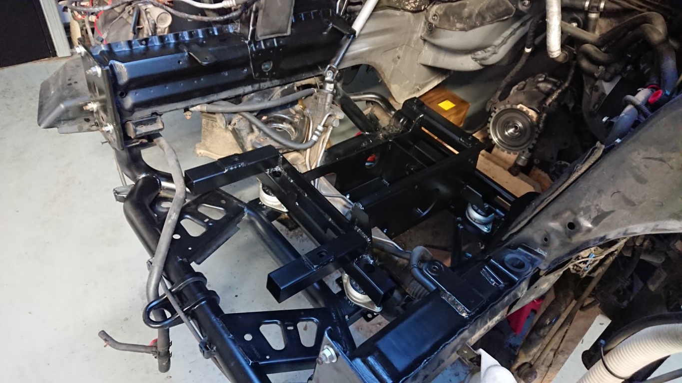

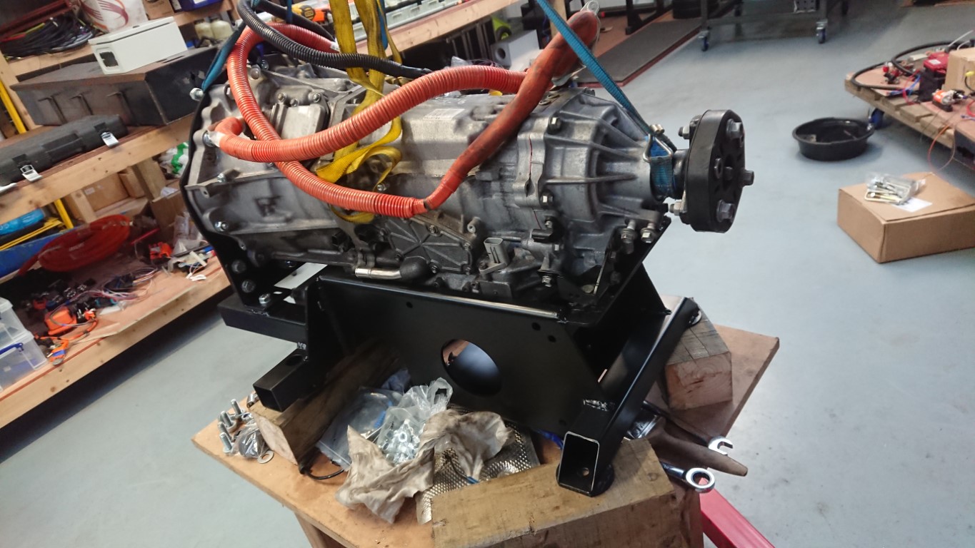

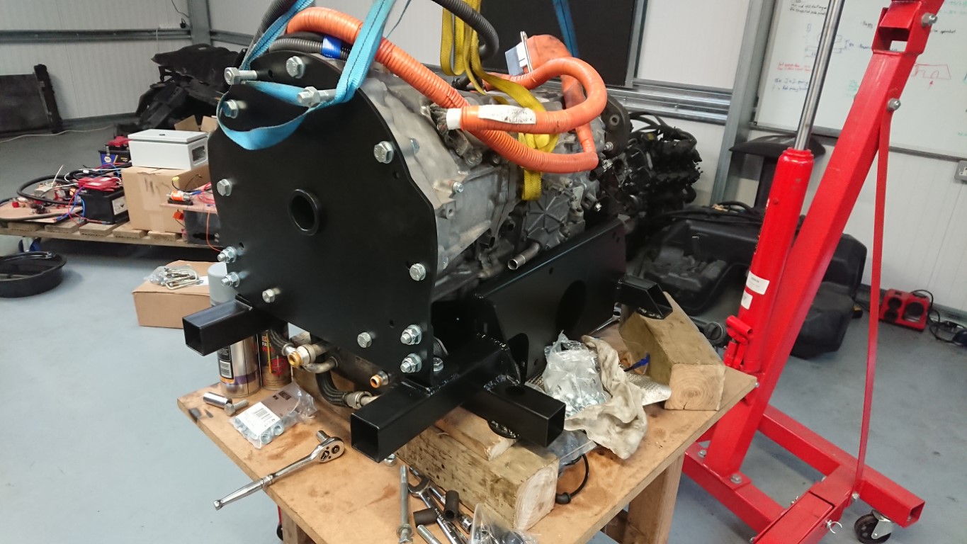

Mechanical:
Must be getting confident there won't be any more chopping and changing, the paint cans are out! :o
Parts for mounting the inverter and front axle tube
Anti-vibration mounts for the HVJB frame
Final test fit for the transmission and differential mounting frame to locate the anti-vibration mounts for the transmission
Test fit for the HVJB frame before building up the HVJB
