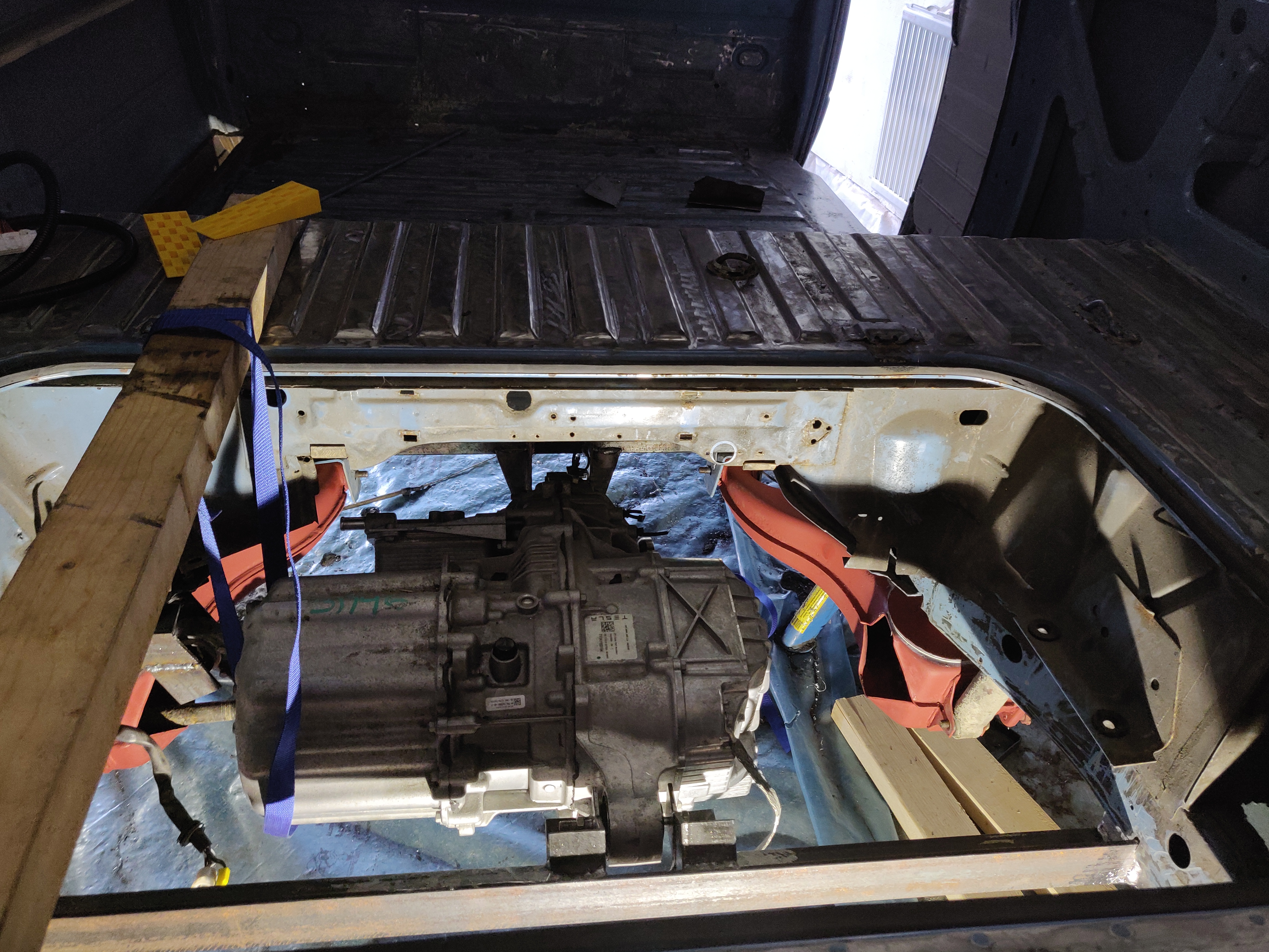

Hi! It seems like we are a couple of people converting type-3 VW busses now :). I don't know If I have progressed longer on my build but I will try to be helpfull if you wonder something. I'm not the smartest guy though and have done a lot of trial and error with the mechanical/construction stuff. I don't have a fancy CAD model of the car for example haha.
I think, when I have been looking on photos, that the screw through the third mount should be horizontal. The problem is that you don't have a lot of straight places to measure from on the car itself.

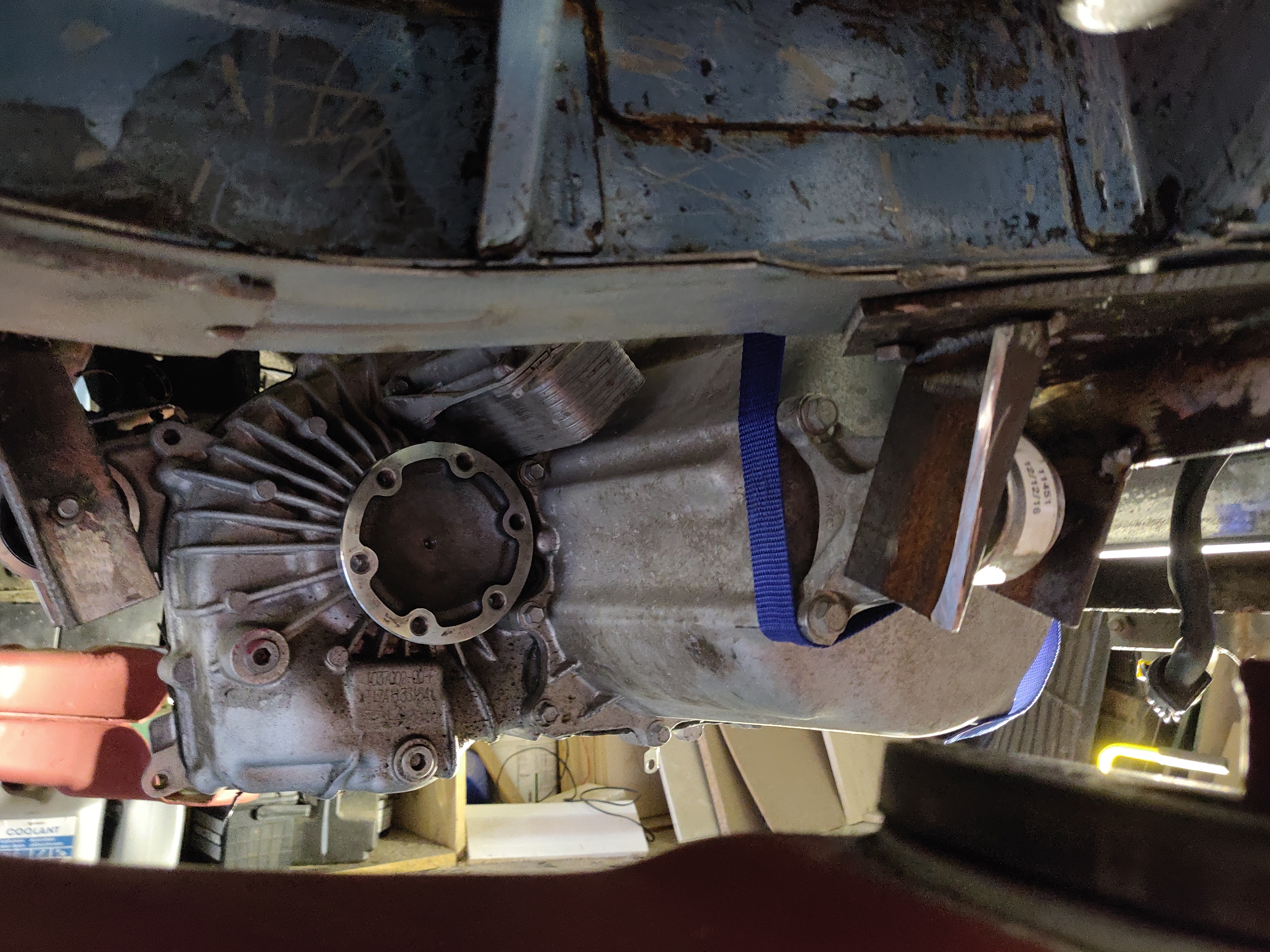

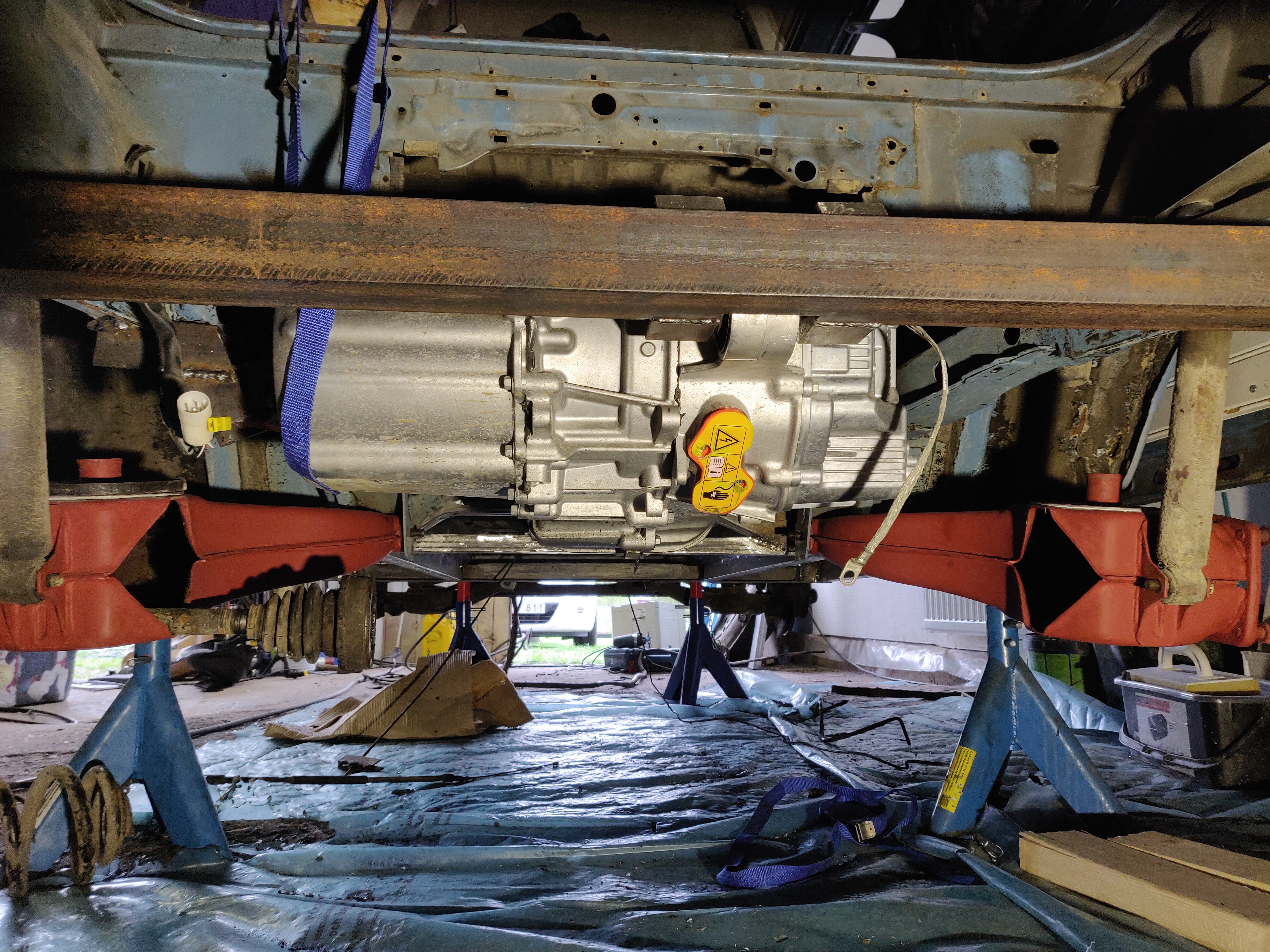

Mounting almost done. I've used 6 and 5 mm steel because that's what I have lots of. It's easy to weld as well.
Next step is the find a pair of driveshafts that fit. They need to be a bit longer then the original ones. It would also be a plus if they had different fittings. Because now I have 100mm on the hub side and 108mm on the transmission side.

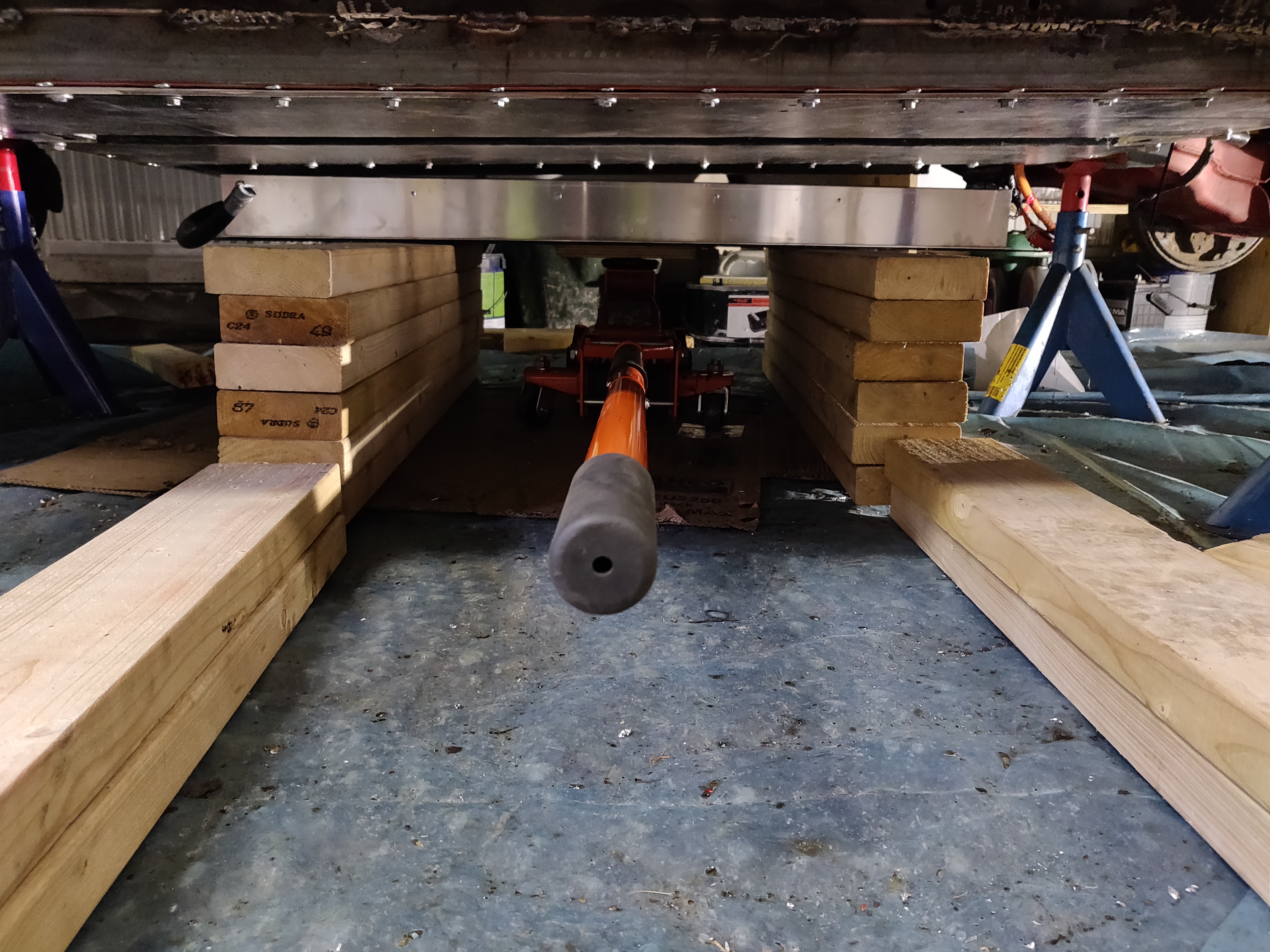

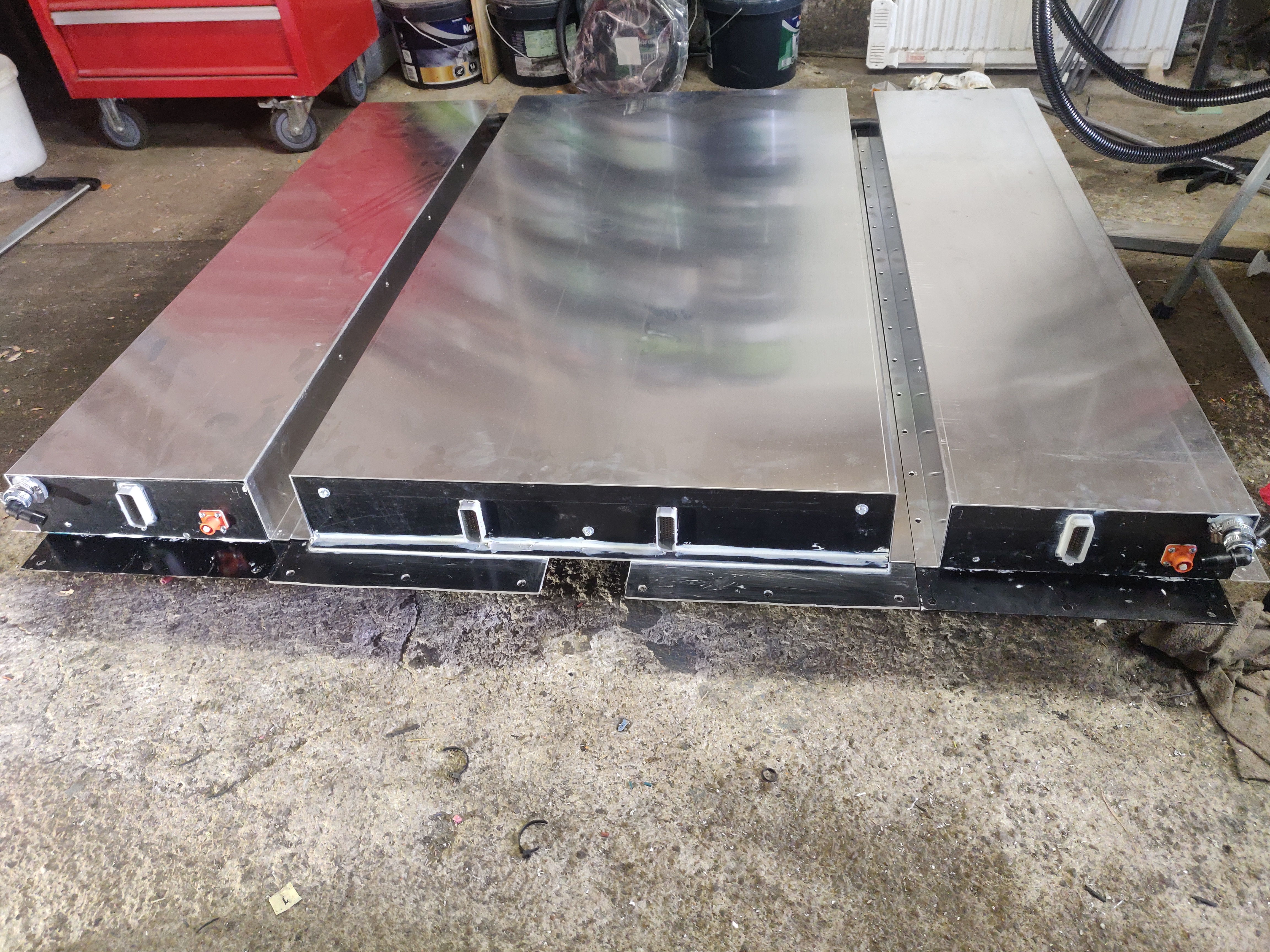

It has been a while since my last update here but the project is still going forward, though slowly. I kind of hit a milestone today with running the motor in the car with driveshafts connected, oil in it, coolant flowing and at full battery voltage. I have also connected the BMS (Orion BMS 2) to the batteries and succesfully charged them. The battery boxes are also almost done and mounted for the first time under the car.
Mounting the battery boxes wasn't really just bolting them to the car. I had to adjust some things and it's still very tight.

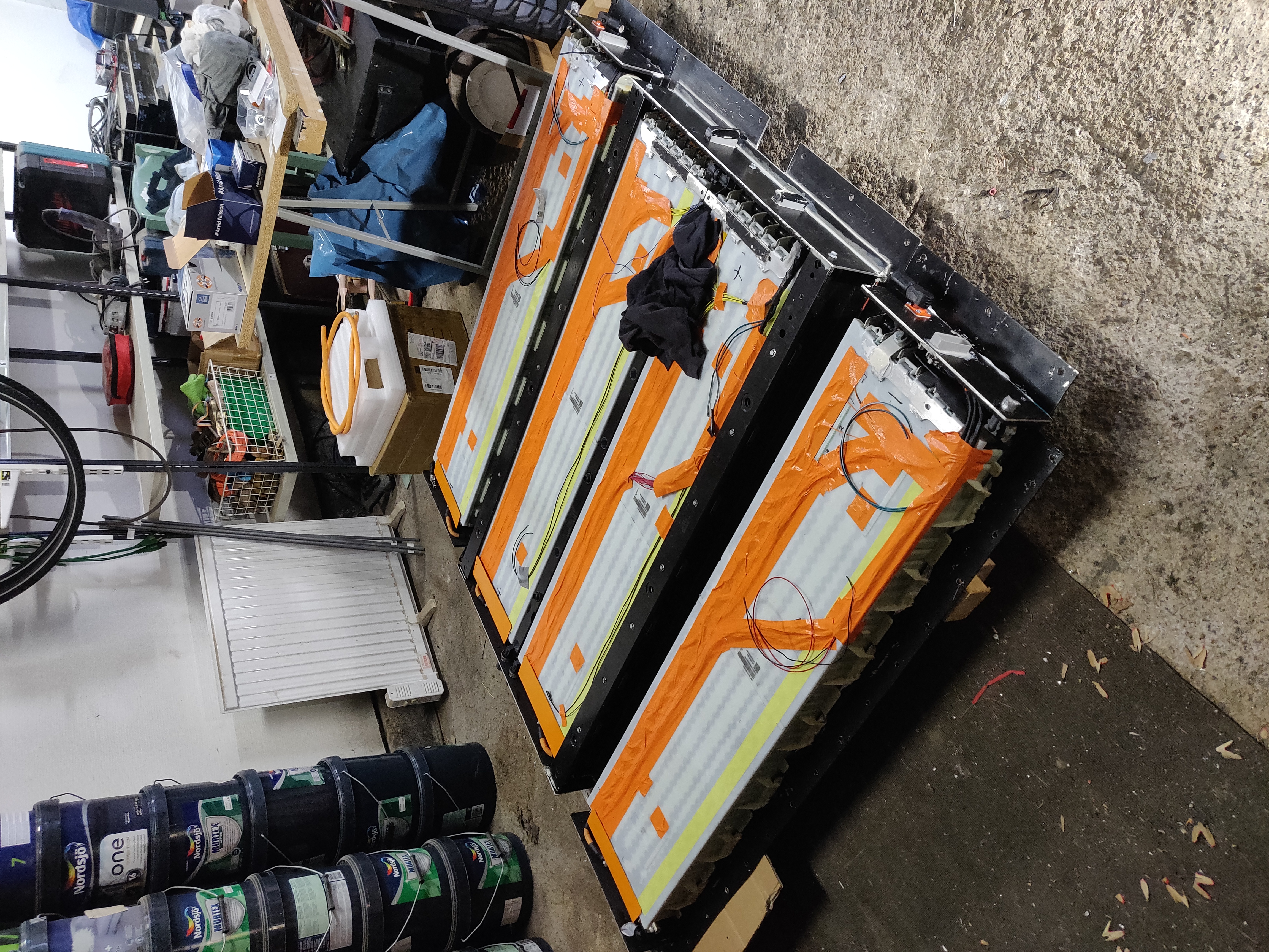

There are 3 boxes. One large in the middle holding 2 modules and two smaller ones one the sides. The middle box is a part from the original Model 3 battery pack and the two smaller ones I had to make myself.
I got a company to make the covers going on top of the batteries. They are made of 2mm aluminium.

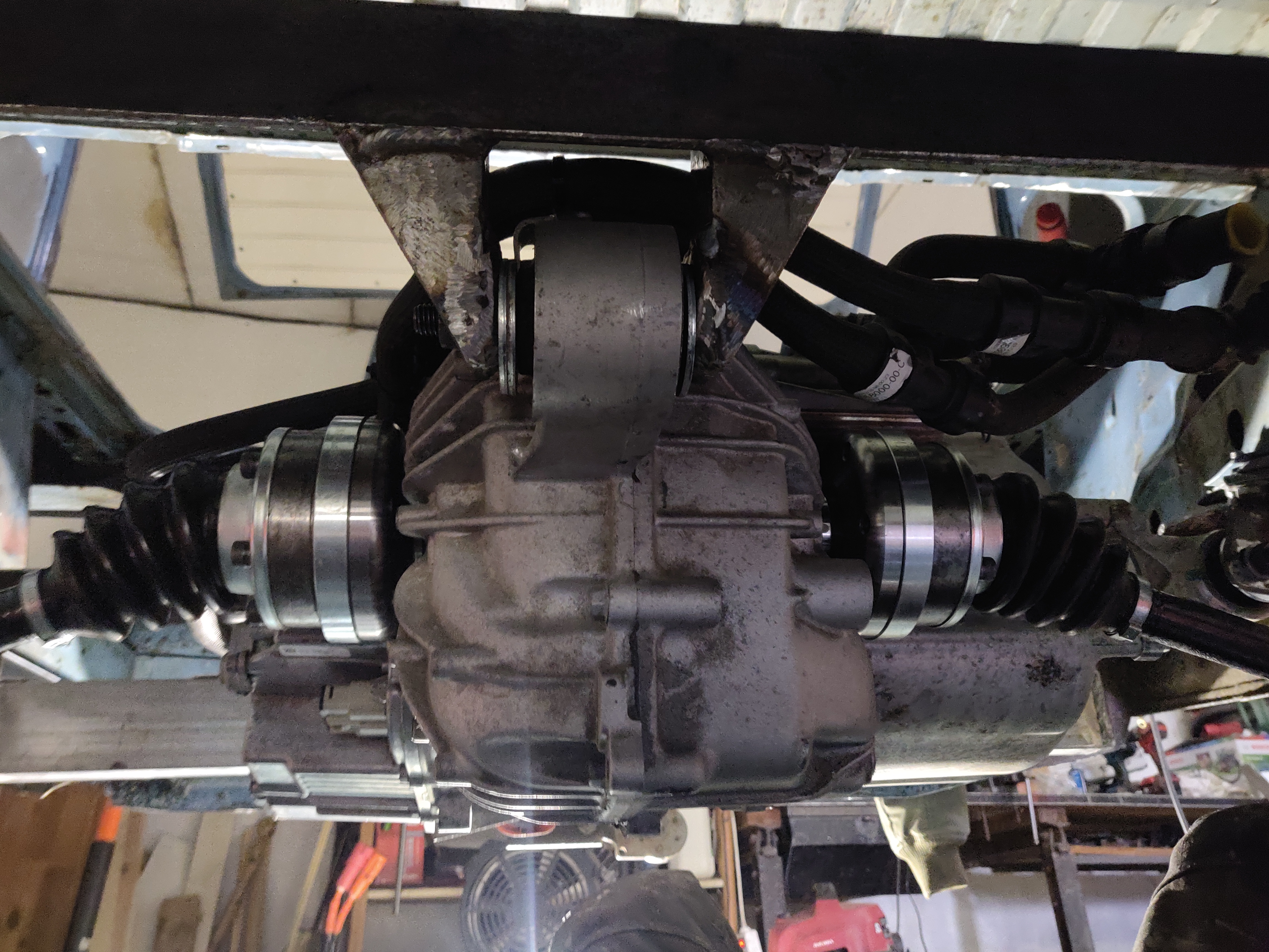

I got specially made adapters from a company called EPYTEC. So I could connect my old driveshafts to the motor.

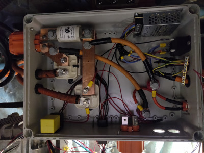

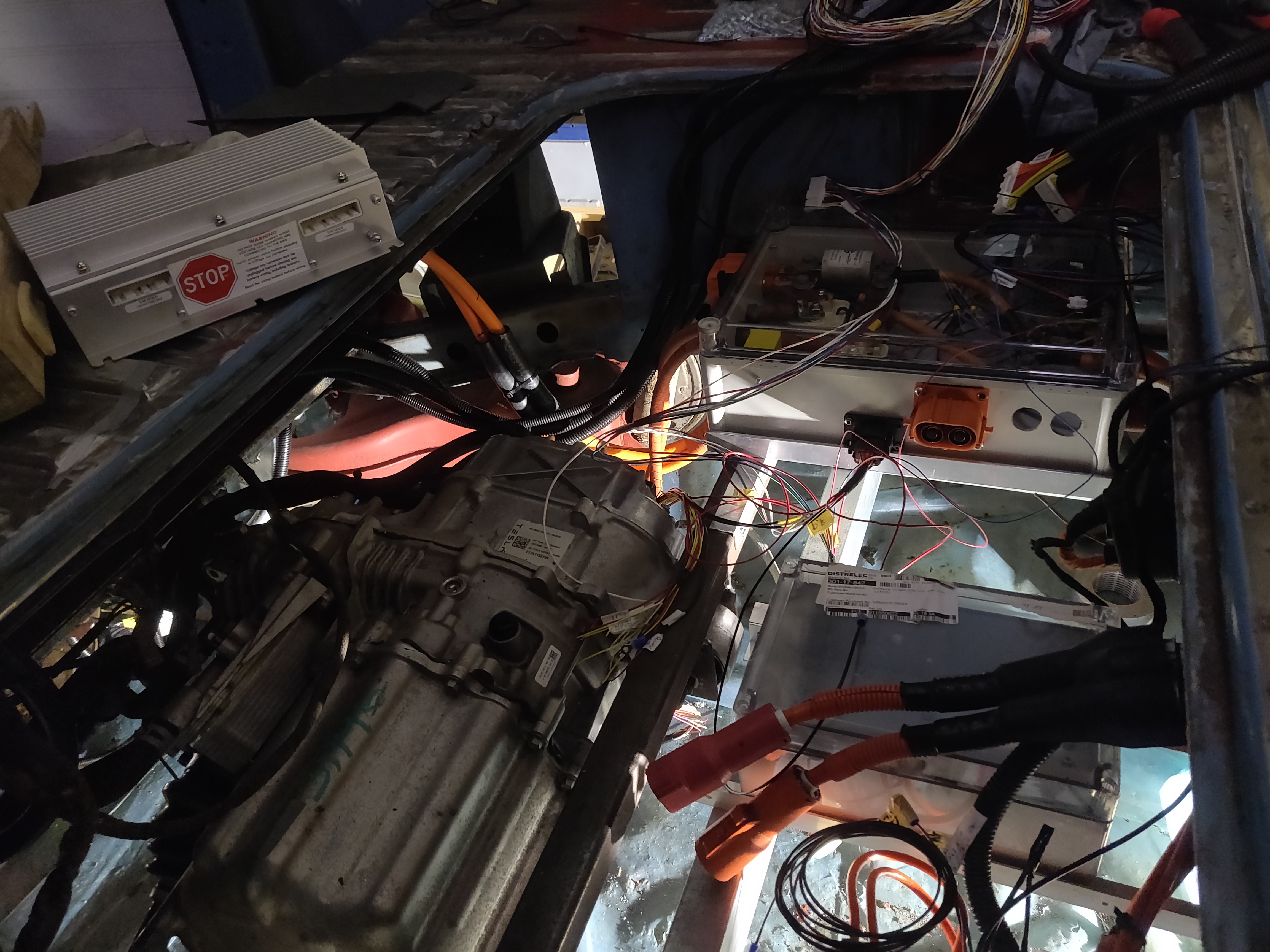

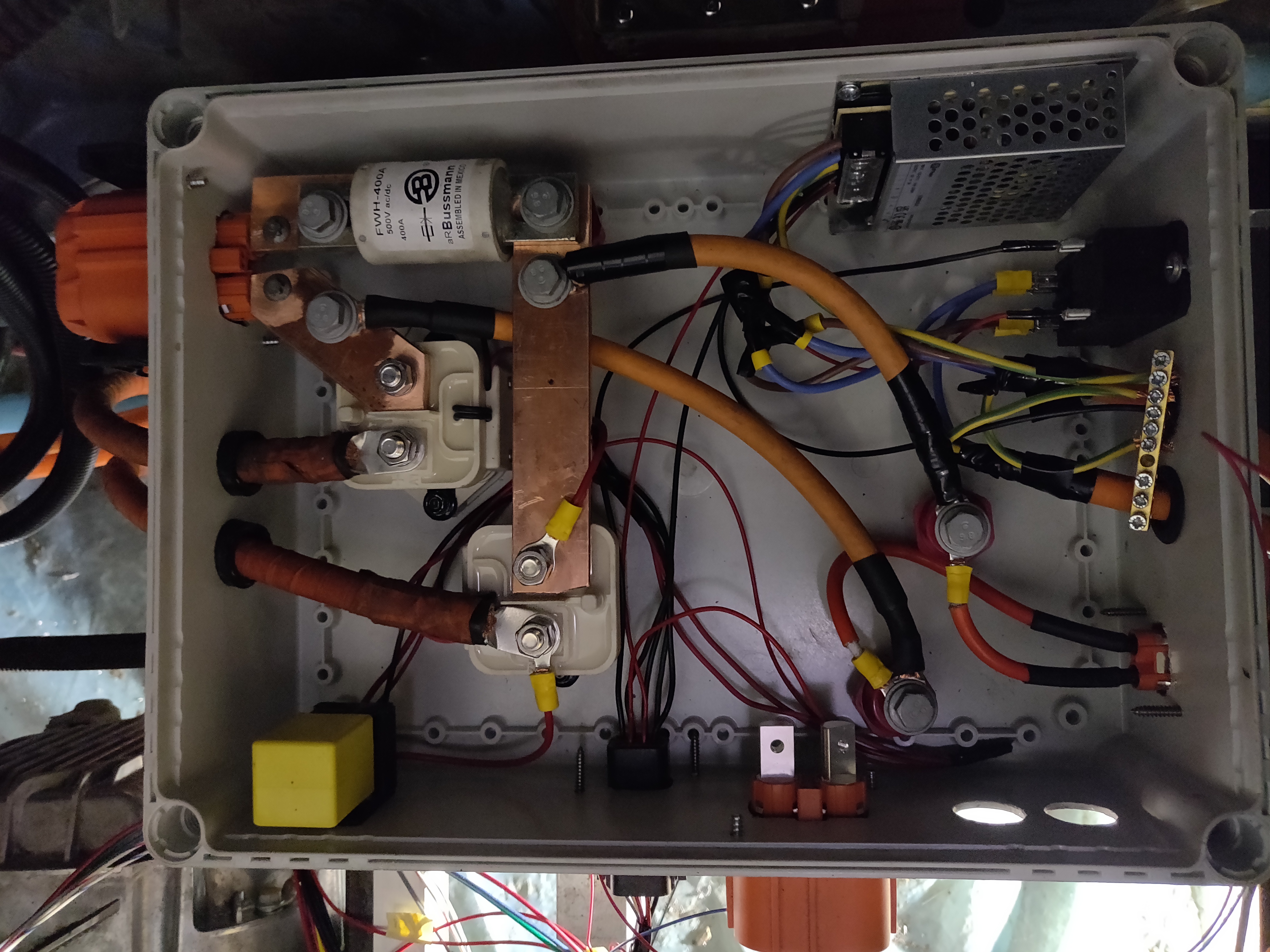

HVJB plus charging almost done. I'm later going to add contactors for the fast charging.
Lots of cables coming together.

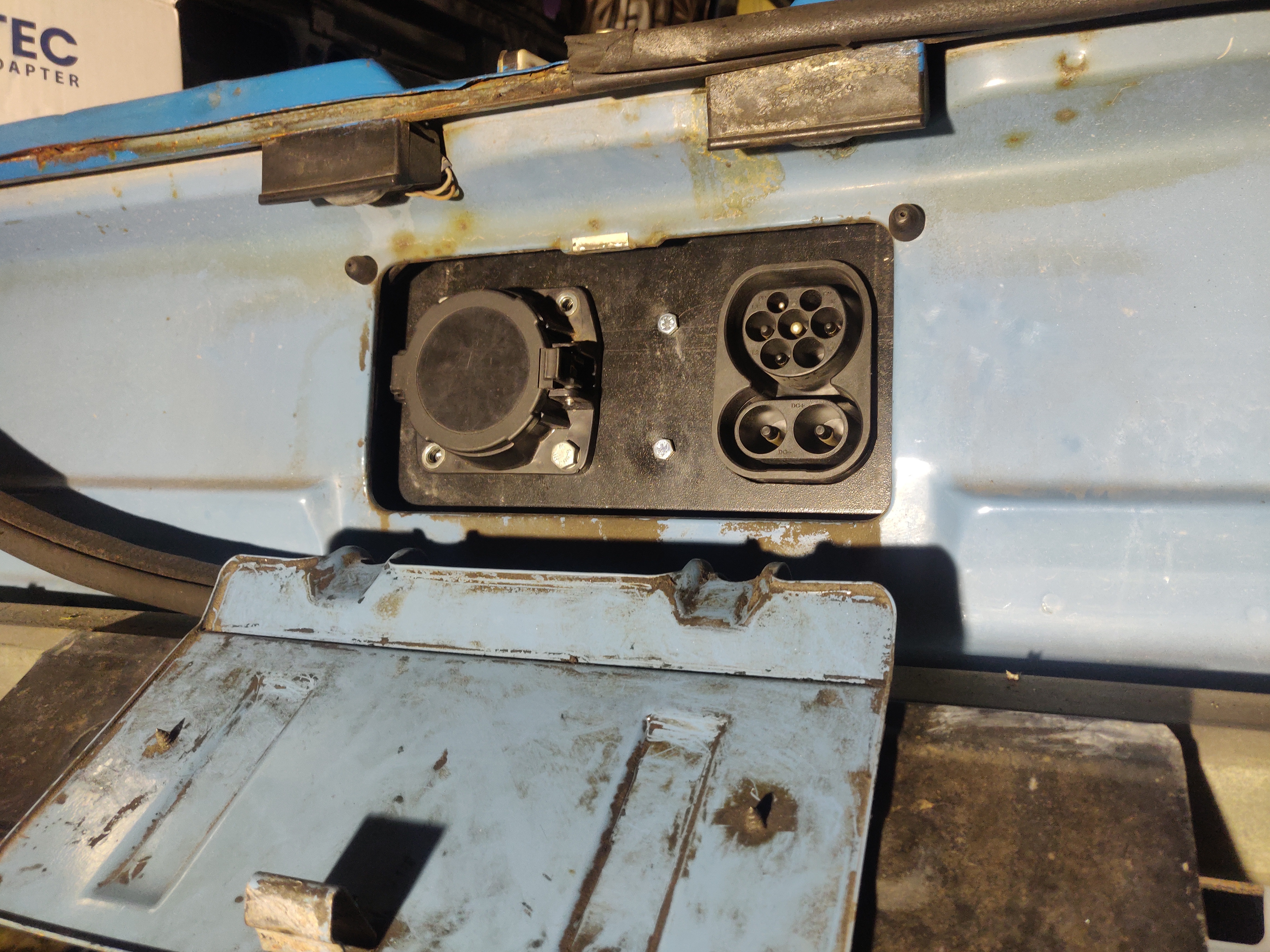

I put the charging inlets behind the registration sign where you before could check oil and coolant. I think it turned out really well.

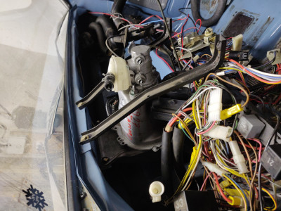

I also mounted an iBooster brake booster from an Honda Accord. I haven't wired it up yet.

The bad:

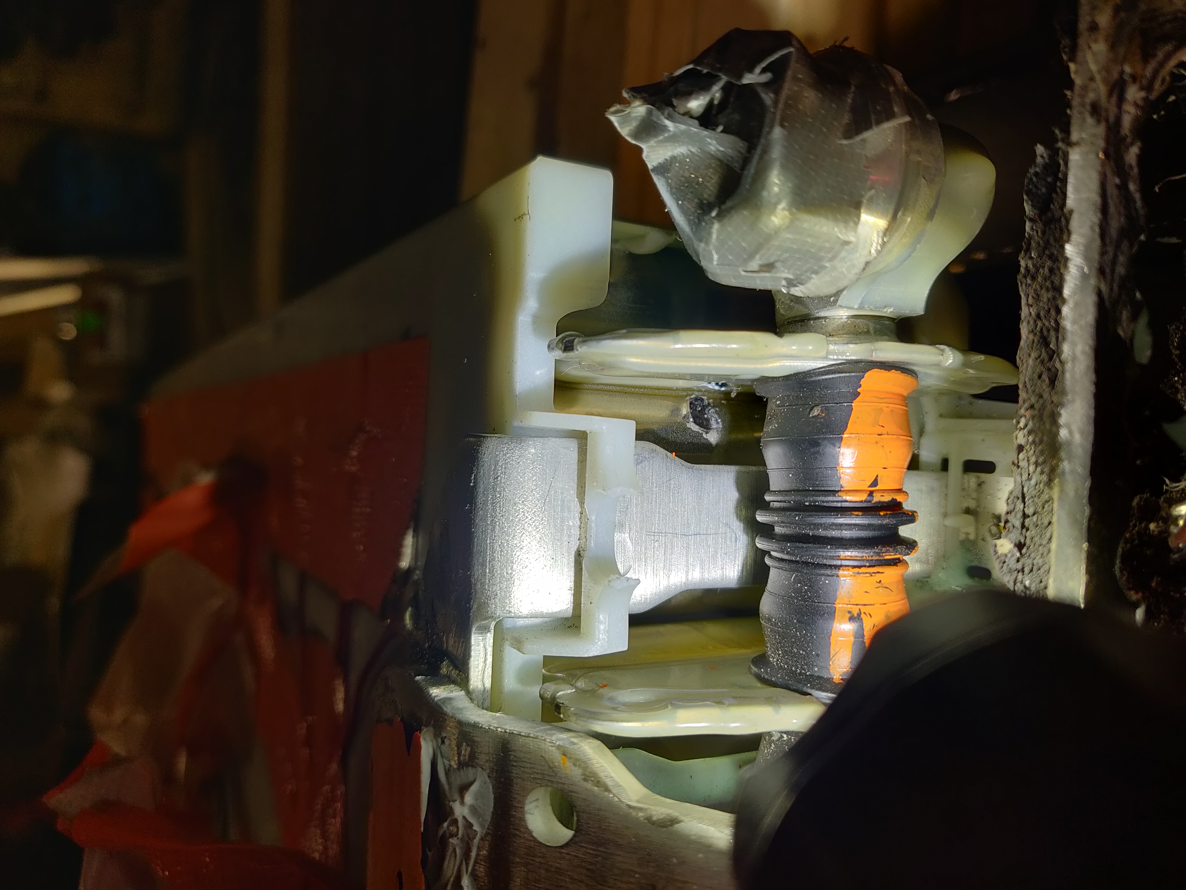

I accedentially managed to puncture a cell in one of the battery modules when I was redoing the boxes a bit. :(
It smoked for a second but then nothing more happend. I instanly disconnected the punctured cell from the rest of the module, by removing the small wires on the underside. I then tried to take the cell out of the module but soon relized that it was almost impossible without destroing the other cells aroung it. The next day I discharged the punctured cell very slowly with a small resistor. Nothing happend to the rest of the module but I'm not sure if I want to have it in my car... So I have ordered a new battery pack as my brother also was interested in some modules.
