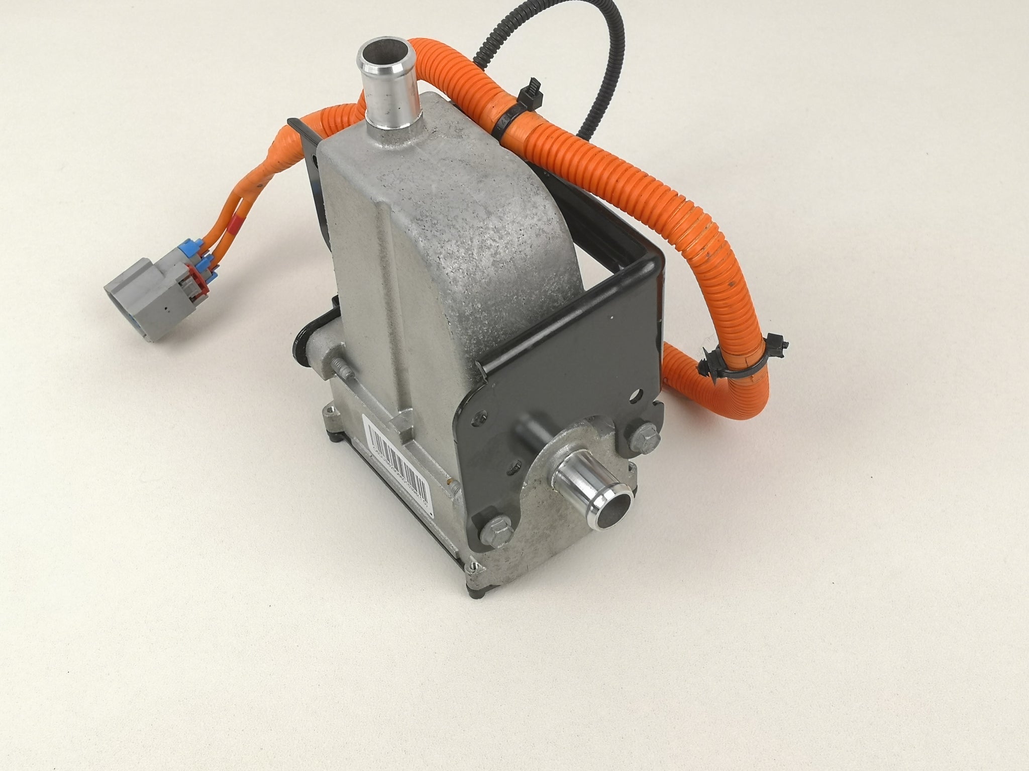

I have an option to cheaply get one Tesla electric coolant heater.
Unit P/N is 102868900 or 103890100.
Anyone has any data on how to operate it? Is it CAN bus operated or maybe SW bus?
If i am really lucky it would be PWM operated :).
tnx

Yes it seems this Tesla heater is a dumb module. The PWM i was reading about applies to HV sourced from the HV control box where IGBT transistors and its drivers are located.
I dont think it would be wise to switch 5kW heater directly with 15A HV relay. Its max power seems awfully borderline and i dont want to have any issue from the heater. I may skip it for now and instead use two Volt battery heaters in tandem. That would be 1500W of heating power. Much more managable and similar to a kettle heater :). Also each heater comes with its own thermistor which i can use to sense 55°C and stop it there.

You can use one from VW, it's controlled via LIN. The signals are known!

ebay 3Q0963231E starting at 140€, i bought mine for 45€
Posts: 3577
Has thanked: 134 times
Been thanked: 342 times
Re: Tesla coolant heater
muehlpower wrote: Mon Jan 24, 2022 10:38 am ebay 3Q0963231E starting at 140€, i bought mine for 45€
OK, what kind of control? LIN or CAN?
Any data on HV and LV connectors?
On photos it looks rather large. I am not sure if i can fit it in...
