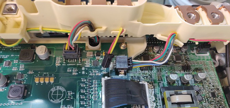

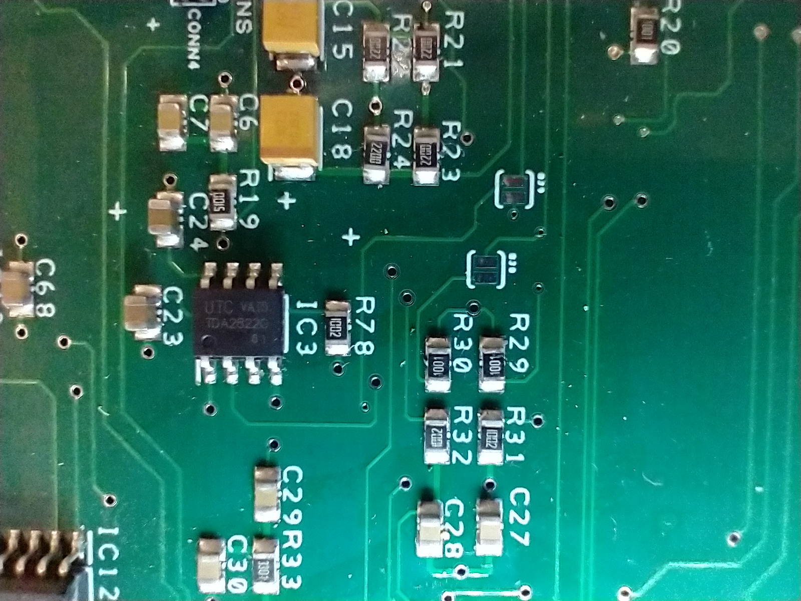

So maybe I have another incorrect component. I took a picture and was comparing components to the BOM and I noticed R21 wasn't a match. According to the BOM it is supposed to be 10 ohms. I haven't found it on the schematic yet. The resisters in question are near the top of the attached photo where there is glare.

Thanks for your post and insight. I will try adjusting the set-point later today when I get time to work on it. Currently it is at 85C. The inverter is room temperature. There is no heat in it at all.
My real questions are:
1. what is causing the fault?
2. is my board populated correctly? There seems to be a discrepancy between my board and the BOM.

Make sure you have the right sensor type selected. Set snshs to semikron for the Prius gen 3. Choosing the wrong sensor will give you wonky values.jwr813472 wrote: ↑Tue Nov 23, 2021 1:56 pm Christian

My advice is to get the heat sink temperature faults resolved first before going down the faulty/wrong parts rabbit hole. Trust me. I’ve gone down that rabbit hole

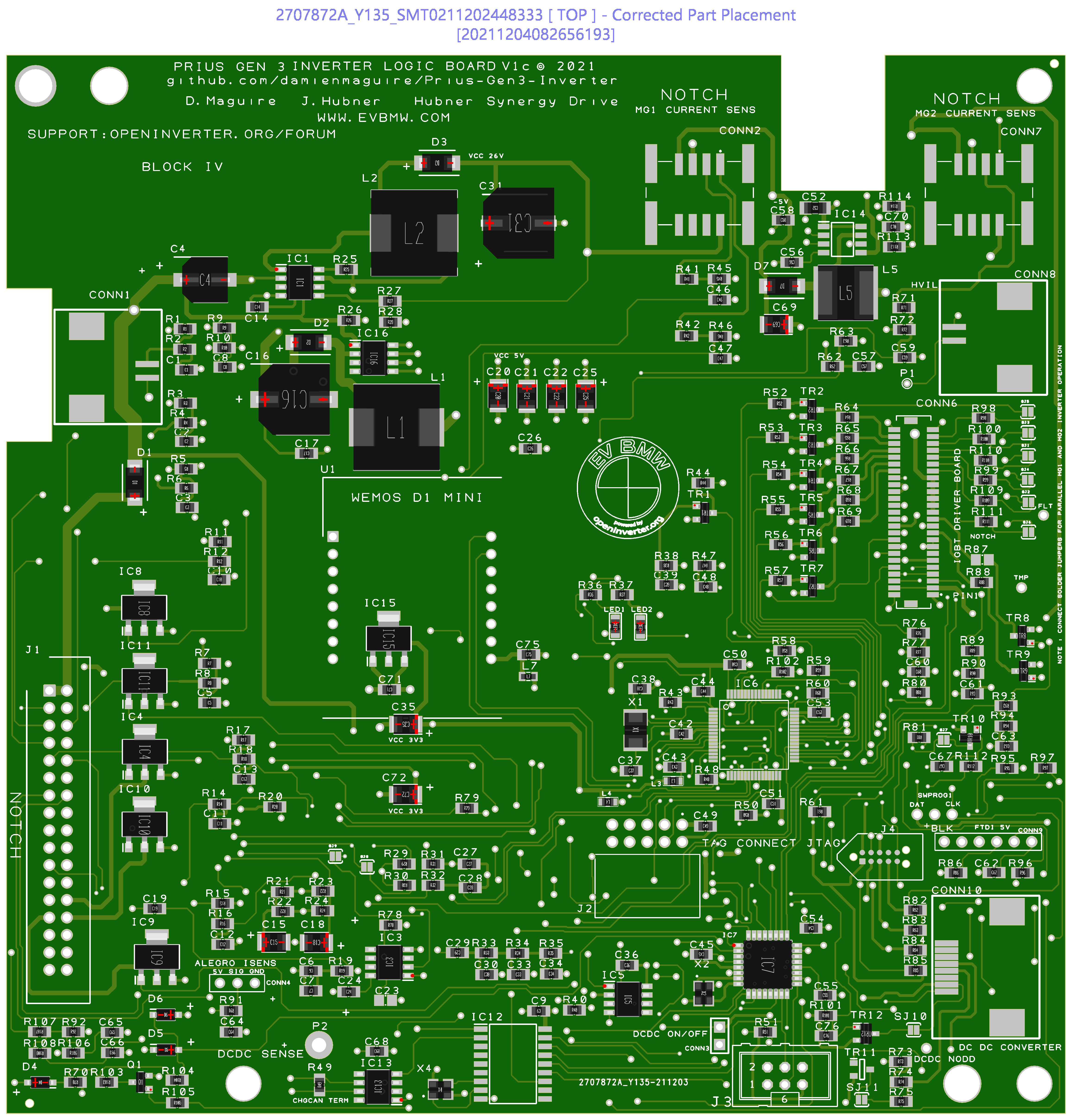

Some upgrades on the Gen 3 Prius logic board following feedback and contributions:
5V, -5V and 3v3 Supplies upgraded.
Double footprint to allow Olimex or Wemos wifi modules.
DCDC converter delayed startup on main contactor close.
DCDC 12V output control via STM32.
DCDC Sense permanently connected to +12V (avoids turn off overshoots)
Prototypes should arrive in the next week and should get a chance to test over Christmas. Design files will be released on Patreon at that stage.
All the non placed parts will be supplied in the kit but the STM32 will be fitted and programmed by me prior to dispatch.
