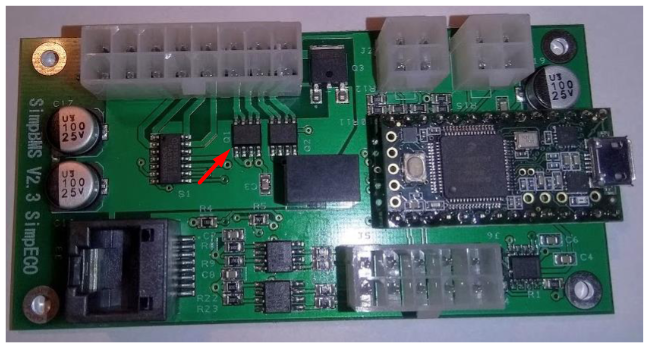

2. Thinking #1 was incorrect, and discovering they were actually not economized contactors, I connected them to the LOW pins on J4 for each contactor. I connected the teensy board to USB power, and immediately the negative contactor closed. About 3-5 seconds later, I heard what I can only assume was the positive contactor closing and immediately the IC in the photo below started smoking.
Photo from the manual of IC that smoked (now has a small bump on the surface)

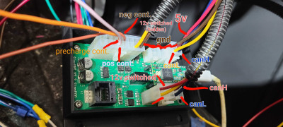

Here's a breakdown of my wiring when contactors were setup for HIGH control.

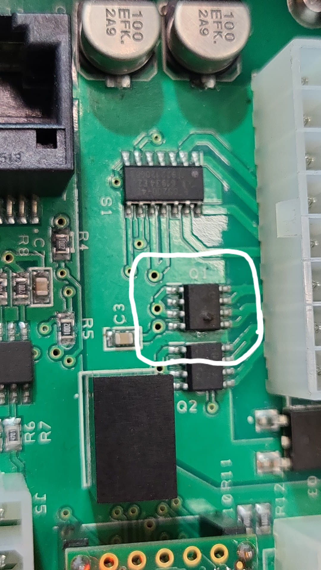

And here's the damage

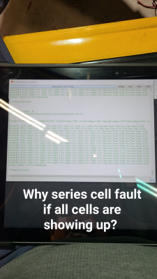

Last question: I'm getting a "Series cells fault" error, even though all cells are present and reporting. Do I just have a battery setting wrong?

Also, if anyone can help me ID the chip that cooked, I would appreciate it. I am googling all the numbers on it, but can't find it.
RandallATX
Posts: 9
Joined: Wed Aug 25, 2021 1:57 am
Re: Hitting some SimpBMS hurdles
Post by RandallATX »
So, I appear to have detonated this controller IC. I did it accidentally shorting a contactor coil wire to ground. :?
I believe it is a bts5200-4eka, but hoping someone can confirm that is indeed the chip.
Also, does anyone have one they can sell to me? It's... a little hard to find right now.

For the series cell fault check all settings on batteries tab relating to Parallel and Series cells. Then Check in the debug menu if the cells present is also set correctly.
You say 16 tesla modules so that would be : Parallel 1 Series 96 and Cells Present should also read 96.
In the manual wiring for your contactor is explained. You should measure the "coil" resistance if its a fixed lowish <100 ohm value you clearly have un economised contactors. You then wired them to the low side drive without adding a diode so huge voltage spikes thus blowing the ics.

I was getting series error on my Simp BMS and all cell where present and correct, it was basically because I was not saving the setting's. i think if I remember correctly the setting's are saved when you exit back to the root menu.
I know Tom is the designer so he knows best but this was just down to my lack of knowledge on using the simp BMS.
