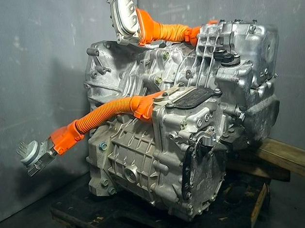

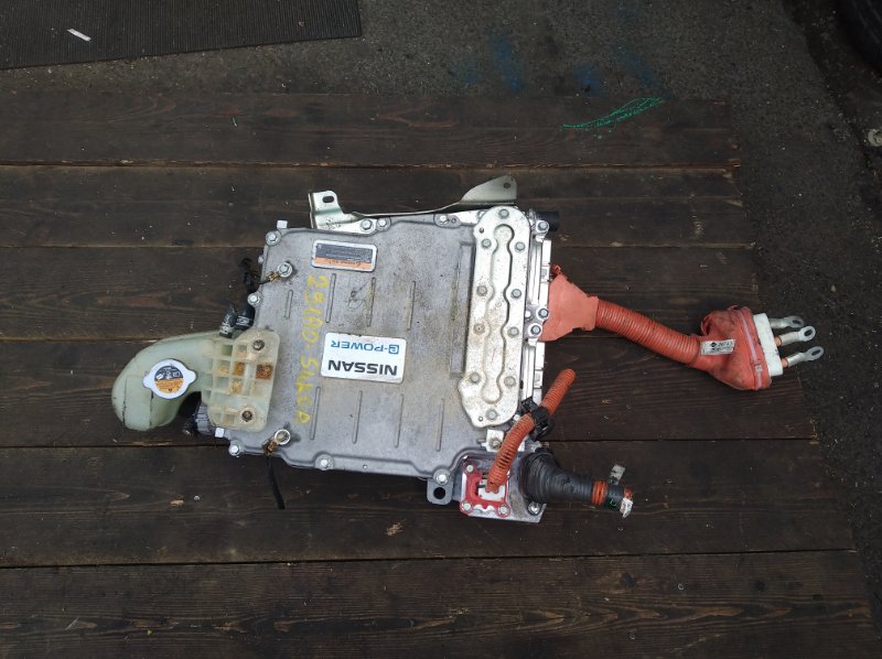

I've just ordered the motor set and am looking for an inverter to play with myself. The main motor is a well documented EM57, and the 2021 and newer models will have an EM47 that is smaller and more powerful. There are 2WD and 4WD configurations.
I've gathered some part numbers:
- Inverter (likely FWD version)- 291A0-5WK0A, and I've seen a 291A0-6XK0A (the last digits seem to relate to the model or variant of the vehicle)
- Generator (FWD) - 290C0-5WK0A
- Generator (AWD) - 290D0-5WK0A
- EM57 - 290A0-5WK0A
5WK0A seems to relate to the HE12 Note e-Power and 6XK0A seems to relate to the HE13 Note e-Power.
The newer Nismo S version (2016 or 2018 onward) has a 100 kW capable inverter.
I'm not sure if anyone on the forum has played with the setup, but it may be fairly similar to the Nissan Leaf.

First of all mg2 and mg1 are separate mechanically in this nissan note e power unit. The ICE is only run mg1 and its charge the HV Battery. There to power modules 1 is for control the mg2 and 2nd is to start the ICE and after starting its use as charging the HV battery. You can see the videos about its mechanism. I also want to use the complete setup to make an EV car where I can use mg1 for charging the battery system when ever i am going on long tour because at this time we don't have charging stations in my country like fuel stations. If any one have an idea how to get start ICE with its own ECU and wiring.

I have a Nissan Note e-Power, and there is a version of Nismo S, as far as I understand, both versions have the same engine EM57, but Nismo S produces 100 kW. Do I understand correctly that the main difference is in the inverter? Can I simply replace the inverter and get 100 kW? Maybe someone who already understands well can tell me.
