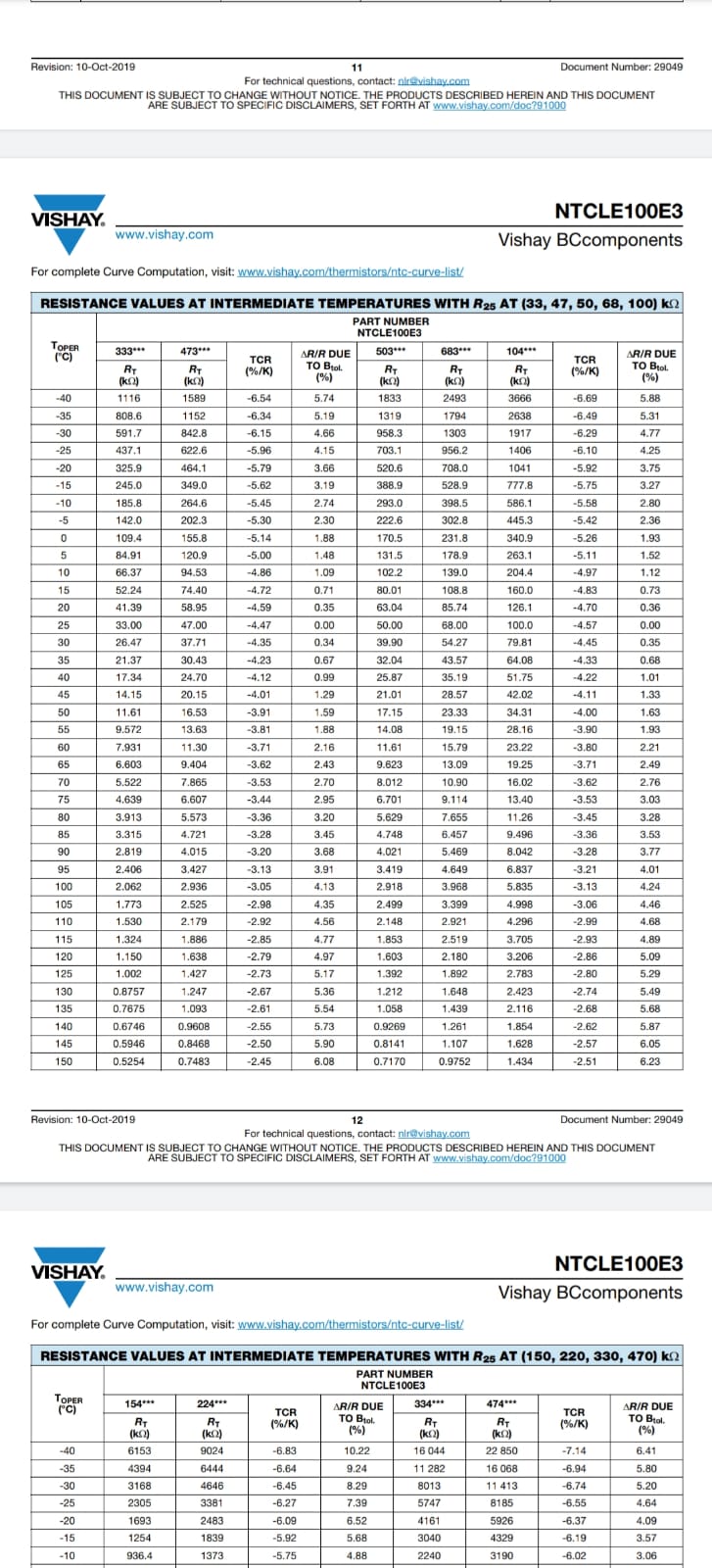

dsp1108 asked me to post this video and info:
Sensor temperature of motor like as ntc vishay.
Connect to pin 18 and 28 signal connector invertor.
R 25 =100 k.
