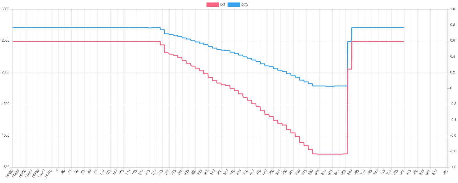

Did a test run of the VCU today. Will be in the next video.
But one detail puzzled me: throttle runs backwards
The plot goes from 0 to fully pressed. In voltage primary goes from 4V to 1V and secondary from 4.4V to 2.9V . Is it like that or have I reversed polarity? I connected it like written in the wiki

I think you can try to reverse +5 vs Gnd. In 1.6 wiring diagram it is stated what pin is +5, in 1.4 wiring there are no markings.johu wrote: ↑Tue Feb 08, 2022 6:15 pm Did a test run of the VCU today. Will be in the next video.
But one detail puzzled me: throttle runs backwards![]()

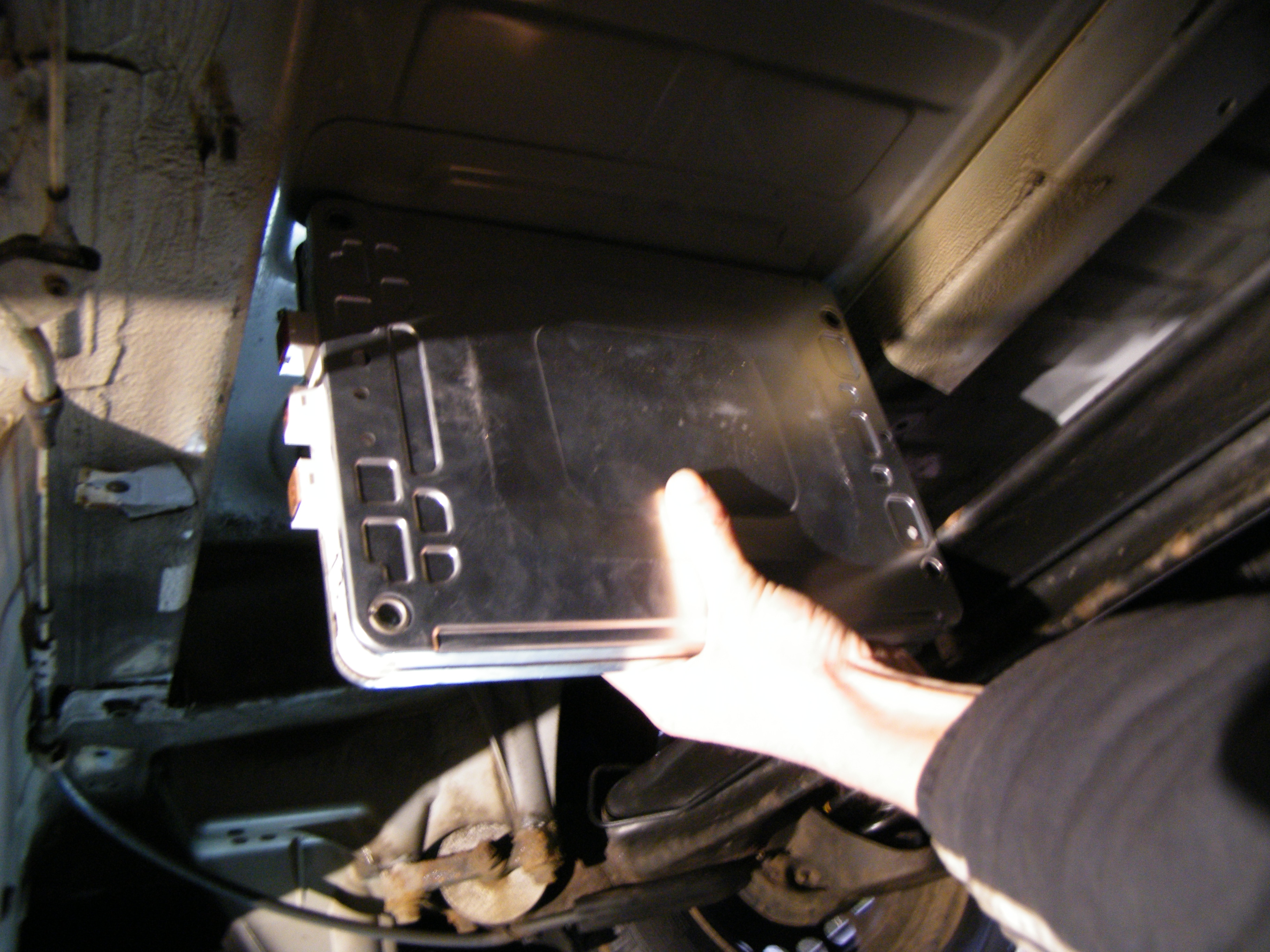

I removed the fuel tank and remaining exhaust parts today and am again delighted by the very boxy space that makes. So I will be able to easily fit 24 Leaf modules (i.e. half of them) where the tank used to be.
We will cut out the floor and place a plastic box (800x330x230) into the void for weather protection. The actual battery brick will then be mounted with a set of angles into the longitudinal carriers. So the battery box has no structural task. The other brick will life directly on top of that, so the rear seats are gone. The owner prefers it that way. But we might also put them into the compartment below the boot. Time will tell
