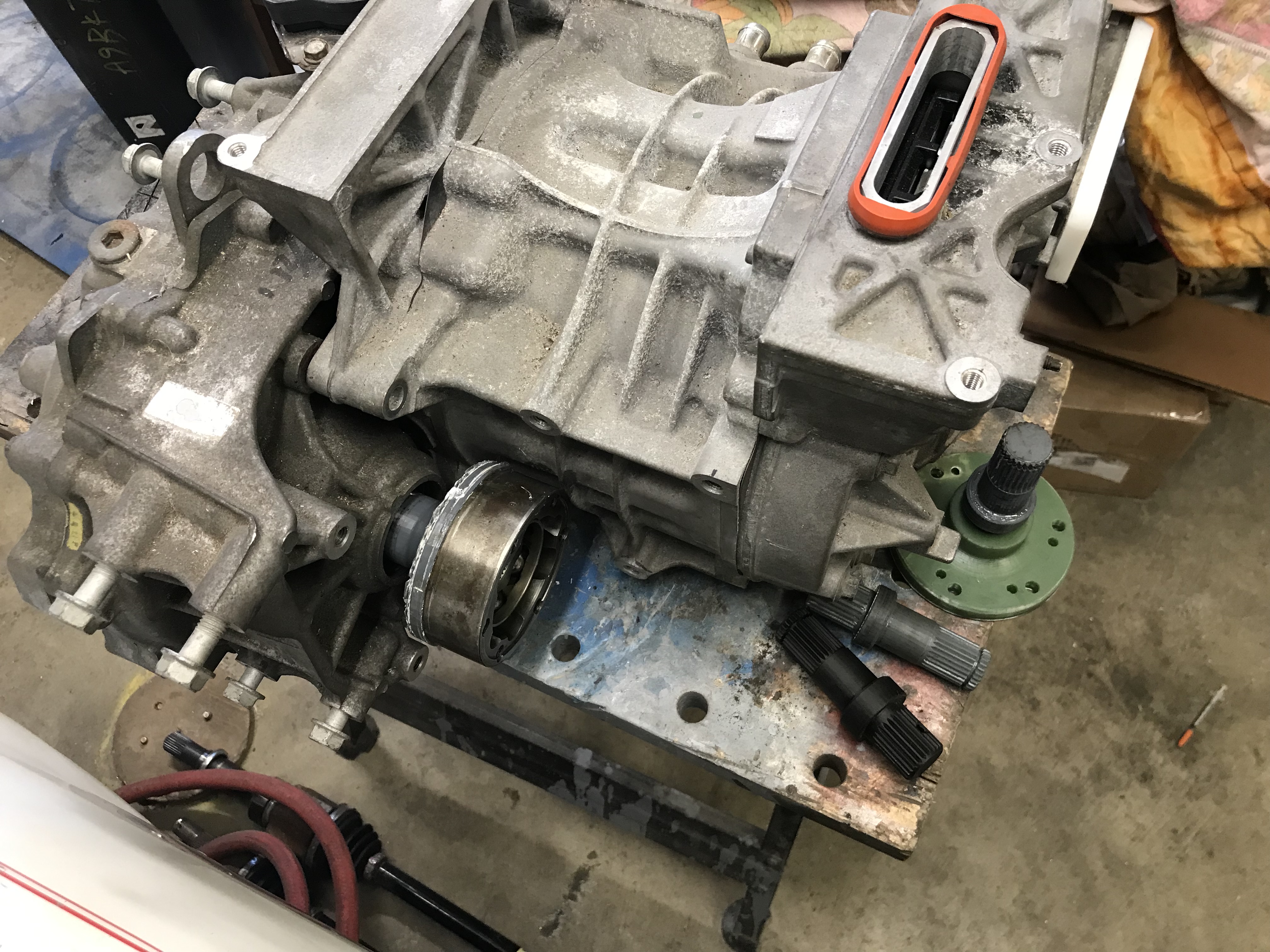

Started looking for the Leaf motor as well. It would seem that EM61 is more available in my region, but I've read from here that EM57 is more often used, so I might look for that instead. I haven't measured the motor bay yet so I don't know if it'll fit as a stack or if the inverter needs to be removed and relocated as in EM61. Once I have chassis work sorted, I think I'll make mock-ups about batteries and motors from cardboard to see what fits and where.
Is there a reason why I definitely shouldn't go with EM61 if one presents itself with good pricepoint? Some custom inverter boards or VCU not compatible? Difficult to source some parts that I'll end up needing? Anything?
I'm also trying to understand Leaf stack required "aftermarket" boards and what will I need when the time comes. Openinverter Gen2 replacement board, ZombieVerter VCU, what have you...

Oh I also heard that with Leaf stack the motor and the inverter should be from "one unit" (i.e. matching.. serial numbers or something?) for it to work properly? i.e. if I buy the motor part, and then from another source the inverter part, will there be issues?
- Posts: 6742
- Has thanked: 380 times
- Been thanked: 1564 times
Re: VW T2 -76
The resolver offset (static angular error of the resolver) is programmed into the inverter. You can match a motor to a "foreign" inverter by using the numbers printed on the motor and some special CAN messages. I think it is described here somewhere in the Nissan section and the tool "Leaf Spy" also supports doing this.

Yeah I'm leaning towards EM61 for its separate construction, just trying to figure out it's not something that turns out to be incompatible with most of the available VCU stuff. All I'm seeing is about EM57
confusing.
I need to study more about what kind of board(s) I'll need to control with it..
EDIT to specify:
I mean, currently as I understand it... Inverter controls the motor, and VCU controls the inverter based on inputs from throttle and so on. Am I correct?
With EM57 there is the opensource board that can be placed inside the inverter, with EM61 I am unable to find any.
I assume ZombieVerter being VCU would work to control both...
Have I got this right?

There is still a small thing of resolver timing. I advise you to go hunting for complete Nissan stack. That way you will get motor and inverter with preprogrammed timing.

Yeah looking for a full stack in either case now.
Thank you for that confirmation.
I'm just trying to find out what's the "best" option, I understand it's difficult to say and everything can be tweaked if enough motivation
EM61 would fit better, EM57 seems to have better support. Any other differences I should be aware of? CHAdeMO?

Well then use EM61 stack then. I think i remember someone from diyelecrticcar forum transplanted complete leaf to another car.Cera wrote: ↑Fri Feb 25, 2022 5:34 pm Yeah looking for a full stack in either case now.Thank you for that confirmation.
I'm just trying to find out what's the "best" option, I understand it's difficult to say and everything can be tweaked if enough motivationEM61 would fit better, EM57 seems to have better support. Any other differences I should be aware of? CHAdeMO?
I went and used EM61 motor with Volt inverter just because i didnt know i could use CAN bus with Leaf inverter.

I haven’t confirmed yet if the diff splines on the em61 and the em57 gear box are the same. But I I’m very close to having the vw stub shafts for the em57 gearbox done.
they’ll have a bug irs transmission spline on the opposite end so type 1,2,4 or 108mm(930) flanges work.
But I agree, the em61 gearbox/motor is definitely easier to fit compared to the em75 Type 2 cv pictured here.
- Posts: 3569
- Has thanked: 134 times
- Been thanked: 339 times
Re: VW T2 -76
I have bought a wrong set of shafts for my EM61 motor way back in 2016. They were EM57 shafts from 2012 Leaf as in the end of the year they shifted production from EM61 to EM57. When i tried them on they would go in the gearbox but not all the way. It seems EM57 shafts are thicker than EM61 or have the wrong spline. When i got corect shafts everything fitted.
Anyone has more experience?

Yanik mentioned that the are sort of different.
But can’t tell if its just the oil seal lips that are interfering or the actual splines are different. I know that the oil seals on the em57 gear box are different sizes on ether side. As one side uses a jackshaft. Luckily the seals are swappable, so having a single stub shaft design for both end of the gear box is possible.
Quoteting from Janik: “ I have test fitted a junkyard find Nissan Primera P11 SR20DE left stub to leaf gen1 and its a perfect match for spline and seal dimension”
