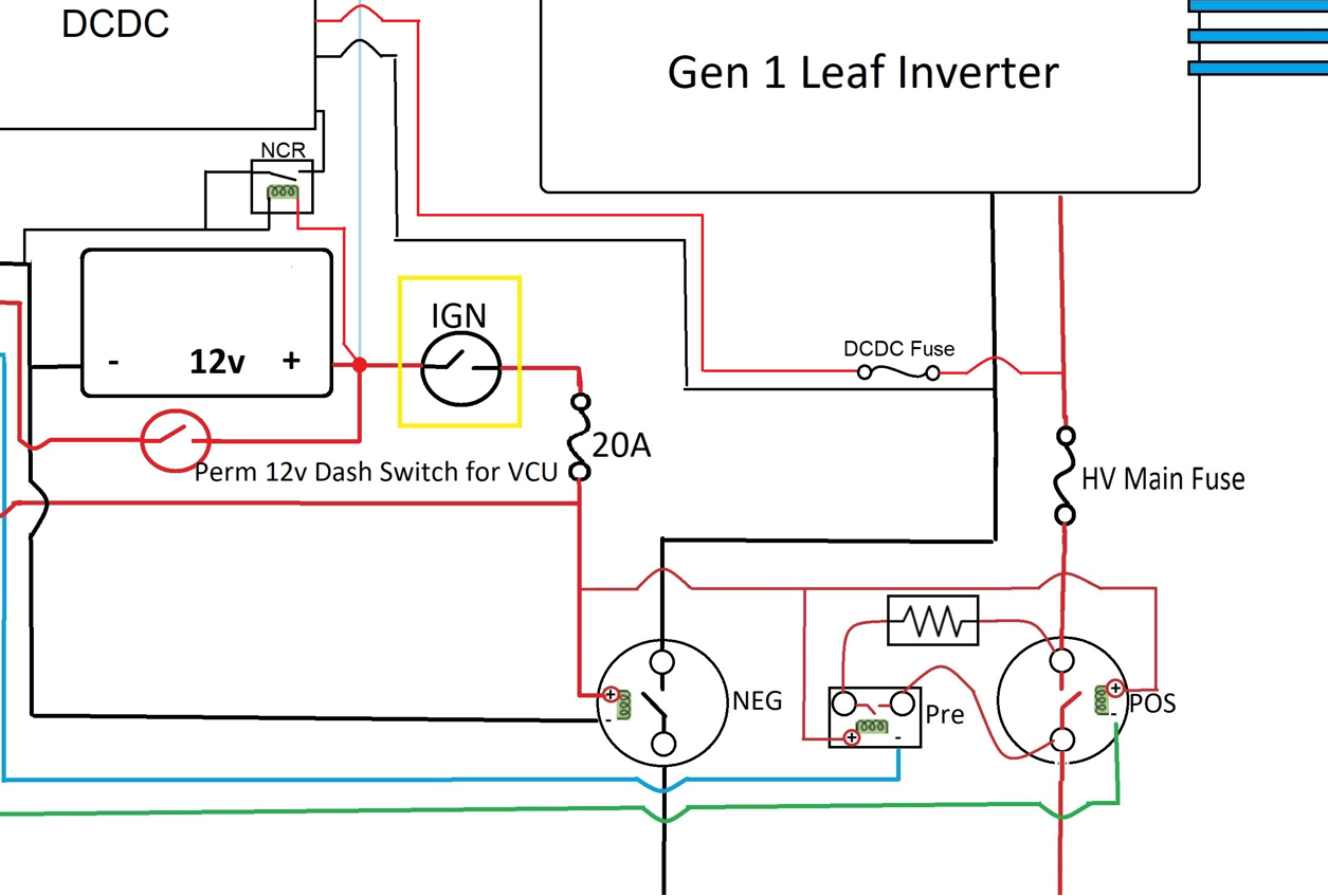

Hi guys
I'm looking some advice please. I have everything from a 2011 Nissan Leaf except the battery pack and am trying to connect the HV components to my egolf battery pack. I've added two more 4S modules so I have the correct number of cells in series and the BMS is connected without releasing any smoke so I'm hopeful this is OK.
I tried connecting the Leaf PDM through a 100W 50R resistor and it immediately popped so I didn't get to the point of connecting the HV directly.
I then tried a 30R 100W resistor but used a slightly different sequence to connect it and it popped immediately too.
So to see what would happen today I tried 6 x 4R 60W resistors in series but before I could get the direct connection plugged in they overheated and popped too.
I have a 10A fuse on the pack which didn't blow so I don't think it was drawing big current from the pack but it was too much for my resistors.
At this stage I don't have the inverter connected to the PDM as I was trying to minimise any damage should things go horribly wrong.
Can anyone advise where I'm going wrong please.
Do I need a precharge resistor between the battery pack and the PDM?
Should the PDM be drawing current as soon as it is connected to the pack?
I have the 12V battery connected so is it trying to charge the battery?
Are my resistors too weedy or the wrong type?
Should they only be connected for a fraction of a second before the direct connection?

The stock Leaf PC resistor is 40W 30ohm based on the one I removed that failed under similar conditions. If the DC-DC is active or the inverter is "ON" during PC, this can cause an overload. Also, if the voltage setting for PC is too high, the PC system can remain on for too long and overheat the resistor to failure.

It may have been the DC-DC as the 12V battery was connected at the time but the inverter was disconnected.ZooKeeper wrote: ↑Sat Feb 19, 2022 5:20 pm The stock Leaf PC resistor is 40W 30ohm based on the one I removed that failed under similar conditions. If the DC-DC is active or the inverter is "ON" during PC, this can cause an overload. Also, if the voltage setting for PC is too high, the PC system can remain on for too long and overheat the resistor to failure.
I also had the AC pump and HVAC heater connected.
But all these would all be connected in the Leaf too so either my timing was too slow (I was plugging them in by hand) or I'm missing something.
The resistors I used worked OK with the inverter for testing but this is the first time I've tried connecting the PDM

I have had similar issues in the past with mine. When DCDC is already active, I have found the precharge never completed as the DCDC takes all the juice so the inverter never reaches HV preset. In this situation, I never blew the resistors. I did blow them when I had the DCDC polarity the wrong way around. 2 seconds after I closed the contactors, the PCR went pop. Once I fixed the human error, all good.
Here is my setup from when I got things set up first for ref. I would check that all your Leaf PDM wiring follows the layout Are you connecting this with the service disconnect out? That should be the last thing you put in place. I cant see why it is going 'live' at the point you are doing up the final HV fixings and the PCR is going pop. Something very wrong there. Are you using Damiens Leaf VCU? When it comes to timing as you mentioned, timing should only come into place with the settings you have in the VCU (Damiens or Johannes') and you trigger the Neg and Precharge contactors followed by the Pos main after you reach HV preset

+1 for reversed polarity. Resistors don't go pop from a bit of overload

Guys thank you sooo much, you are 100% right. I just did some more research and discovered I was connecting the pack with the polarity reversed.
It is such a relief Cookie that you said you did it too. Not so much because it means someone else is as silly as me (but that helps) but because your system still worked afterwards.
I had been watching this video.
At 1:52:32 he talks about the polarity. Had I listened and watched a little more carefully for a little longer I'd have realised he was talking about the battery connection side of the junction block and the other end of it was the bit I needed to know about. He then mentions this a few seconds later but I had already thought I had the answer and turned off.
Thankfully I never got to making the main connection so only the 100W resistors were in circuit so hopefully when my new resistors arrive all will be well.
