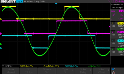

This shows the 3 main phases (with static 25%, 50% and 75% duty cycle PWM - high-side drive for reasons) and the exciter output on the wiring harness all perfectly aligned. The exciter output is reduced a bit by running at 12.2kHz (2.24V) rather than 10kHz (3.17V) but I'm hoping this should still be enough signal to provide an accurate position. Next stop for me is getting the analog capture of sine/cosine and phase currents going.

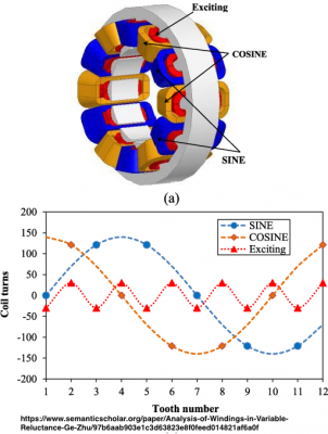

Just sharing this picture.
https://ieeexplore.ieee.org/document/6953227
Exciter and resolver coils are placed in the same tooth! Exciter are in every tooth. Just unclear if the Tesla resolver has alternating sin and cos coils or all 3 coils integrated into each tooth.
1 pic explained everything and more than 1000 youtube videos glossing over actual key info. This one pic contains all the missing information I was lacking for the past 2 weeks to understand how the resolver works. I thought it had to be like that but no evidence found until I saw that pic.
