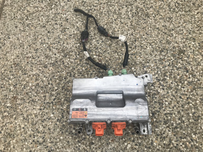

so I scored a Chevy Volt second gen DC-DC Converter, essentially for a $100 bucks, couldn't pass that up, and FREE shipping, I am sharing the eBay listing details because I know when I was a beginner (so many, many days ago, ha ha) I wanted to know what these used electric/hybrid car parts cost and more importantly what people are paying for them, folks please remember that sellers can ask what ever price they want for their items, it does not mean you have to pay it, or that the item is worth that, and every day more and more used OEM EV parts hit the resale market (thank you distracted texting soccer moms), also be aware of some sketch eBay practices where a seller will list multiple items at different prices, one being sky high to make the others look like good deals, there is a term for that, which escapes me at the moment, if you know what this shady practice is called please post a quick response, a while back one of those 20/20 magazine TV shows did a special on this
Top Tip: note how the eBay listing does not even have the word "Converter" in the title, that's why I was so hell bent on obtaining the part numbers so that we can search by those as well, not my first rodeo folks, not my first rodeo, lOl

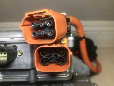

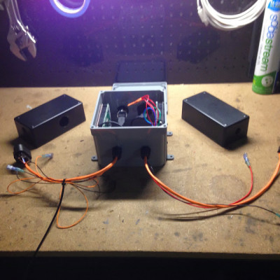

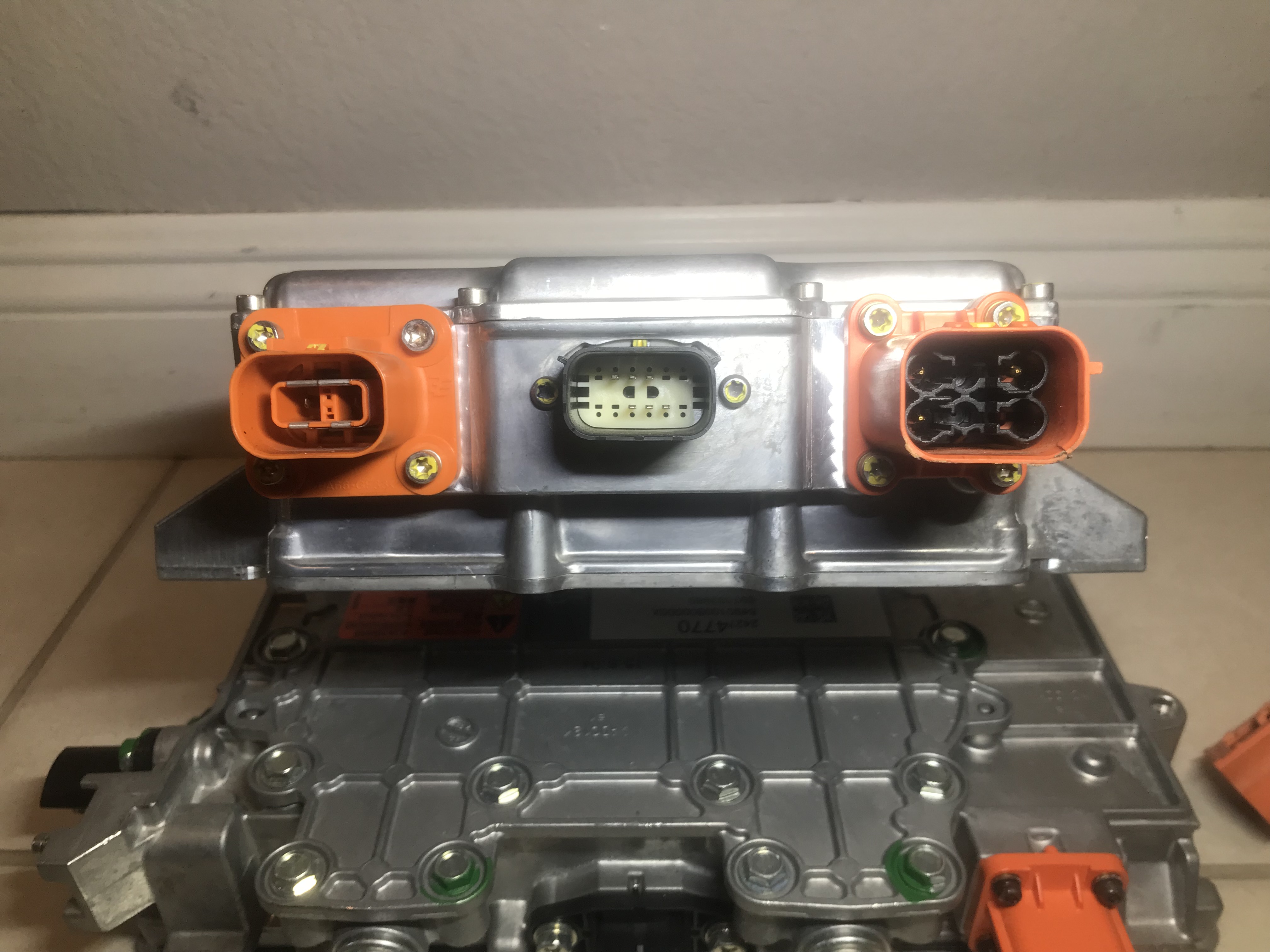

folks what we have here is the making of a Mr. Arber Kramar of LEAFDRIVEBLOG fame Starter Kit, so why don't you lean in a bit closer and set your eyeballs on this there second gen DC-DC converter orange (pronounced: high voltage) plugulator
Note how the orange square(ish) plug is keyed? One protrusion/notch thingie on the left, whilst a double on the opposite side?

now let's stare and compare that to the orange (high voltage) plugs on the second gen charger
I believe this one below runs to the high voltage battery pack
and this side is where the charge port plugs in

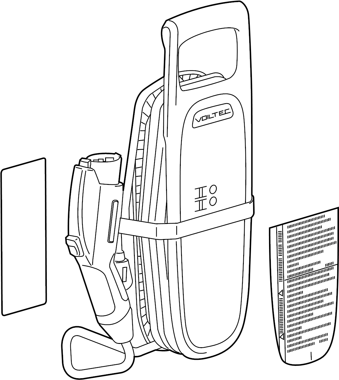

so I thought this diagram picture thingie was cute and worthy of cluttering up our thread, oh it also pretends to show where the charge port actually lives on the first gen Chevy Volt
um ok...
ok, call me crazy, but where the hewk did that charge port door go?

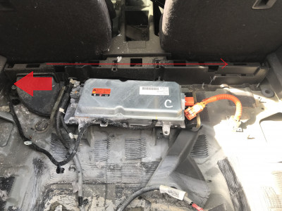

so I swung by a local all Chevy parts wrecker today in my town and they said they had one first gen Chevy Volt a 2014 model and they would let me go and look at it with them and tell them what parts I needed that were still on it, they were also kind enough to allow me to take some pics so now I can share with confidence the location of said components

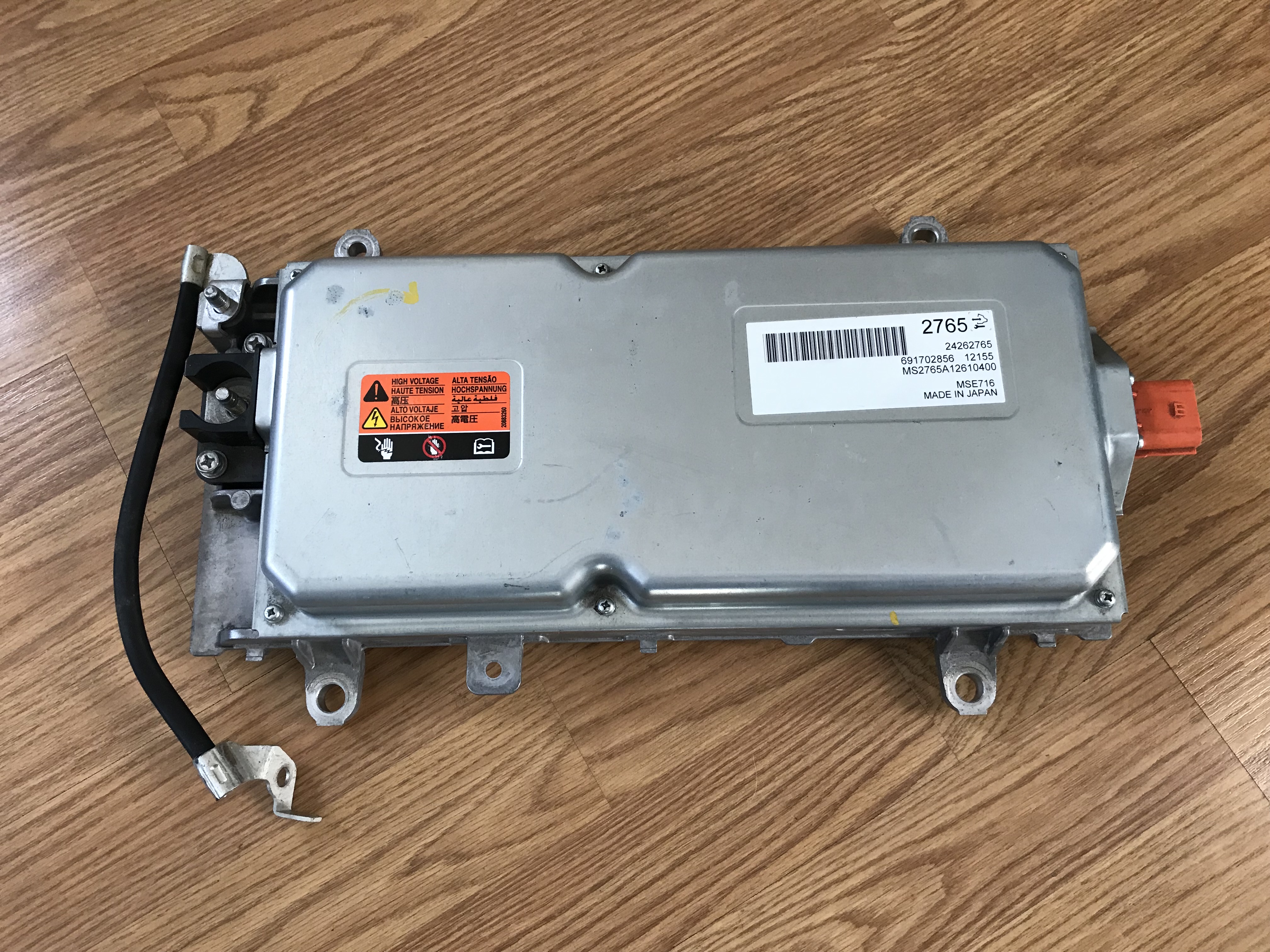

so I got the low voltage positive and negative cable harness off of it part number 23167047 (I divorced them for demonstration purposes)

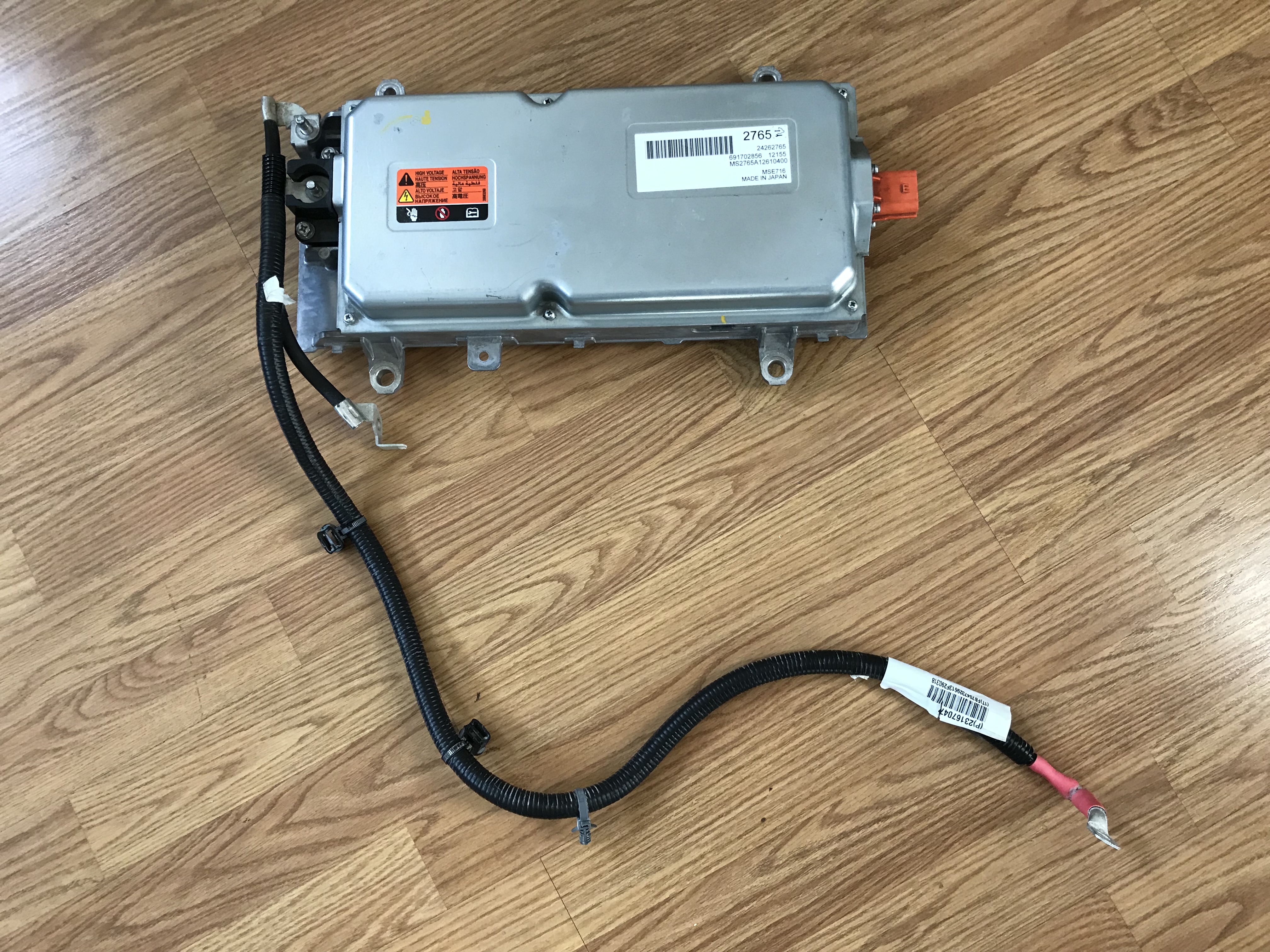

so now my first gen (2011-2015) Chevy Volt DC-DC converted setup looks like this, all that's missing is the proper high voltage orange battery cable, which they are pulling off the car for me tomorrow

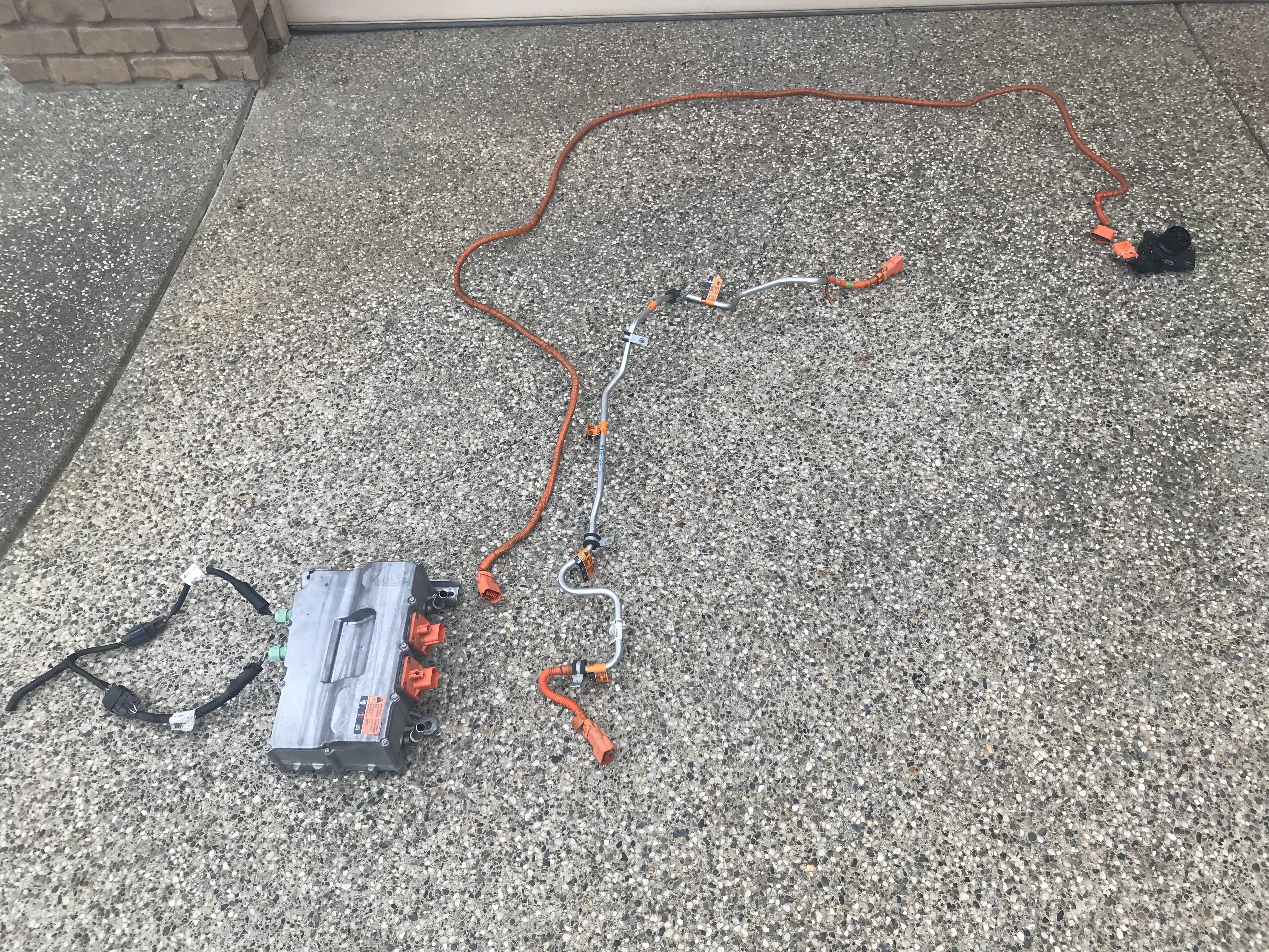

I am pleased to report that now WE seem to have all the wires, cables, harnesses, (call 'em what you will) for the first gen (2011-2015) Chevy Volt DC-DC Converter
so let's lay them out in the driveway and take a look see (pretend you are standing at the rear of the car and looking into the trunk where the converter lives and then follow the metal tube thingie which runs under the car to the front of the vehicle where it plugs in to the front of the high voltage battery pack under the engine bay firewall)

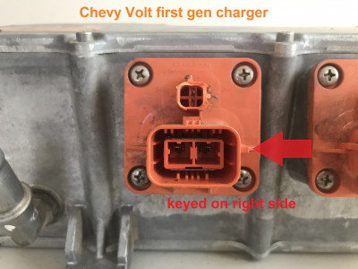

just want to point out and caution folks that none of the orange high voltage cables are interchangeable between the first gen and the second gen
here we stare and compare the DC-DC converter two nostril ports and see how they are keyed differently
