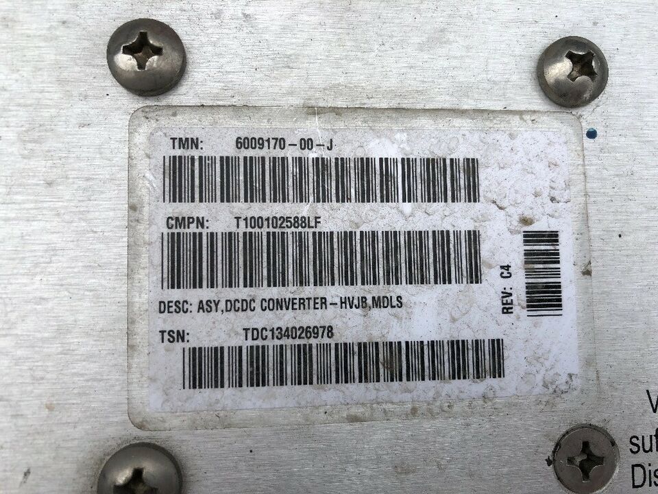

Since the first DCDC converters are the cheapest to get, I bought one and tested it. The voltage can be controlled with the same CAN message as described above. A message is returned with the identifier 0x210. The second byte apparently returns the temperature. 0xE1 at 20 ° C, increased to 0xFE, approx. 50 ° C during testing. Byte 5 gives the output voltage in 0.1V. 0x8C for 14V, 0x82 for 13V etc. The connections are at the top right 12V enable signal, bottom center CAN L, bottom right CAN H. The two top left pins a HVIL.
Because the case was damaged i opened it. I noticed that the two orange plugs have 40A fuses. The gray plug seems to be an adjustable output. The corresponding CAN message for controlling this output would be interesting. Does somebody has any idea?

muehlpower wrote: Thu Jan 14, 2021 10:00 am Does somebody has any idea?
Same circuit as this?
https://www.diyelectriccar.com/threads/ ... ox.193729/

New Electric Ireland wrote: Thu Jan 14, 2021 10:13 am
My device is a combination of this box and the DCDC converter. The HV outputs are the same in color and function. The control must be different, my plug is only 6 pin and assigned as described. No PWM input and no status output!

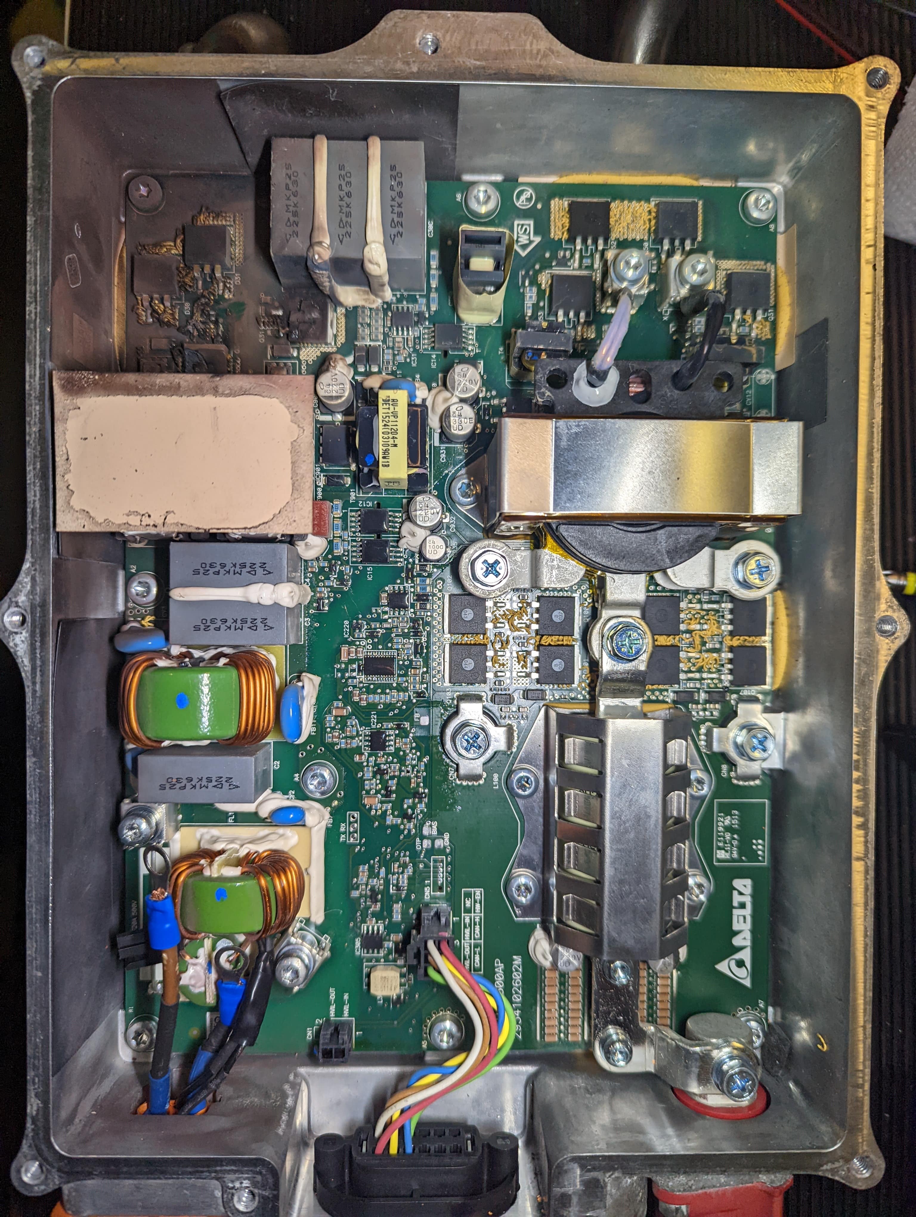

Post by janosch »
Fire!
We used this DCDC for 1500+ miles without CAN control.
Thursday it set itself ablaze.
I wonder what went wrong? Maybe we overloaded it on 12V side, but no heater was on, maybe PS pump (60A fuse). Will fuse the 13.5V+ output just in case for the next one.
Cooling issue possible, but it is mounted flat as it would be in the Tesla.
Part #:
MKP25 225K630 ( 600V grey capacitor )
C3D10060G ( 600V / 14A Schottky Diode near fire)
Burned are Q30, Q31, look like HV MOSFETs to me at first glance, but I am not very familiar with the innards of this device (yet).
If I find out what the MOSFETs were I might be able to salvage the board actually.
Until then:
Classifieds: wanted: Tesla DCDC
Edit: In retrospect, why I decided not to fuse both HV and 12V side for an expensive component like that is now a mystery to me. #movefastandbreakdcdcconverters
