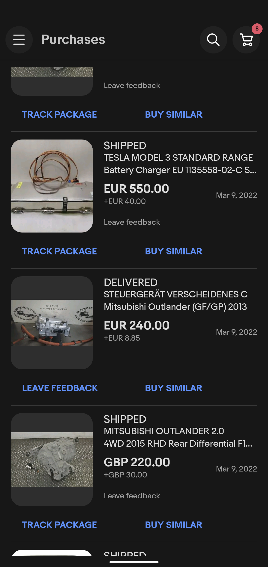

so I'll add some more transparency to this project: costs
Obviously the shell was already there, so I'll focus on just the costs of the EV stuff.
The BMW charging cable was 350 EUR converted from the polish currency That's the housing for the Zombieverter VCU

The battery is out of a Kona 2020 and has only covered 16.000 ish kilometers. So the SoH should be very good. I'll try to get it in the car the way it is with all the housing, but i doubt it'll fit even with severe bodywork to the shell of the car. So i assume I'll have to tear it down and use an aftermarket BMS like the Orion BMS again.
This time I really wanted to spend money on the battery as range is something that will actually determine how much you use the car, if you want to commute to places further away
I've spent 350 on the Zombieverter ECU
And 300 on the charging control ECU for the Tesla unit
The battery was 5400 EUR and shipping from the Netherlands 350EUR and also I bought 2 drive shafts out of 4 that i need, for 50EUR each.

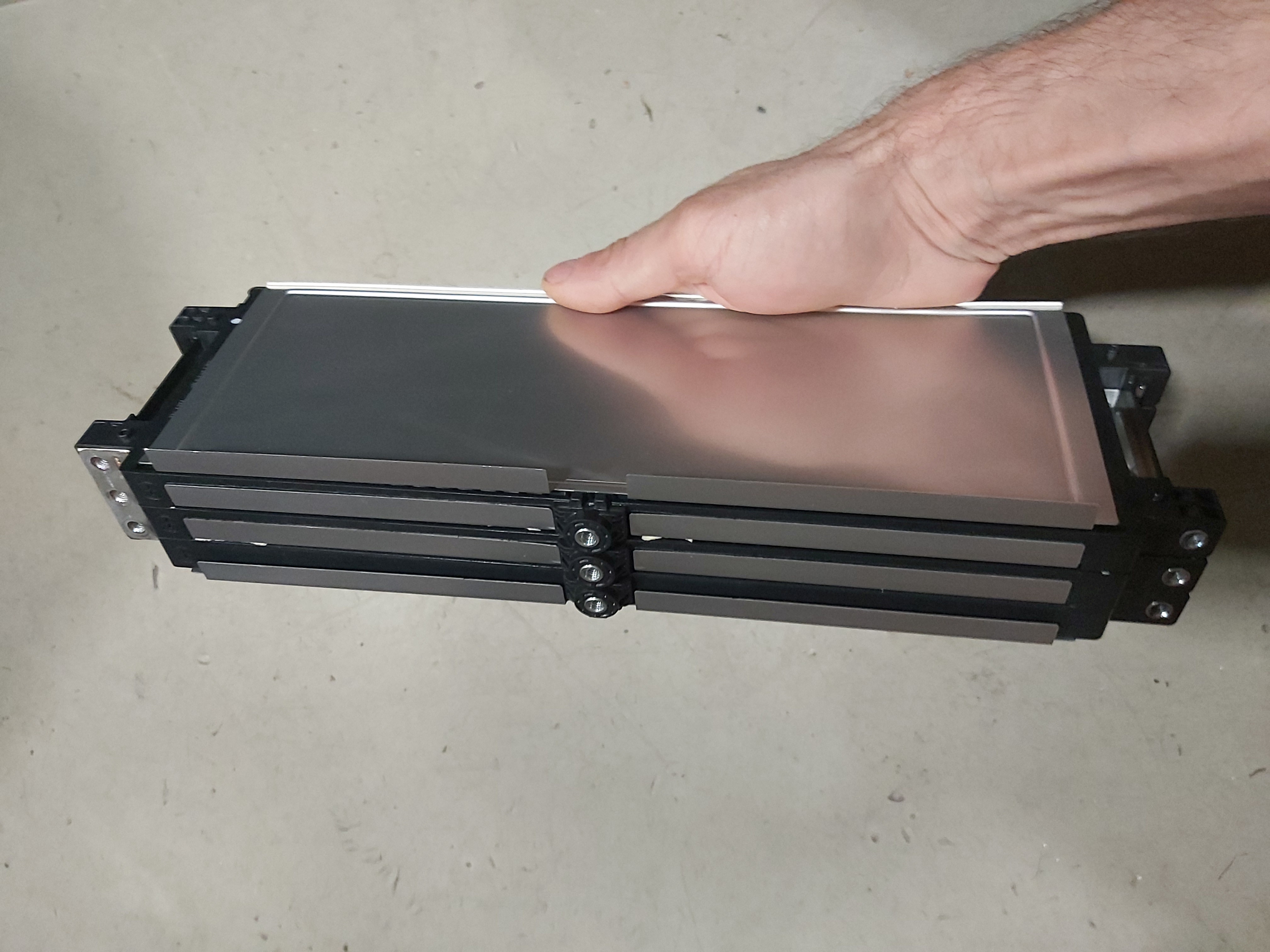

Very interesting! I don't want to separate the 3 cells. I will try to fit 96 of 98 of the 3-packs in the car as the Orion BMS only can do 96 cells, so approximately 1,6 kWh can't be installed.

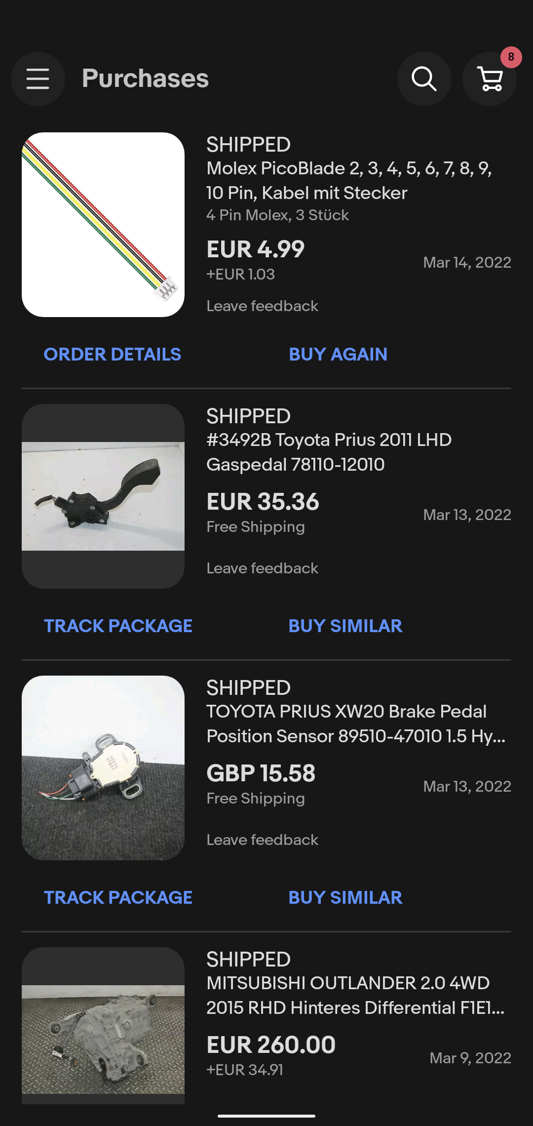

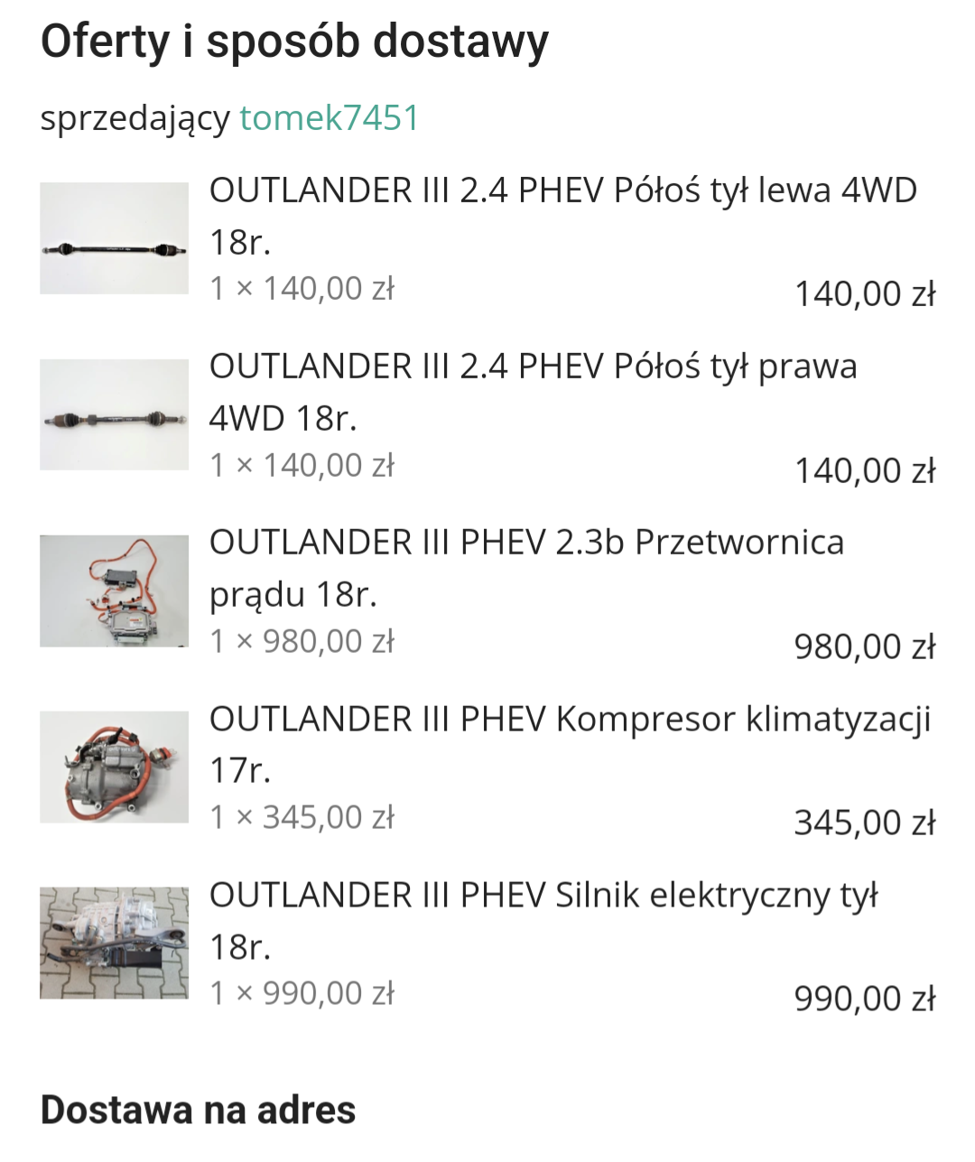

One of my rear outlander motors that i bought for cancelled, so i had to find another one. Luckily i found one on allegro and contacted the seller to get the two missing driveshafts, the heater and the AC compressor. So HVAC is taken care of, already. Furthermore every HV connector will fit snuggly as everything is OEM. I love that OEM look. If someone pops the hood and can't tell that's a homemade conversion neither can when driving the car, that's what I try to achieve.
This sums up to just under 600 EUR for everything

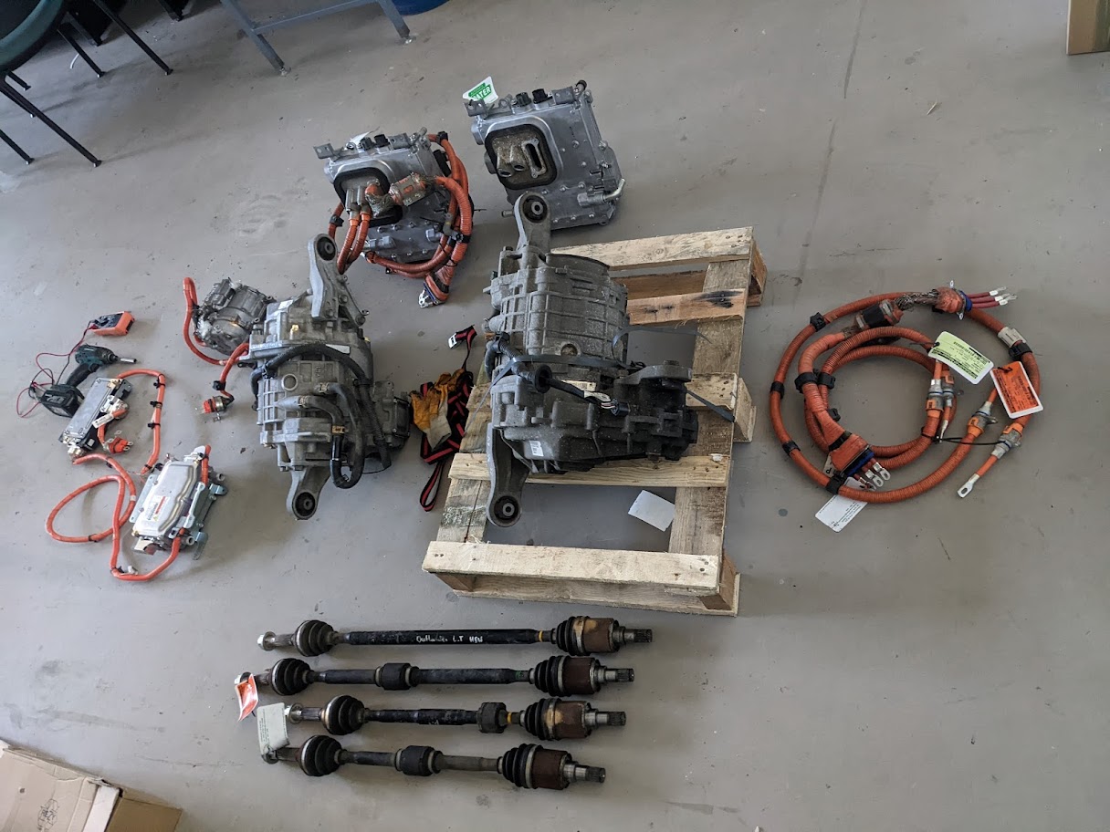

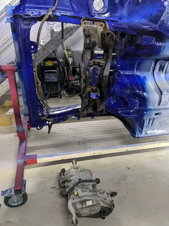

I started to work on the Impreza and figured out, that one motor has to face forward and one backwards due to the limited space i have.
I will have to split the battery in 3 Parts: 36 cells in the back, 36 cells in the front and 24 cells in the middle where the fuel tank was. But it will fit.
I took the battery cover off, to measure the cells myself, alltough there is very good information in this forum (Kia/Hyundai section)
The Spare wheel well will be cut out completely to make room for the 36 cells.

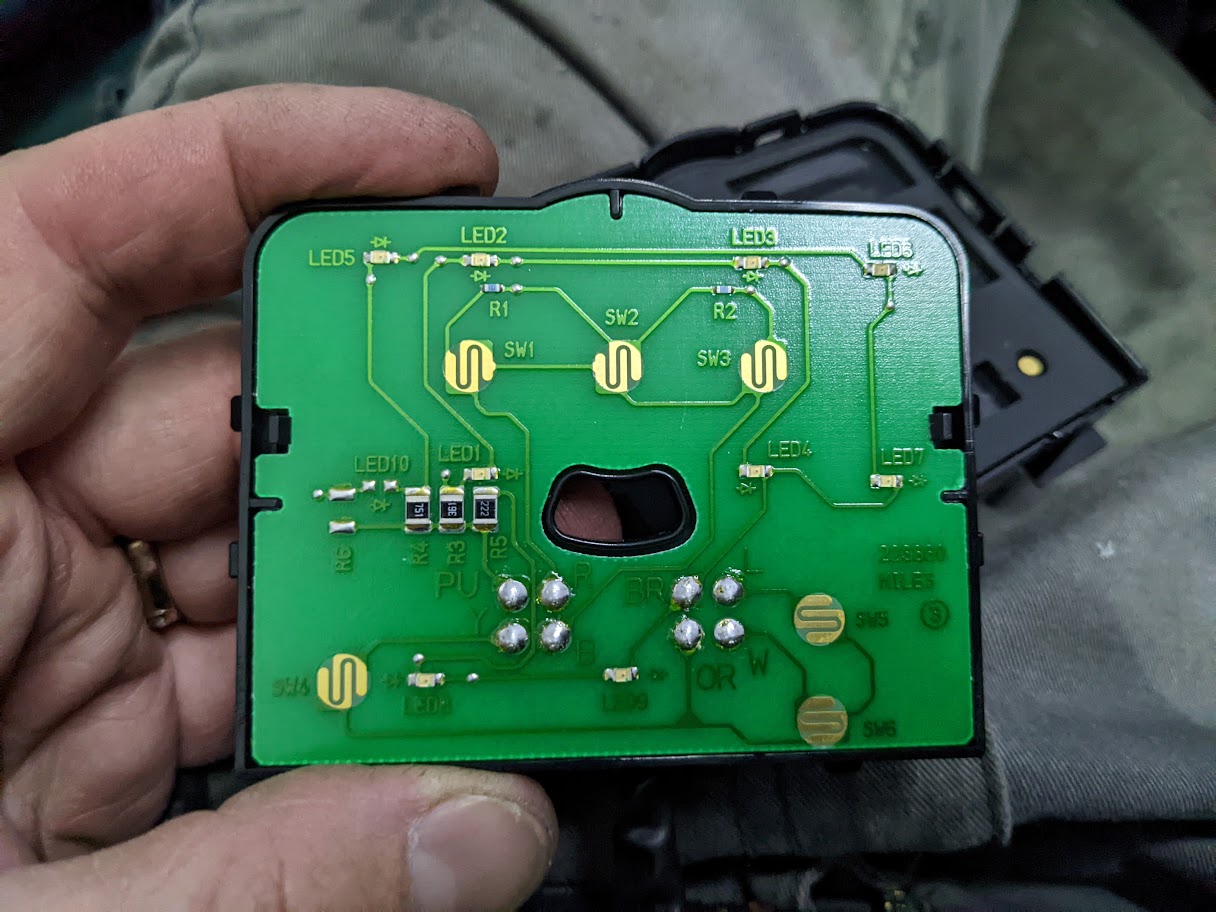

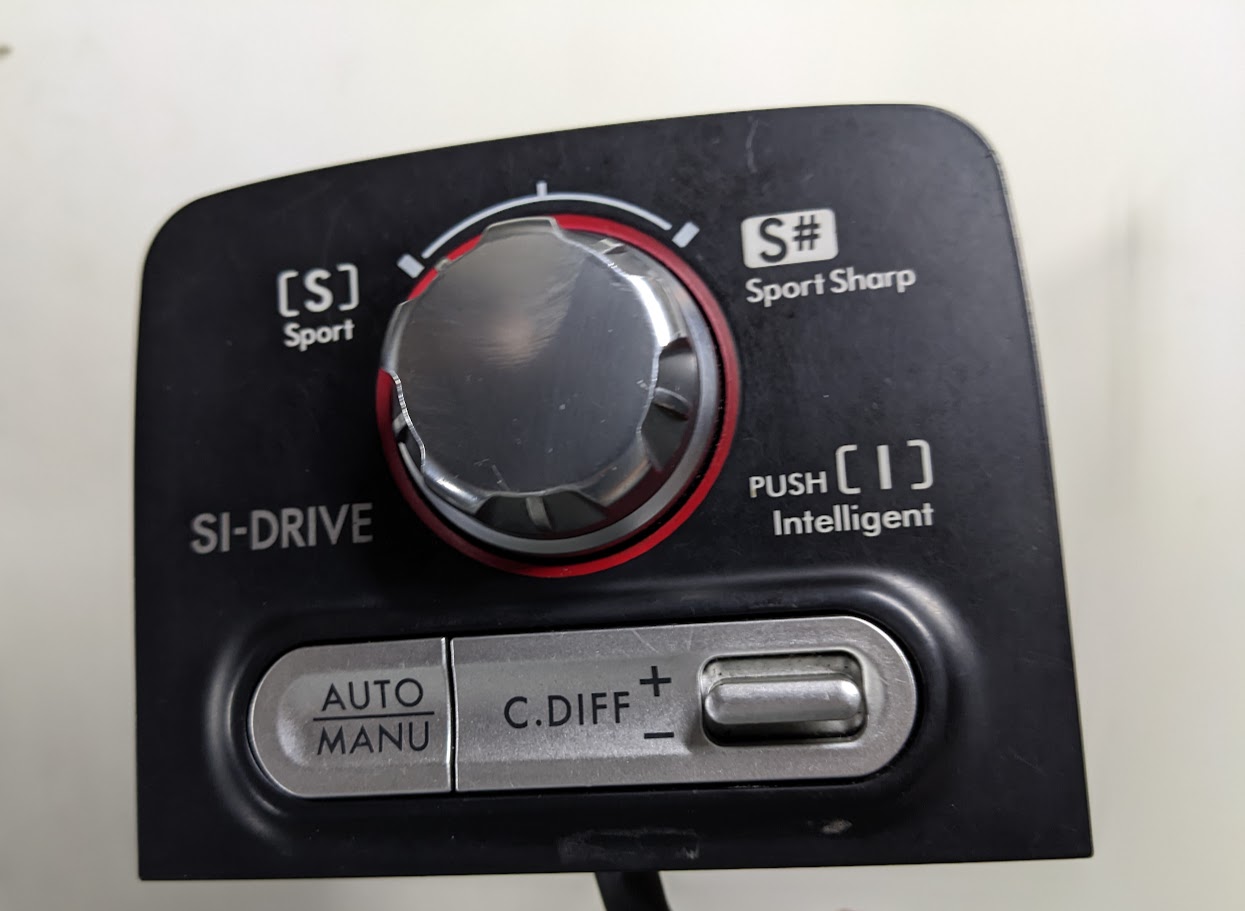

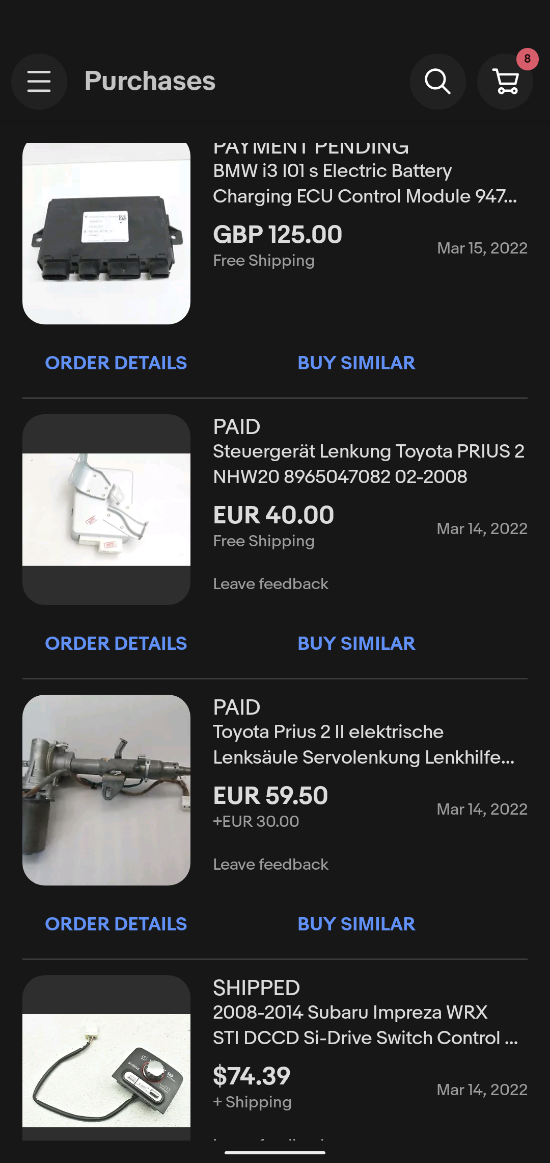

I also inspected the switch from an 2013 Impreza WRX STi that i bought and found out the turning knob already is a resistor ladder. I then decided to convert the other buttons, too.
So a push on the button will start the car, a left turn forward mode and a right turn backward mode.
The diff + / - button will determine how much torque is going to the front and the rear wheels and the Auto / Manu button will reset it to 50/50.
Also it'll get painted black and with some custom stickers it'll indicate all functions labeled correctly.
What i don't know so far is, if the inverter is sending some information on the can bus, such as rpm. But i'm pretty sure it must. If yes i would like to implement slip control by comparing front RPM with rear RPM and reducing power of the higher RPM inverter until they are equal again. In Manual mode drifting will then be possible as this is only true for auto mode.

Sweet OEM look. This project is going to be awesome, looking forward to helping out.
Looks like there is RPM info on CAN viewtopic.php?p=24162#p24162

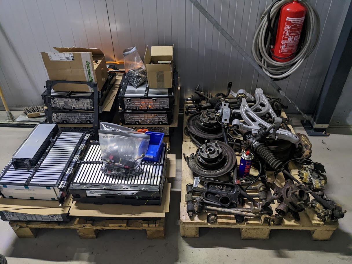

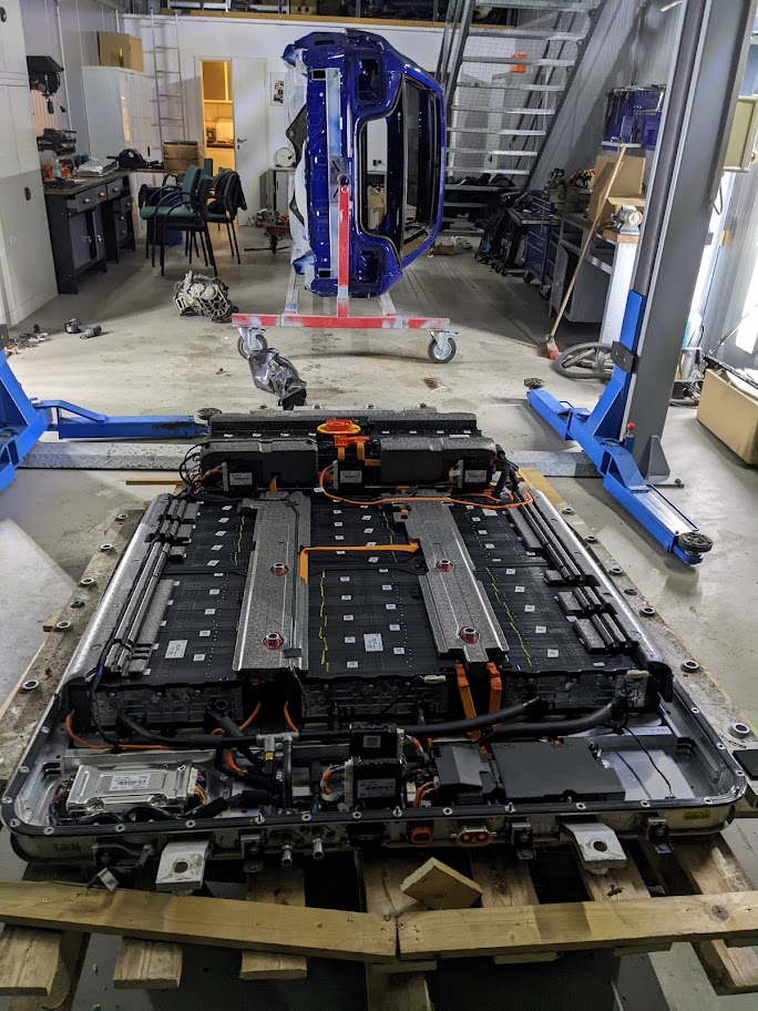

Yesterday i took the battery apart. To get 96 of the 98 Kona-Cells in the Impreza it'll be the same puzzle as it was on the GT86 Project.
Also i have to convert 6 of the 8 10S3P Blocks to 9S3P. Two of the Blocks are by factory 9S3P (8x 10S3P + 2x 9S3P = 98 Cells). The Orion BMS can only support 96 Cells in my version, so i won't use 2 of them which equals in 1,3 Kwh less.
Done taking the batteries out!
Water Cooling Plates on bottom, secured with a lot of screws and heat sink pad inbetween the cells and the cooling module.
Left: All 10 Battery Blocks
Right: Impreza-Drivetrain-Parts

Re: Subaru Impreza 96 - AWD with 2 Outlander rear motors
Some details on the battery:

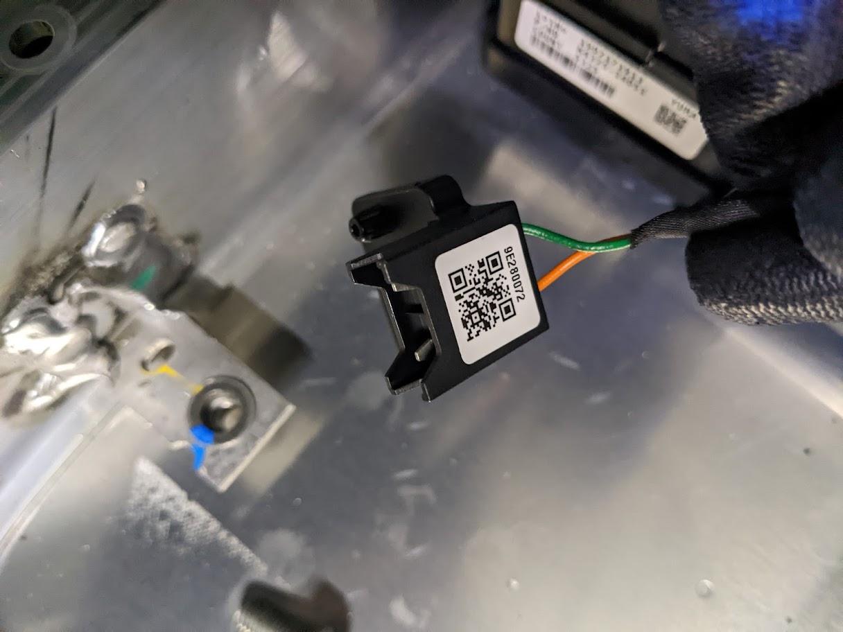

Interesting: I found this sensor, i guess it detects a leak of the cooling liquid
The relais-box with precharge, i'm going to reuse that of course
The Connectors i'm not reusing.
Shutoff-Plug with seperate fuse rated 400V 400A = 160Kw

The Outlander-Stuff:
1x AC-Compressor with Cables
1x Heater, also with Cables on HV and the Plug on 12V Side.
1x Junction box with 20A Fuse, where the Heater is connected to.
2x Inverter with all Cables and Plugs
2x Motor with all Cables and Plugs
4 x Drive shaft to be connected to the Impreza outer shafts
when buying this stuff i always try to get all the cables. That makes it so much easier to install and the looks are usually way more OEM-Style.
All Outlander Parts
The fuse box is nice to have
I Expected the motor to weigh less. It's 60 Kgs!
All Outlander Parts

I would advise you to make modules of 8S3P. It can be assembled up to 96S easily. Then you can get all sorts of proprietary BMS as well as DIY. My favourite BMS right now is active balancers from Hankzor store https://www.aliexpress.com/item/1005002 ... 1802NyGfjMZapatero wrote: ↑Mon Apr 11, 2022 7:07 am Yesterday i took the battery apart. To get 96 of the 98 Kona-Cells in the Impreza it'll be the same puzzle as it was on the GT86 Project.
