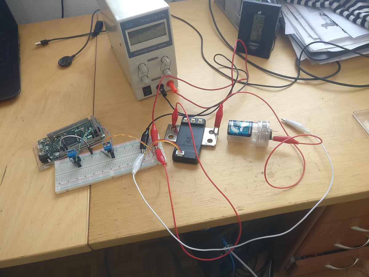

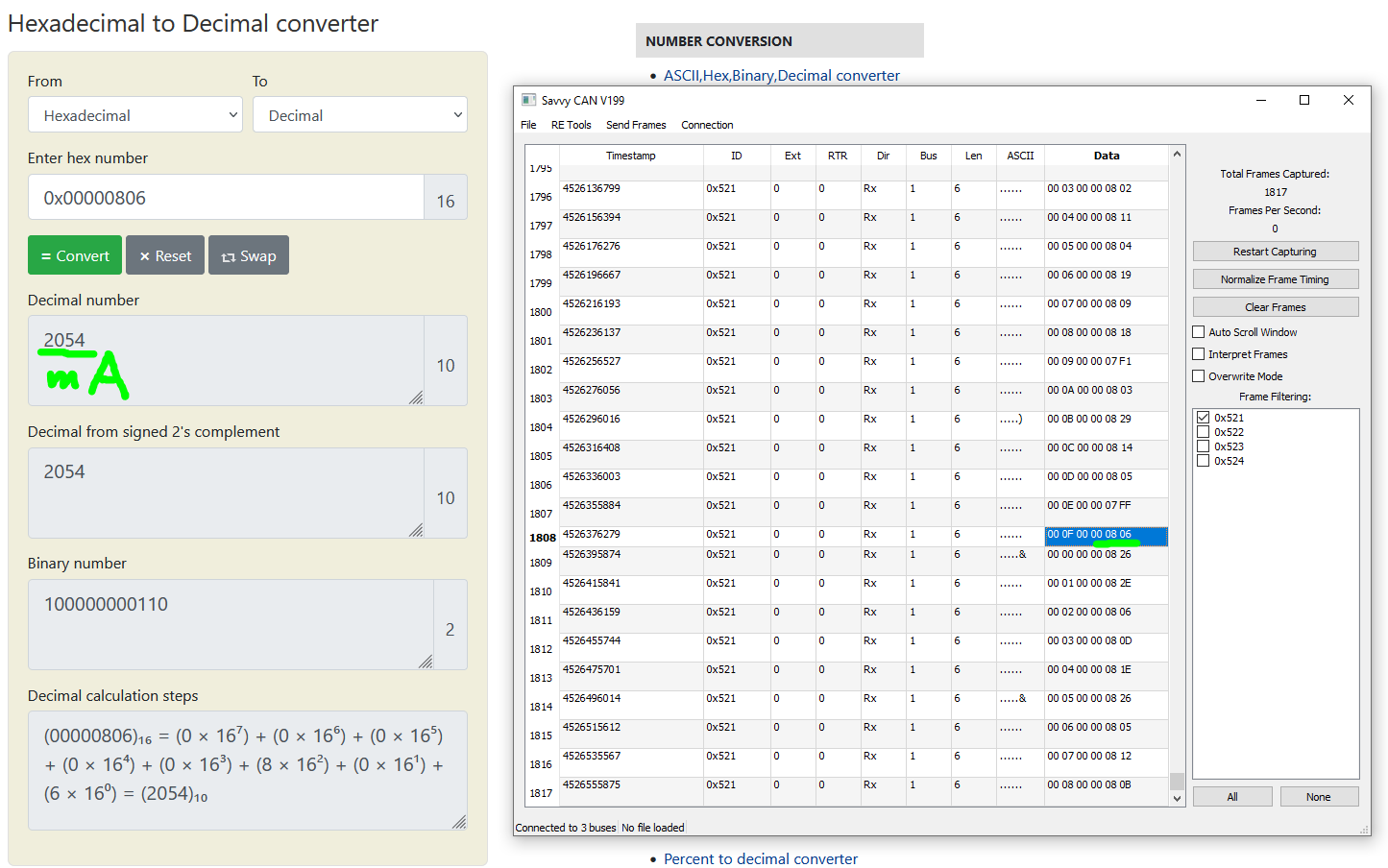

- Got a CAN capture from the ISA shunt. Test setup with a basic 12 V headlight:
- I tested my ISA shunt with it's stock settings. I guess the values are in hexadesimal. For example savvycan data for ID 0x521 (current) is "00 0F 00 00 08 06" = 0x00000806 = 2054 [mA] This at least corresponds to my lab PSU value when I dimmed the light.
https://www.rapidtables.com/convert/num ... cimal.html
So now I have a device (that needs to be placed in a casing with proper wiring) for CAN sniffing and proved that my ISA shunt (IVT-S-1K-U3-I-CAN1-12/24) works.
