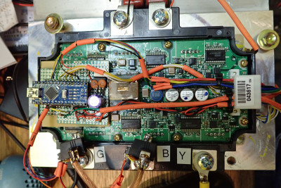

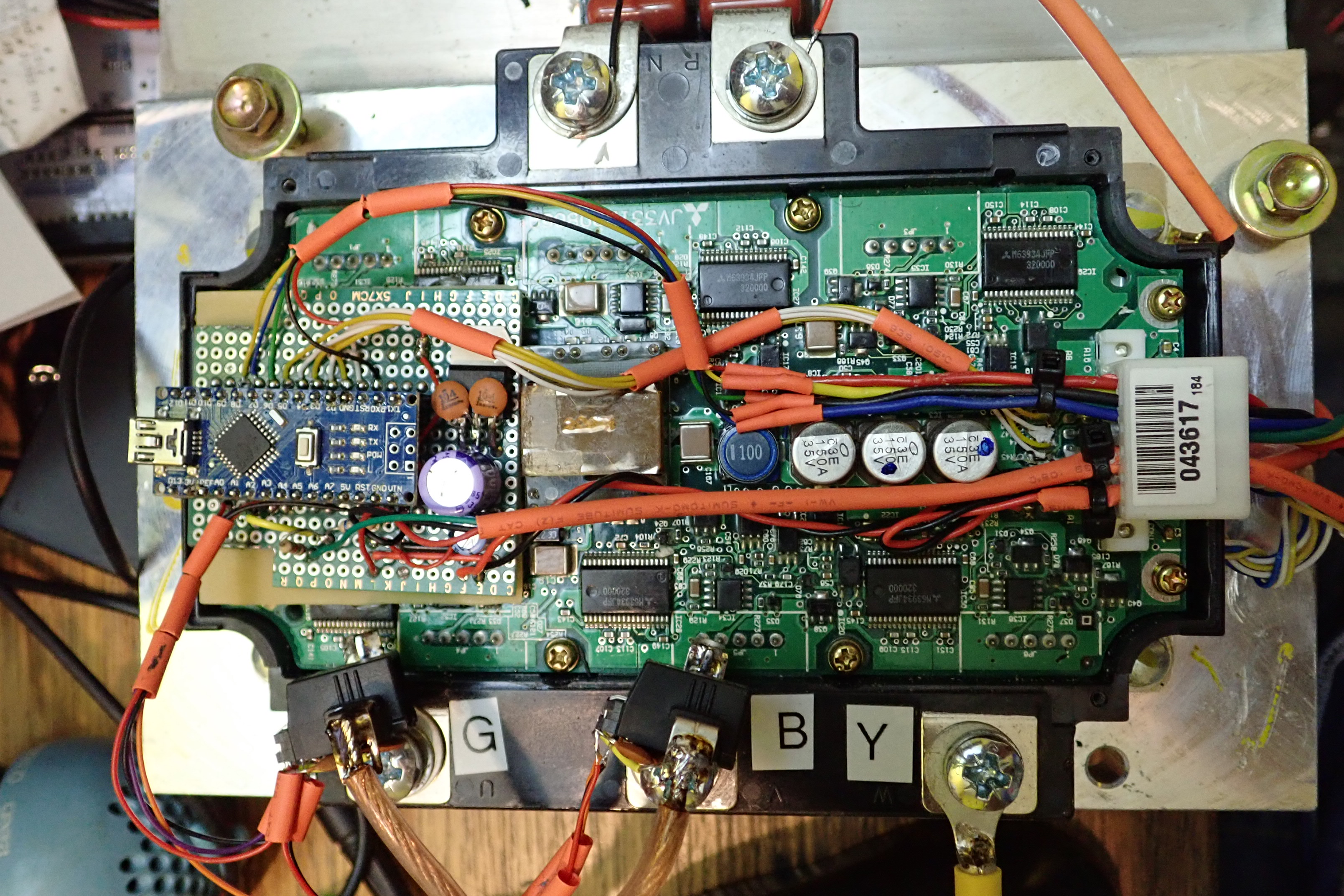

I lashed up some very very crude code on an arduino to get the project working enough for the camping weekend. I'll revisit it later on as it has no working phase current limiting, low voltage detection or anything fancy like that.

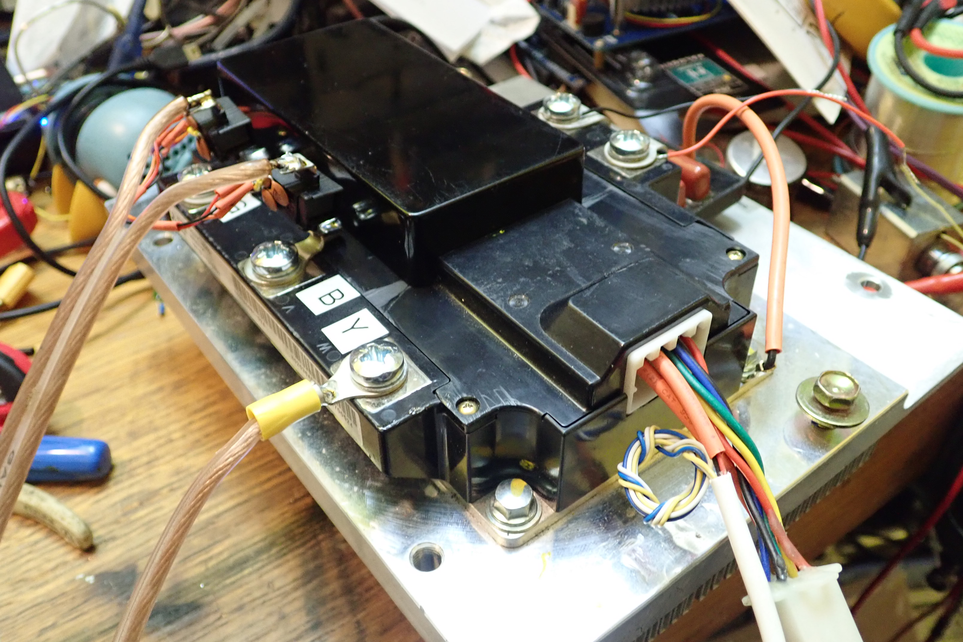

Honda IMA power IGBT module with Arduino lashup mod.
Ready to fit to the bike.

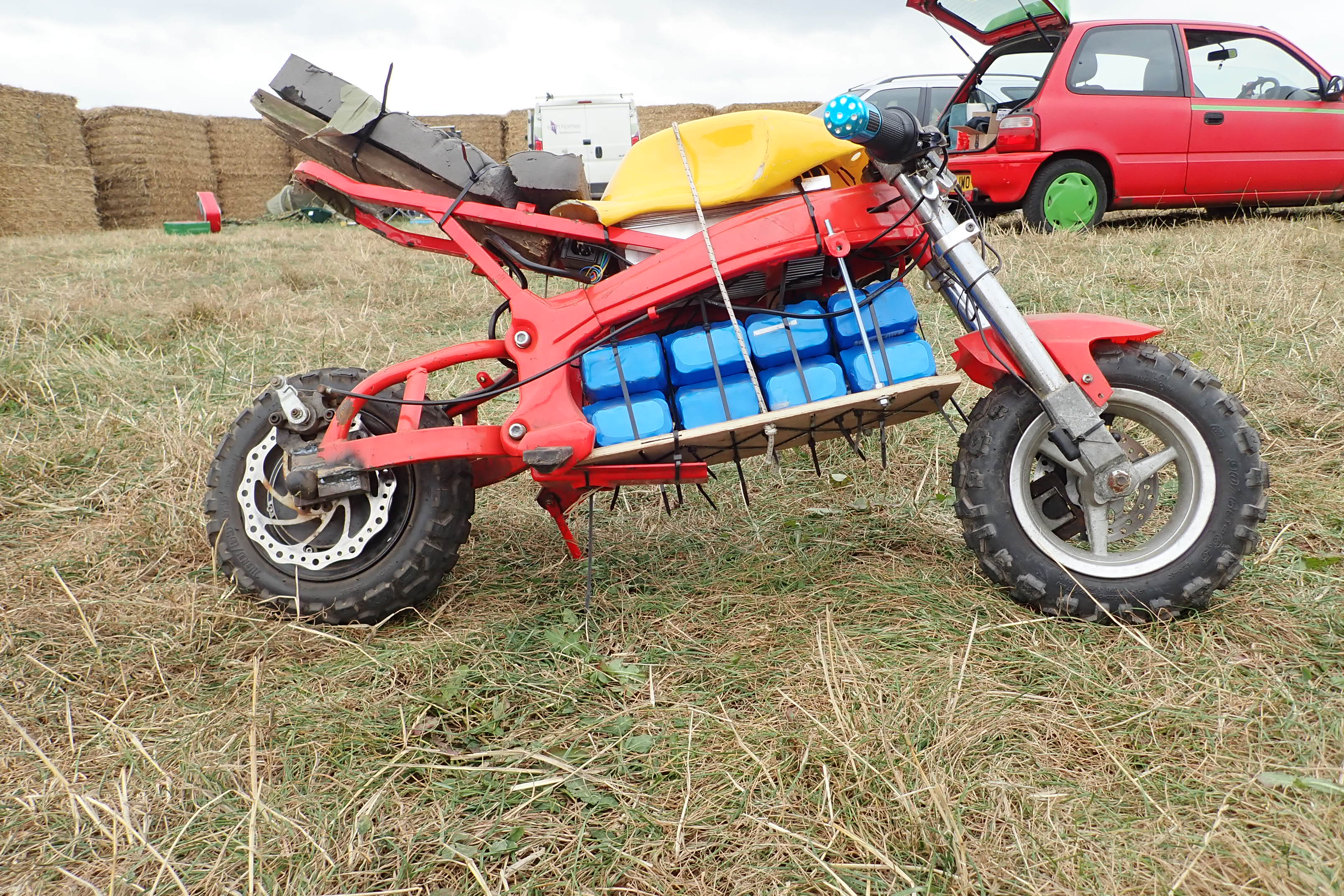

The field bike
A friend testing it out for me
60V 2800W hub wheel with a 10s 72V-84V battery pack made from Hoverboard packs and ovcourse the Honda IMA IGBT module rated at something like 300A
The motor was definitely being run over it's rated current.
The field bike
