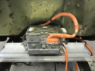

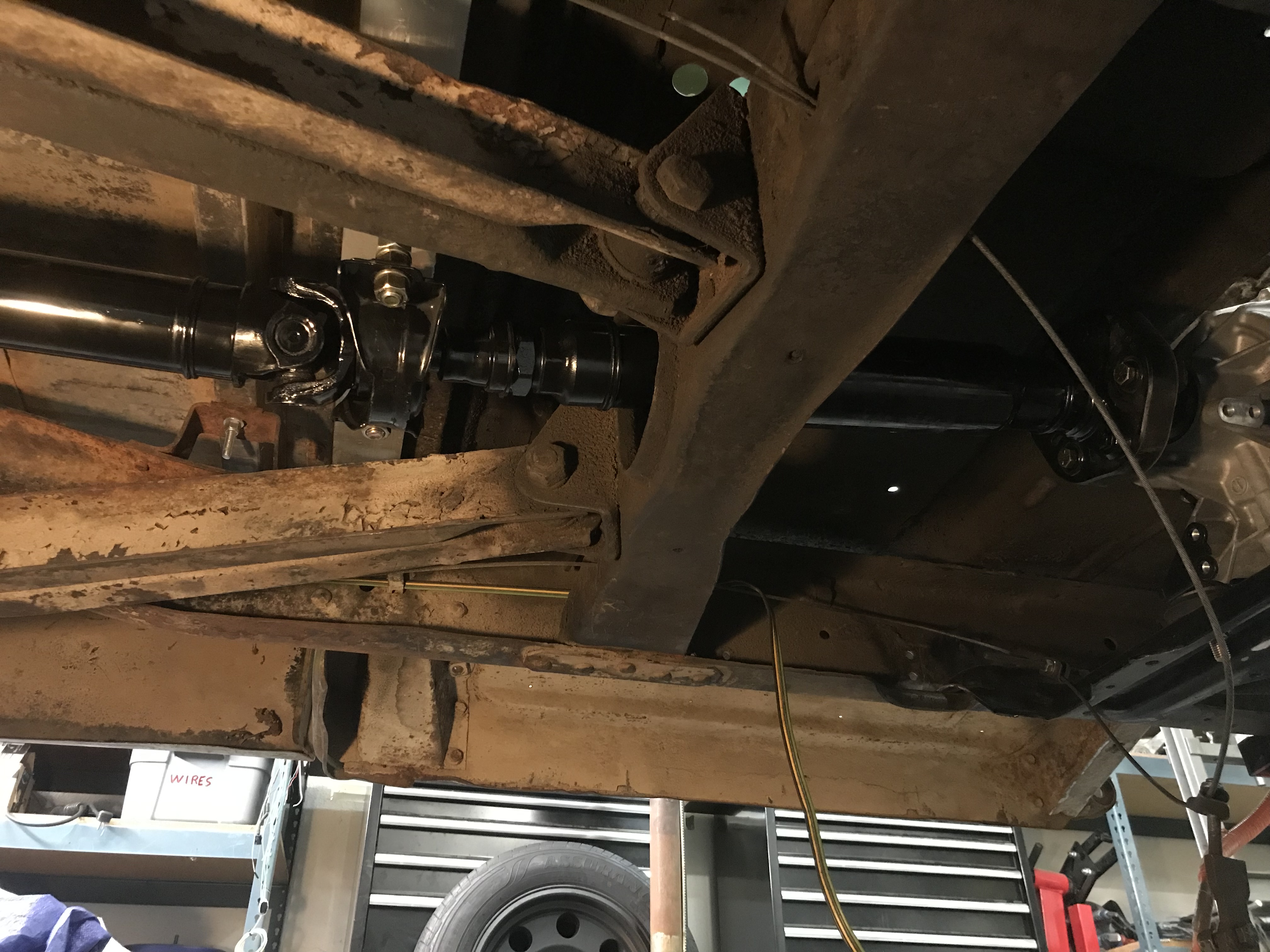

got Big Sexy back from the shop and popped it right in, fits like a glove

that's cute, but can you turn that box around so we can actually see what you are doing?

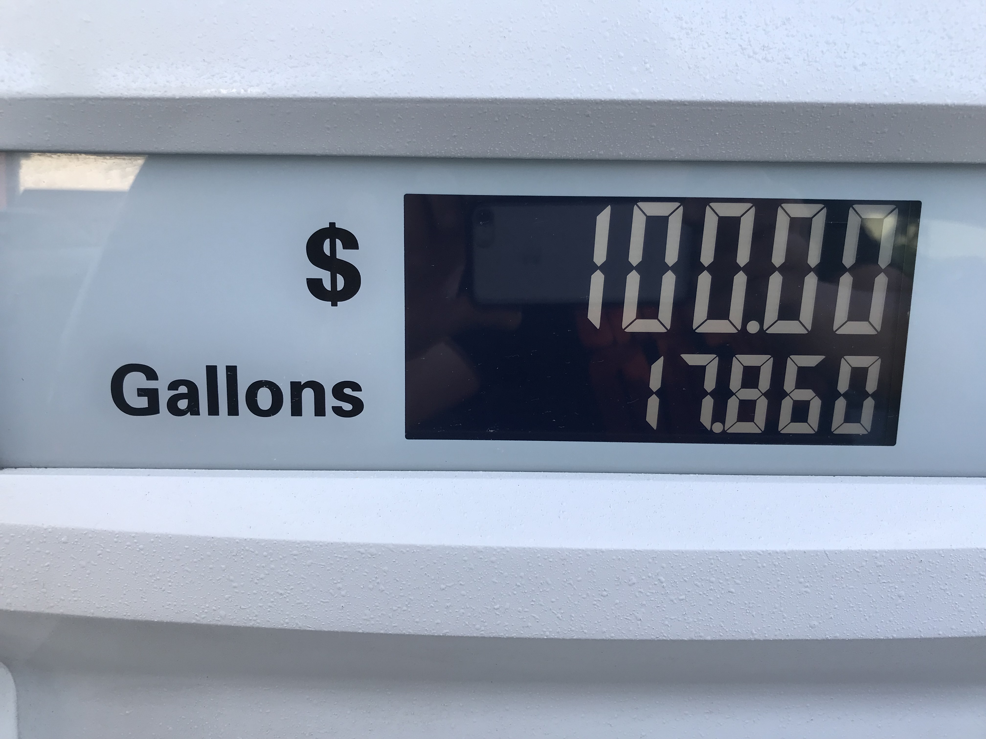

Why should you convert to electric? any questions, ha ha
and that was no where near fill up of the 21 gallon petrol tank
muehlpower
Posts: 807
Has thanked: 18 times
Been thanked: 188 times
Post by muehlpower »
If the fuel were so cheap here, I would continue to drive with petrol. We get 12 gallons for $100!

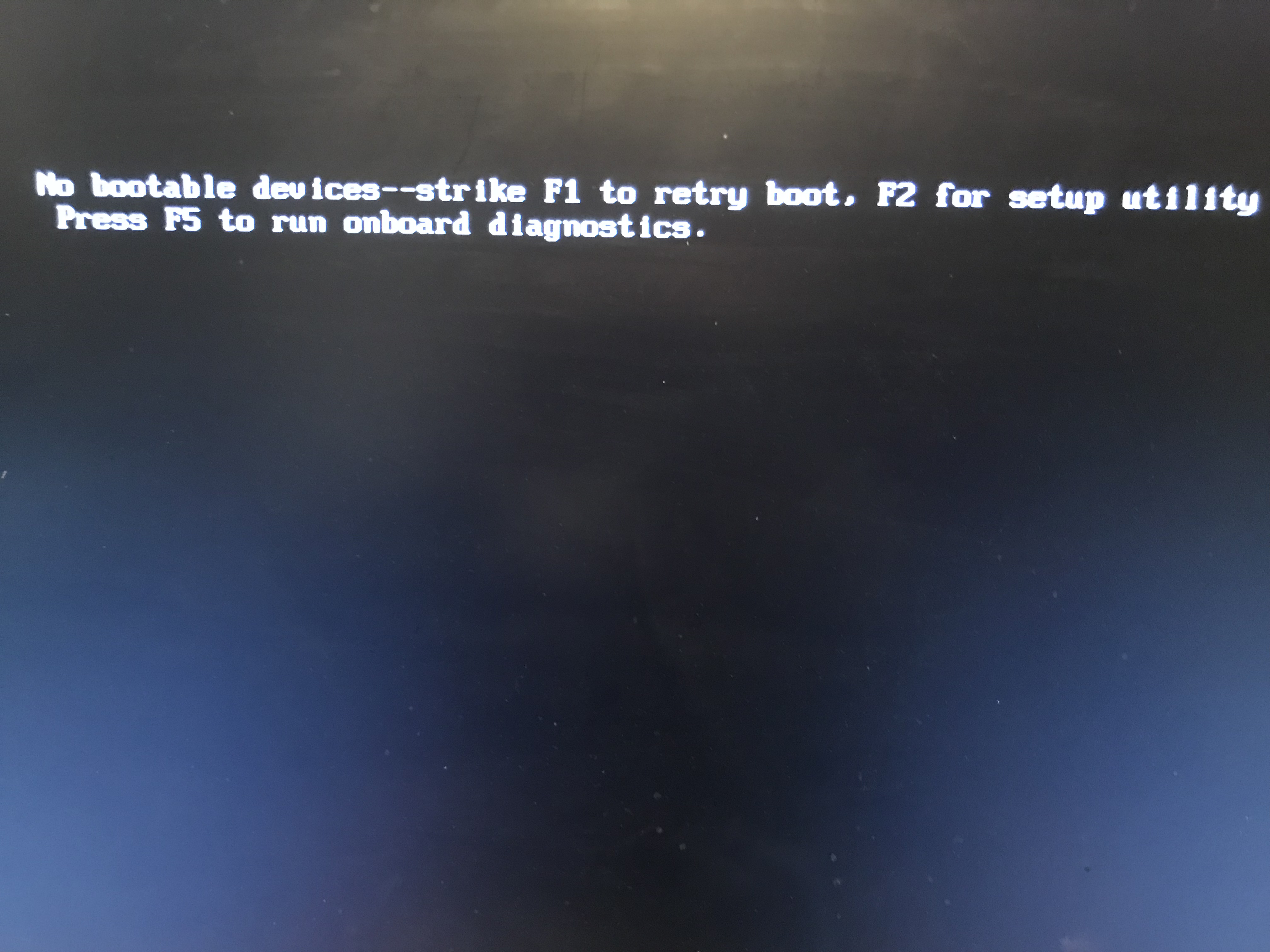

Post by Gregski »

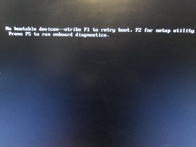

this morning I was greeted by this dreaded hard drive failure on my primary home computer where I keep all my EV Conversion pics and documentation
the Intel SSD 535 Series hard drive just failed
480 GB Solid State Drive
I'm an IT guy but this sucks ballz! I tried to tether it to a working laptop as an external drive but it won't even power up
midway
Posts: 100
Location: Ural
Has thanked: 15 times
Been thanked: 16 times
Post by midway »
Never store important information on the SSD, quite often they fail beyond recovery. You can look at the manufacturer's website for recovery utilities, or contact Intel technical support.

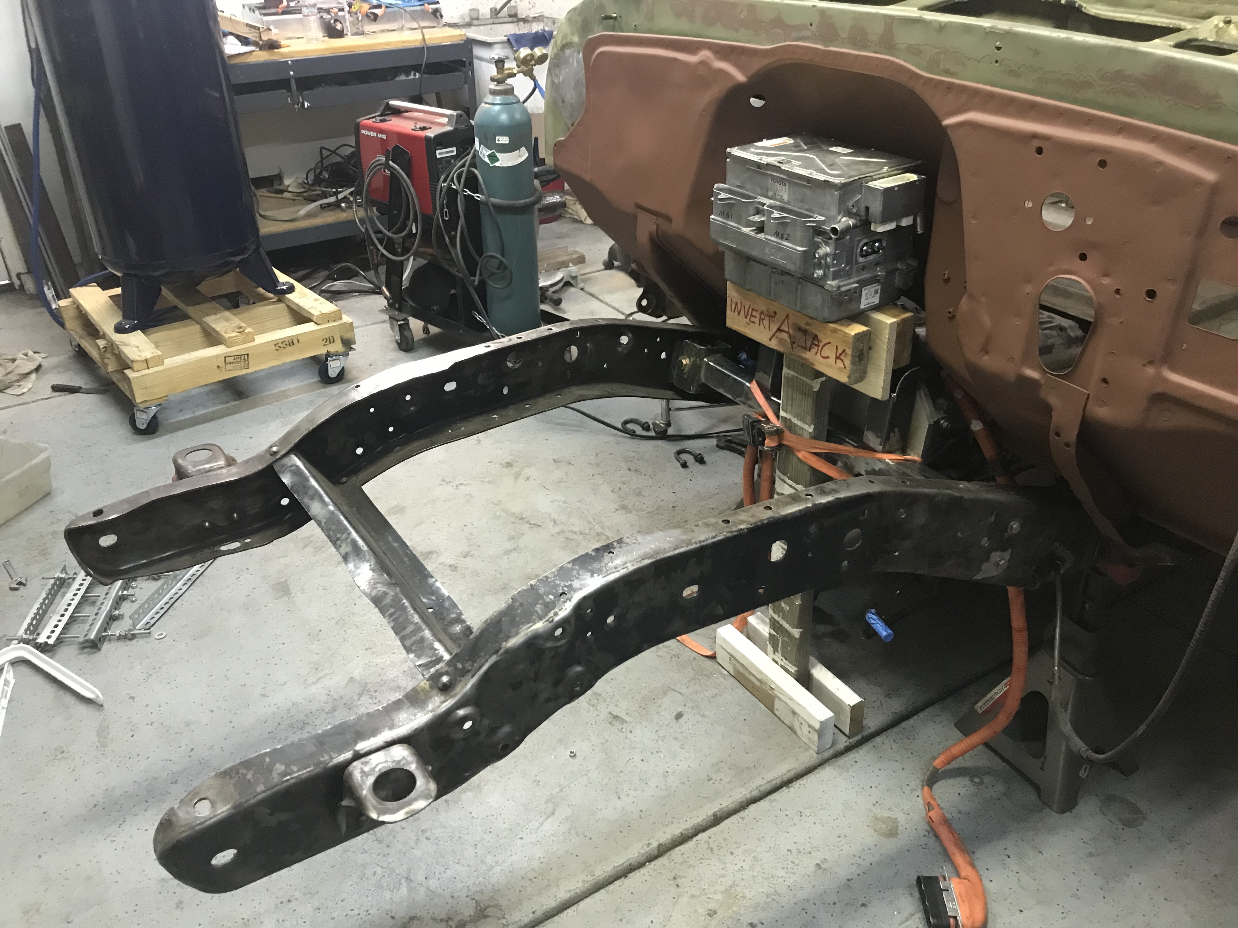

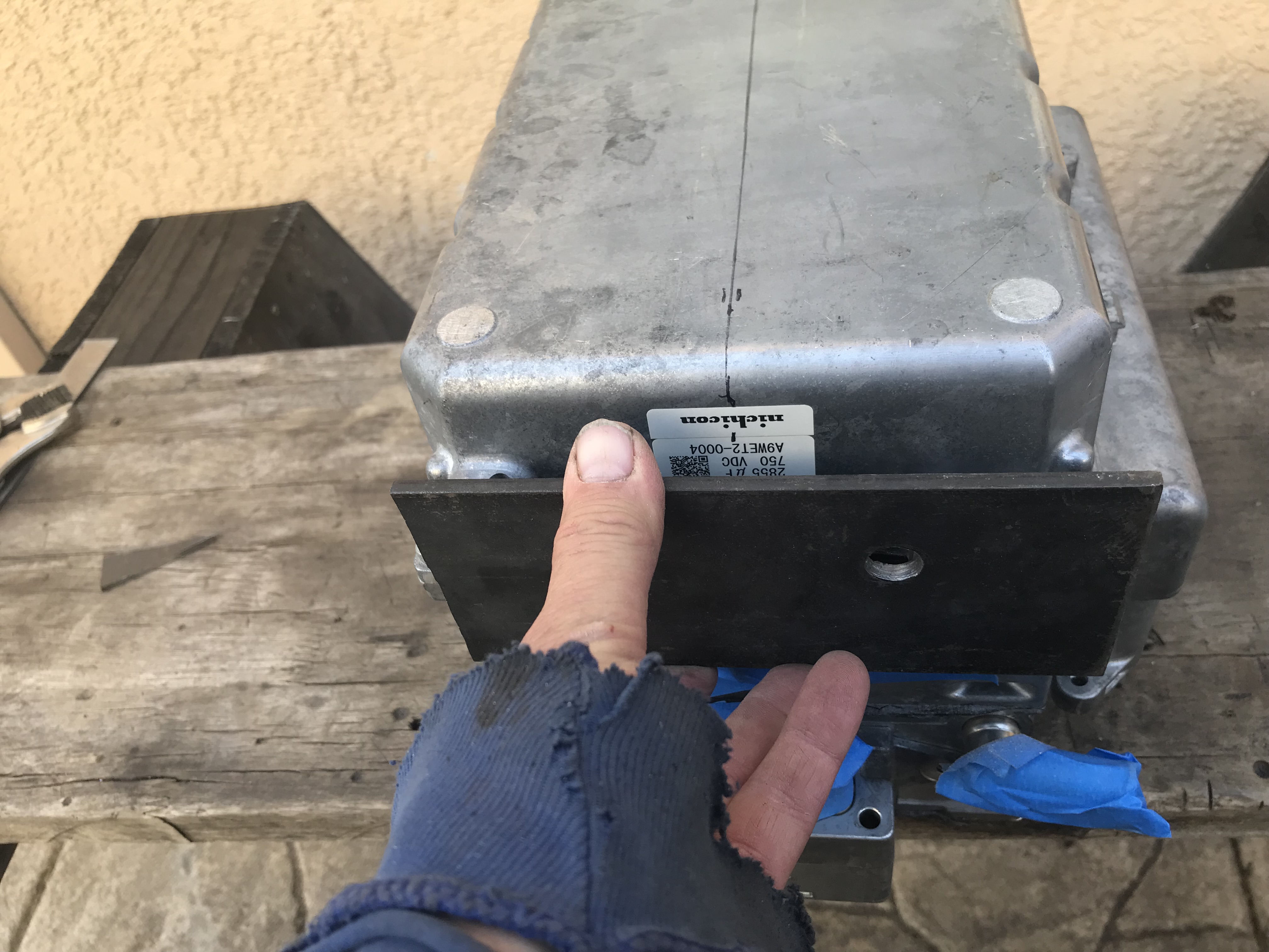

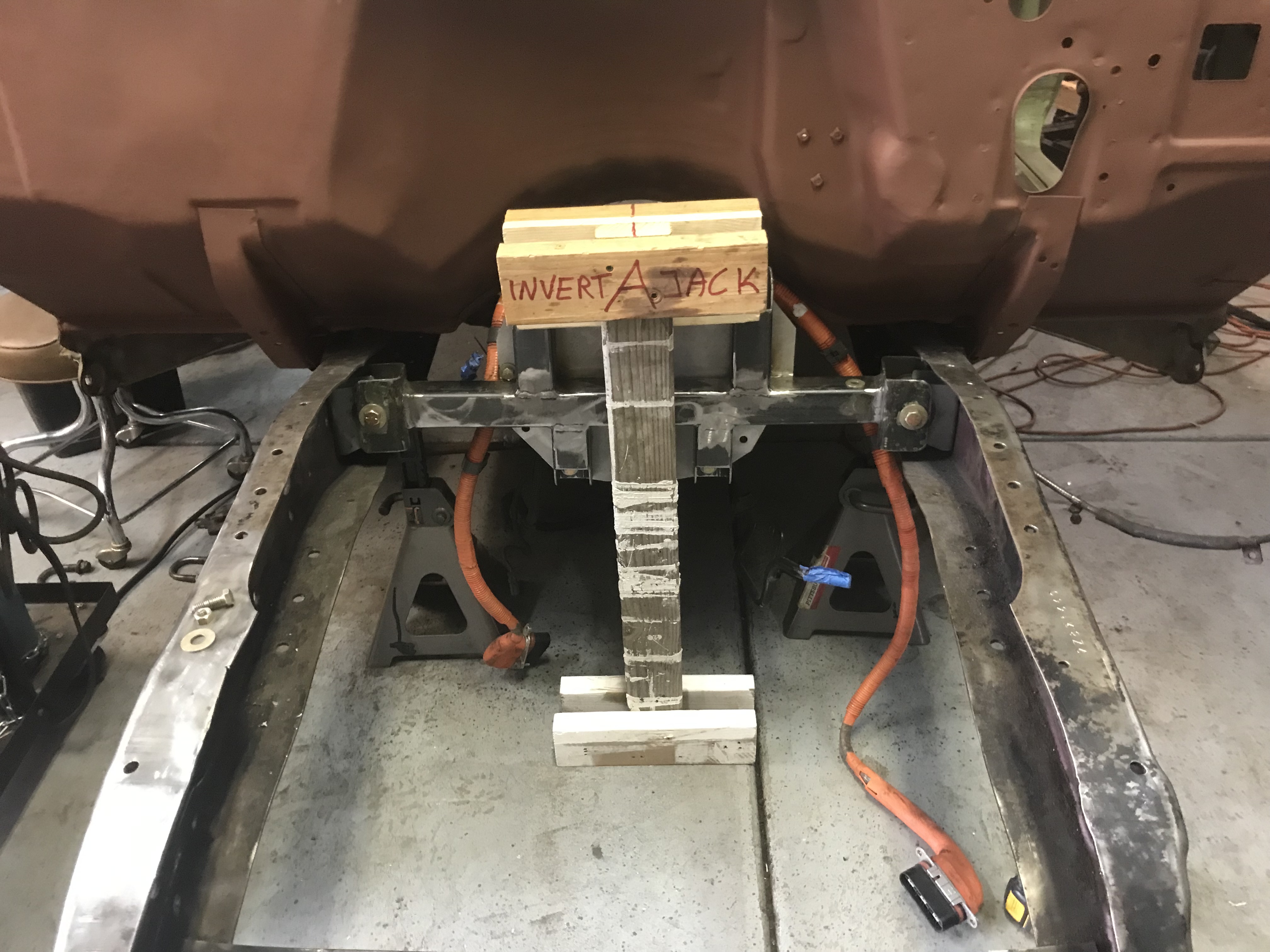

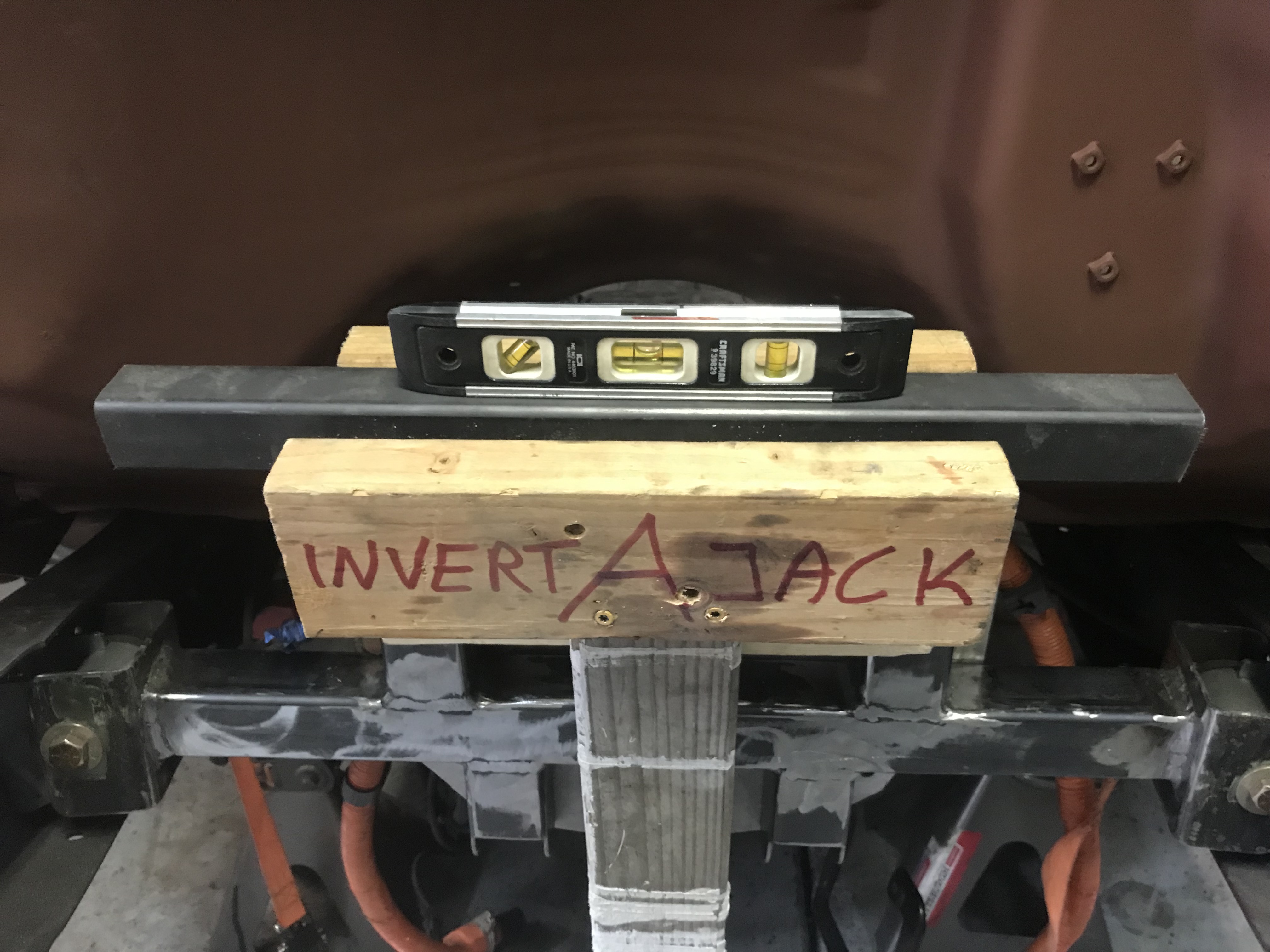

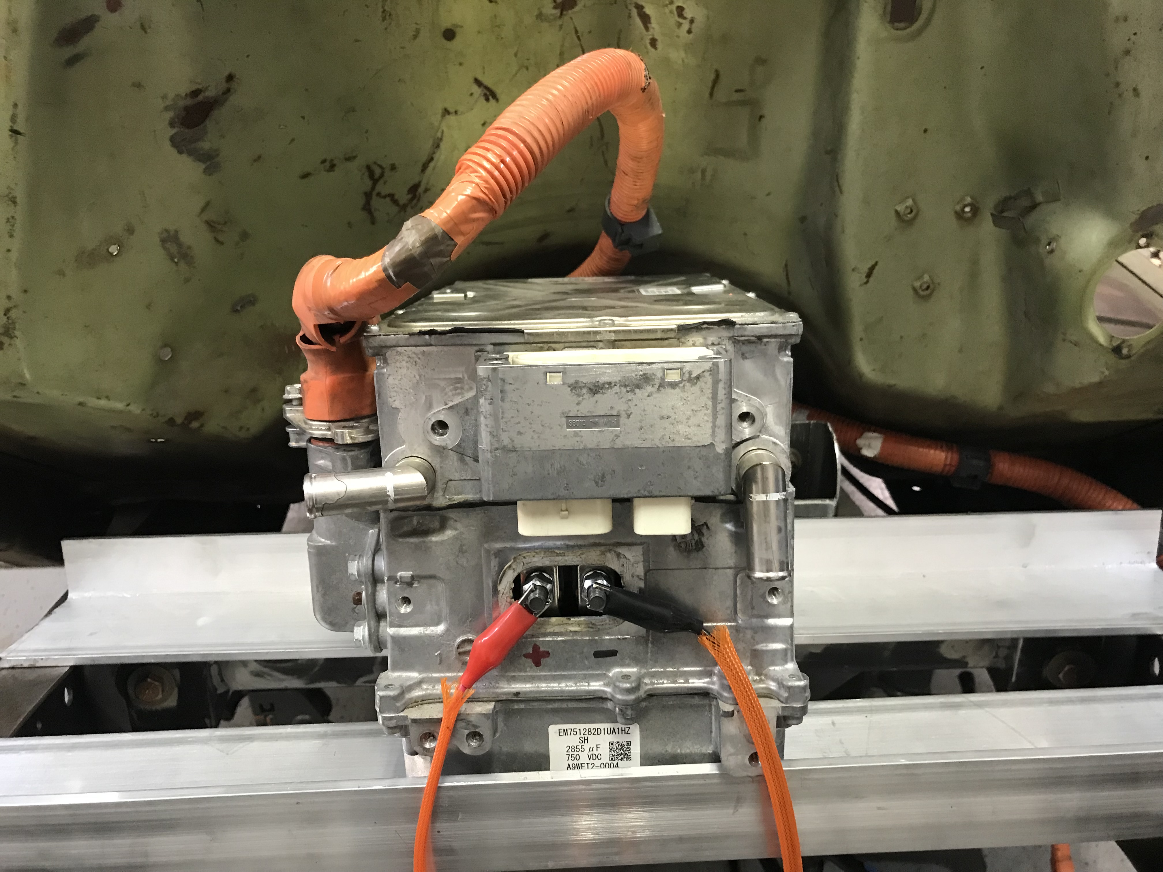

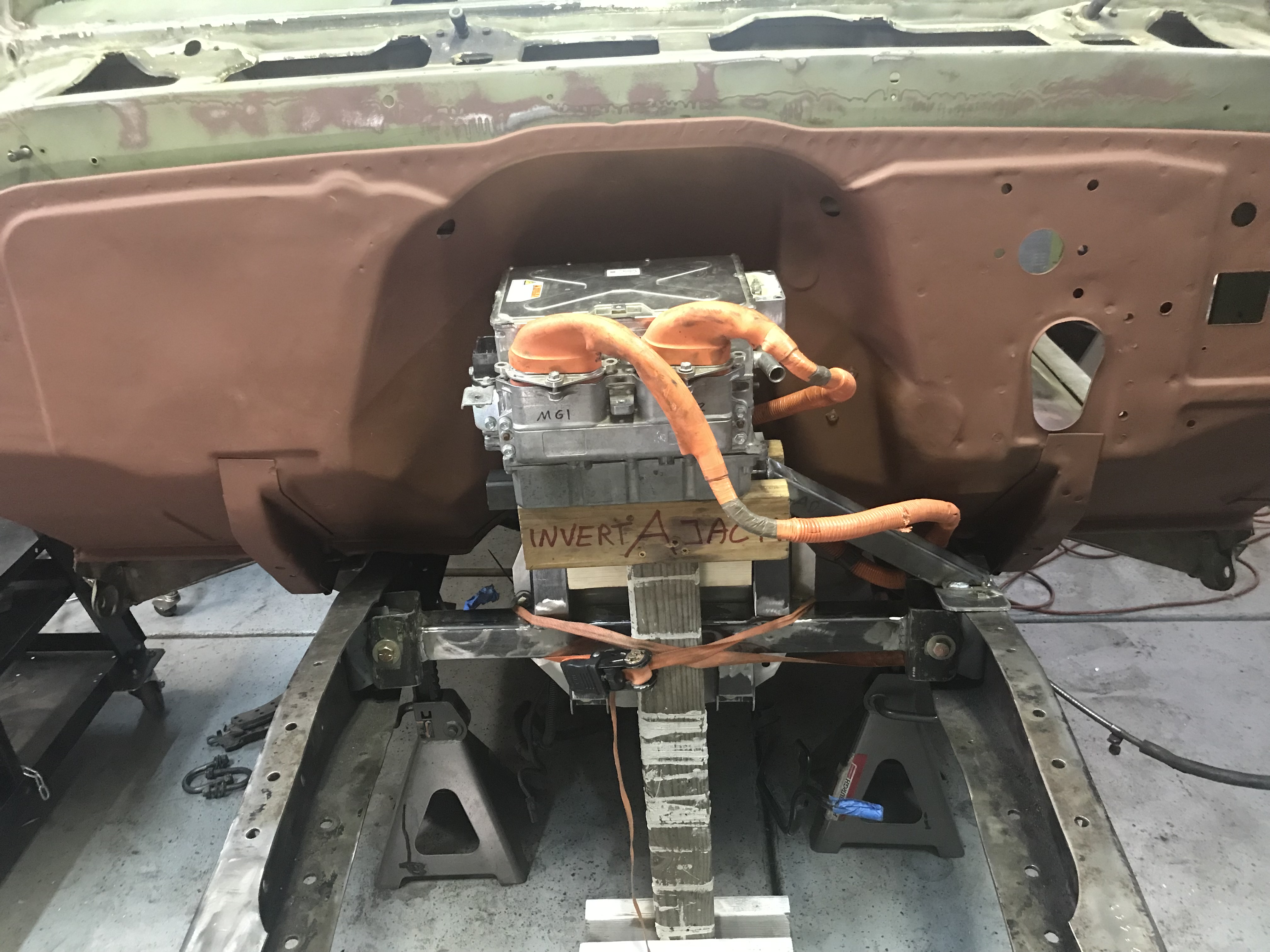

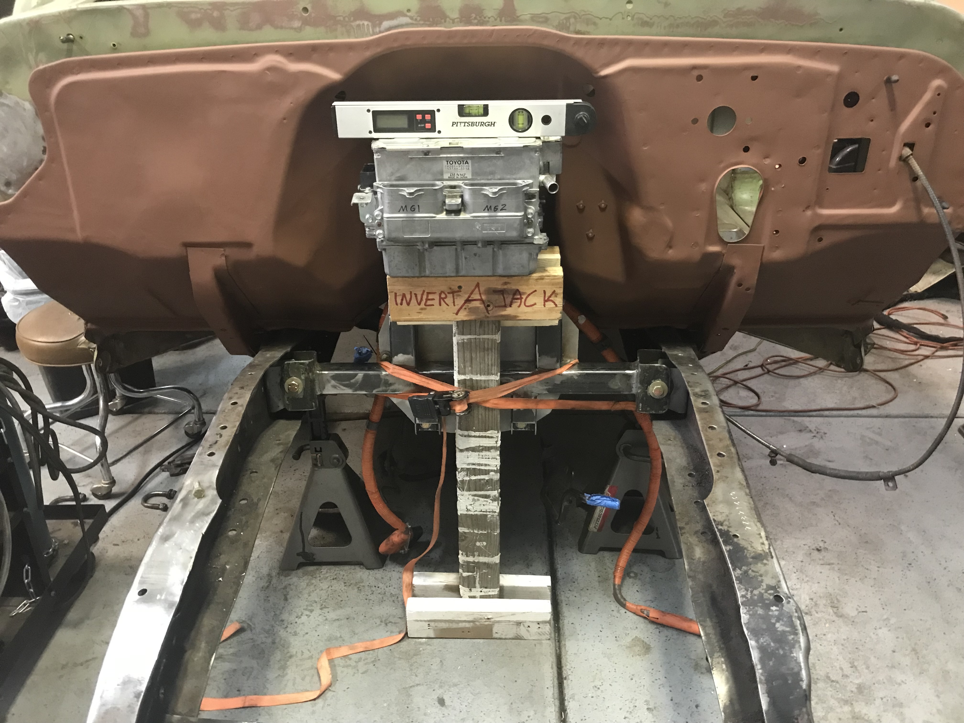

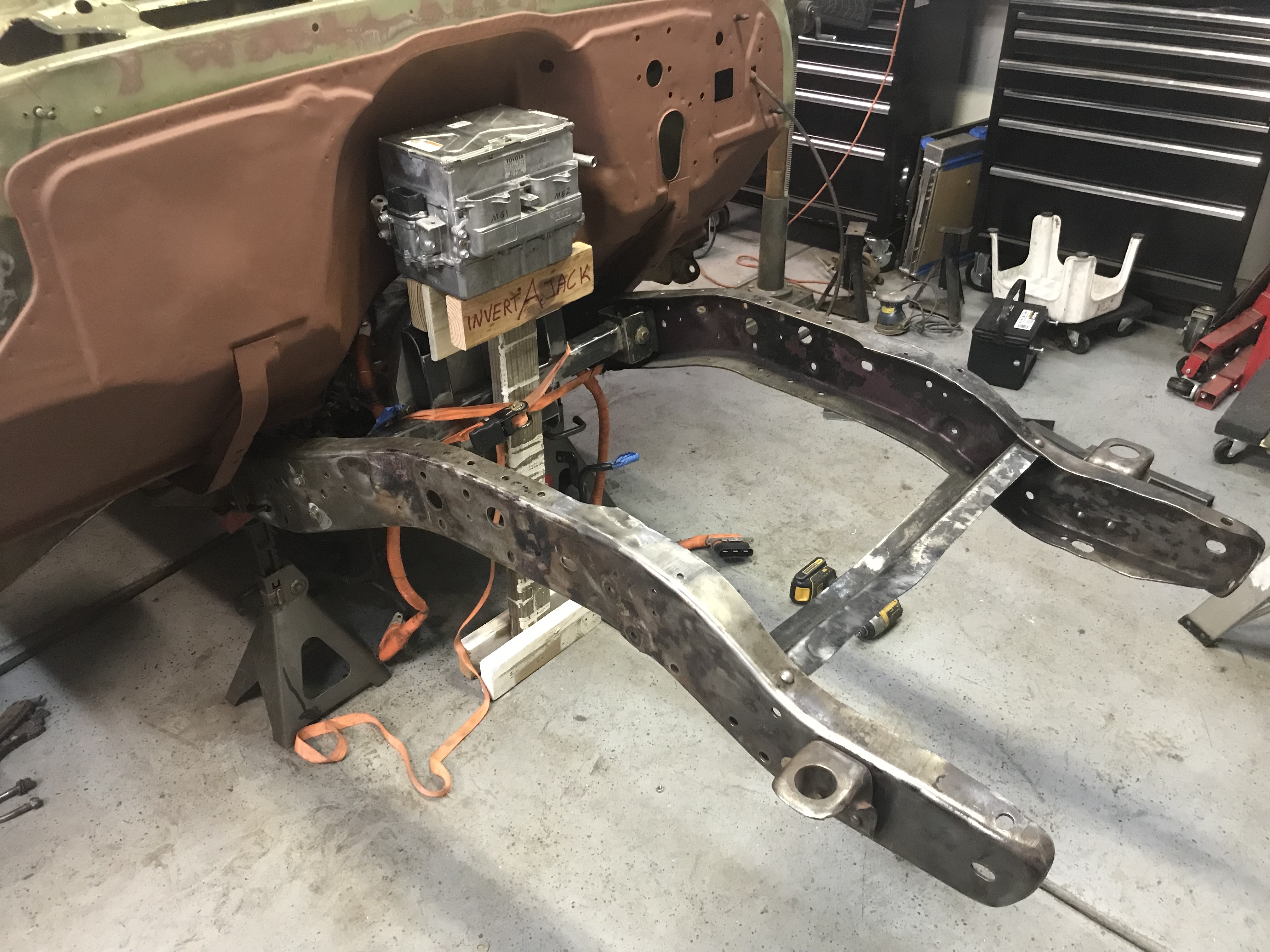

ladies and gentlemen I give you the self leveling Inver-A-Jack ... now available in rustic white
Gregski
Posts: 3164
Has thanked: 633 times
Been thanked: 1610 times

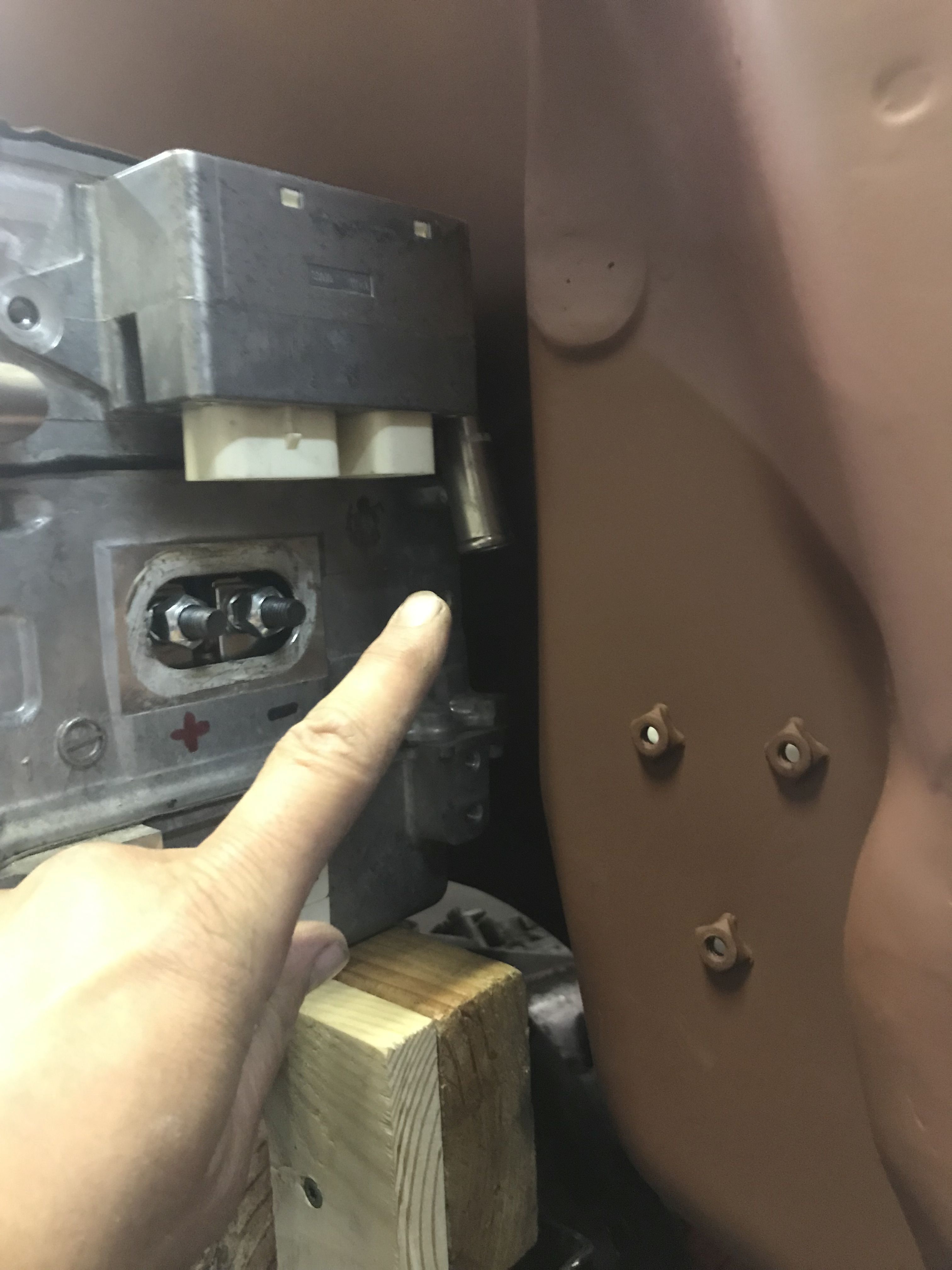

Post by Gregski »
naturally the exhaust nipple and the firewall bulge won't allow us to set it on center, I won't tell Johannes if you don't

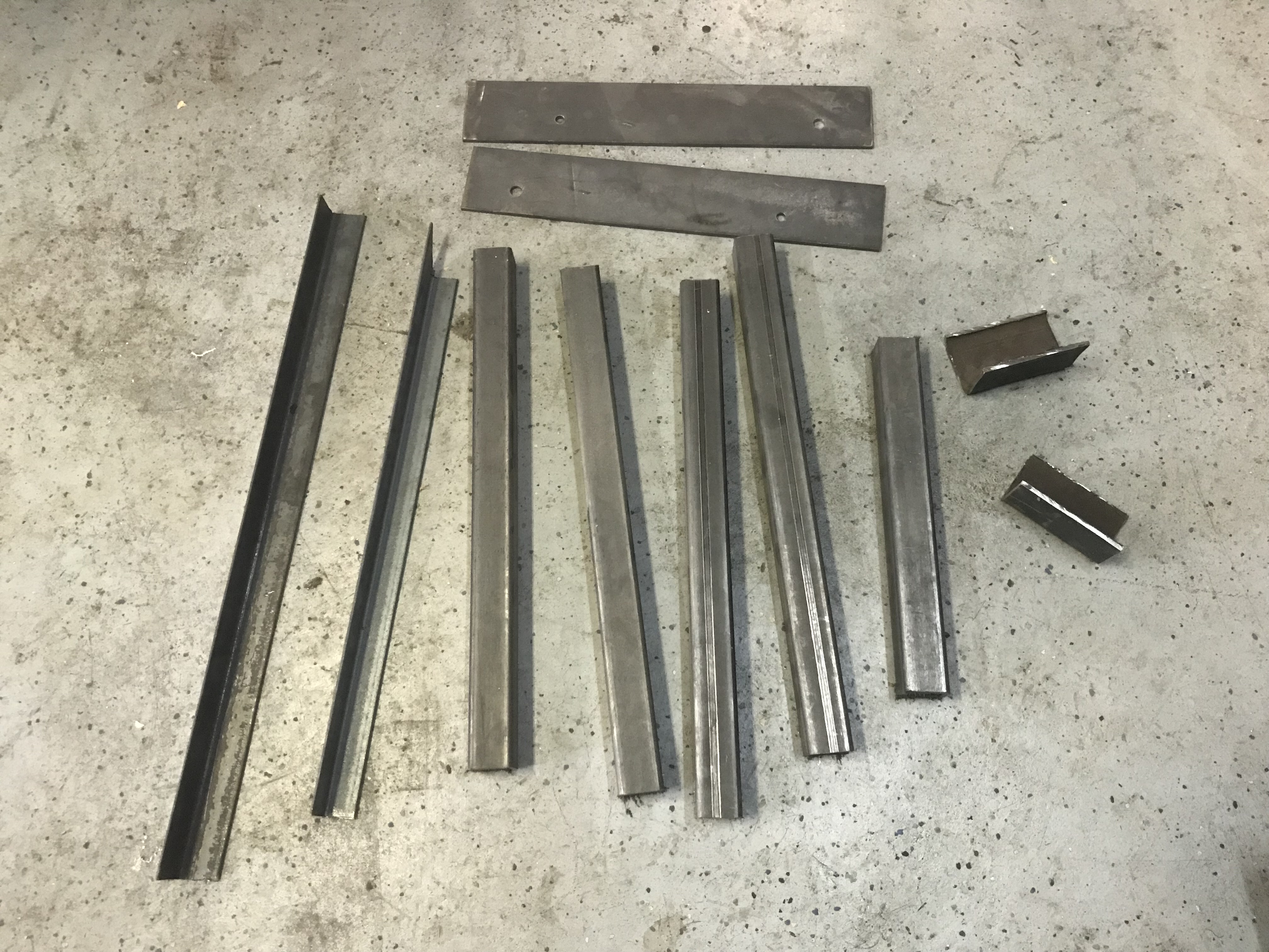

Me: for this project I will only use the strongest and lightest of metals, preferably unobtanium or at the very least aluminum
also Me: let's just check the scrap pile first

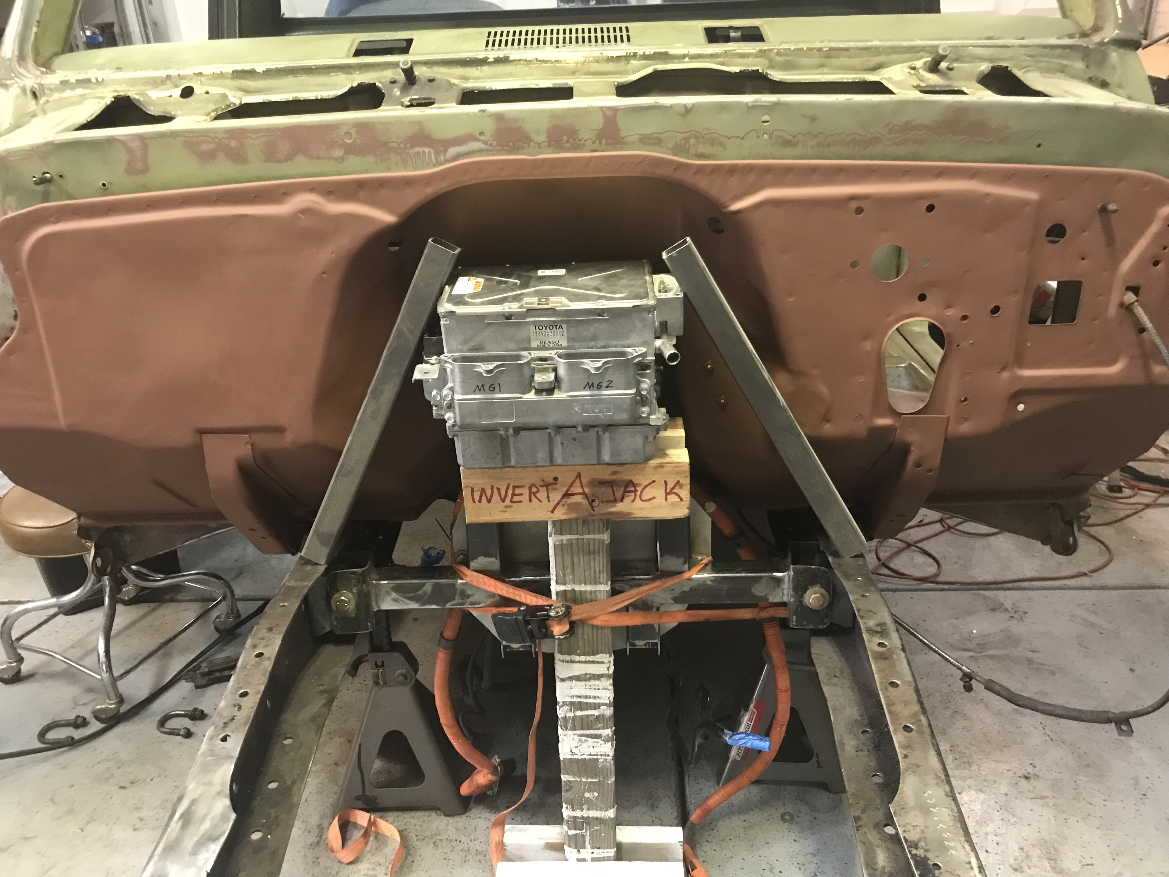

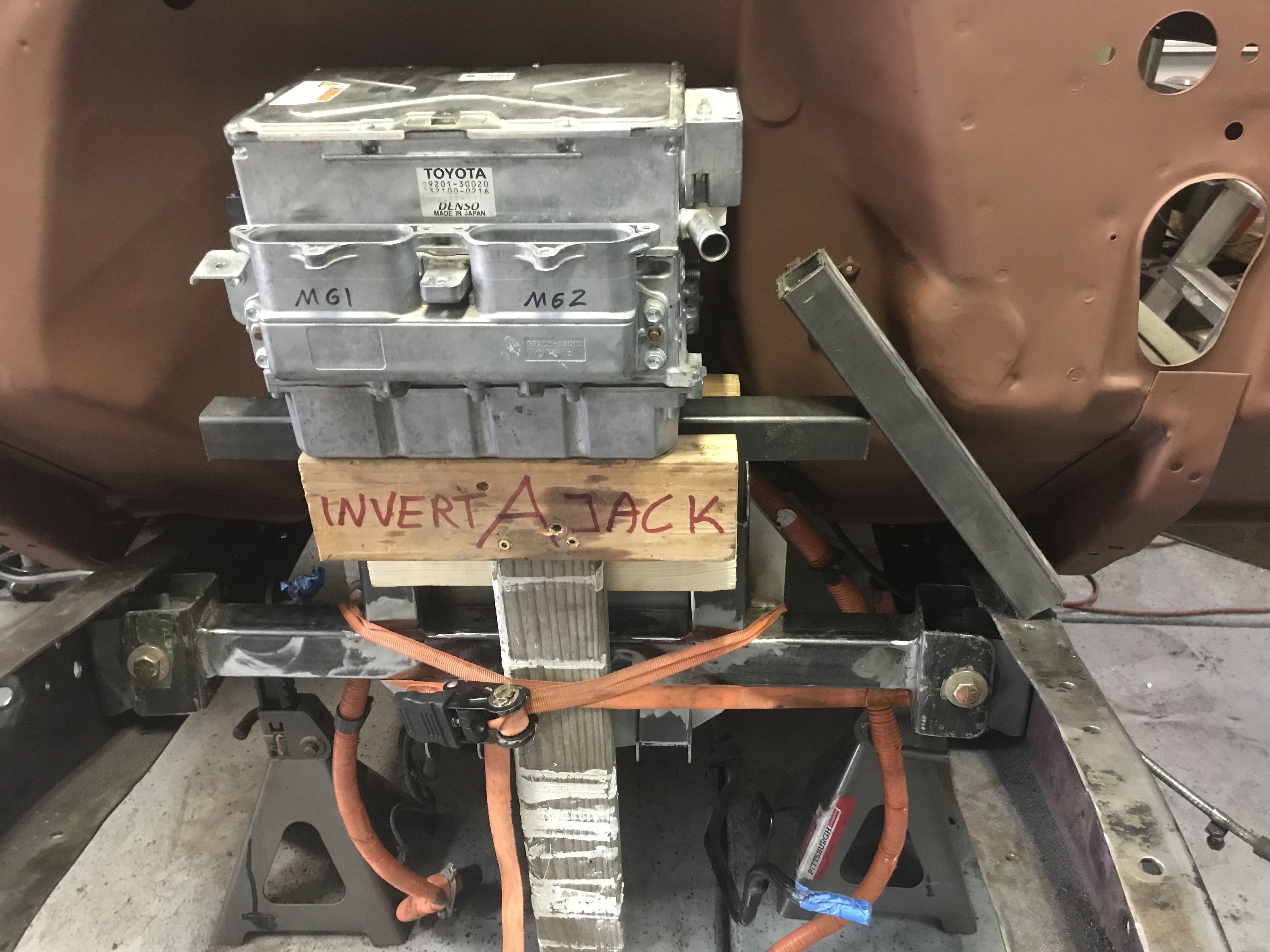

Post by Gregski »

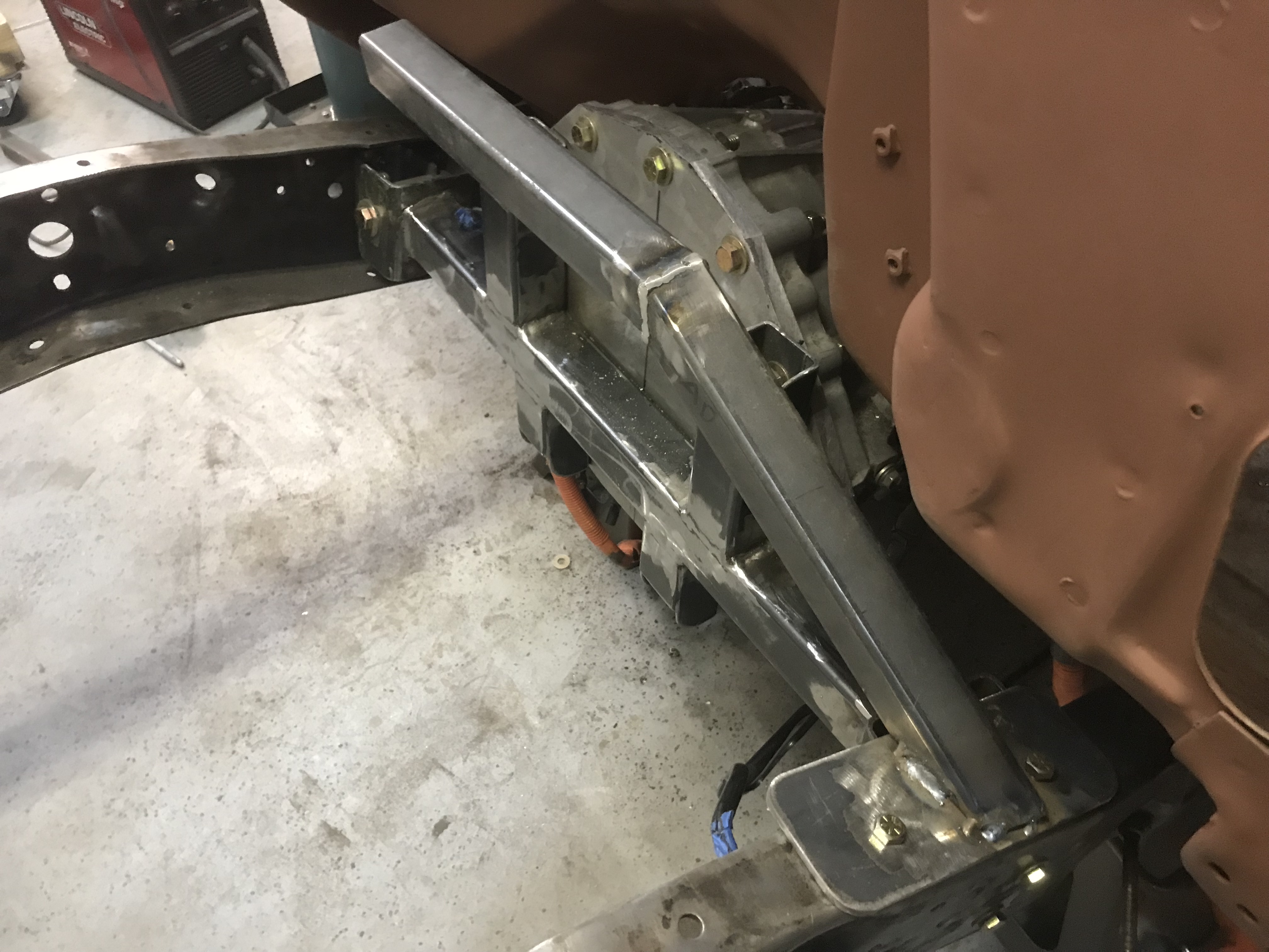

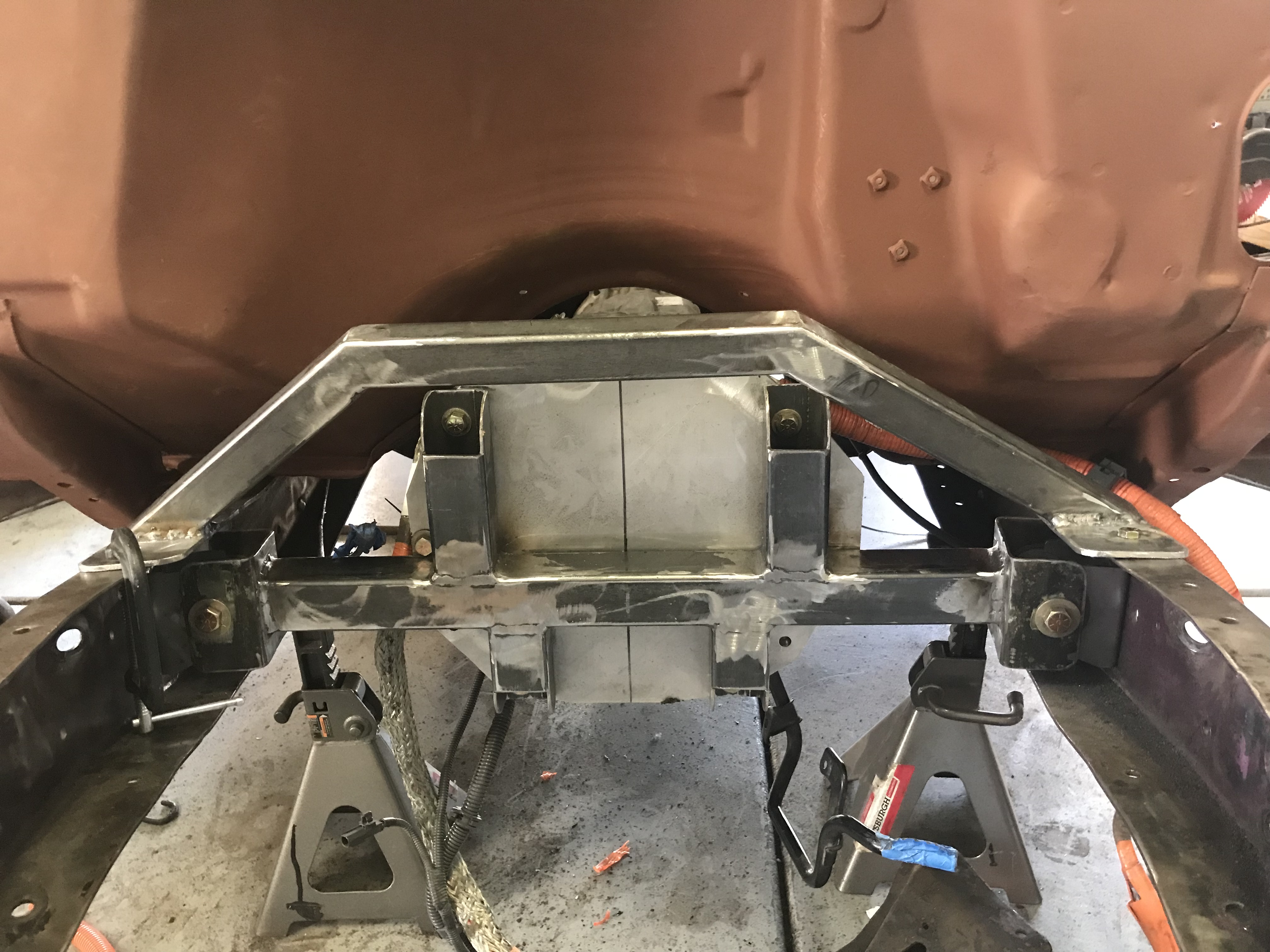

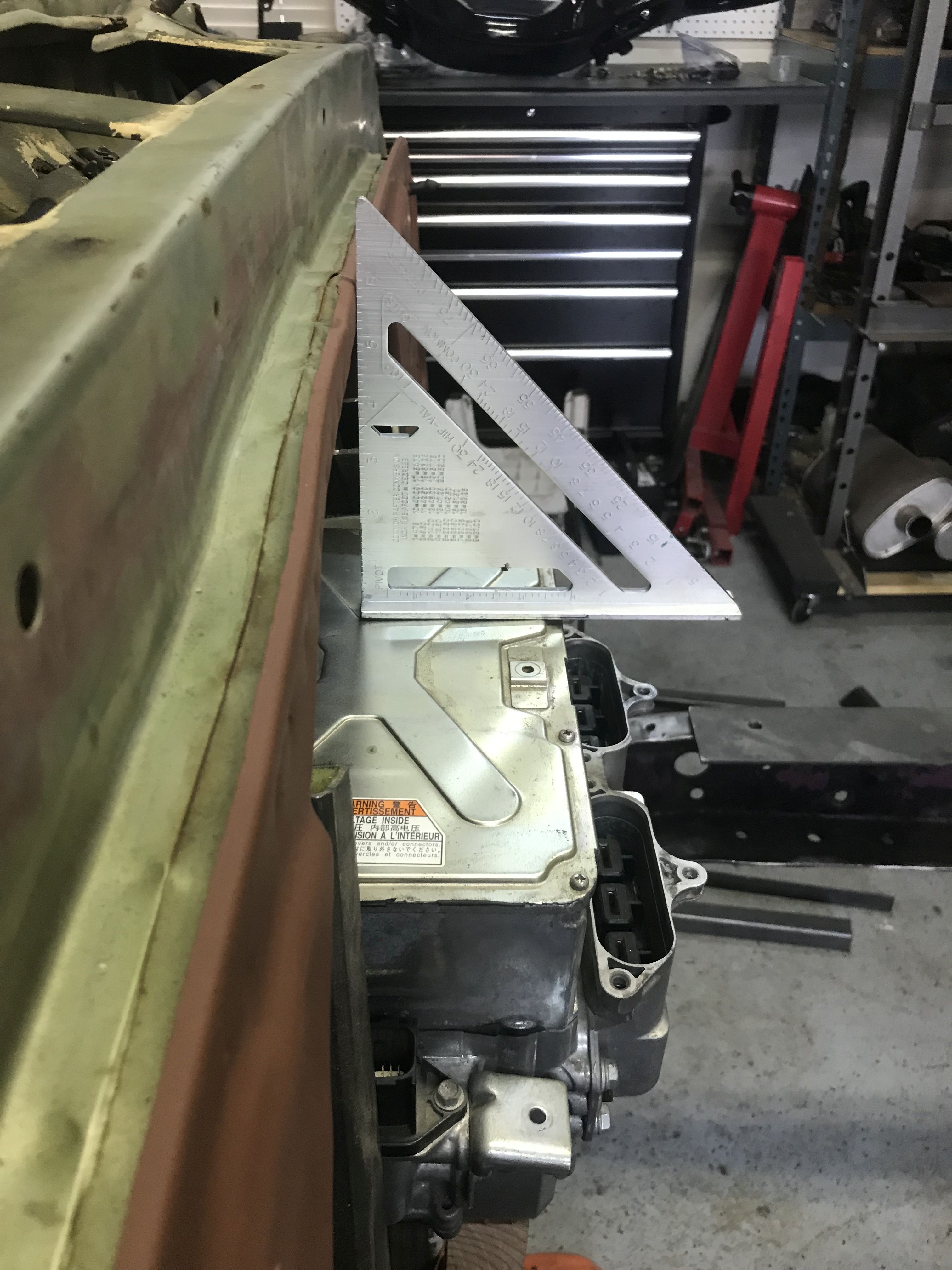

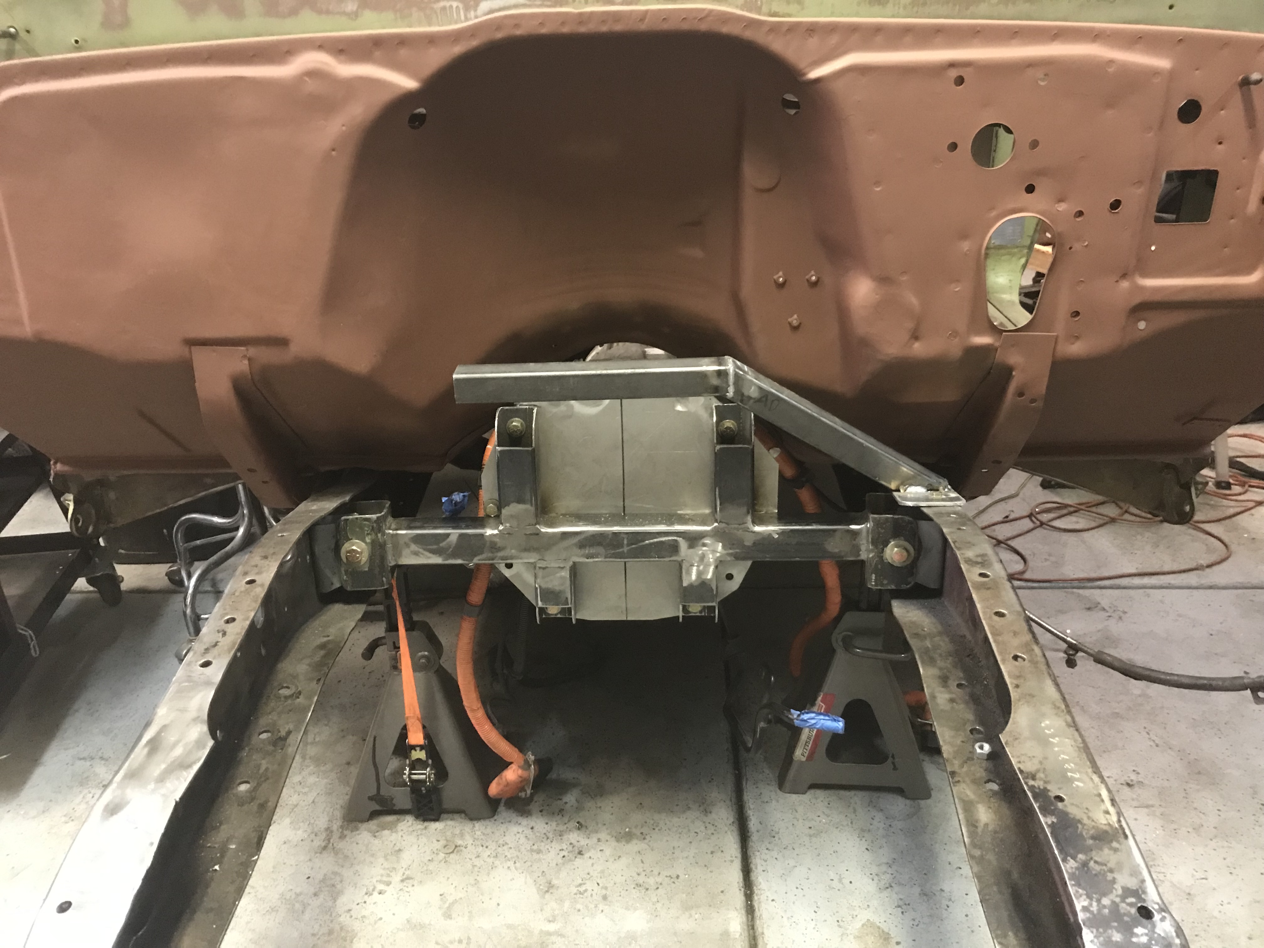

so some ideas taking shape
I call it the Tee Pee design
just checking the Stick Outability
if you tilt your head just right, it's perfectly level

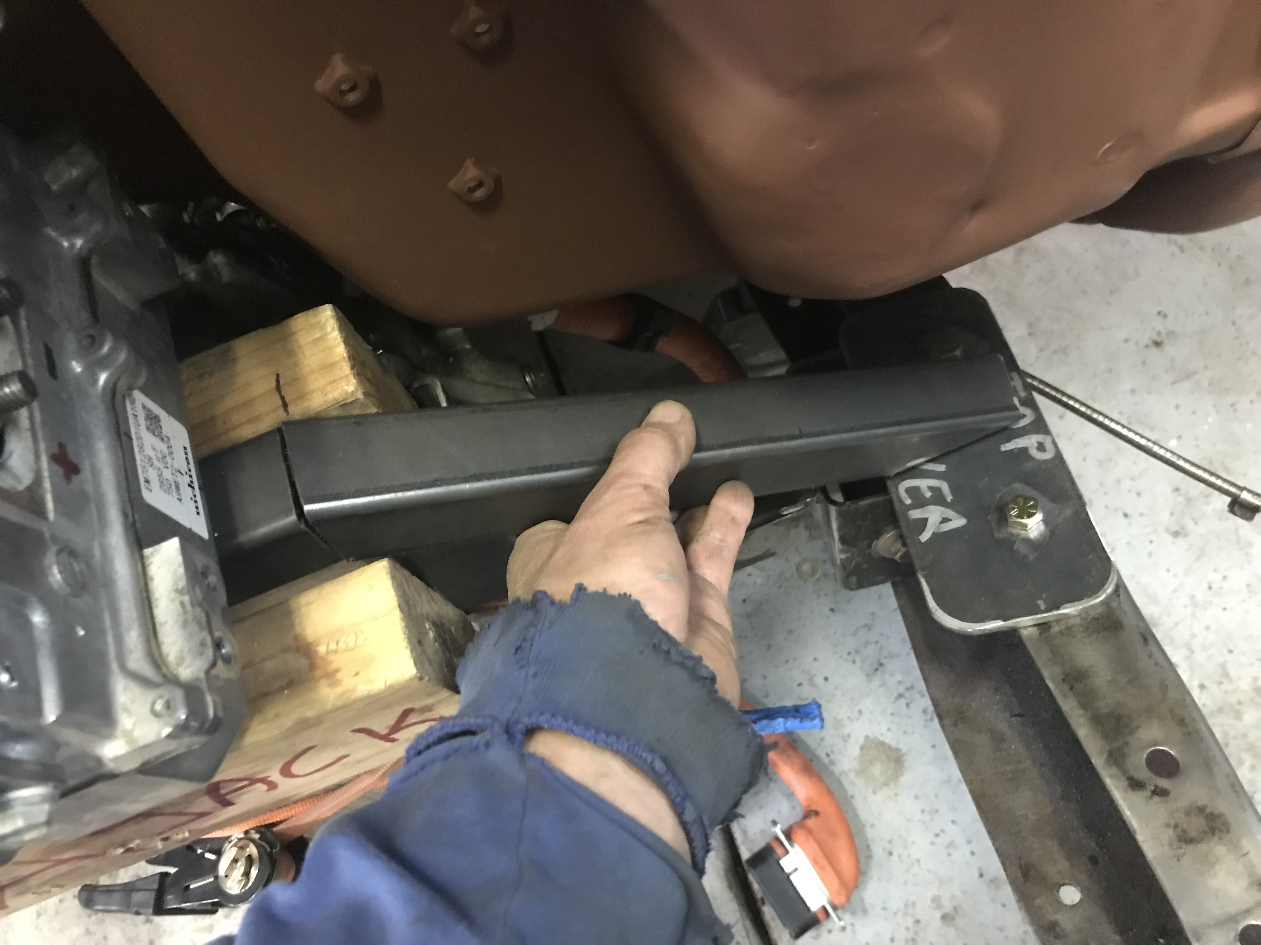

Post by Gregski »

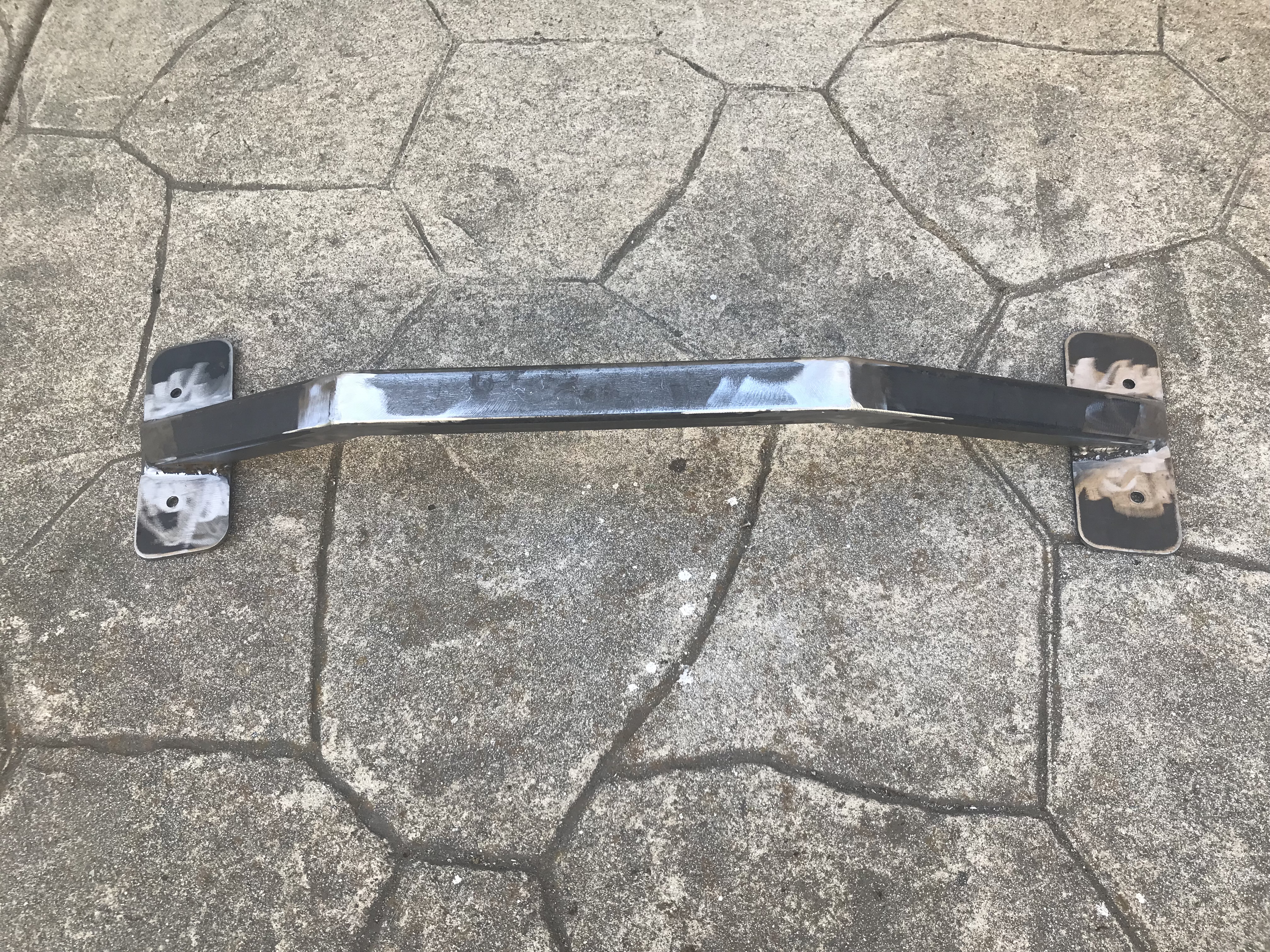

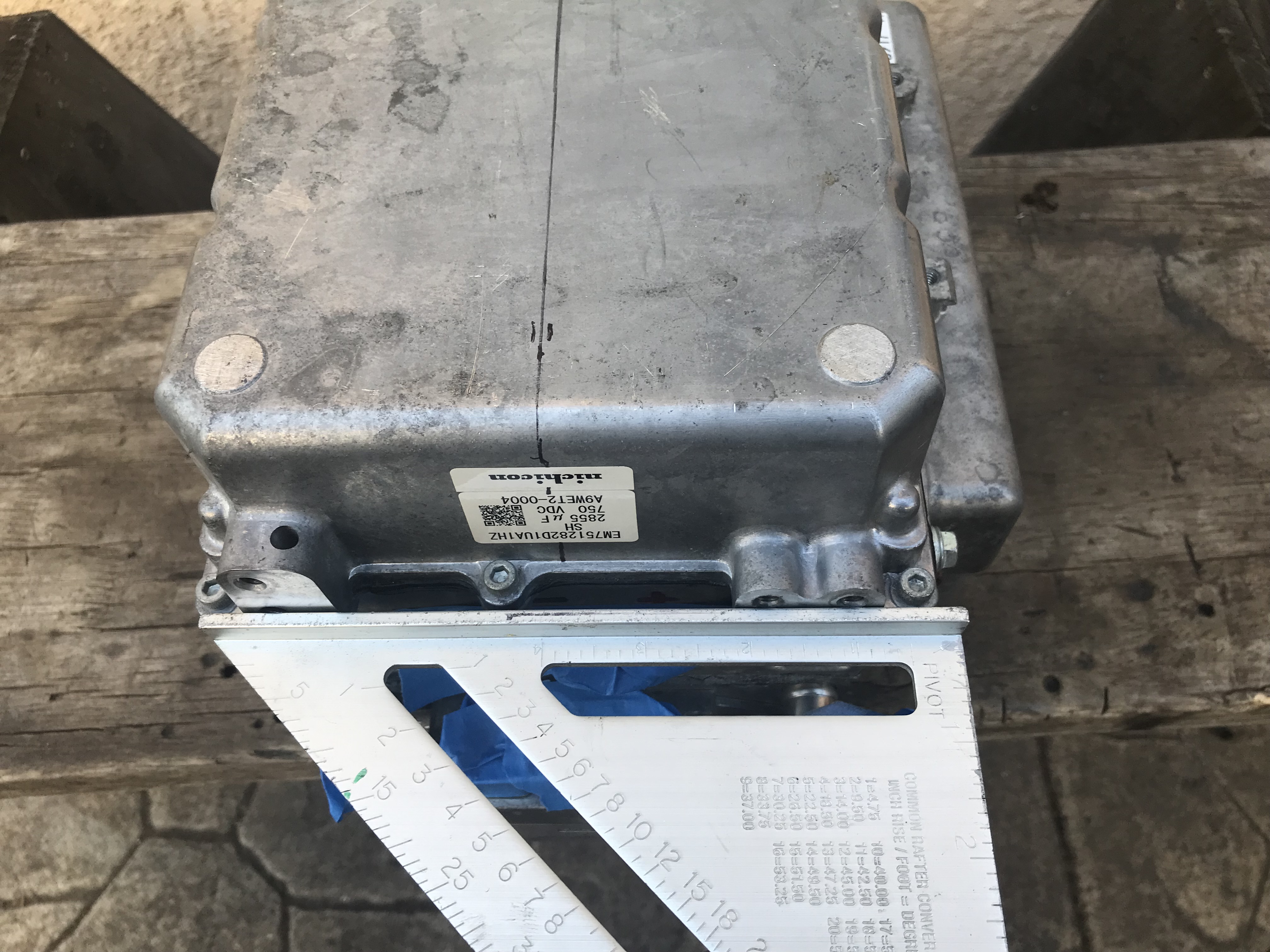

side bracketry
something like this, I guess

Post by Gregski »

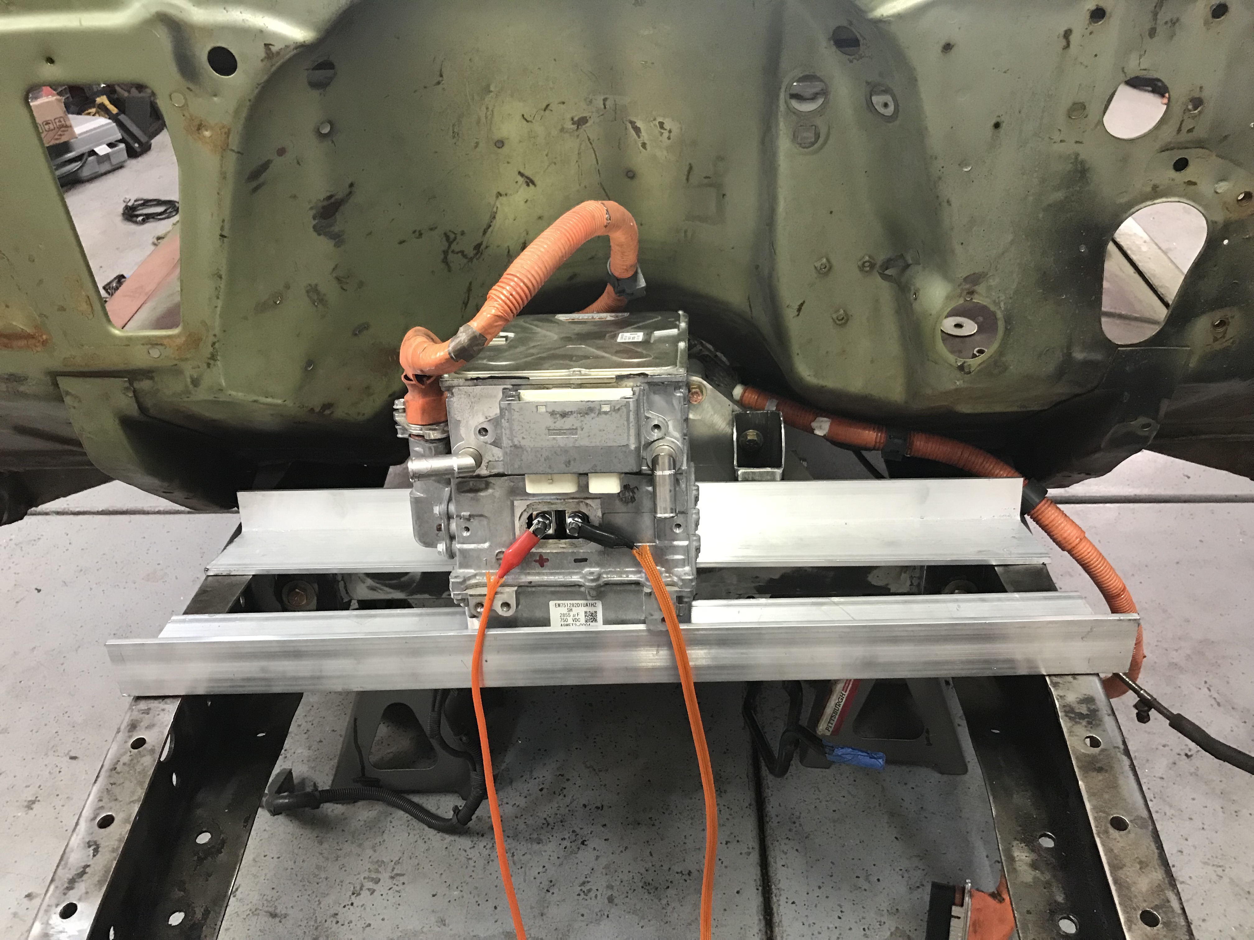

so this is how far we got (me and the mouse in my pocket)

Post by Gregski »

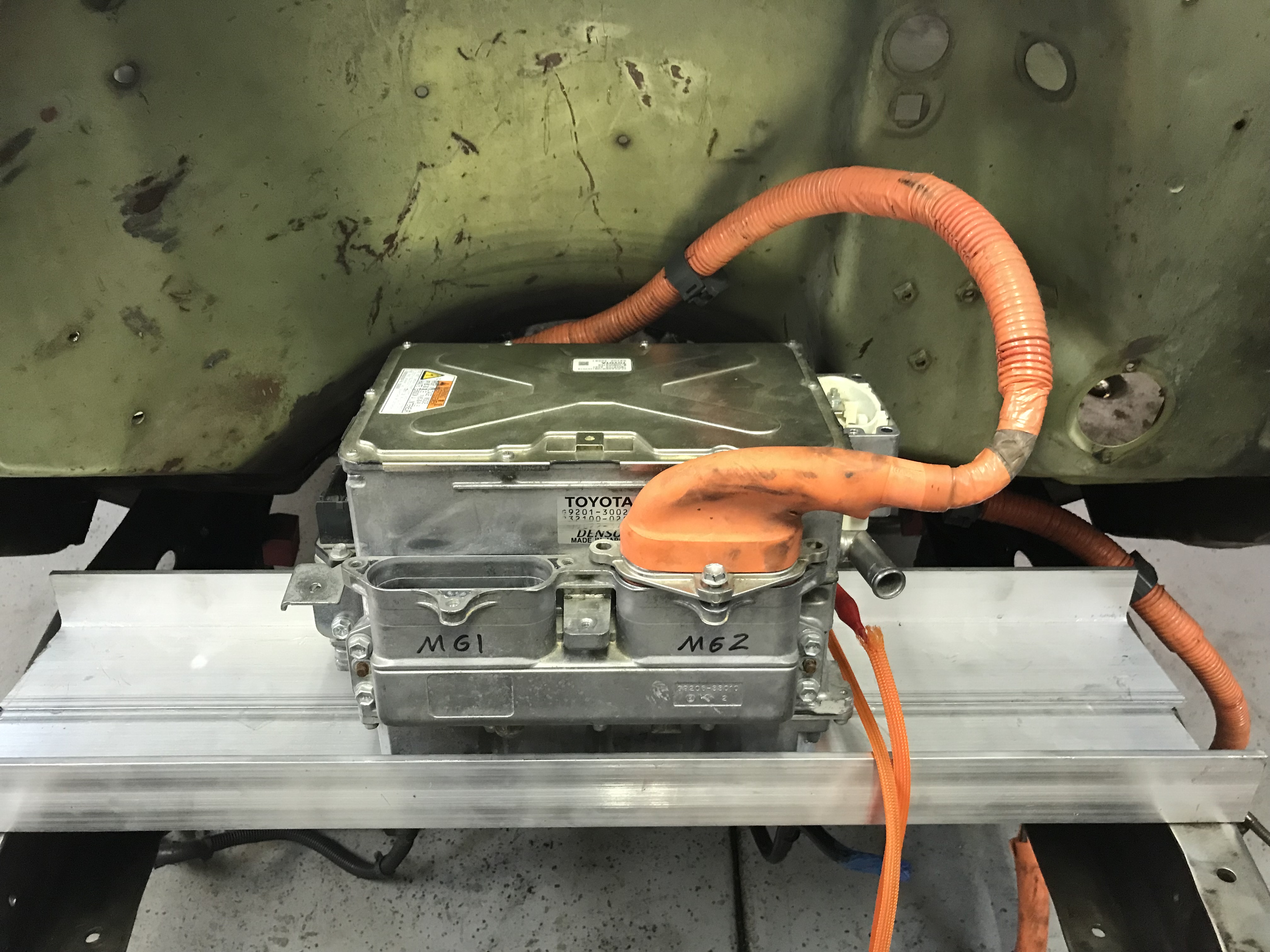

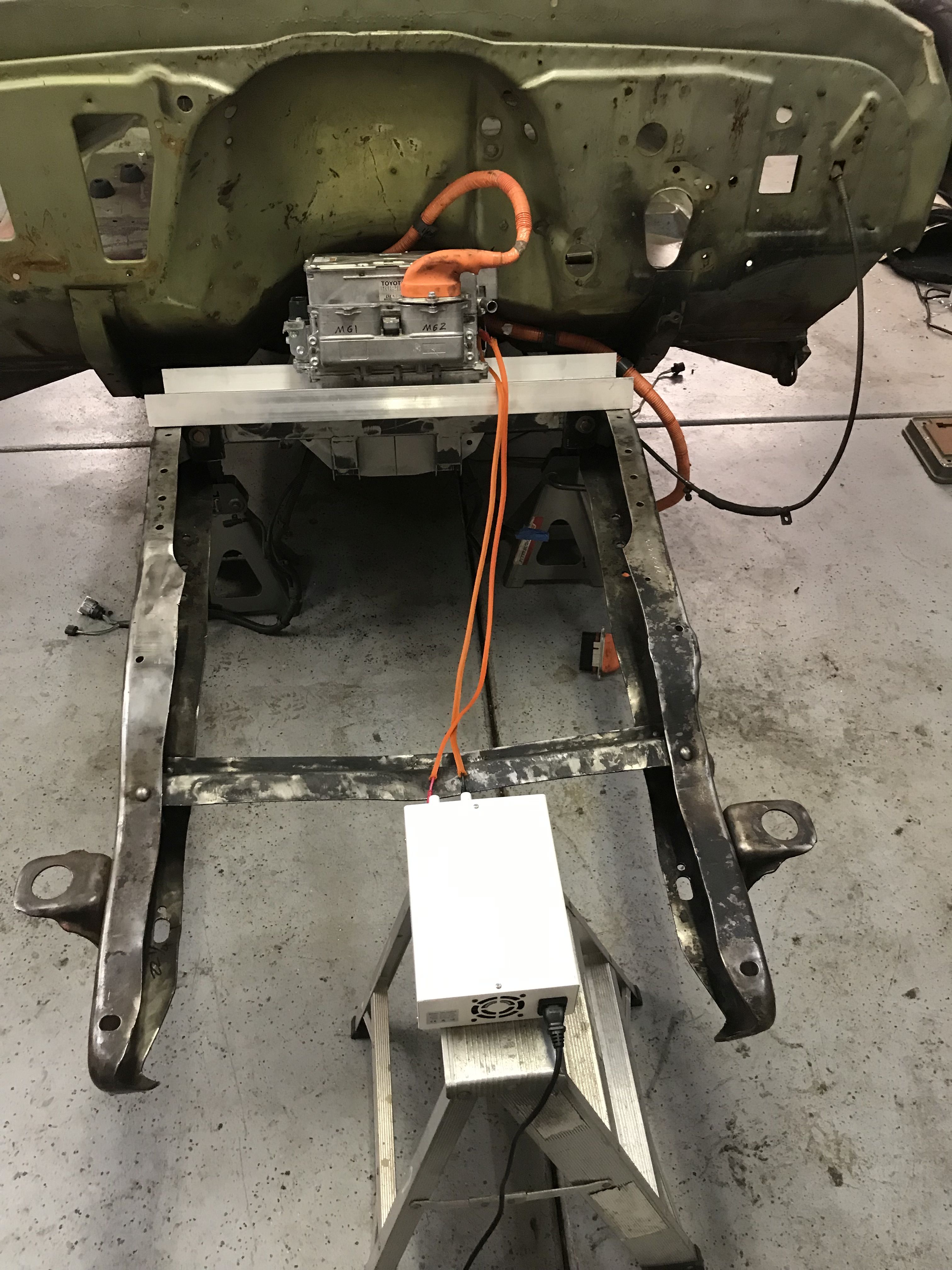

I don't usually stop to check if the cables will reach the component I am trying to install, but when I do, I make sure it is when I am half way through making the bracket...

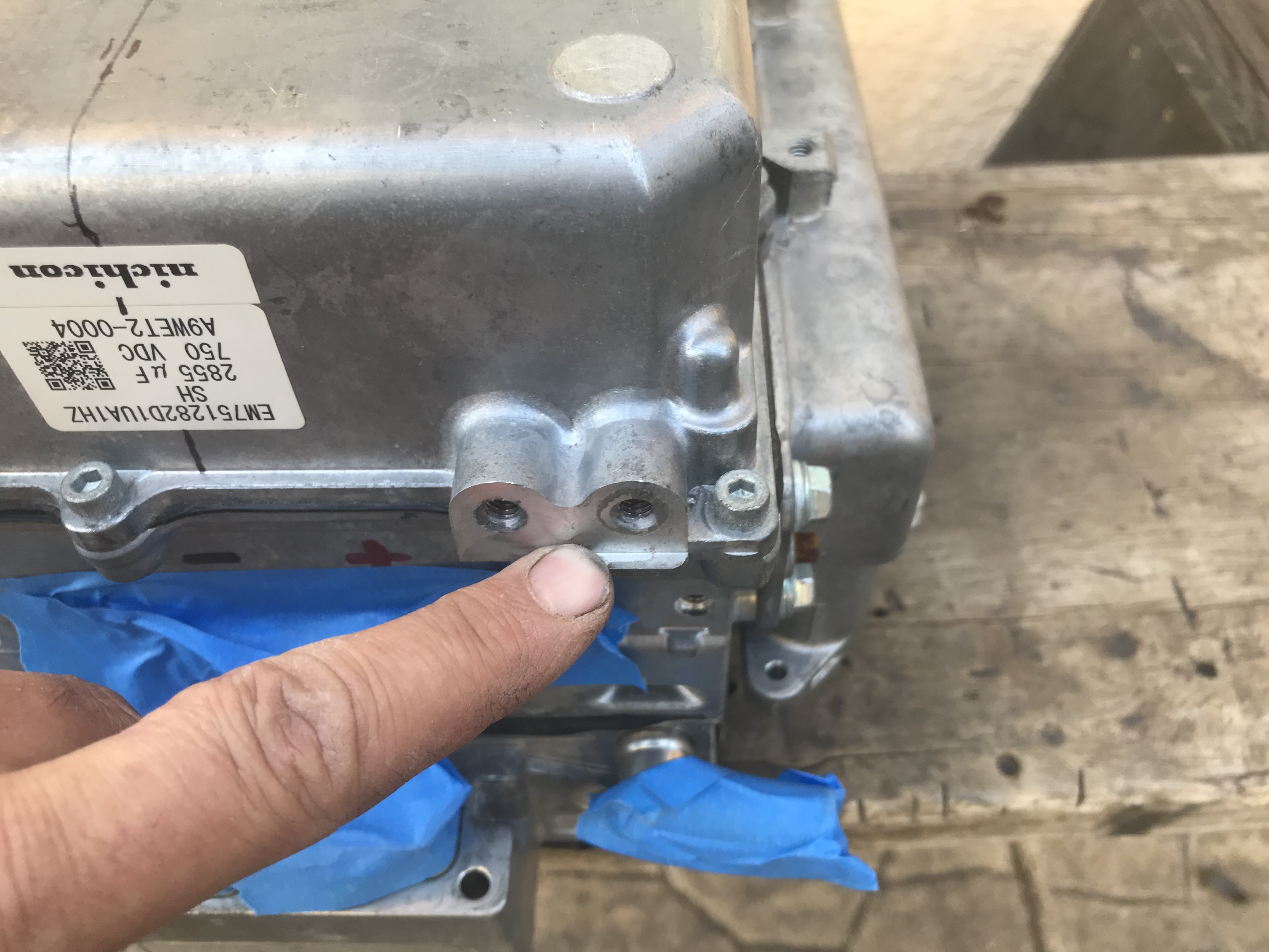

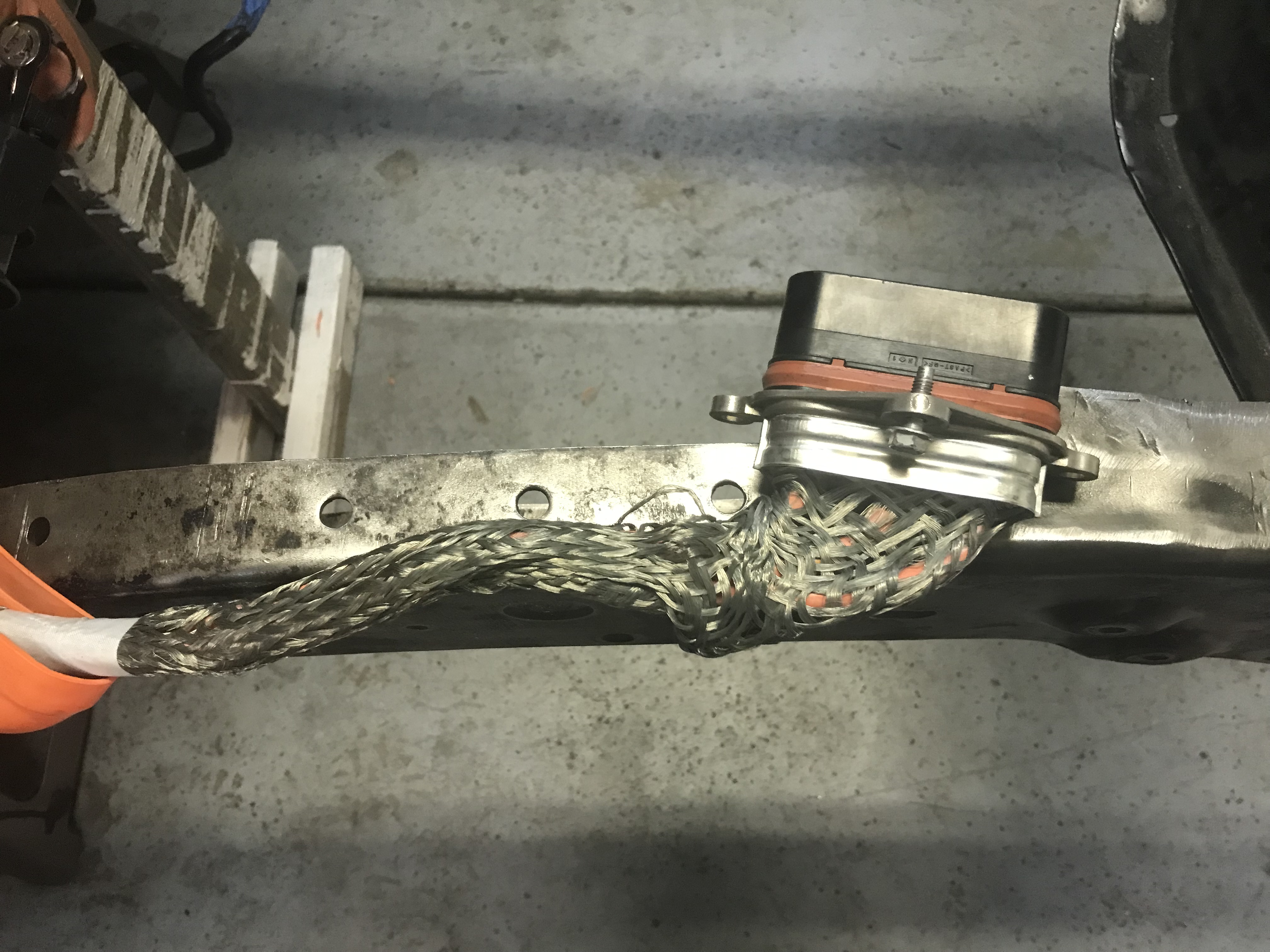

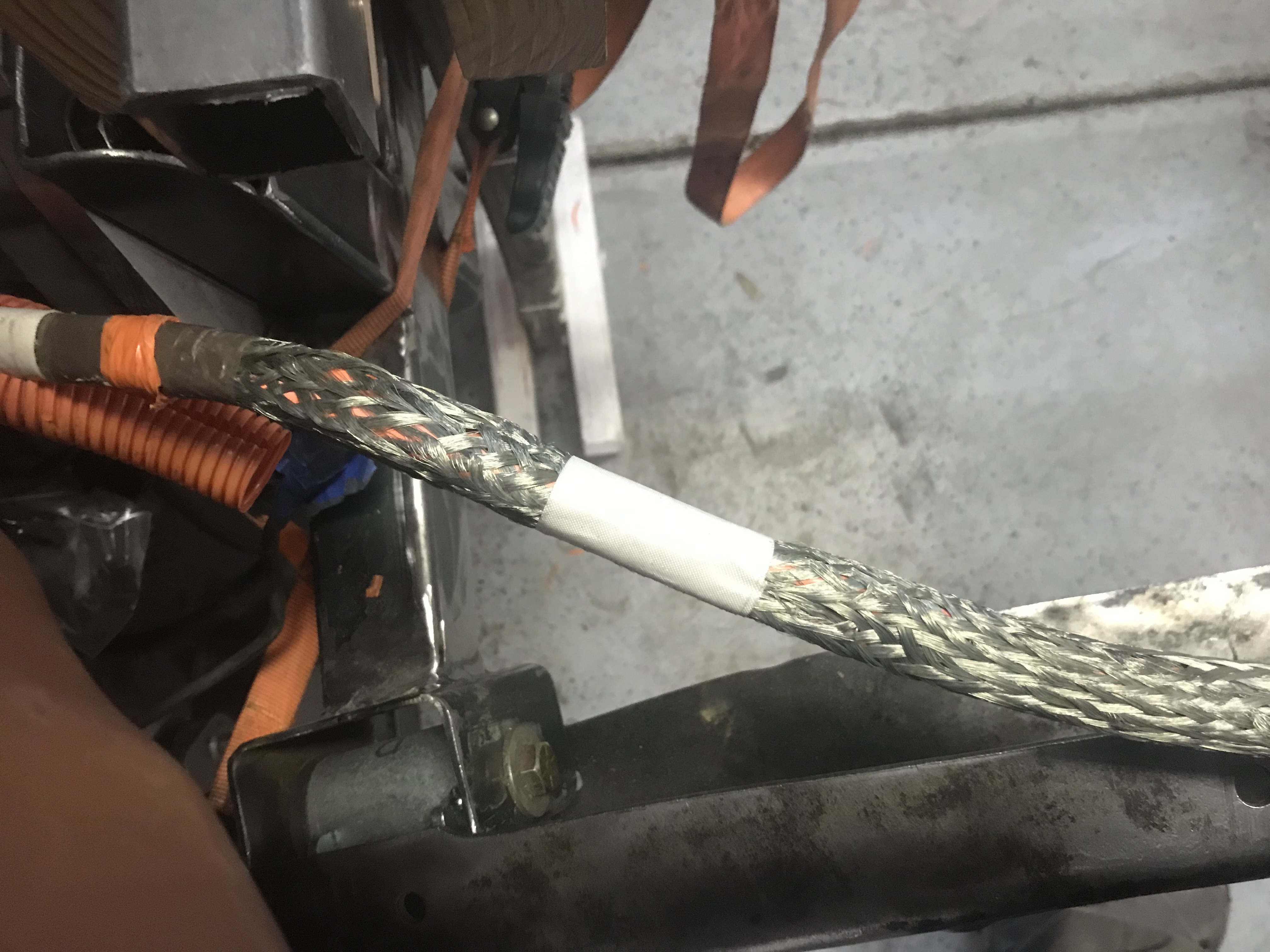

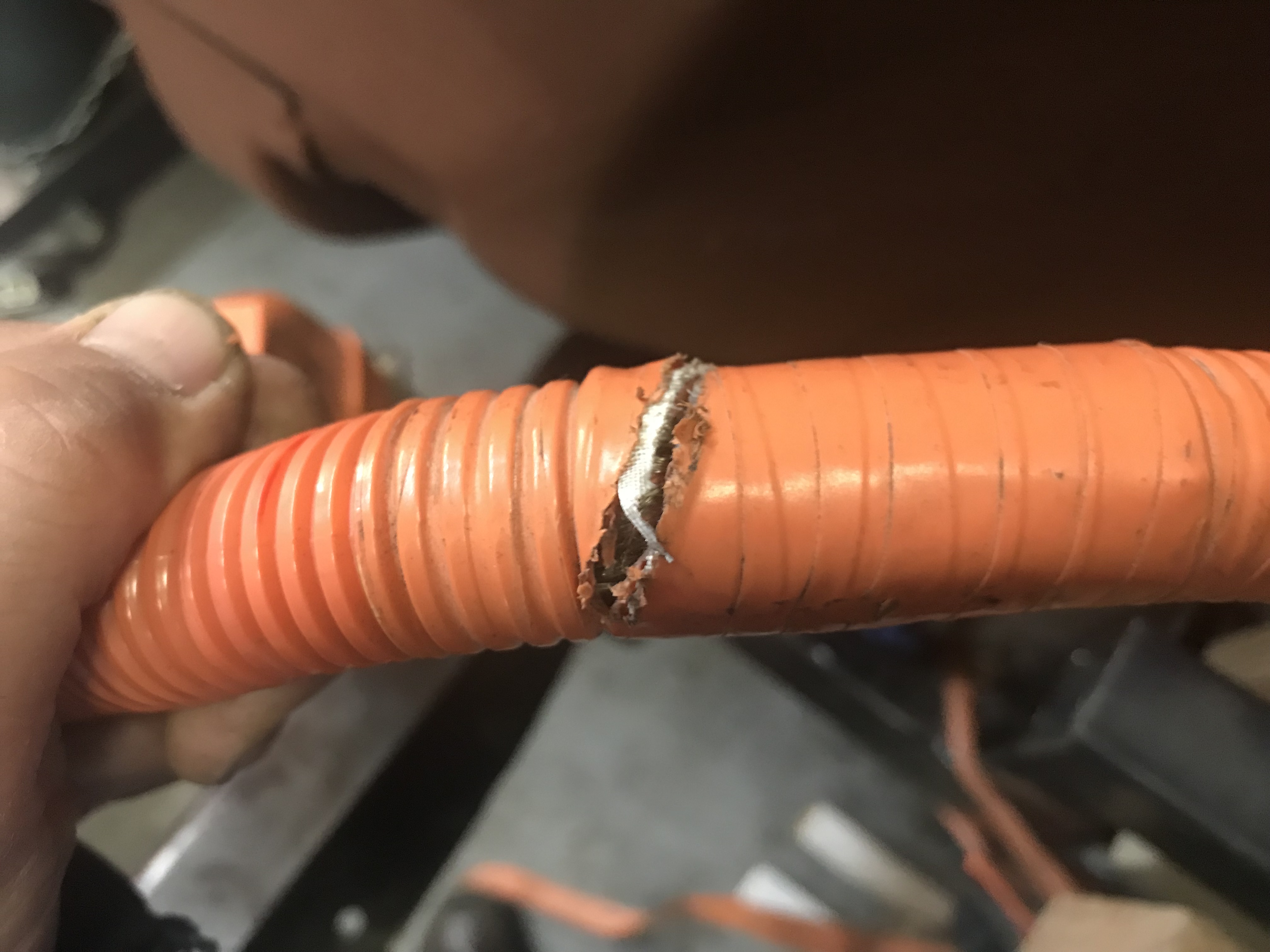

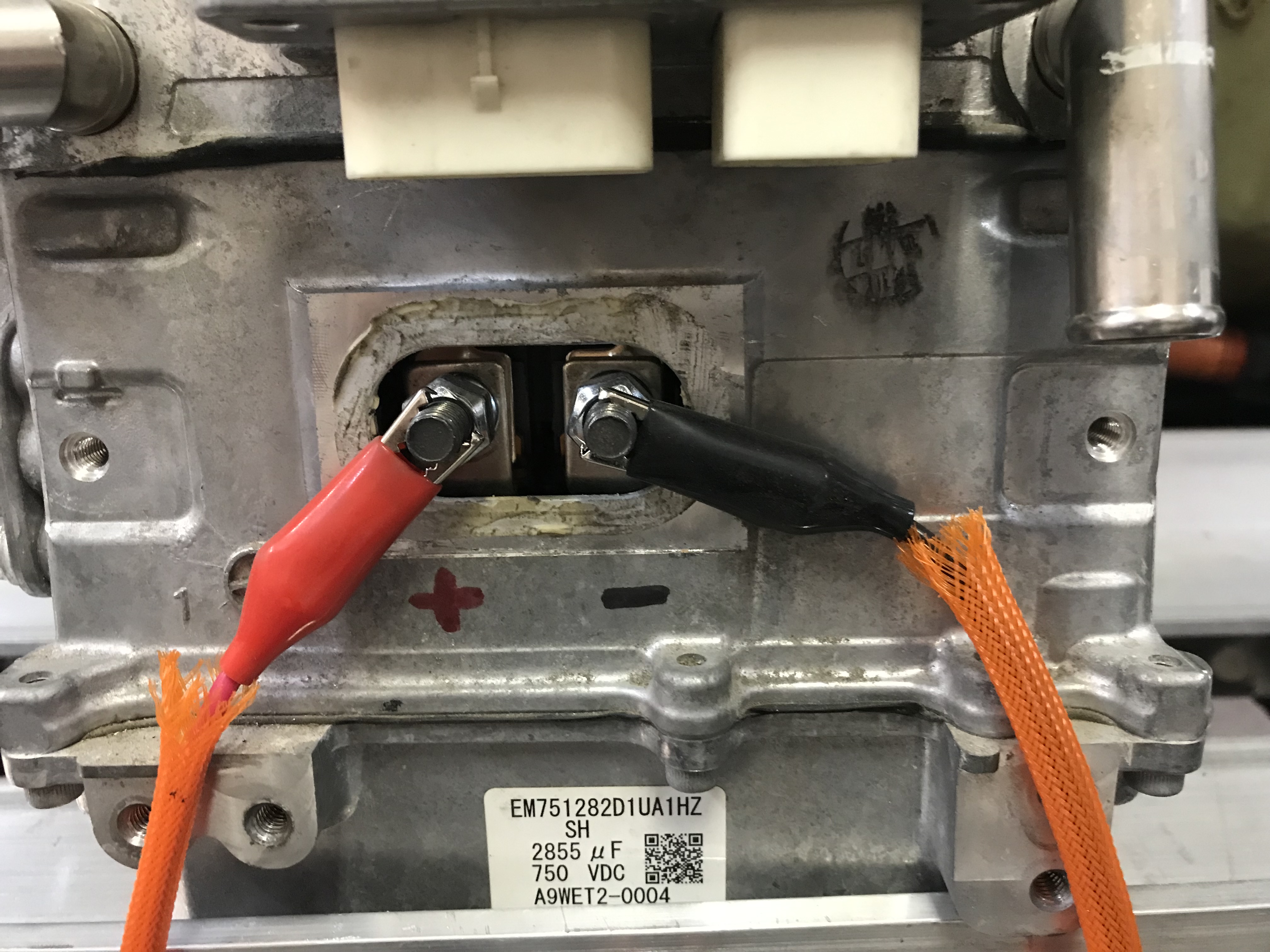

I am really not a fan of this run both cables to one side design (ie East), plus one of my cables has a booboo owie so I decided to unwrap it in hopes of heeling it and seeing if it can be rerouted Westward
so here's what lurks inside

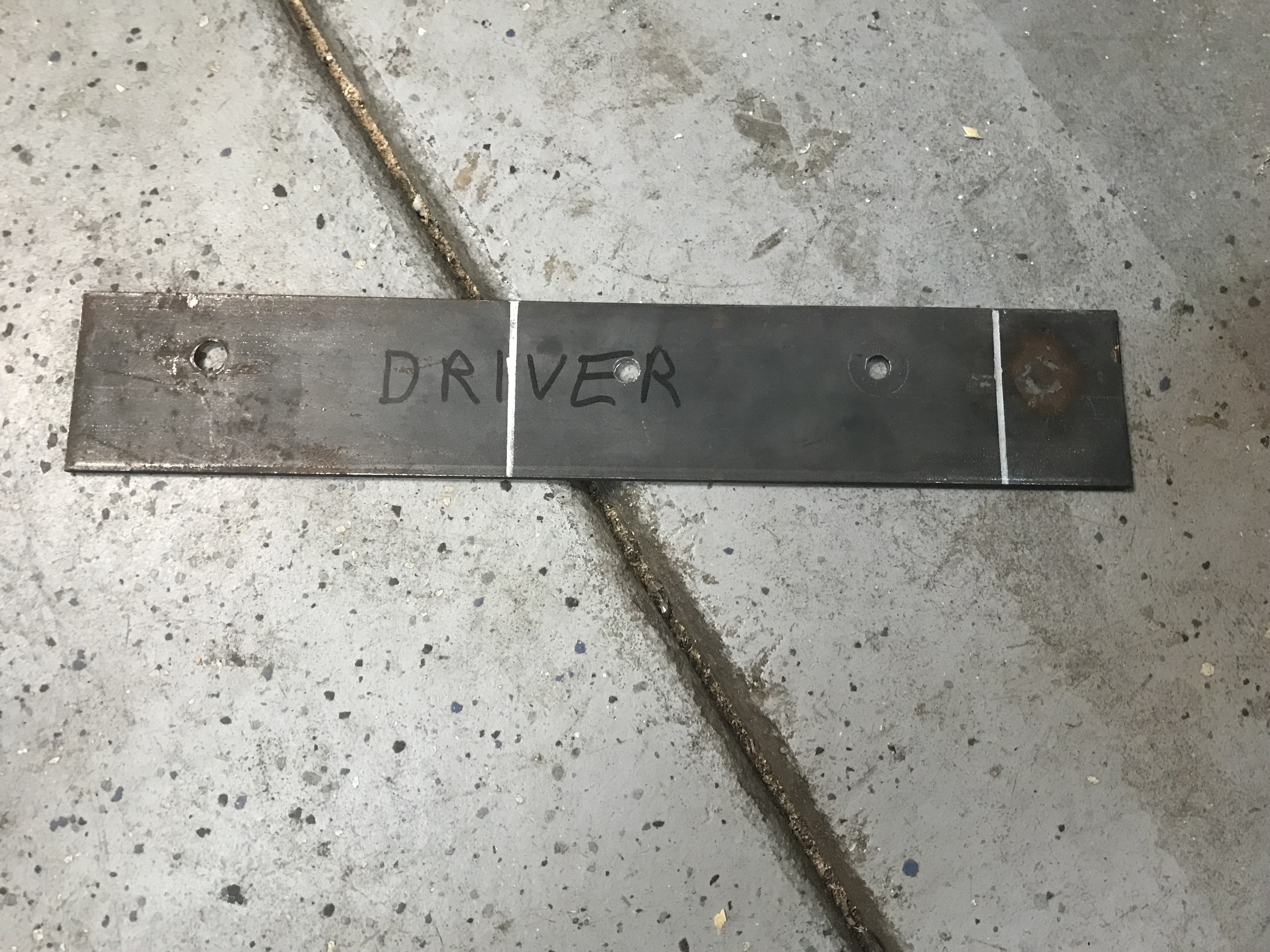

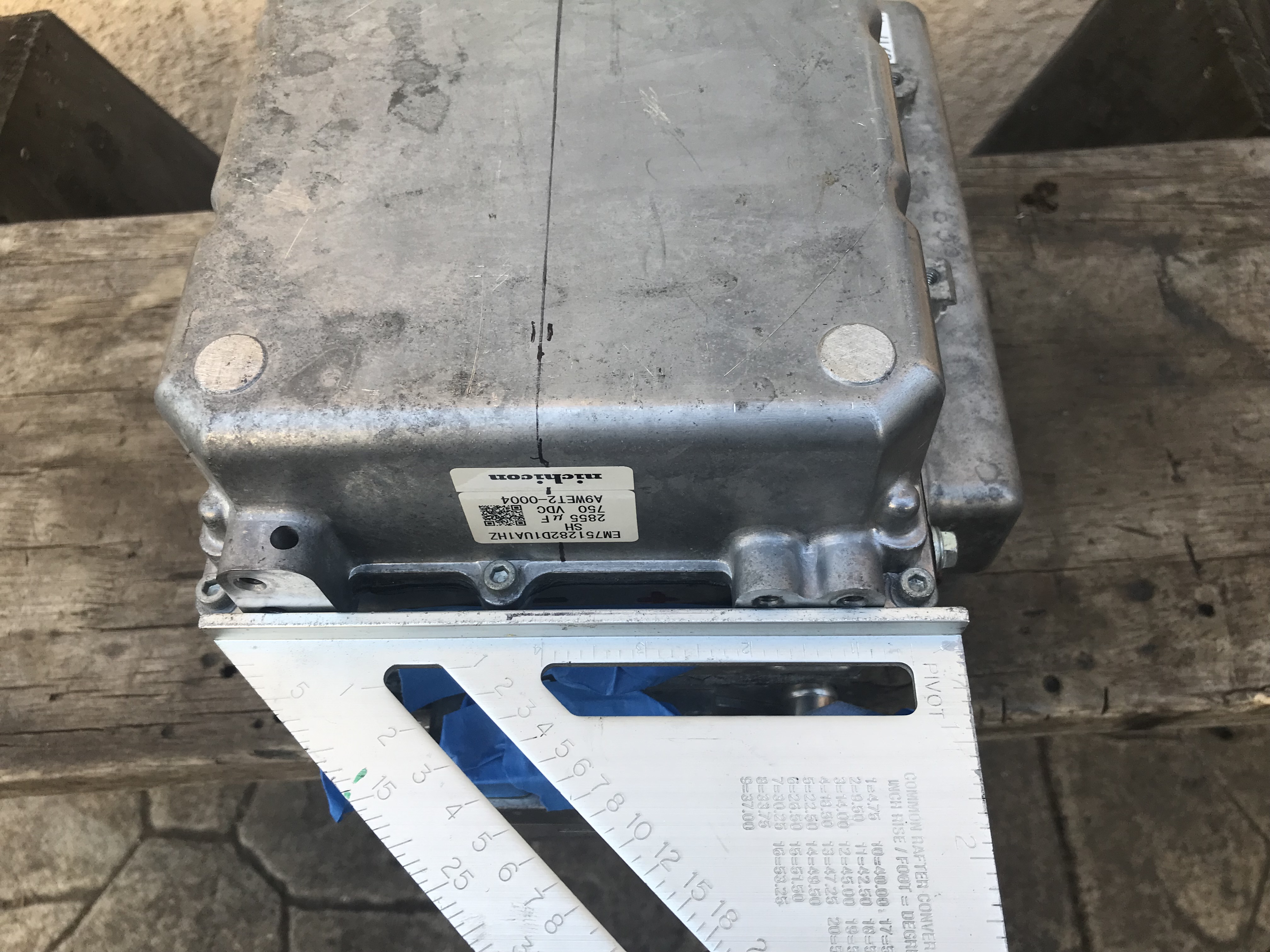

Post by Gregski »

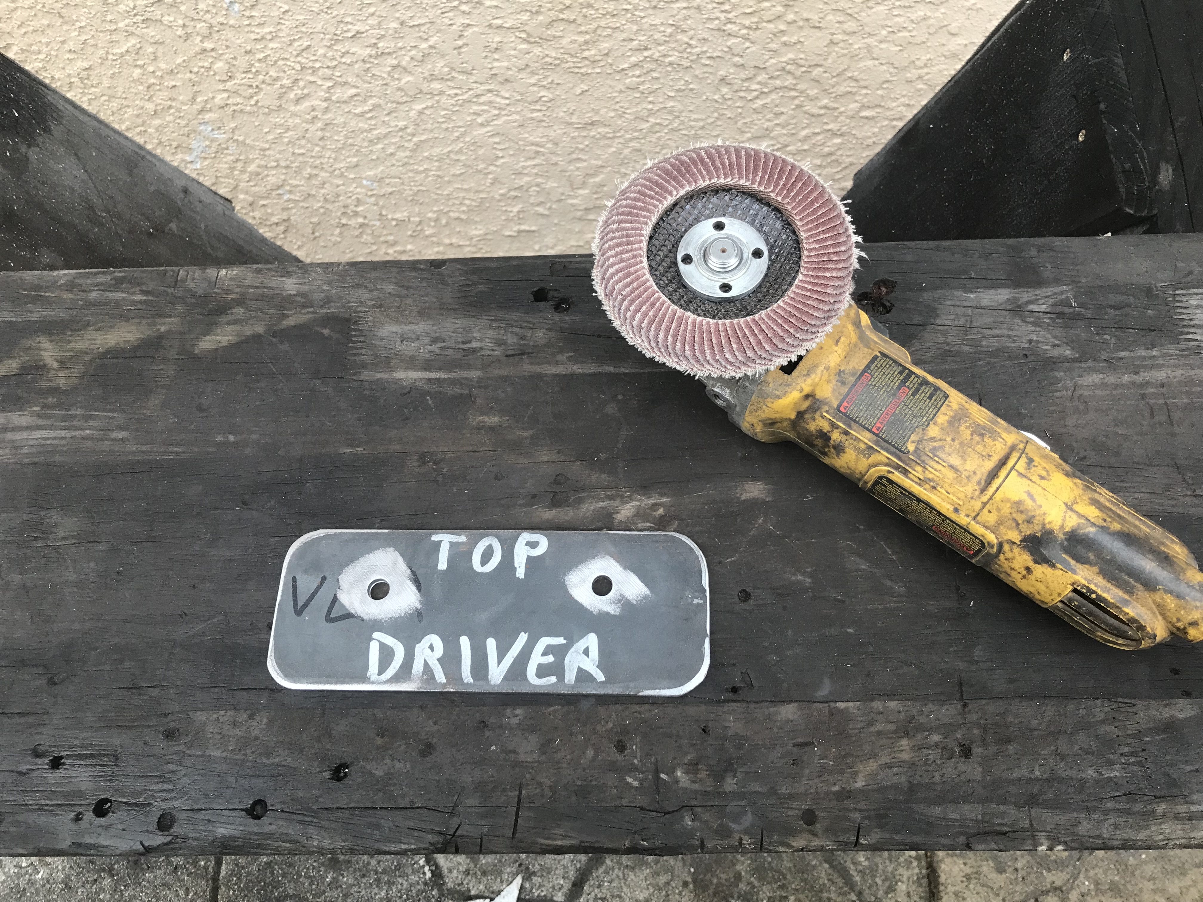

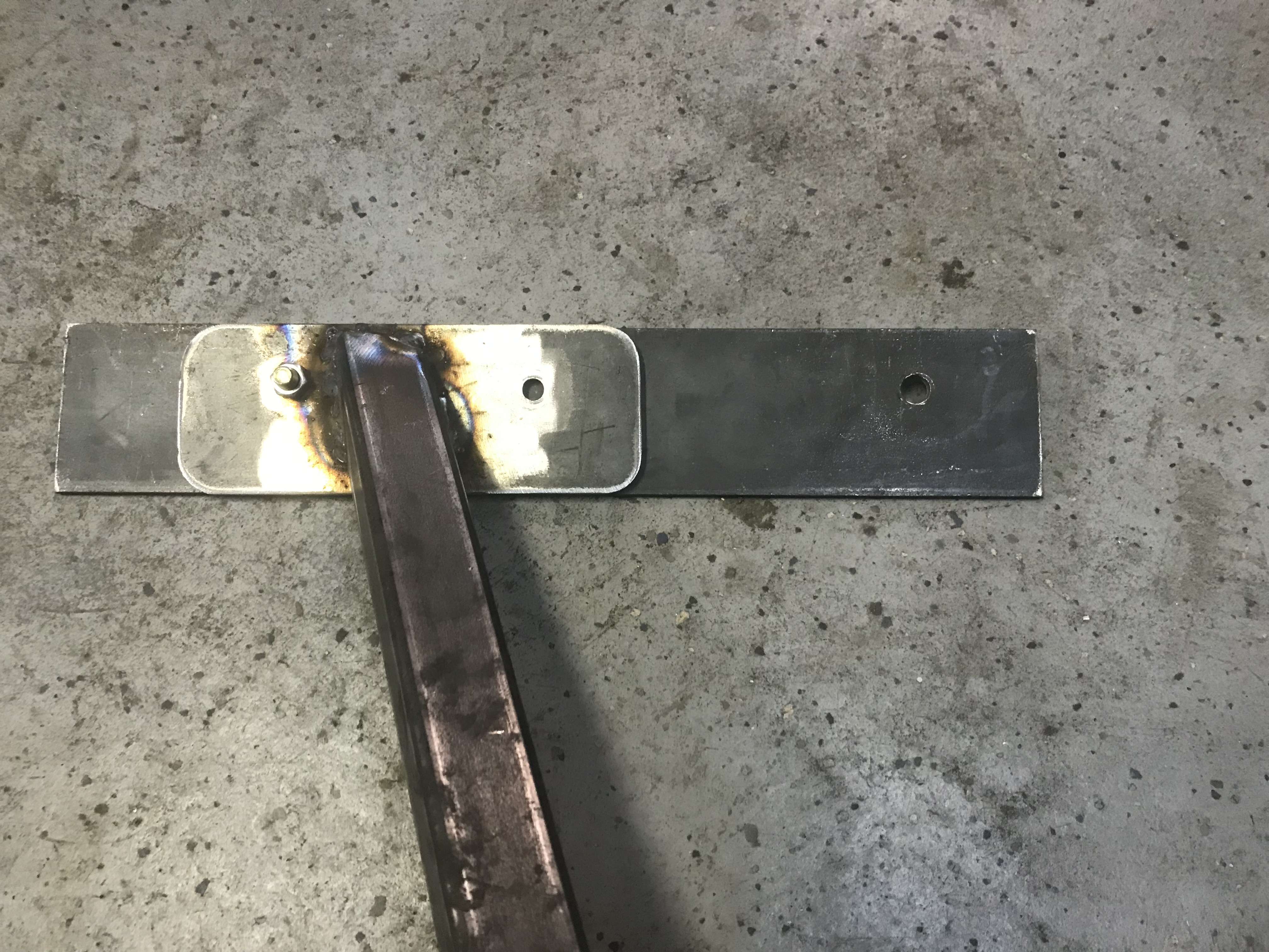

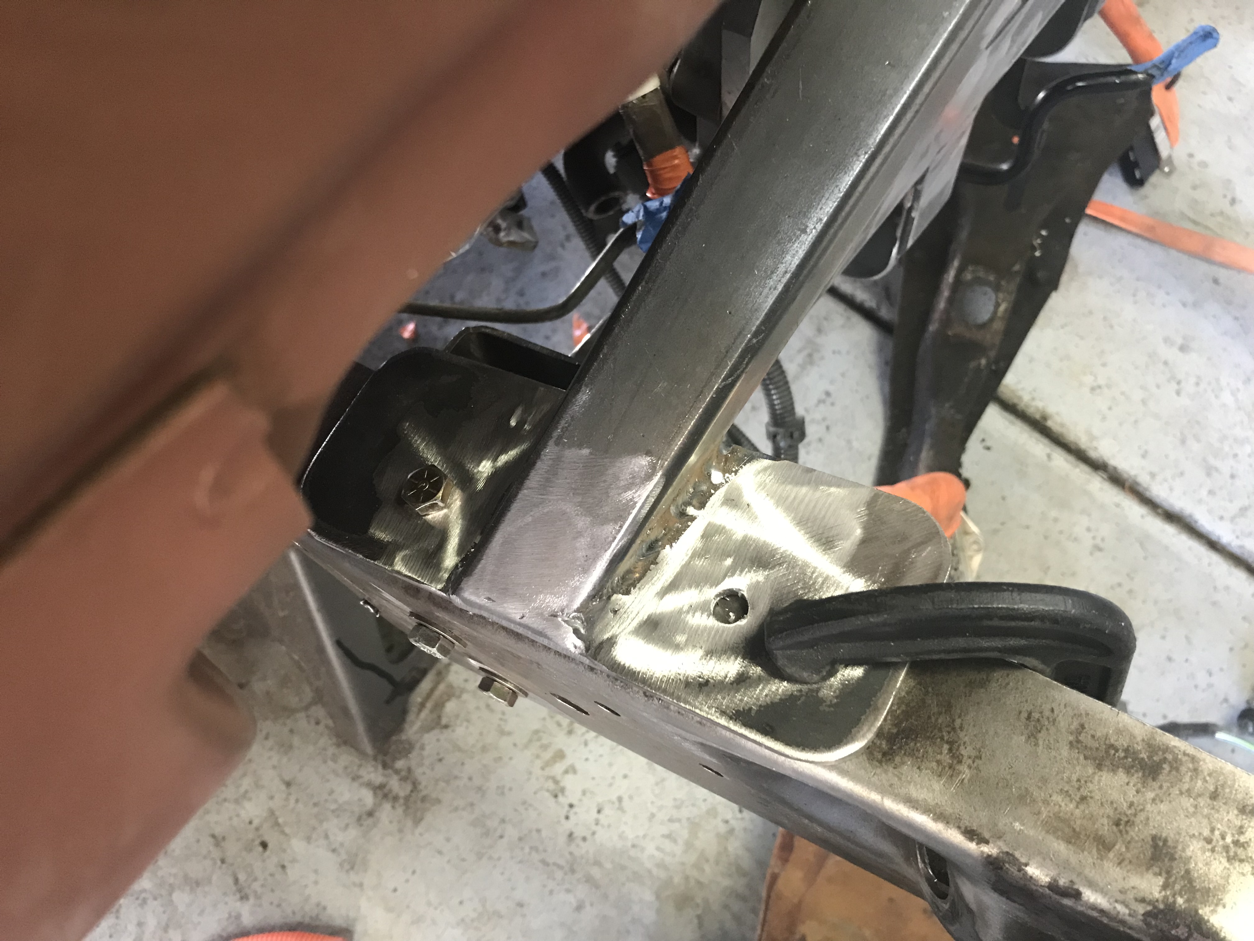

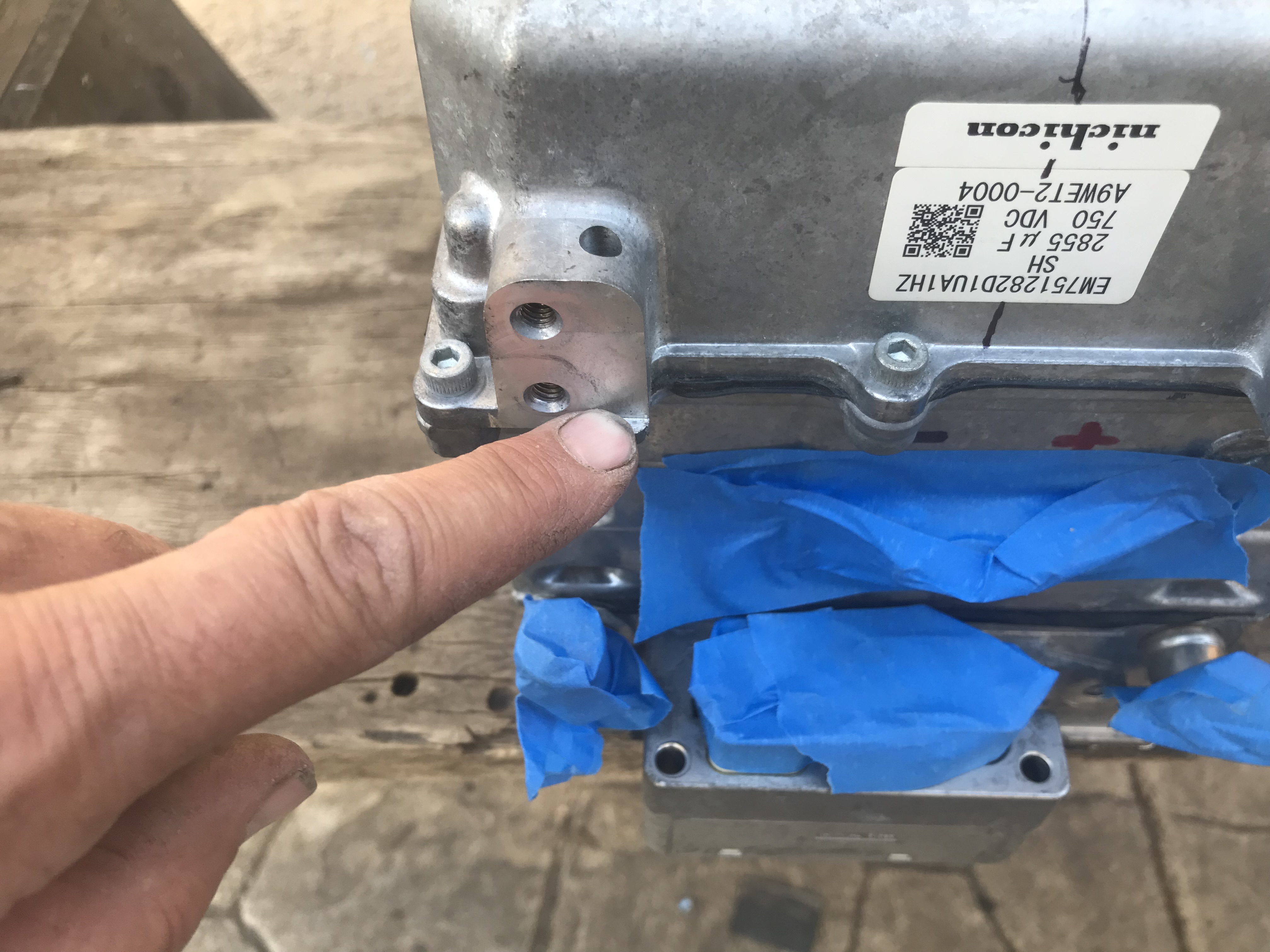

decided to shave off a few protruders to ensure flatability
trying to look all official and shiet
just some scrap piece with a "speed hole" in it

Post by Gregski »

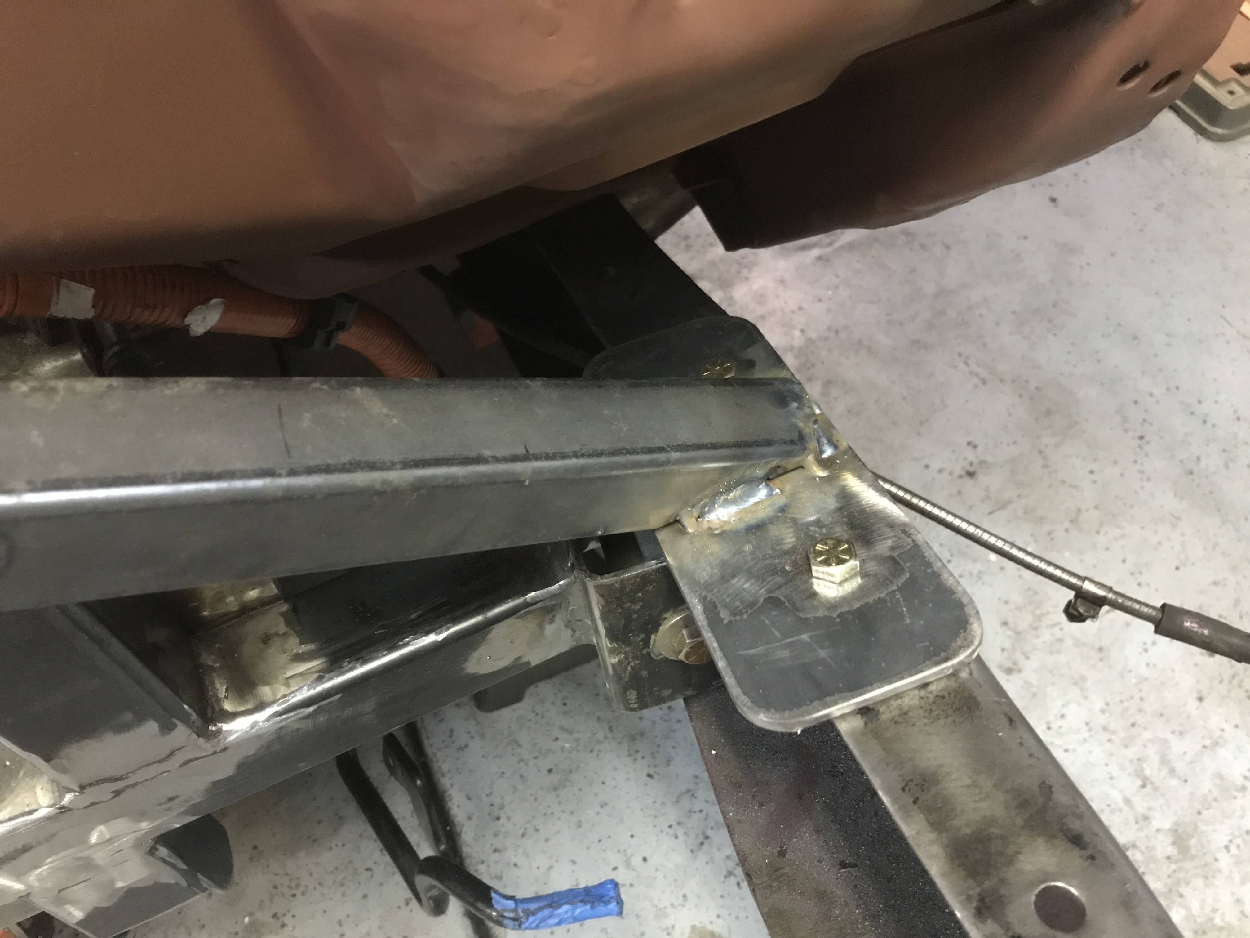

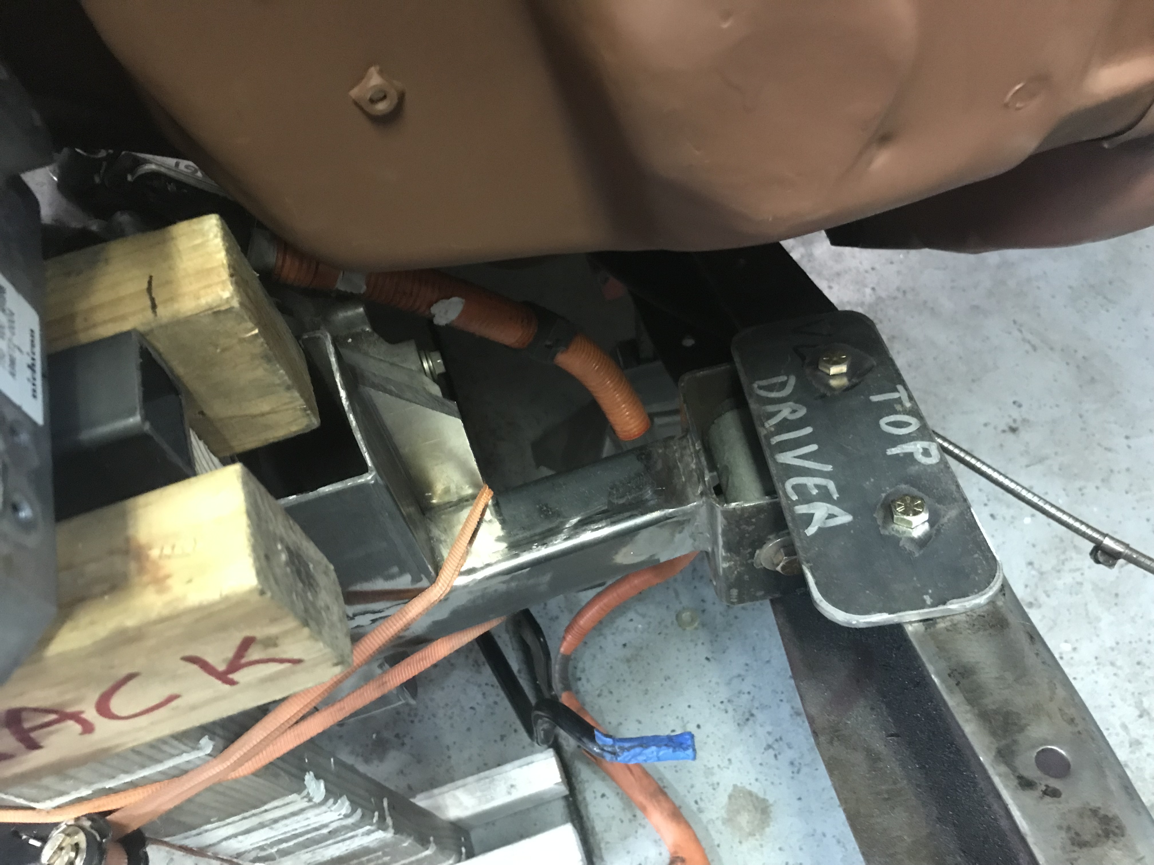

one of many, many, trial fitments (FYI, if frame rail hurdles ever become an Olympic event, I will bring home both the Gold and Silver medals for team USA)
I need one of them 90° drill extensions to drill out this one and single hole in the frame cause the firewall is in the way even with the cab unbolted and slid further back, and I don't feel like unbolting the bed of the truck
