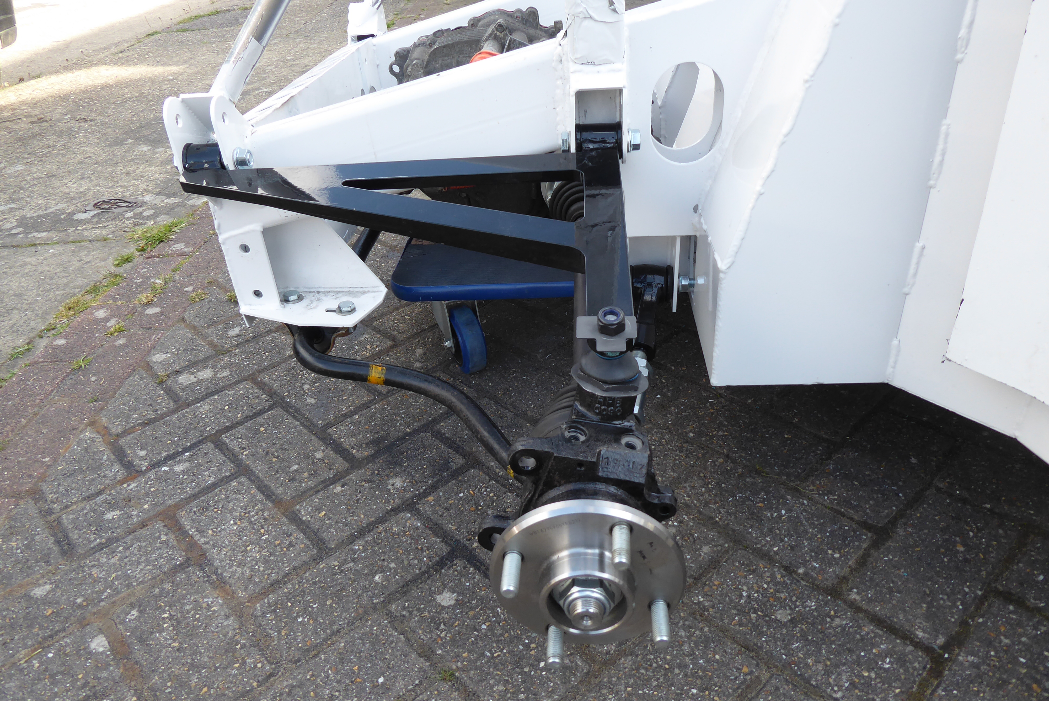

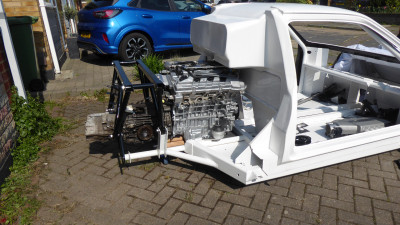

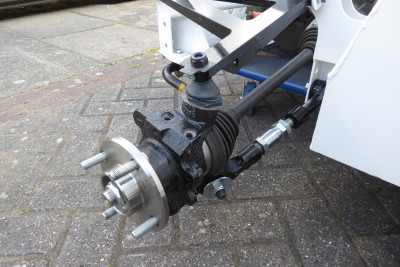

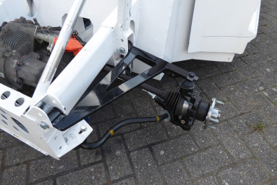

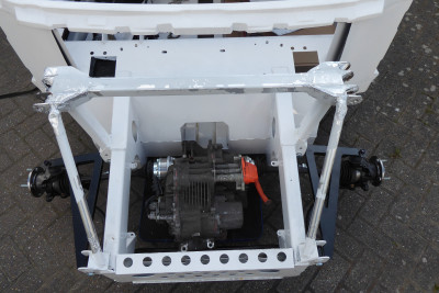

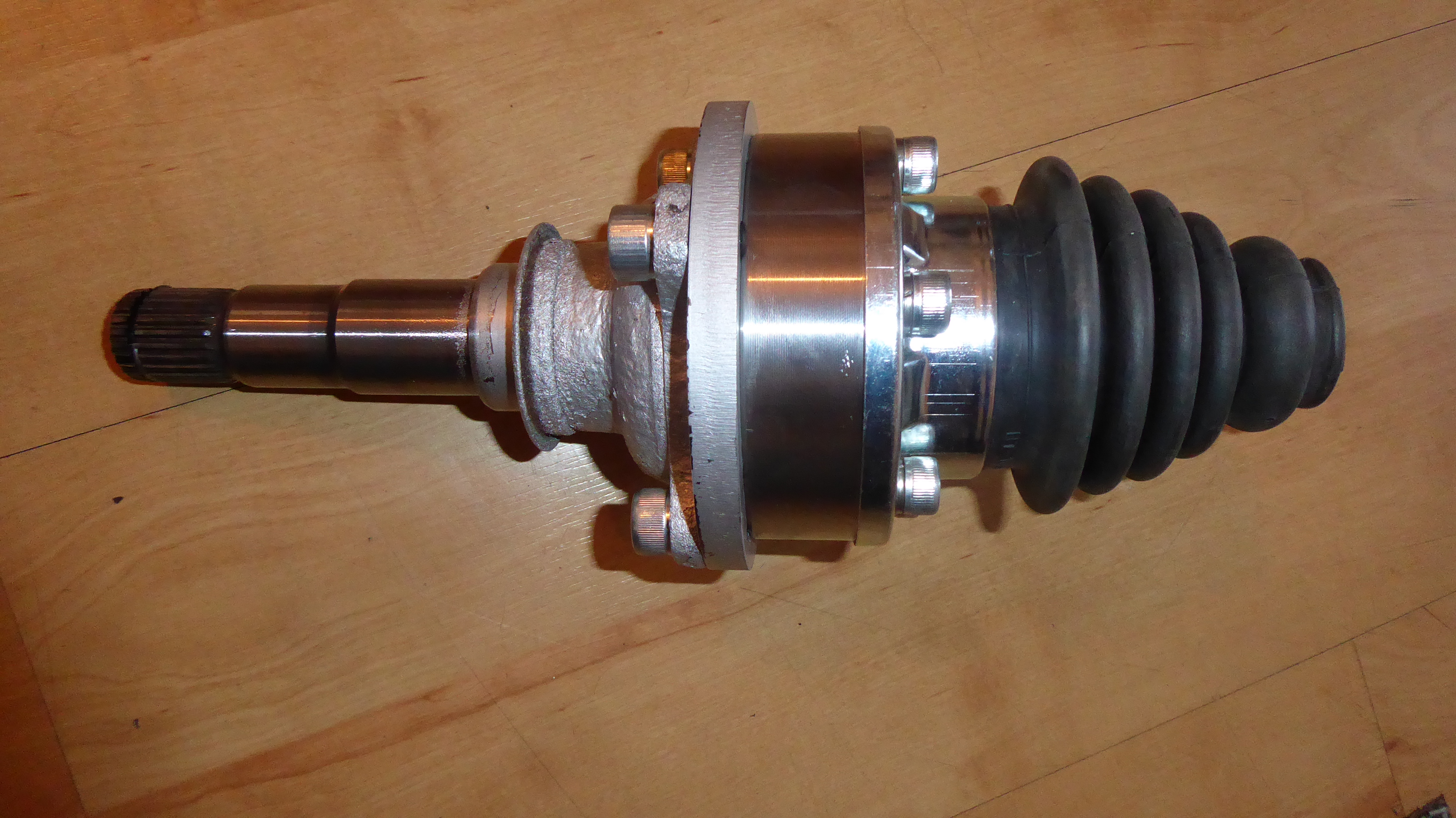

Self Charging Hybrid
MGR in front axle of RS200
V8 4.4l in the back of RS200
GX450h MGR
Volvo/Yamaha V8
MGR Driveshaft to 100mm CV Joint Converter
MGF Hub Carriers
Mondeo Stub Axles and CV Joints
Sierra Anti Roll Bar
Lengthened (60mm) Sierra TCA's
4 Deg Castor for Power Steering
Solid Top Arm
Camber Adjustable Lower Arm
