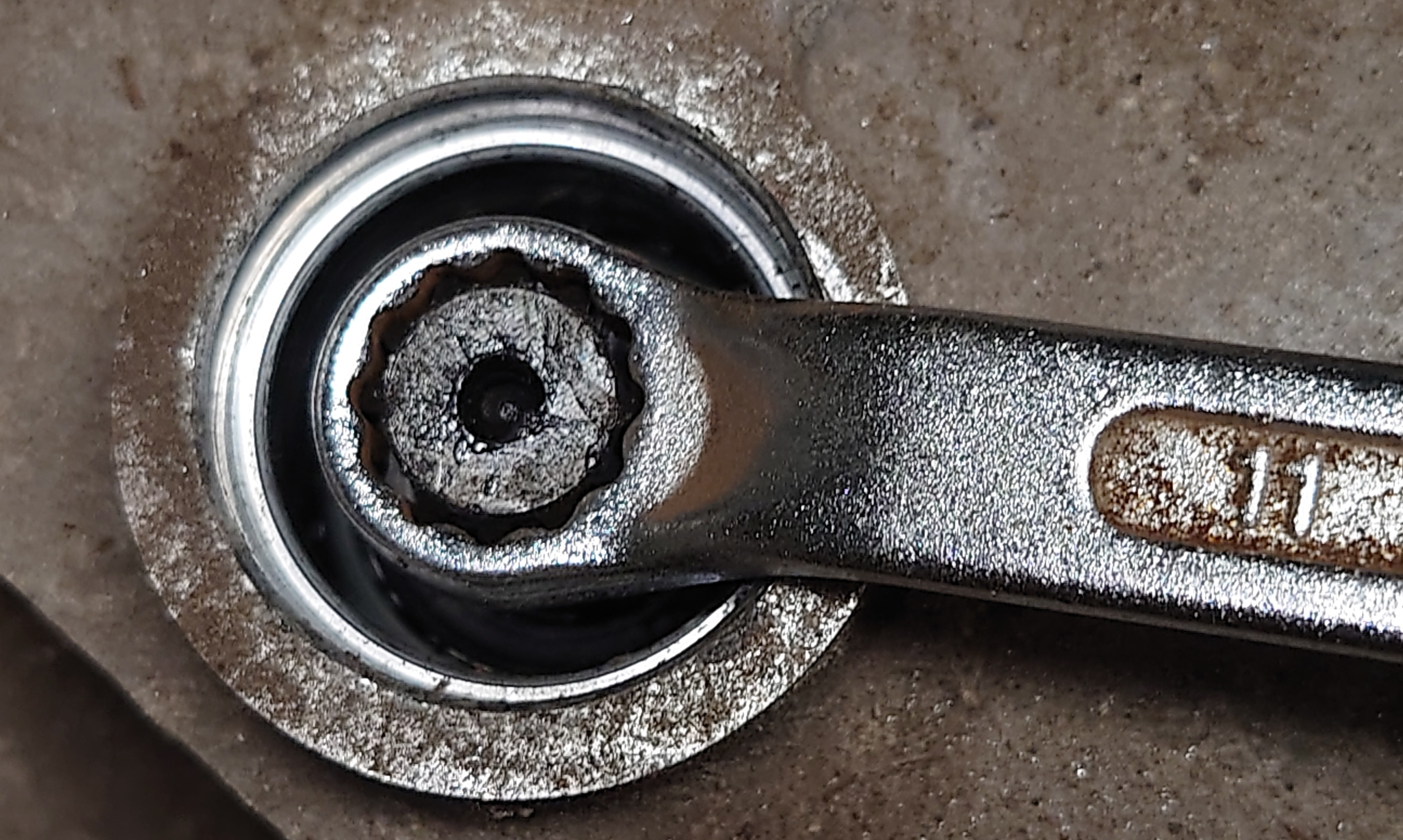

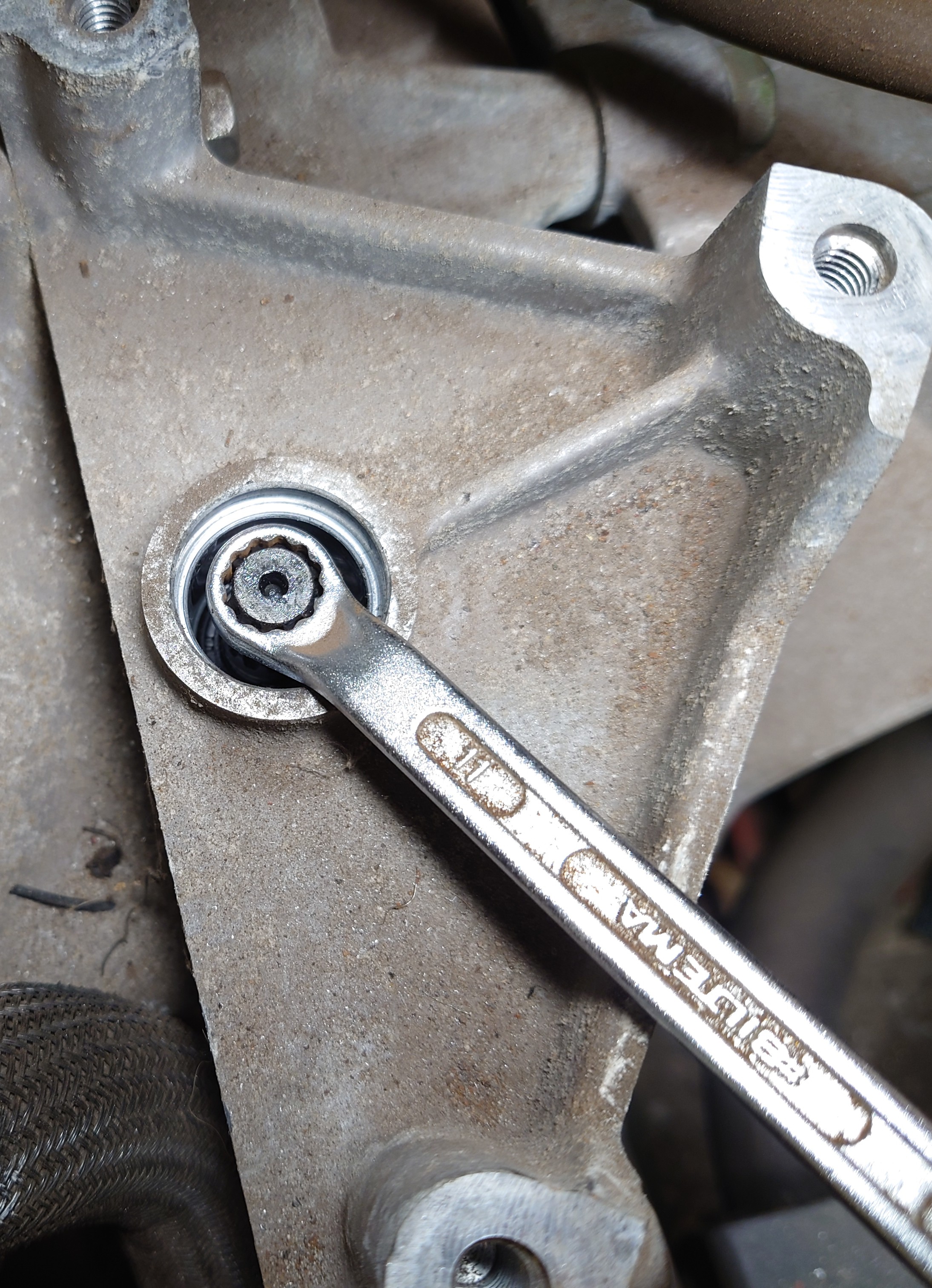

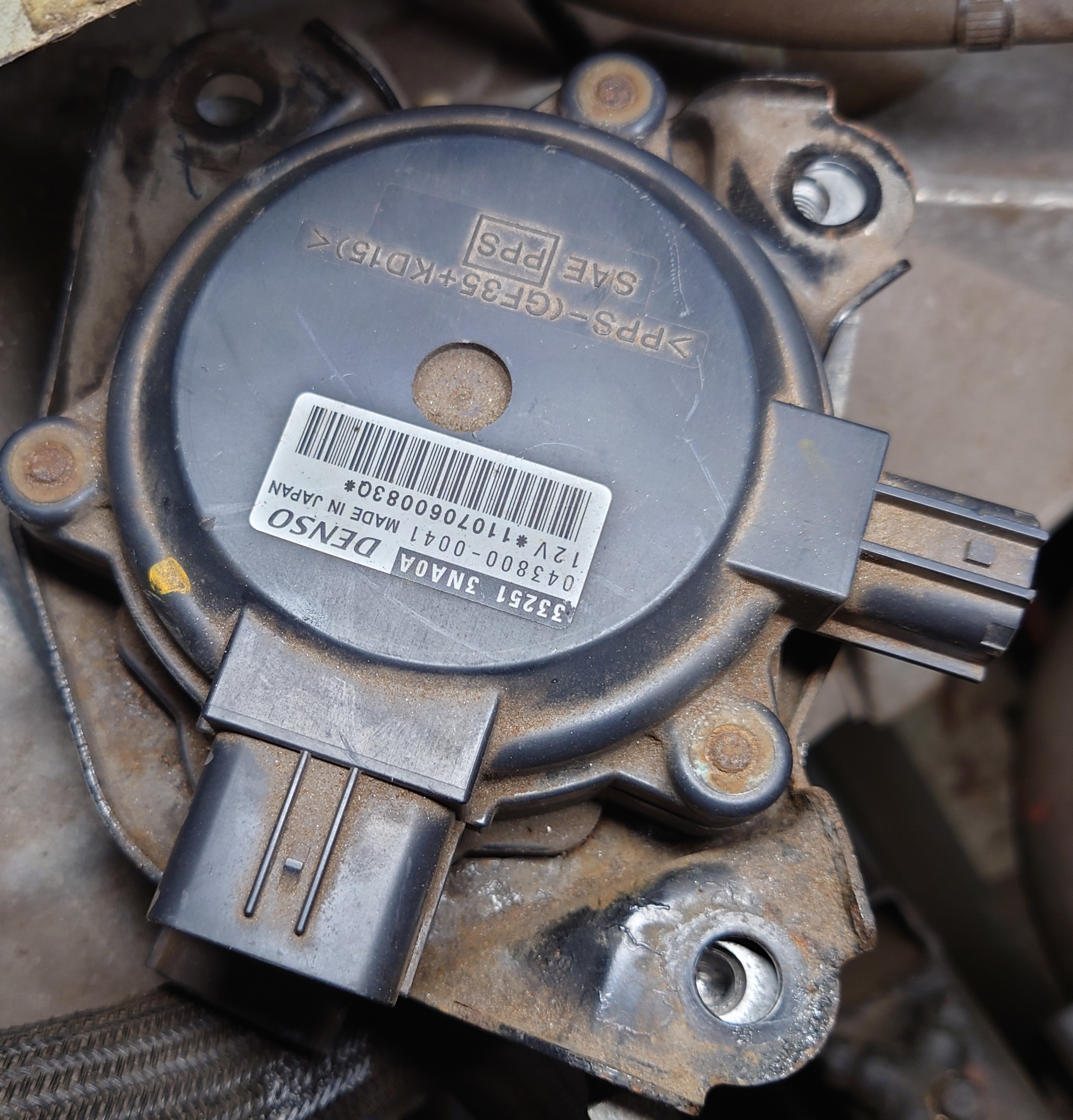

After seeing how easy it is to made work, I decided to tackle my P-brake problem too.
Here is what I found.
This is from EM61
Nissan EM61 P-brake actuator assembly.
Nissan EM61 P-brake operational lever and 11mm spanner
When removing the nissan assembly, it is possible to just change The P lock with a 11mm spanner.
Here is pictures of the 2 positions it goes to:
D = DRIVE
EM61 DRIVE
EM61 DRIVE
_-_-_-_-_-_-_
-_-_-_-_-_-_-_
P = PARK
EM61 PARK
EM61 PARK

Yeah exactly, and the spanner turns ... 90 degrees? maybe only 45 even.
I think the little motor could in theory be made to work with an OpenInverter mini board as it is three phase.
We had to de-prioritise the software solution, but if someone wants to tinker something together and publish here that would be great :D
