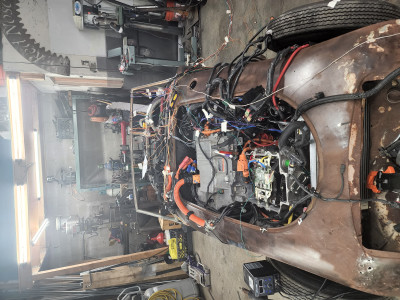

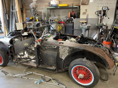

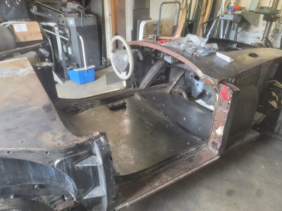

1. Can connect to Zombieverter, and read timestamps, as well as make things click on, but thus far I'm not having luck getting the pedal to register, or parameters to load.
2. Finding out if their is an avenue to utilize the original parts of my leaf, which are as follows, Contactors? Onboard charger?, Parking Brake actuator.
I'd like to use the original contactor unit, but if this is more trouble than its worth I'll build another zombie controlled independent contactor box.
Mainly I'd like to know the best way to diagnose that the Zombieverter has everything that it needs, or that it I've assembled it correctly. It powers up, wifi works, but there's nothing to really tell me that I'm connecting to it. It says it's updating when I install the Bin file from, the wiki.
Bottom line is any advice is welcome as I'm very new to this.
