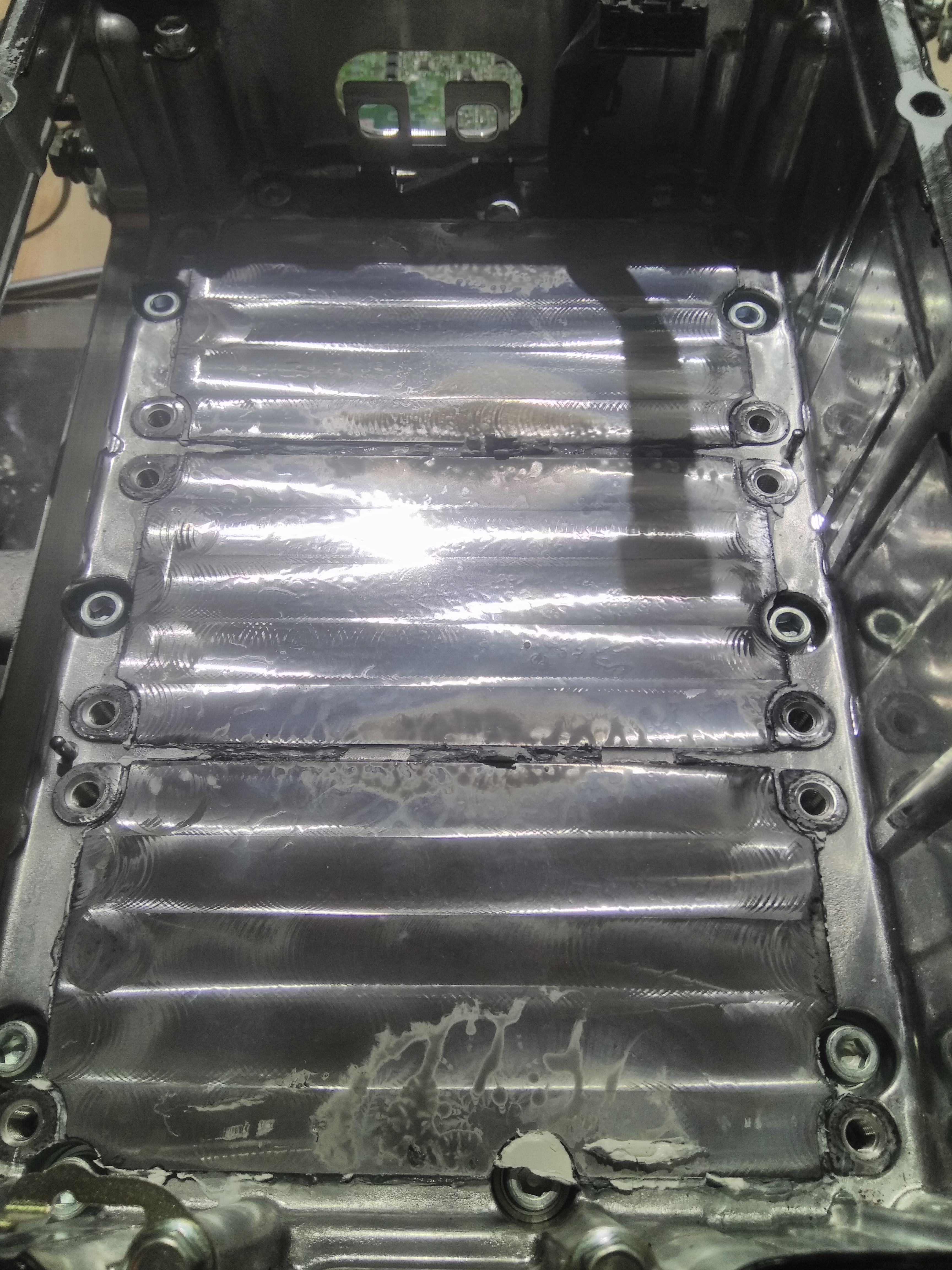

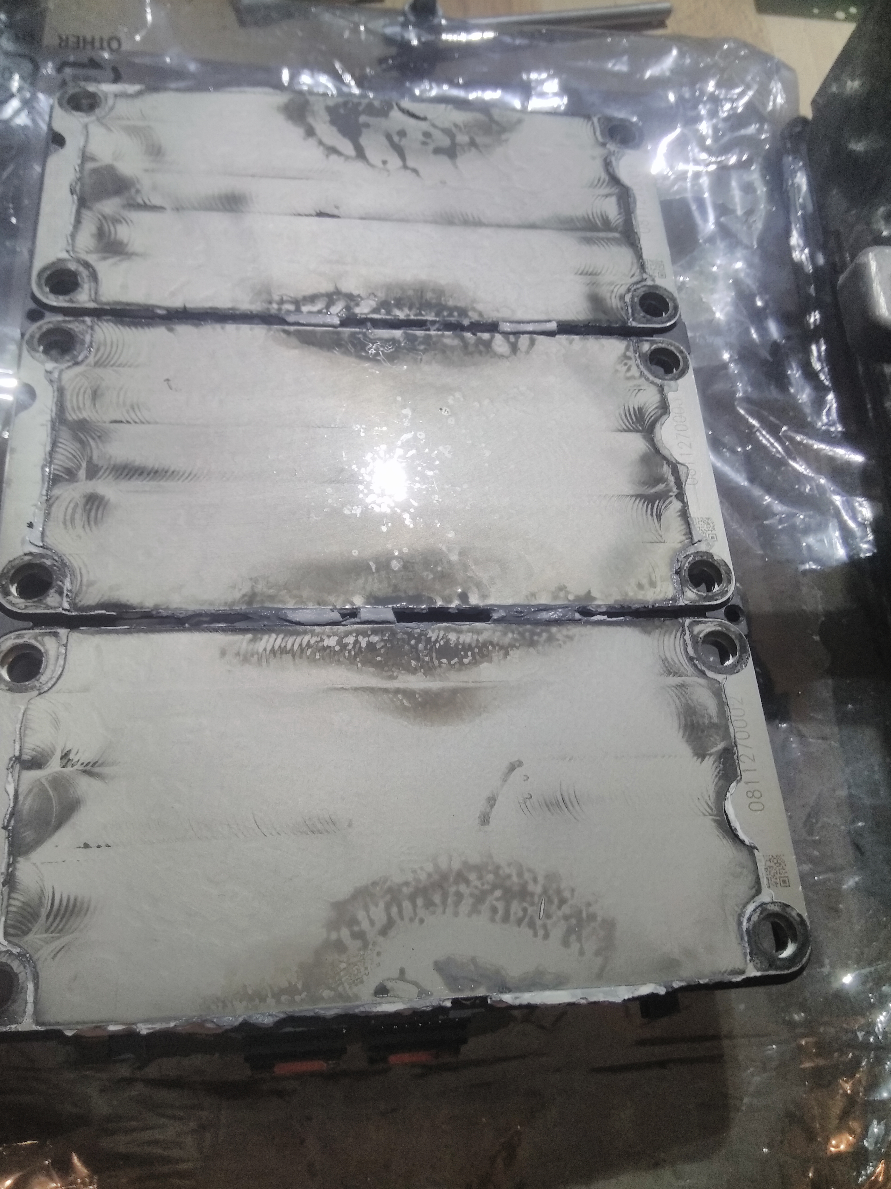

Pump up the jam
Yeah, the grease totally hasn't become translucent and hasn't been pumped out of the hot regions...
:lol: :lol: :lol: :lol: :lol: :lol: :lol: :lol:
More incoming, time to regrease & assemble.
Using electrolube htsp, some thin rubber roller, 2.5-25nm torque wrench (clicktorque a5), tqc sp4000. Torque values from the rx400h TSB. Ambient temperature is 25 degrees celsius. Target TIM thickness - 125um.

Have apart my inverter atm to do wiring upgrades. Does anyone happen to know what metal material the heat sink is made out of on a Prius 3rd Like is it aluminum or nickel etc. i am considering using liquid metal since the heat sink isn’t touch any thing and it’s all metal but I can’t use it if it’s aluminum from the gallium tearing it down. Liquid metal usually decreases temps by about 10 degrees. I was also gonna mod some notcua fans inside pcb board areas to. Being that there is 12v connections it wbt be difficult to make happen as long as I can find points to make it fit.

Lapping the contact surface of the IGBT copper base plate and mounting surface of inverter housing would give you the best results. I believe warping of the inverter housing over time would cause the igbts to separate and any uneven heat would more than likely be the result of that and not bad thermal paste.
