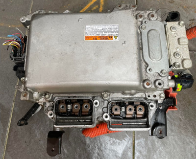

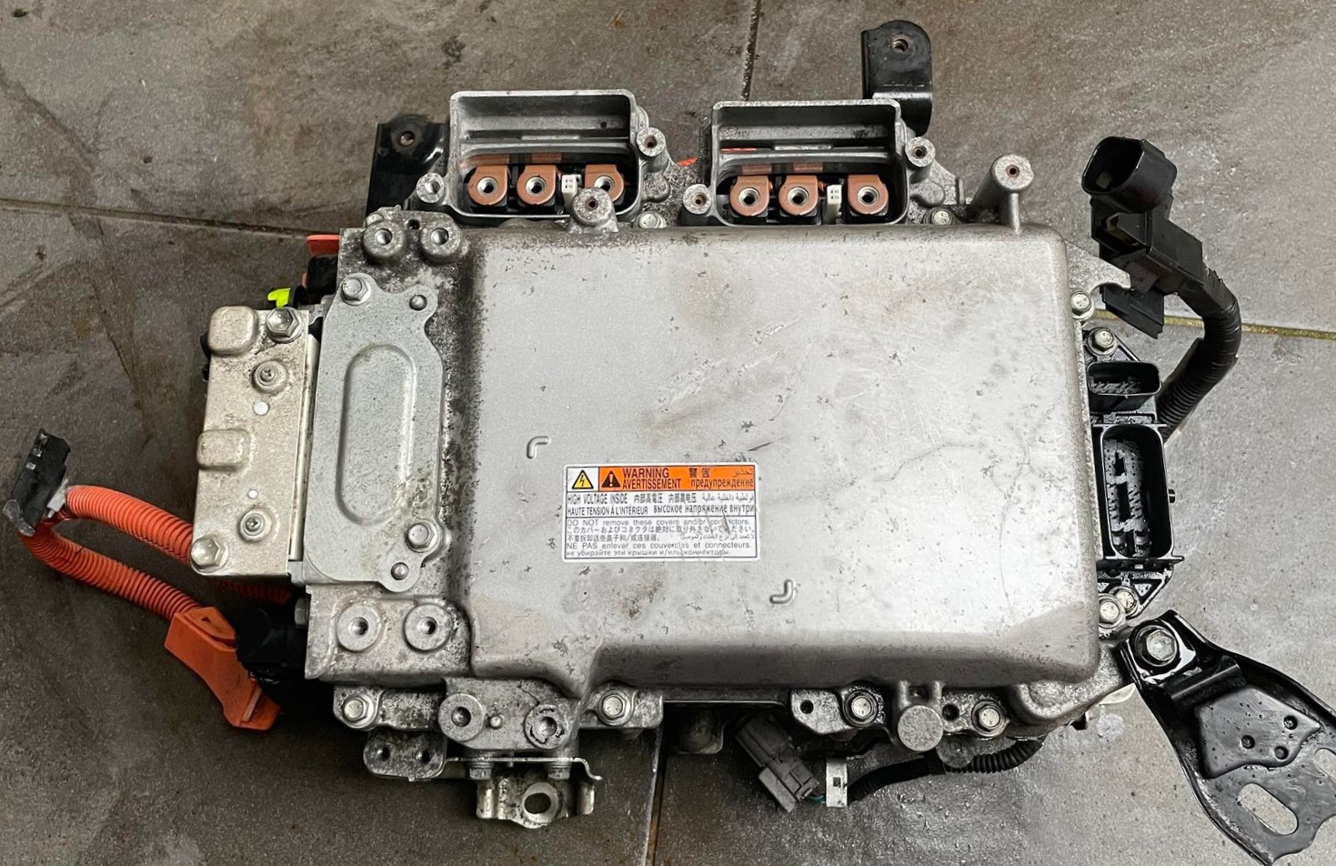

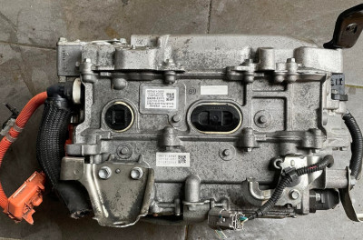

Here are photos of 2 candidate inverters (both from Toyota Camry Hybrids - AVV50, with P314 Trans). According to the only identifier I can make out, the part numbers are both G9200-33171.
Using the VIN for an Australian Camry - 6T1BD3FK30X142521 - the website https://japancars.ru/index.php?route=ca ... lk_id=8431 shows:
- Reference number - G9200
- vendor code - G92A0-33021
- Description - INVERTER ASSY, W/CONVERTER
- Release period - 11.2013 - 04.2015
- Note - AVV50
The thot plickens!

I'd start by looking at what the Logic Board and Power Board part numbers are, and if it has a 'Compatible 50 pin connector'. If they match anything on the wiki (https://openinverter.org/wiki/Toyota_Prius_Gen3_Board) then that inverter might be compatible.
HOWEVER - it seems the G9200-33171 DOES work according to viewtopic.php?p=27600#p27600
