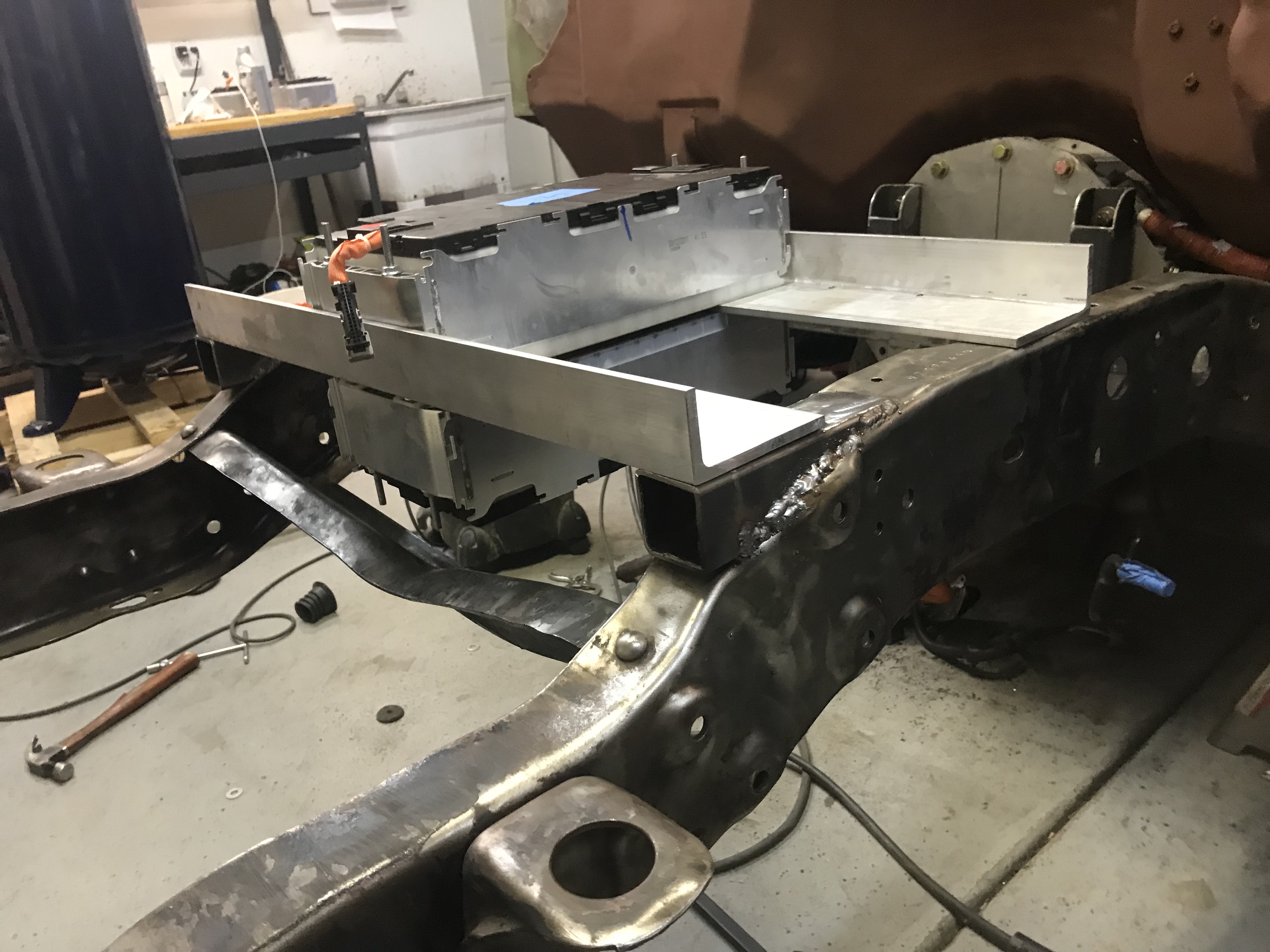

so this is what we are going for
- Gregski
- Posts: 2743
- Has thanked: 501 times
- Been thanked: 951 times
Fun Level = 0
36" divided by 4 equals enuff sticks for 2 battery modules
- Gregski
- Posts: 2743
so one on top and one on the bottom, upside down, bat style
- Gregski
- Posts: 2743
so this is the Oreo Cookie battery tray design, respectfully stolen from Sir Artur Kustusch
you know the saying: Good EV Converters borrow, Great ones steal!

Captains Log: Day 67 of the EV Conversion
I spent the entire afternoon/evening just spinning my wheels, ever had one of them days? I think I worked my butt off but honestly all I got to show for it is one hole that I drilled right under the firewall, which took undoing the entire cab and lifting it up 5 feet, that and an empty bottle of Cab
