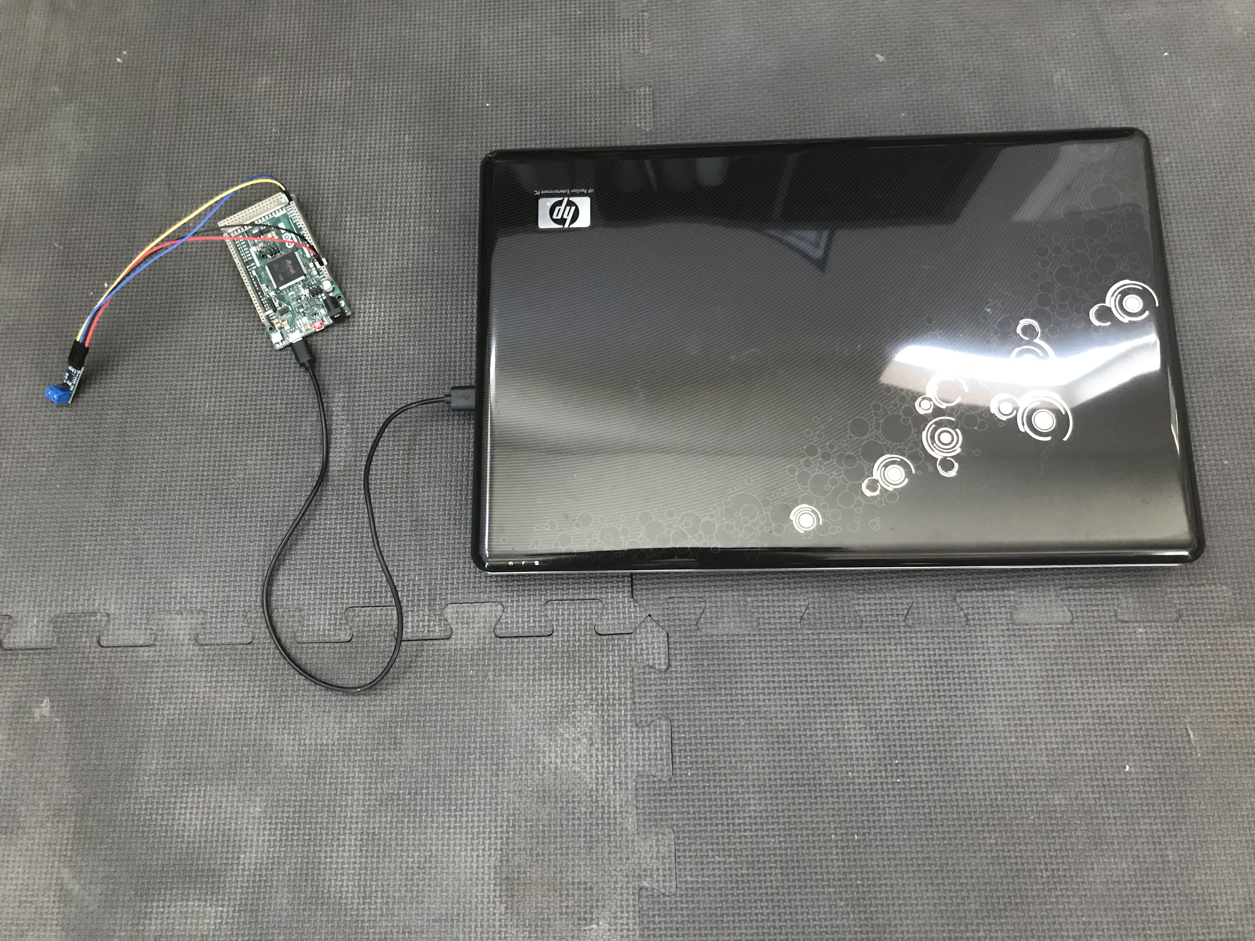

same concept here, just a bit less arcane USB cable
Gregski
Posts: 3161
Has thanked: 631 times
Been thanked: 1608 times
Post by Gregski »
and just like that we were back to where we left off, but with a different CAN Bus analyzer tool, hopefully a more better one (at least this one has a manual)

Post by Gregski »
LESSONS LEARNED
In the spirit of full disclosure thinking I would go out and buy a complete OEM Chevy Volt first gen J1772 charge port and wall charger, seemed like a good idea at the time, but i soon discovered it just complicates things, actually makes it impossible to control the charger, as the silly charge port or wall charger needs to be controlled itself do to the Pilot and Proximity connections

Post by Gregski »
and literally in the 11th hour I got it working but only by enabling both the low voltage and the high voltage chargers using the 0x03 bit and when I do so I can see amps on the high voltage orange wire going into the battery, it reads 3.5 amps which is approximately half of what I have it set to ie 8 amps, but that's because I am on only 120 volts AC

Post by Gregski »
Oh my goodness, it all works, I figured it out, and you will not believe what was the problem!!!
I was trying to charge an AGM deep cycle battery and not a "real" car battery. Who knew that won't work?

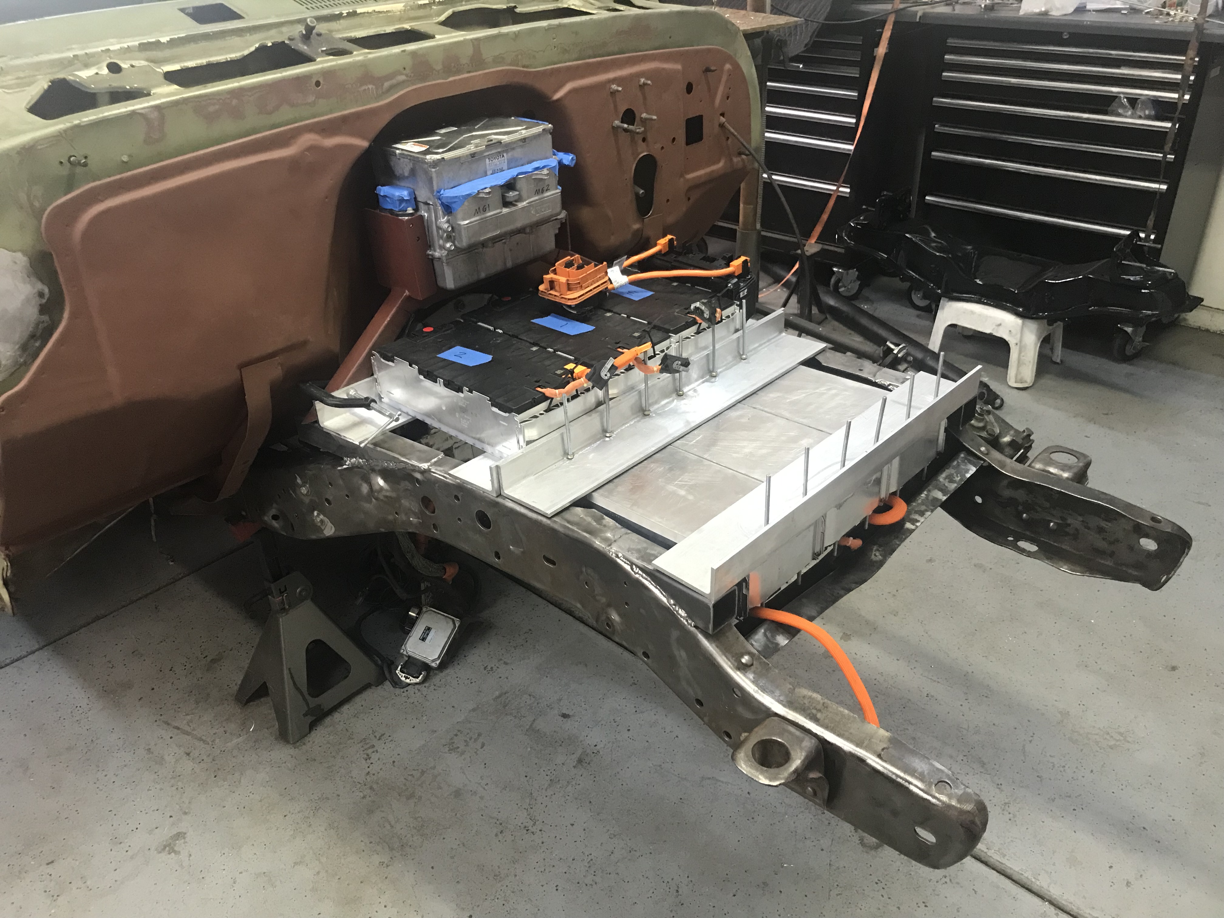

I learned a lot over the weekend, and today I had to rest my brain and do something with my hands....
Commence Operation Porcupine
Gregski
Posts: 3161
Post by Gregski »

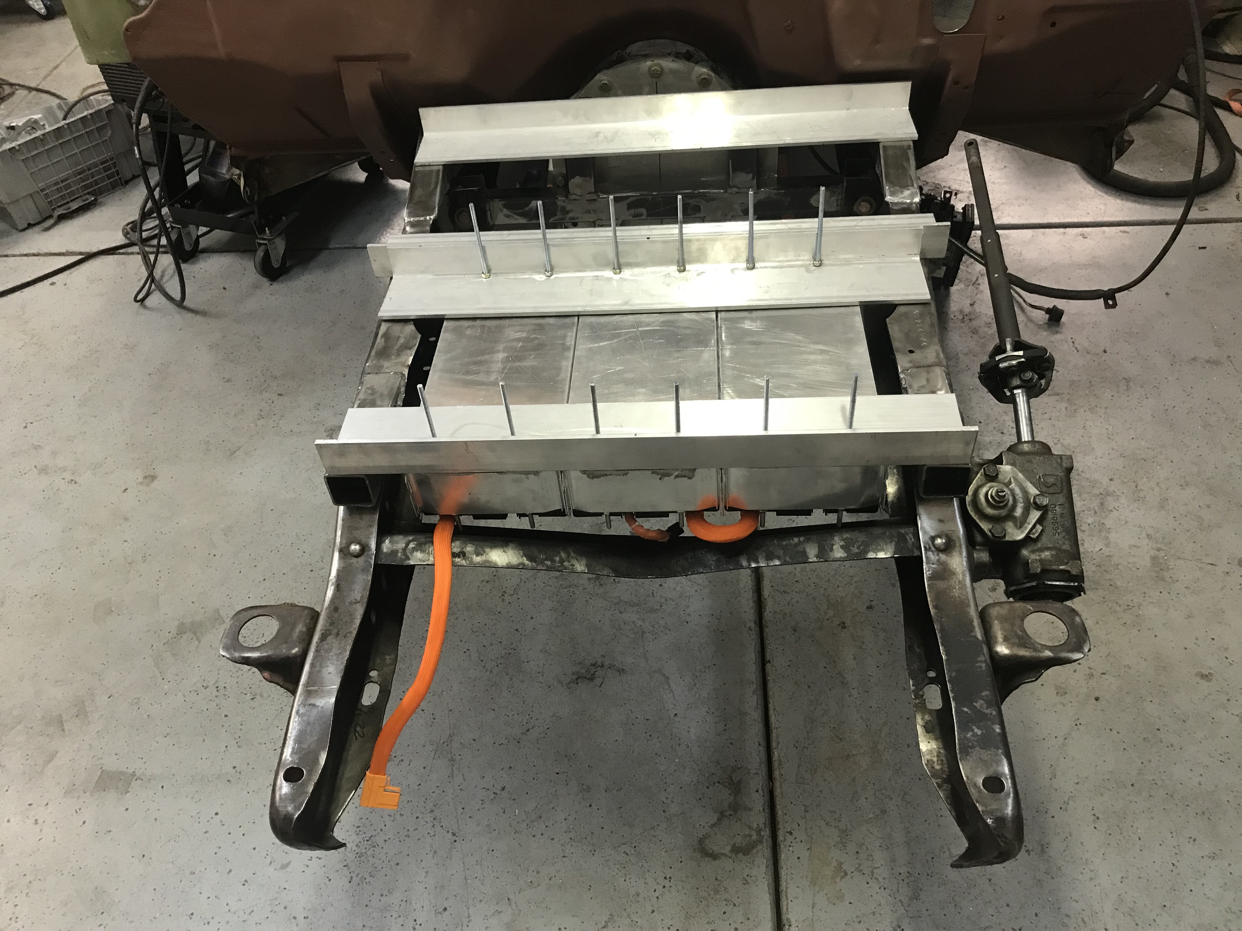

the idea is a modular design that will put crane operators out of business
first we load up the bottom three cell modules (each weighing in at just under 30 lbs)
once those three are individually loaded and bolted up, we simply flip that batch over - right side up
and now we are ready for the top batch
and there we have it, "The Stack" configuration (genius I tell yah, genius!)

Post by Gregski »
now every battery pack has it's pros and cons, be it a Tesla pack, a Nissan Leaf, or this BMW 530e, and this one is no different, one of the downsides of it is these unobtanium proprietary high voltage cables, it is a real challenge to reconfigure the standard pack layout whilst utilizing only the stock high voltage cables
some like this one joins two cell modules very smartly.... (we like, we approve)

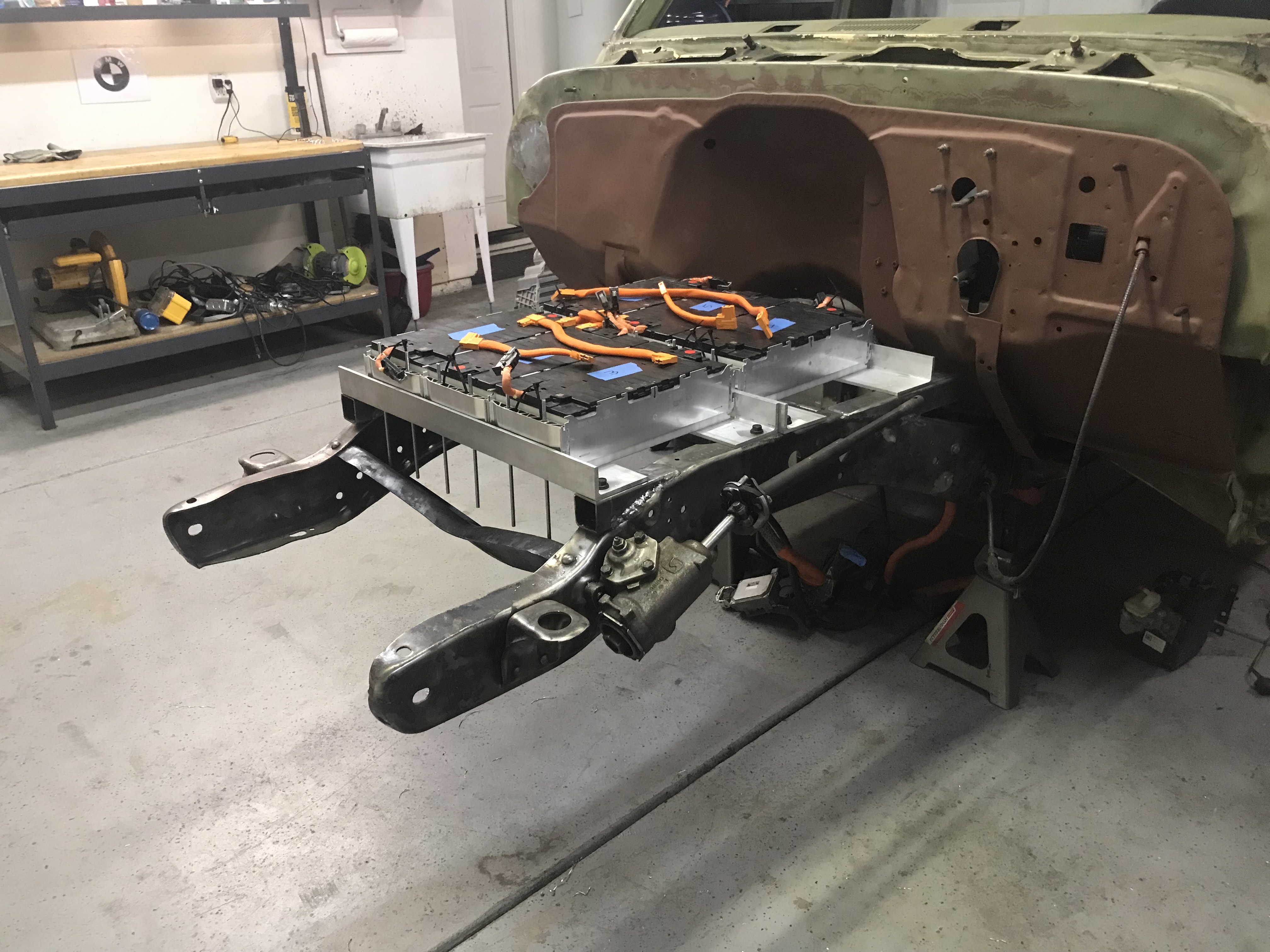

Post by Gregski »
here is one BMW 530e battery pack (Embedded Fun Fact: which consists of six cell modules, unlike the 330e which only has five) reconfigured in The Stack Formation, unfortunately we are unable to complete this arrangement because we are one cable short, technically we have the cable but it is just too short to join Cell Module #2 to Cell Module #3

Post by Gregski »
I'm a Simple Man, I see a gap... and I fill it!
yes we did run out of gas... (no literally)
but we recovered, and one side's done

Post by Gregski »
and onto the other side, having the frame rails level now is a total game changer
man I love a clean canvas

Post by Gregski »
alright, let's load 'em up proper
Gregski
Posts: 3161
Post by Gregski »
now I currently only have one pack installed here, but hopefully you'll get the idea how this design is meant to hold two of them, six cell modules on top and anther six upside down
