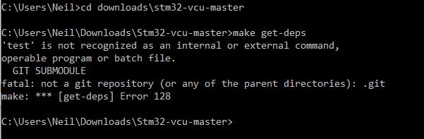

Ok. So ran make get-deps once and got a similar error:
Then opened the Makefile in Notepad and edited line 63: images: get-deps $(BINARY) to images: $(BINARY) and ran 'make'. This looks to do more but something still annoying it:
Wondering if your suggestion to remove 'get-deps' might mean remove the whole line, I tried removing the rest of that line $(BINARY) and ran 'make', but this still gave an error:
I'm thinking the 'make get-deps' didn't do what it was supposed to above

Googling some forums and working through this. Originally I had only downloaded the repo zip files so went back and cloned it properly and using git bash tried the 'make' command again. More happening this time. Stopped on an error again, ran make get-deps and got another error.
As per previous suggestion, I edited line 63 of the makefile (images: get-deps $(BINARY) and removed get-deps from the line). I know get-deps didn't run right but tried anyway. Running make again gives similar error to before.
More homework to do :)

Oh I thought you were already compiling per your other thread.
I faintly remember this happening on Zapateros Windows machine. I "solved" it by copying the already compiled libopencm3 over
In fact you only need the static lib for the STM32F1, attached it. Extract it into libopencm3/lib
Then, with get-deps removed you should be able to just run "make"
EDIT: also it doesn't seem to find the eabi binaries. If you type "arm-non-eabi-gcc" what happens?
