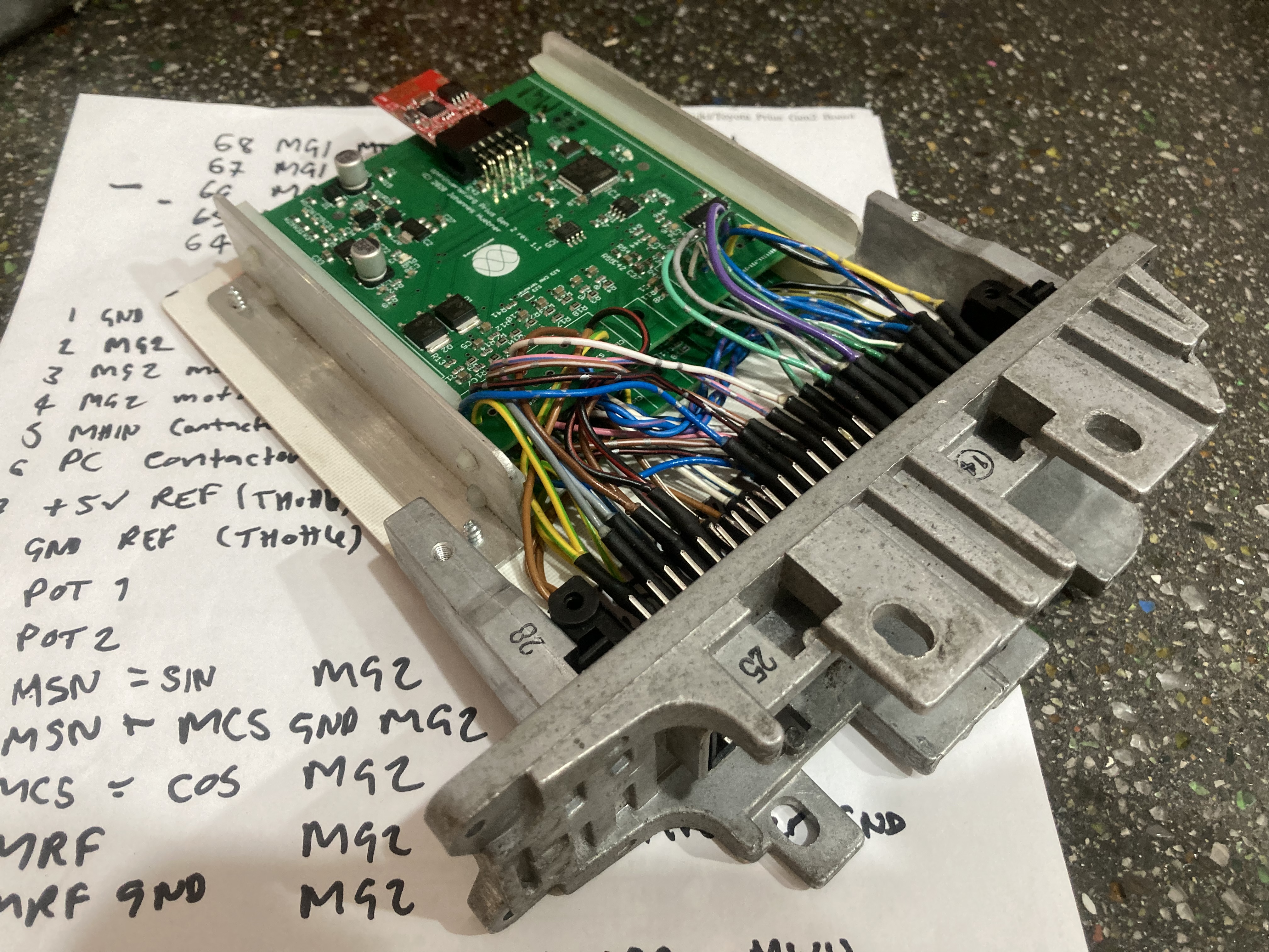

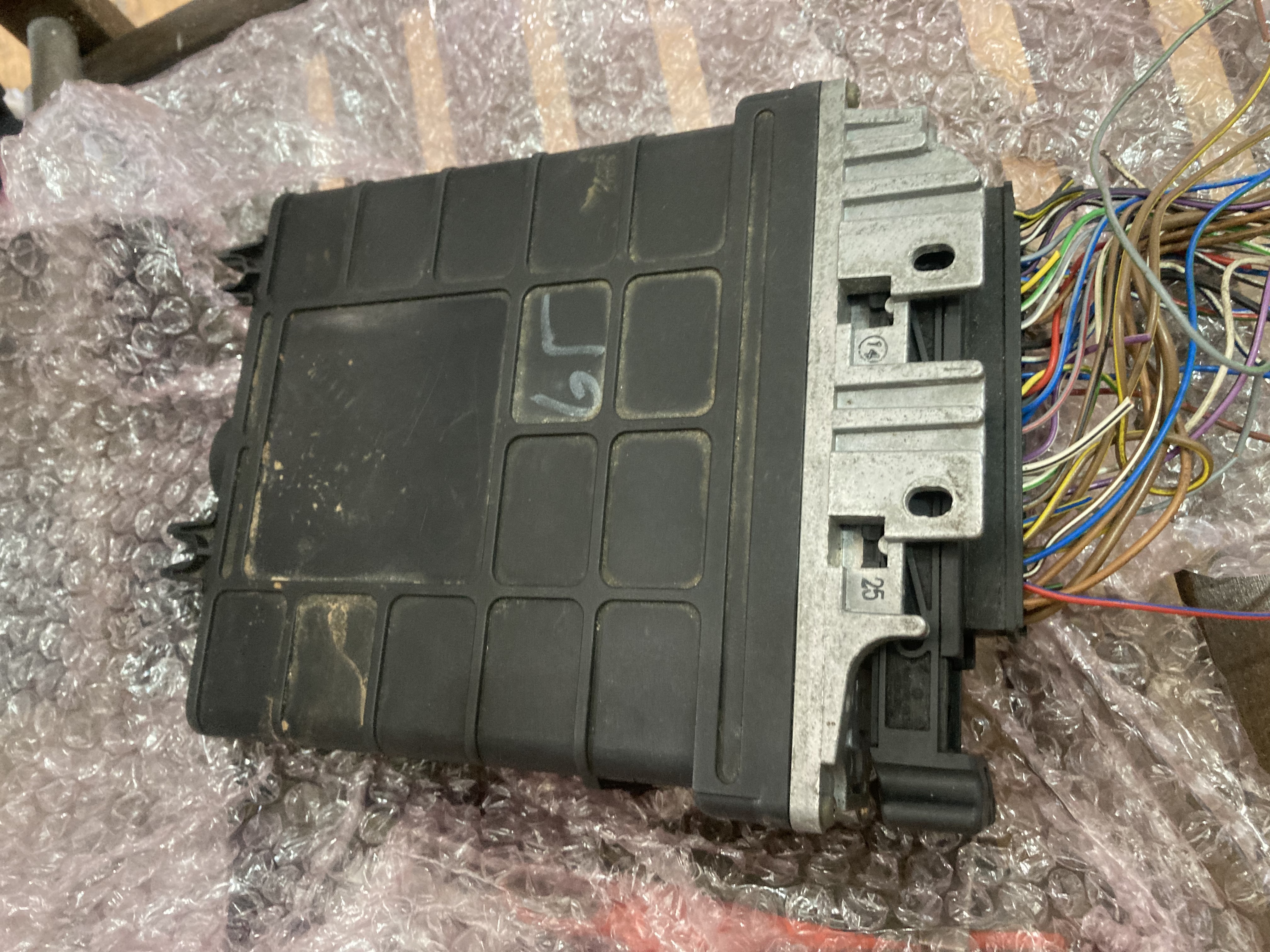

At last i can no longer put off the control electronics!

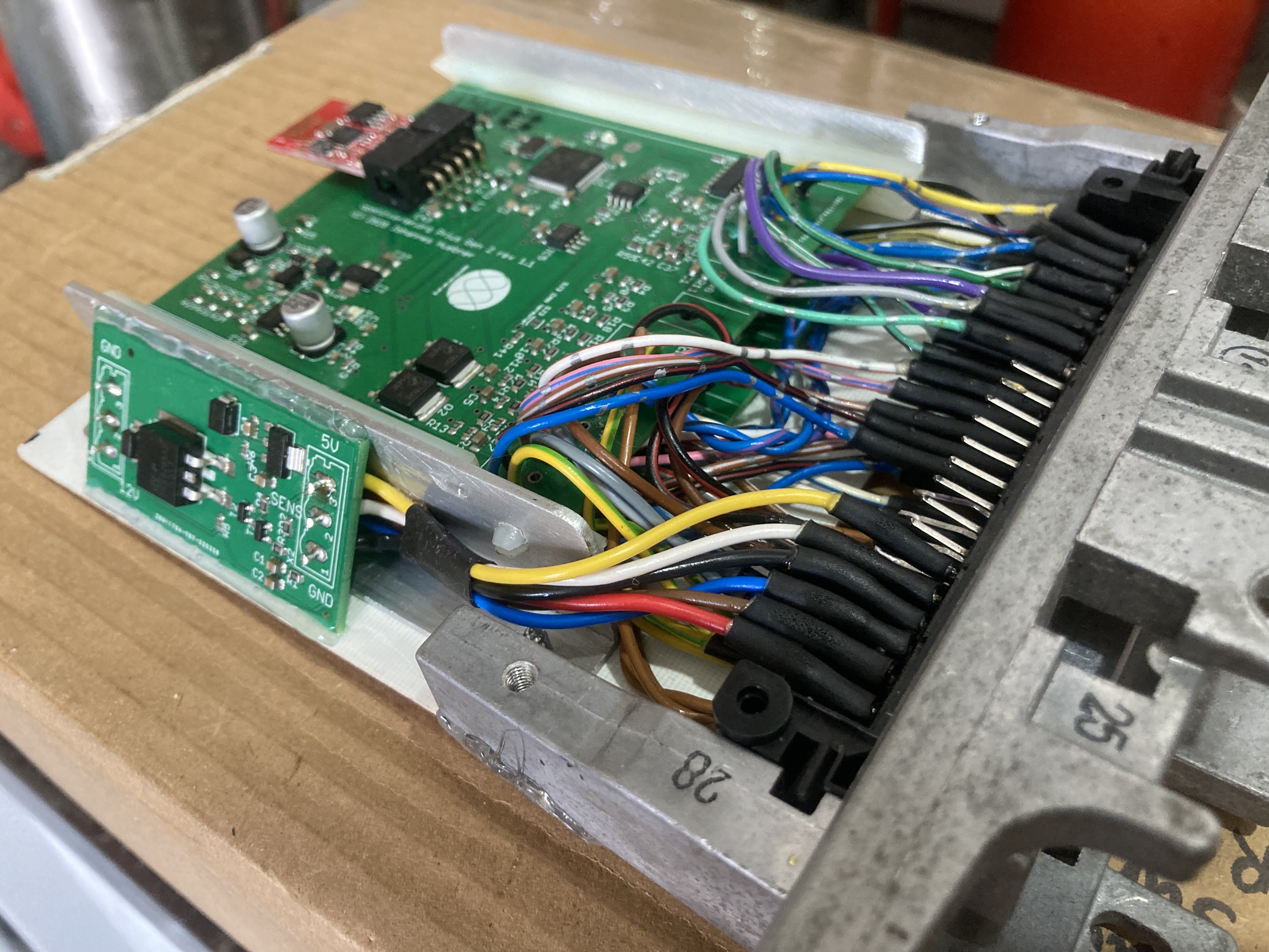

Will the lack of availability of Modice enclosures and the fact I want to drive both mg1 and mg2 in this inverter I have squeezed 2 gen2 Prius boards into and old vw ecu housing

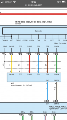

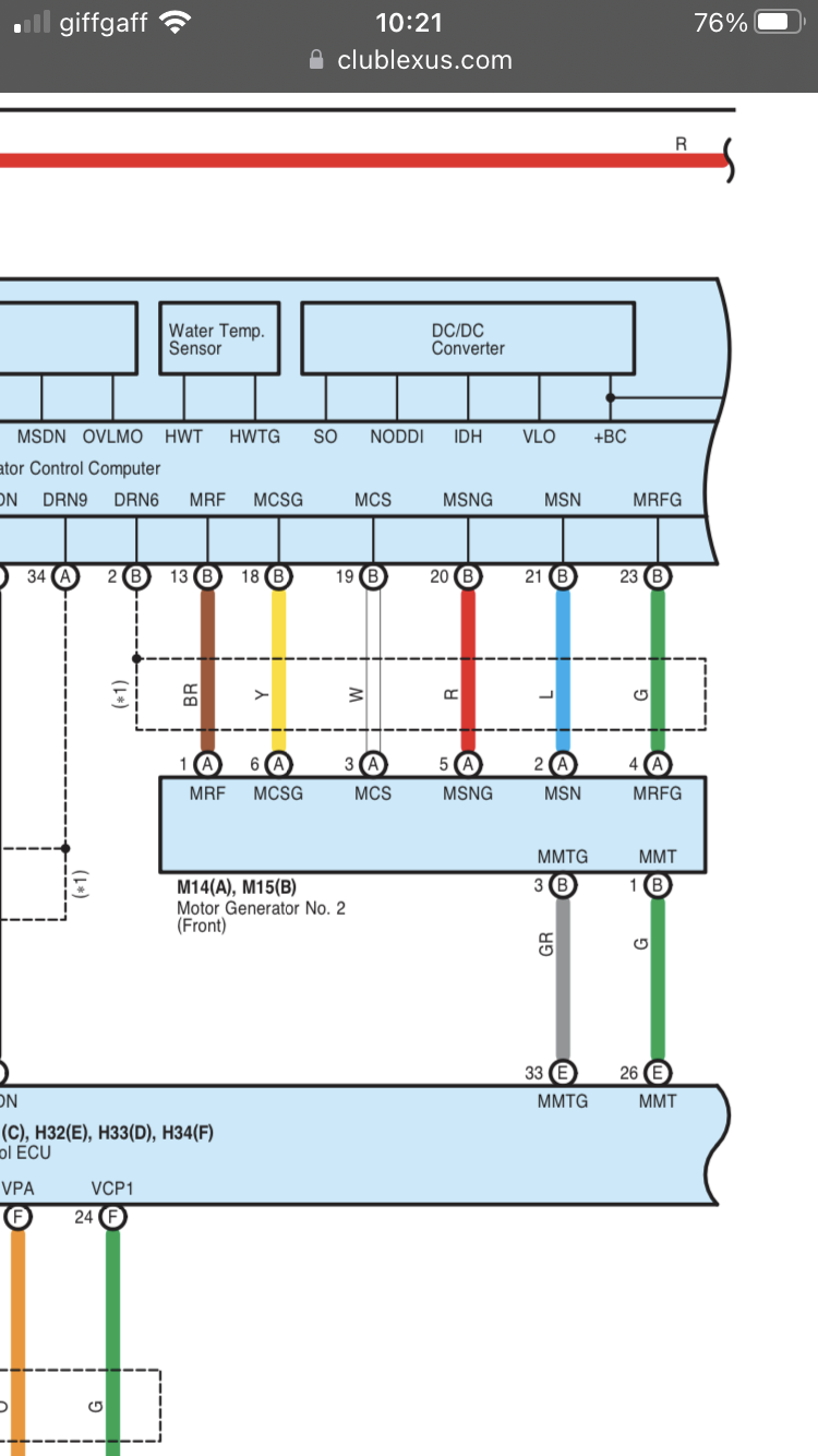

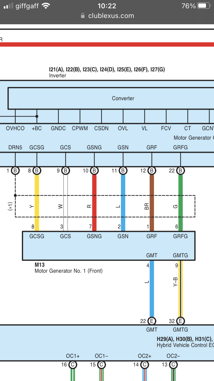

I have also found resolver pin outs for the rx400 transaxle so that should help take the guesswork out of resolver wiring
Ev8
Posts: 818
Has thanked: 43 times
Been thanked: 163 times
Re: Project RX8 , Prius gen2, Lexus transaxle to rwd
Post by Ev8 »

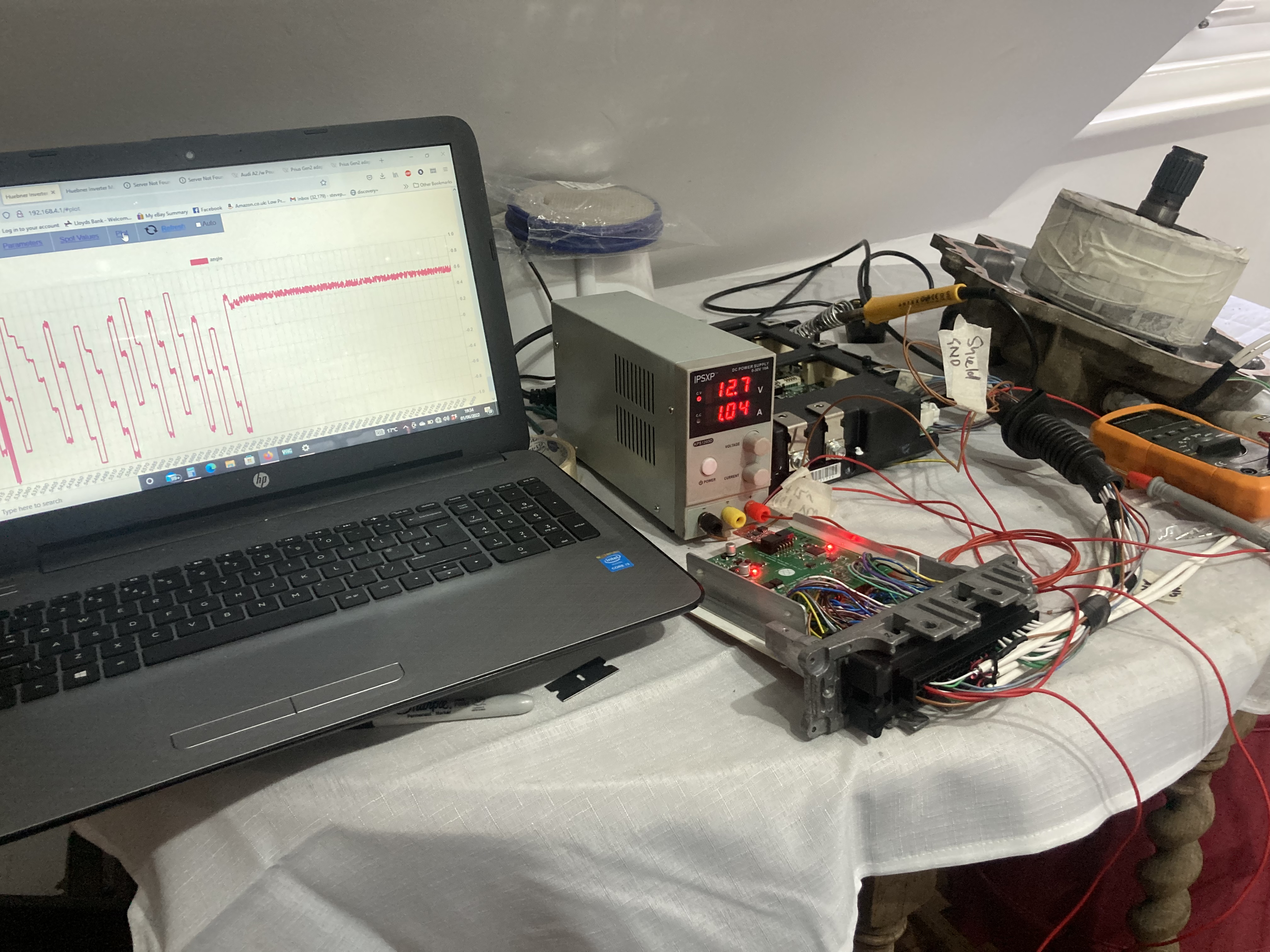

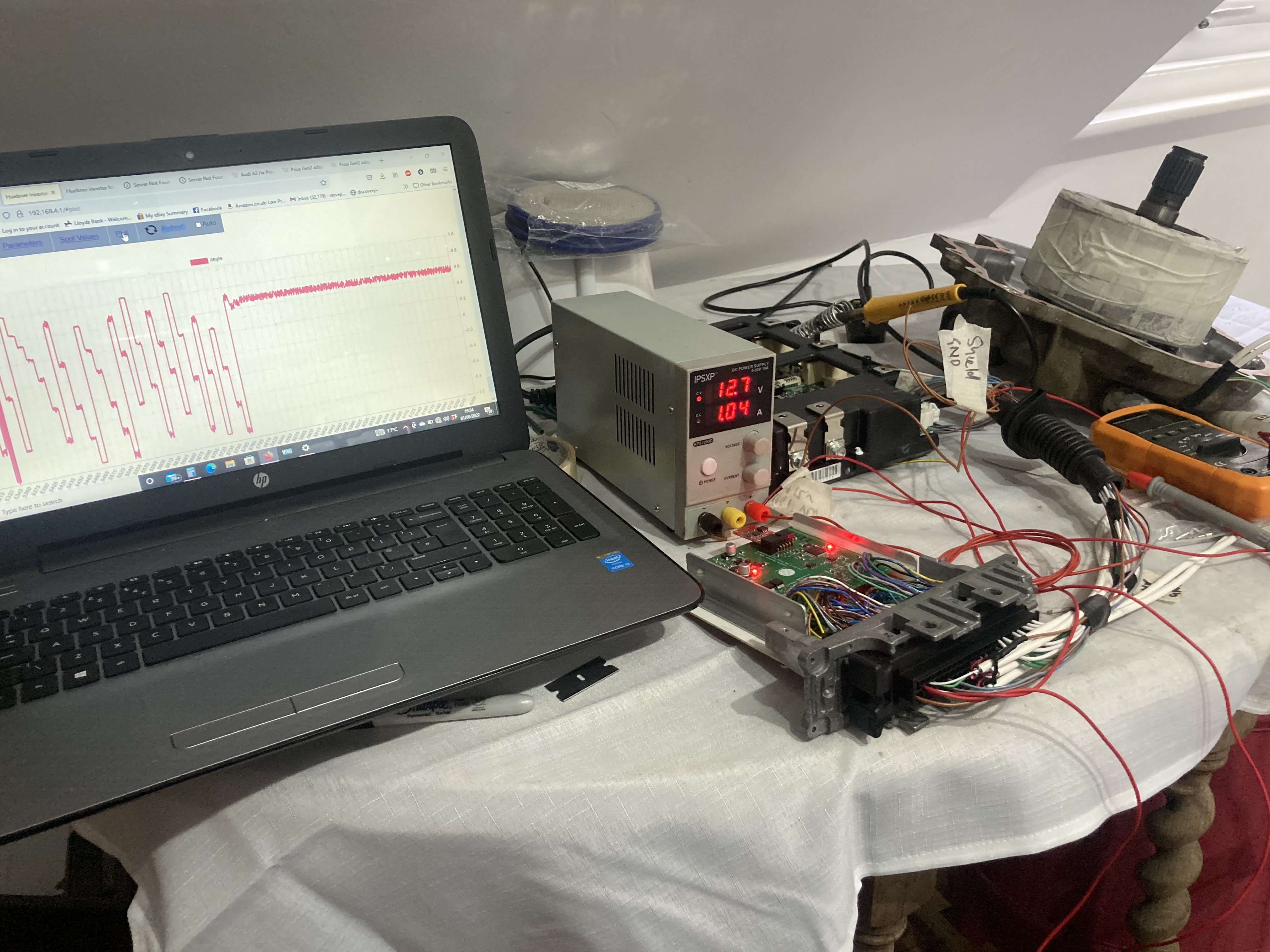

Well a little testing with bits of inverter and motor on the smallest table possible has confirmed resolver wiring is good

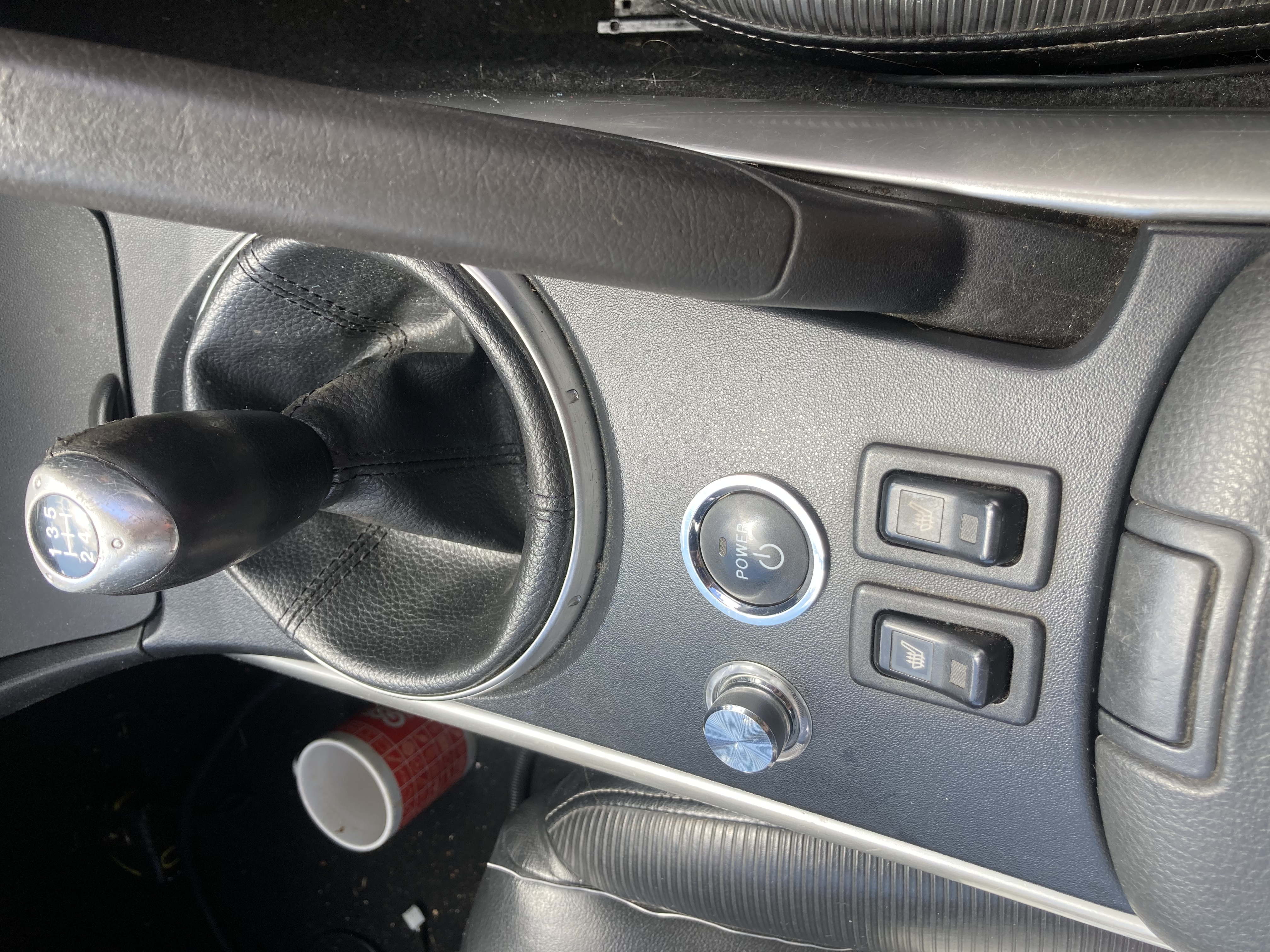

Vacuum pump control circuit squeezed into the vcu case
Prius power switch for start signal and manual regen pot

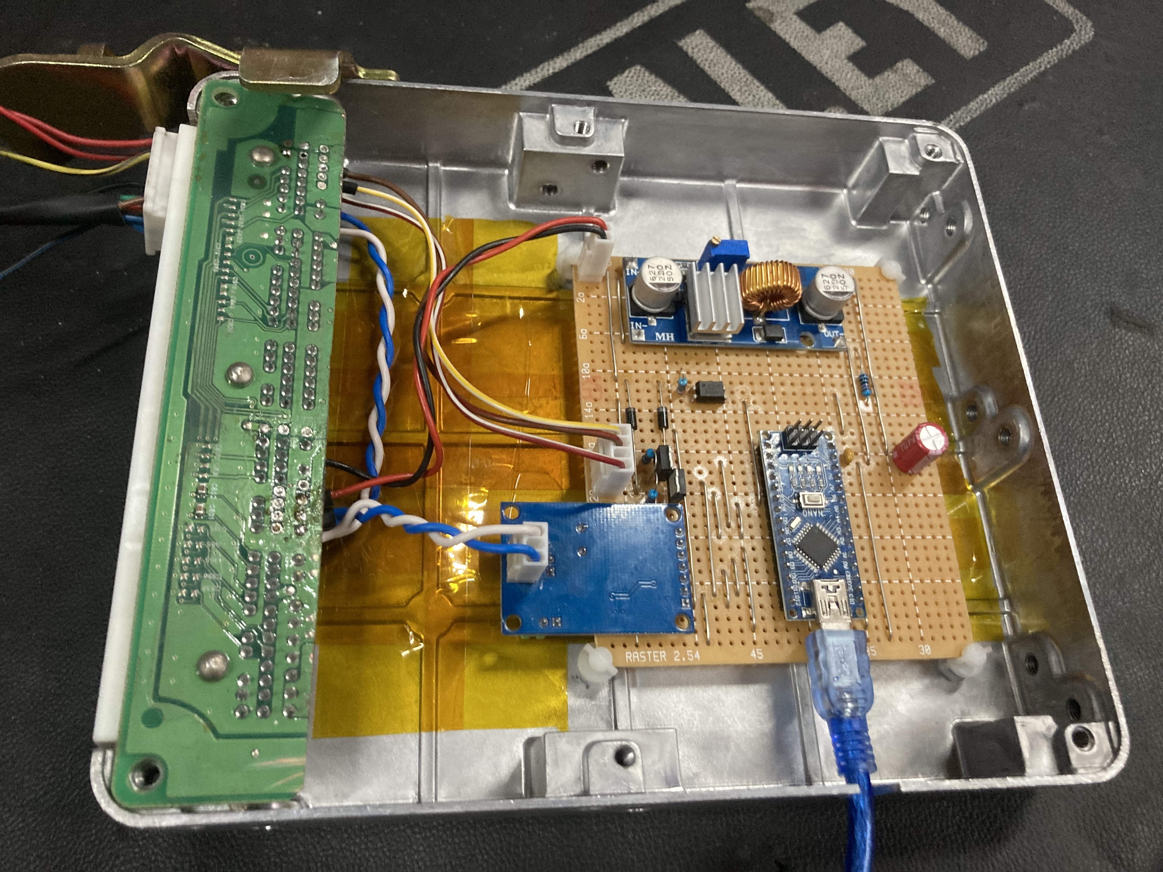

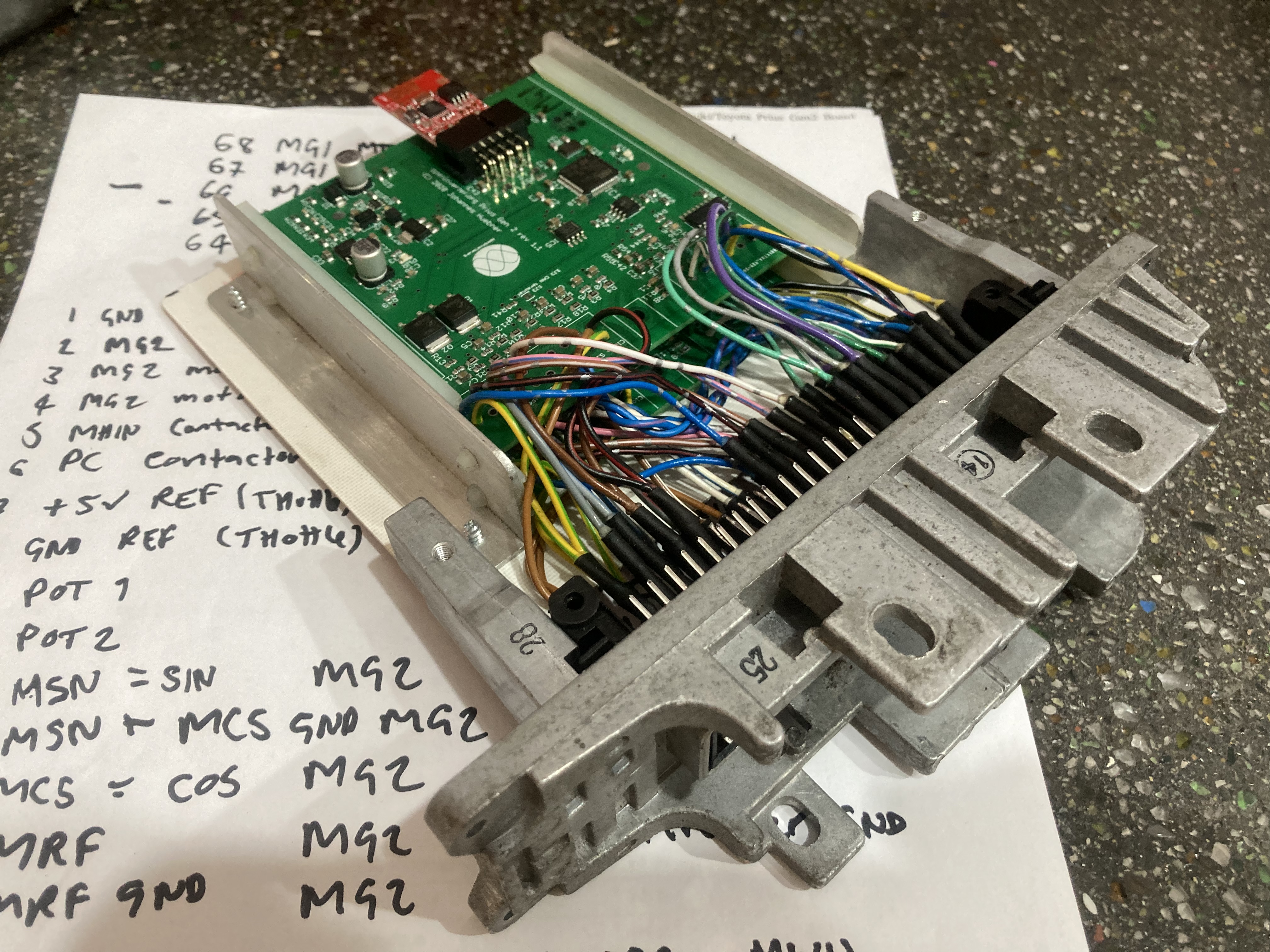

So I’m order to carry out more testing I needed to get the power steering and dash working without the original engine ecu, having discovered that I couldn’t use can messages straight from the open inverter board thanks to the way it sends 16 but values across 2 bytes being the opposite of what the car wants, I had to build a little arduino board to take messages from the vcu and on one can Id change the byte order and spit them back out on the id’s for the dash and power steering.
I also added a couple of small fets for driving things, such as switching on and off the auxiliary oil pump,
Placed it inside the case from the original ecu,
Ev8
Posts: 818
Post by Ev8 »
Ps yes I know the power supply is overkill but I had it in the spares box
Ev8
