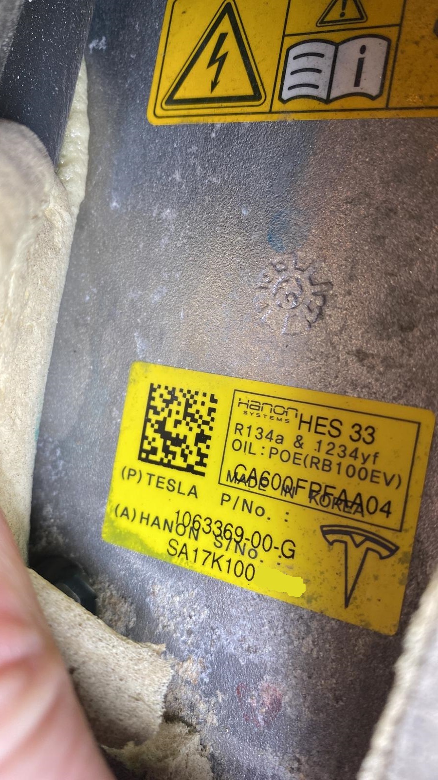

Anyone gave this one already a go?
Part nr: 1063369-00-G
Pin 1: 12VDC
Pin 2: CAN+
Pin 3: CAN-
Pin 4: GND
Connector = Molex 33472-0401
Update:
CAN ID:
0x223
0x233
0x363
0x223:byte5 higher nible bit 0 toggles on reception of 0x28A;
0x233:byte0 & byte 1 contain HV voltage (45 02=60VDC, 7A 01=40VDC)
0x363: Firmware info/data;

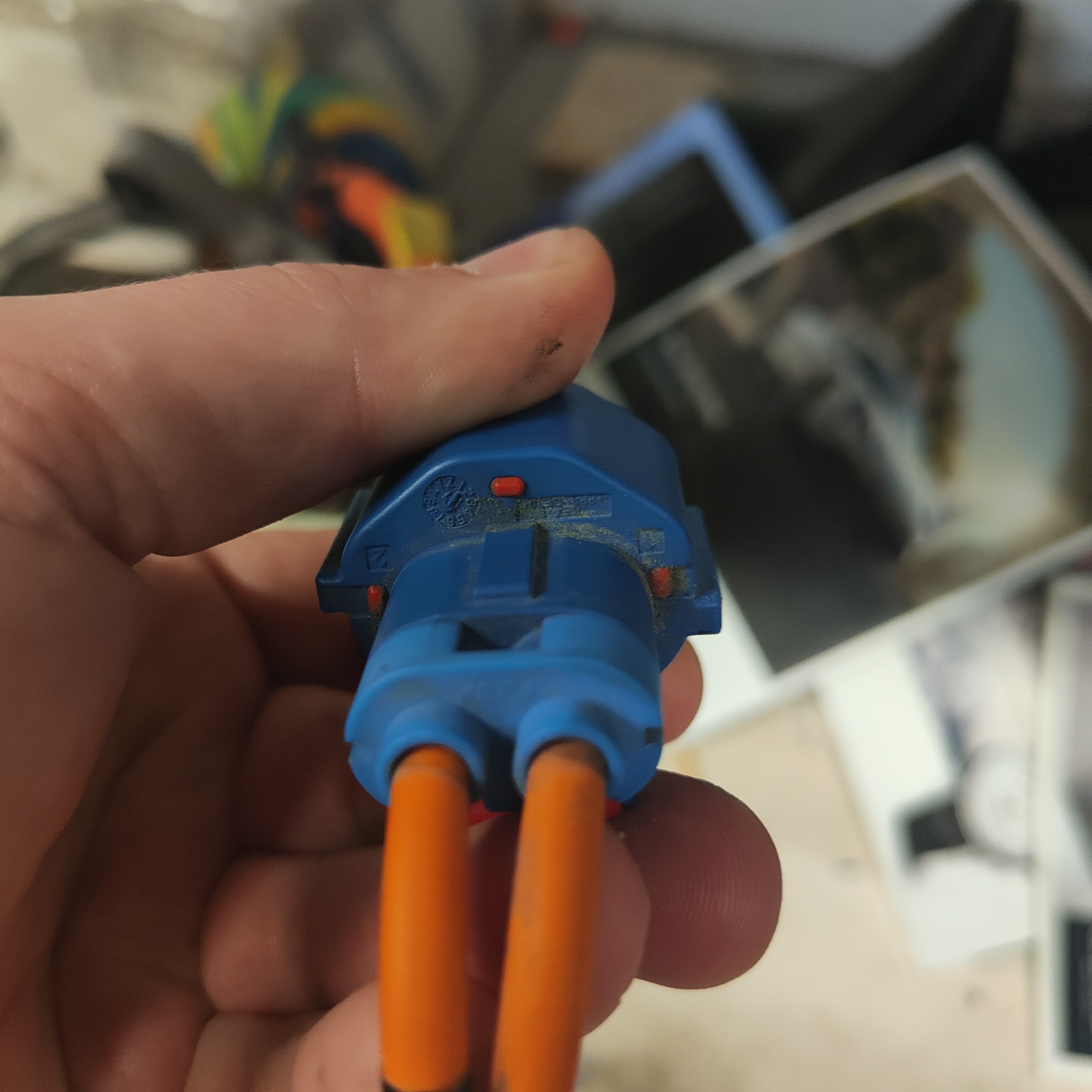

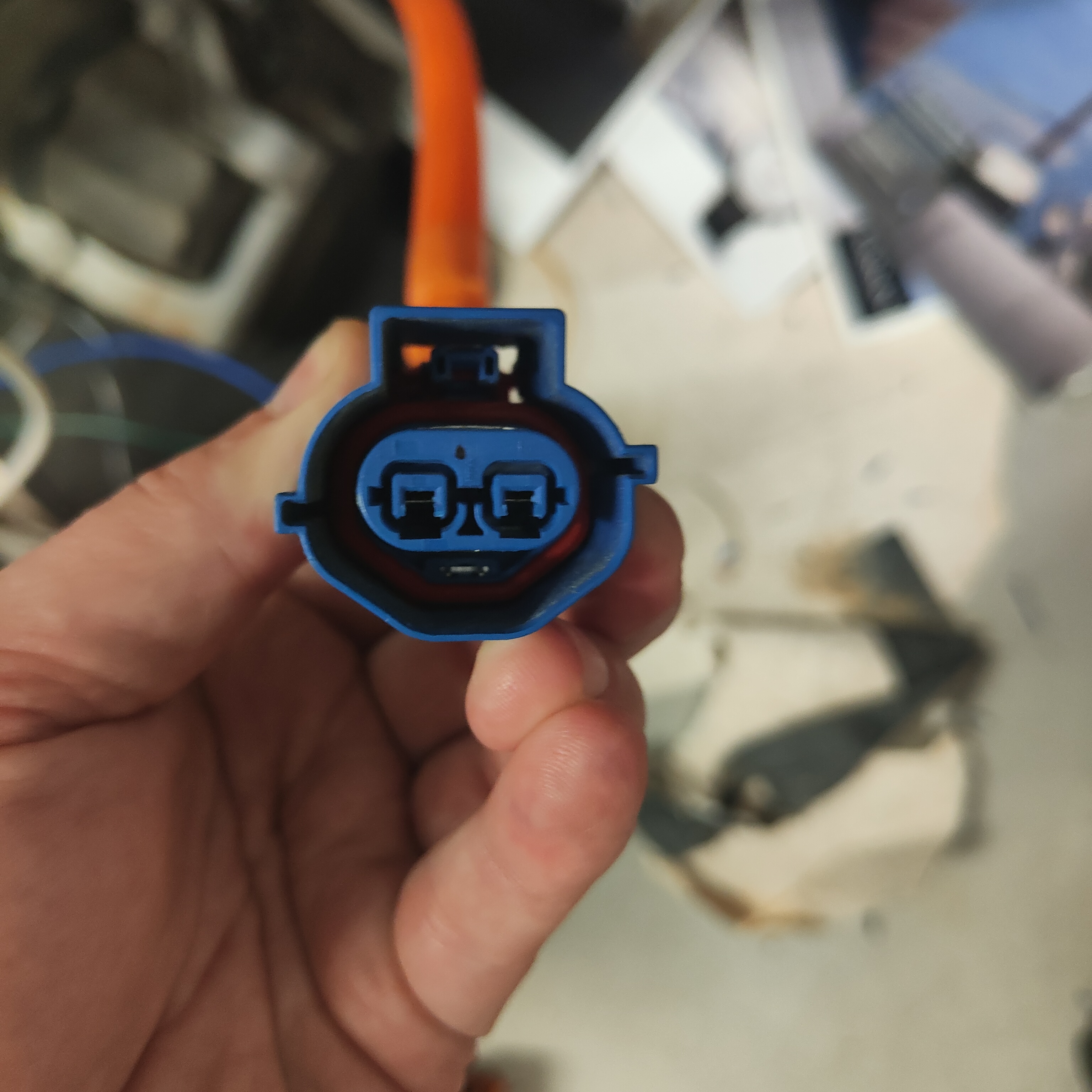

I'm looking for this connector someone can help?
