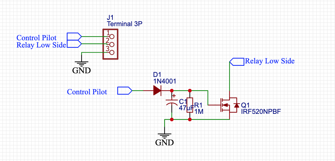

So if you just want to wake up on CP.
Quite a simple circuit, has worked will for me so far in most applications.
Been thanked: 1918 times
Re: How to detect a Type-2 EVSE connection
Awesome, thanks!
Just one question: how does it disengage? I mean how is C7 getting discharged?
It's Toms design from 5 posts above. Just added a high value (2M7) resistor in parallel to C7.
Feeds the pulsating CP signal through a diode so it can only switch ON the nfet, not off. C7 makes sure it stays on during the off-state of CP. The nfet switches a pfet (could also be a relay) that supplies the loads (pump, charger,...)

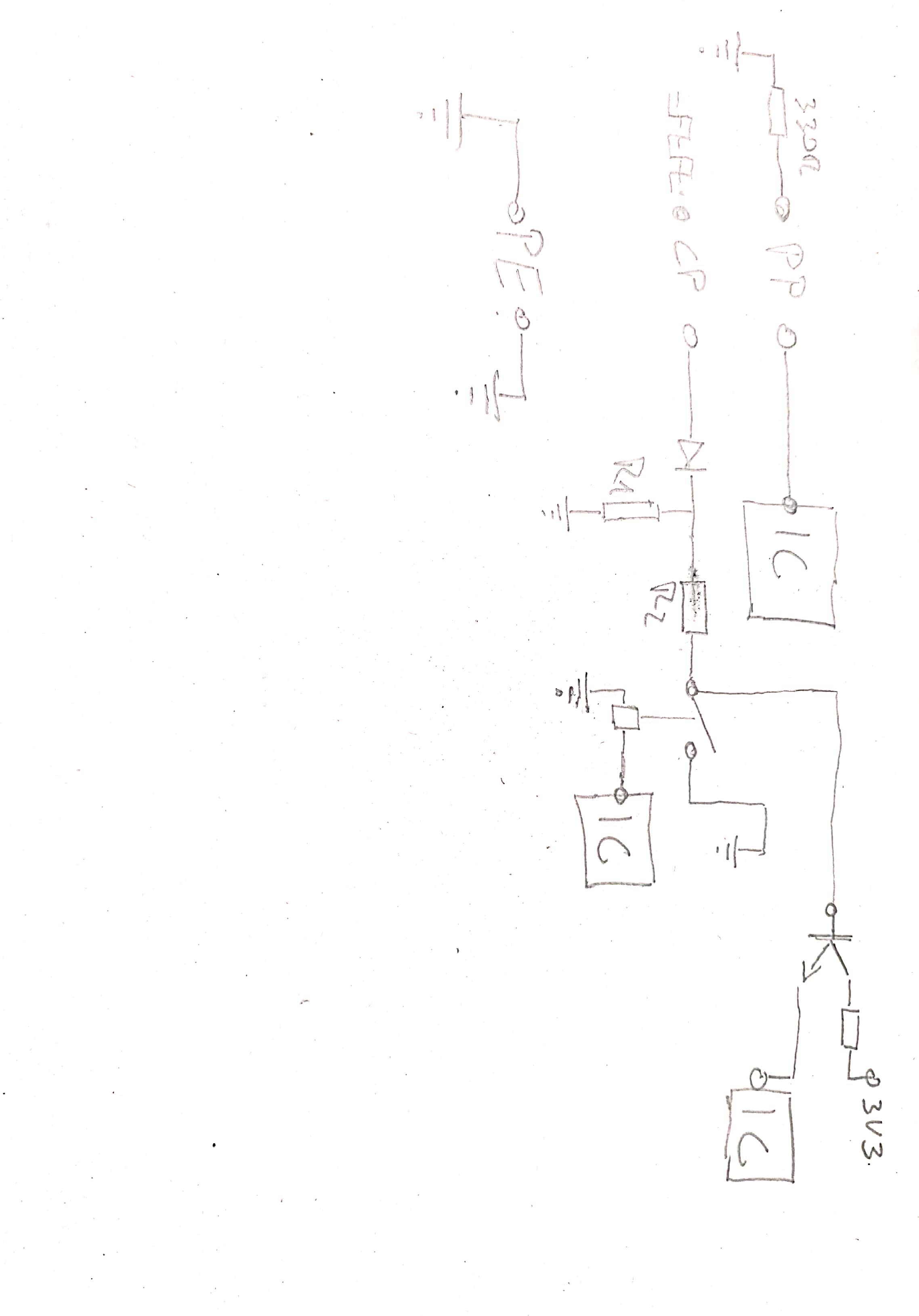

Posts: 3796
Been thanked: 413 times
Bigpie wrote: Wed Aug 11, 2021 8:16 am I've made one of these, but this causes the EVSE to close the relay, probably not the end of the world, but I'd rather it didn't but I can't think of a way to achieve this.
At the minute I'm using the even poorer mans method of leaving the key in the ignition so the charger/DCDC, BMS etc get powered up
Like i said i use PP to pull down IC pin x and signal EVSE is conneceted.
Then i connect CP through diode and R1(2K7) to GND directly. R2(1K3) is connected through relay to GND so it forms a divider on connection. IC is managing the relay. Then i connect small Nmos gate to R2 so IC can sense PWM. I still need to sort out the code for PWM duty sensing but everything else works.
Important difference with using PP signal for sensing is i can use it passively without anything connected to CP pin. I can also delay connect condition and start pumps and DCDC in any order i choose. For example Your circuit wouldnt work well with Outlander charger. There may be other devices also...
I could build RC filter and sense resulting voltage with analog pin too, but then CP result becomes unstable...

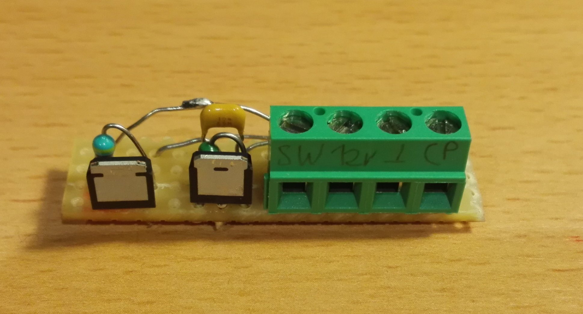

I have integrated above circuit into a Gen2 Tesla charger. So now permanent 12V can be fed in via Pin B12 which is otherwise unused. Its traces are beefy enough to carry the current. CP and GND are stolen from the control board as well. Switched 12V is then send back to what is usually the 12V supply input. So as soon as CP is detected the charger turns on and with it the DC-DC converter, BMS, contactor supply and water pump. In the Volvo conversion 4.5A are consumed and the traces are holding up.
Here's a picture. Red cable not yet soldered to the correct pins, should be on the two bottom ones
