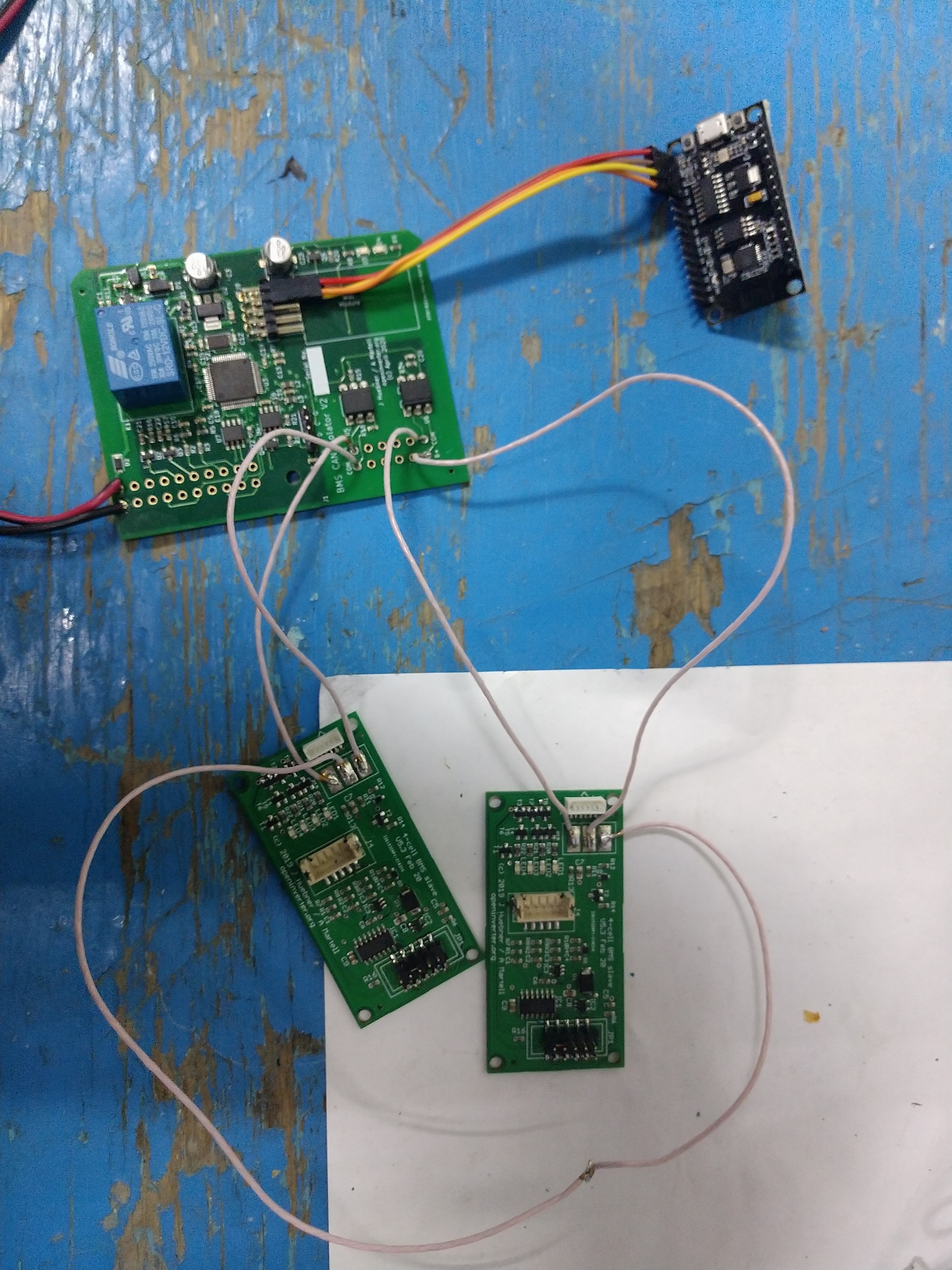

Here is my setup
when i connect batteries slaves blink 4-1 slow
when i connect power to the main board they stop blinking and after 1-3 sec first slave starts blinking 4-1 really fast
second module does not blink

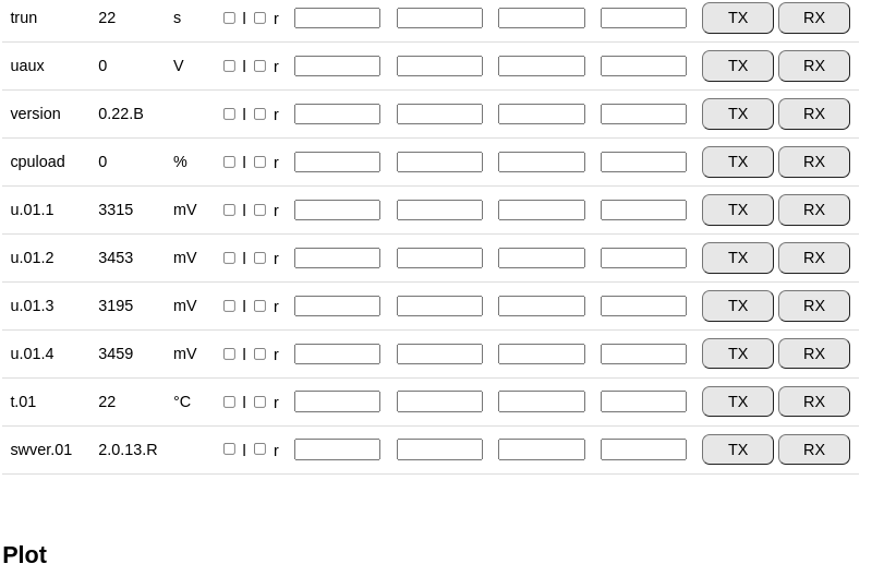

in the interface it shows only first module

That wiring looks fine to me.
I had the similar issue of only seeing the first module in the interface. That was because I had the slaves connected to the battery the wrong way around so the first slave board was on the most positive side of the battery instead of the most negative which it should be.

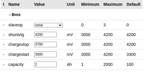

I don't think that was flashing fast though when it did that. What is your shuntvtg set at? When I was balancing the cells that were being shunted down would flash rapidly.

Post by wacomg »
I have properly connected most negative side to the first slave module
but it doesn't help
It can see only first module

when i set shuntvtg to 3400 it light up 2 diodes , as far as i can see, for second and fourth cells

Re: 4-channel BMS with daisychain bus
Is modcount set correctly? (2)

Oh right, the binary on github doesn't have it yet.
So both modules are flashed ok and give you a running LED when reset and not connected to master unit?

johu wrote: Thu Mar 31, 2022 9:20 pm Oh right, the binary on github doesn't have it yet.
Hello !
both modules give me running LED 4-1 slowly until i power on master unit
when master unit starts both modules stop blink then on first module one led blink onse
then on the first module i see running LED again but much faster
the second module no longer blinks at all until i reconnect power
Interface shows only one module

I've had that happen in the past when a data connection wire between the slave boards fell off, every slave board after that one in the line stopped blinking.

You need to connect at least two cells to be able to generate stable 3v3 for the MCU. The last cell must be connected to channel 2 and 4 for power supply
