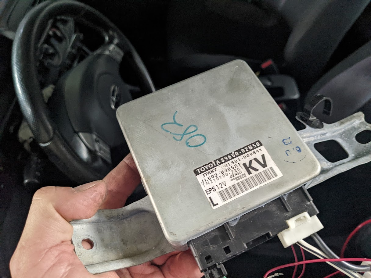

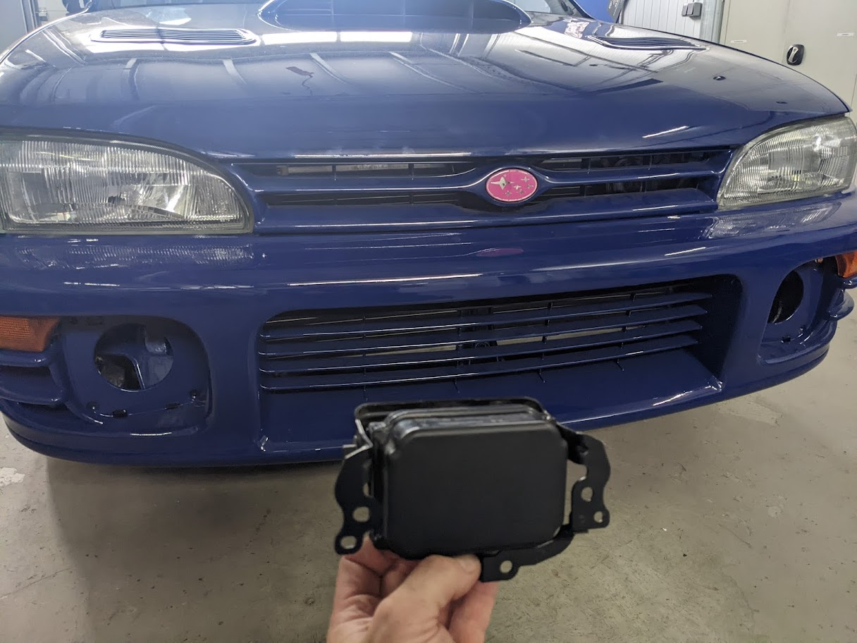

What i figured out is that i need the steering angle sensor, too.Bratitude wrote: ↑Wed May 11, 2022 1:43 pm
Pretty much!
you need:
steering(done!)
Brake(half way there?)
throttle(done)
vss (done!)

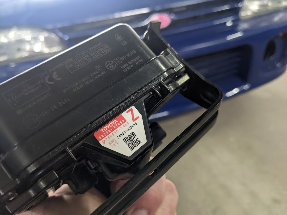

radar (easy)
Here’s the open pilot fork for old cars : https://github.com/Lukilink/openpilot
Unfortunately it doesn't fit properly in my steering column.
Any suggestions for easy to install steering sensors?

Also it seems they use newer versions of the power steering. Is the Prius 2007 EPS working for openpilot, too? Maybe someone knows?

Hm... you could install clio or corsa epas...rally cars have them installed a lot. But that goes under the steering wheel.

Find a legacy diesel, they have eps.

I already added eps from a Prius 2007 but it seems you need an eps that already supports LKAS (Lane keep assist)

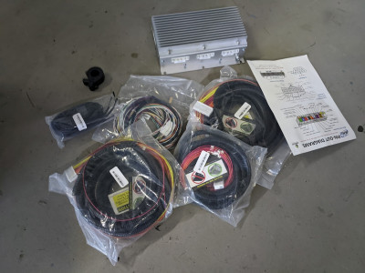

Meanwhile the long ordered Orion BMS from EV-Shop Europe in Romania arrived. I ordered the Orion the second time with them as they are very reliable and also have the cheapest offer in Europe.
I then fabricated a proper mount for the BMS:
In this position the original boot carpet has a door for the car lift and spare wheel tools. Now one can access the BMS there.

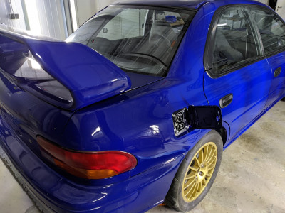

before painting the car again i installed the CCS charging port (uninstalled it for painting, again)

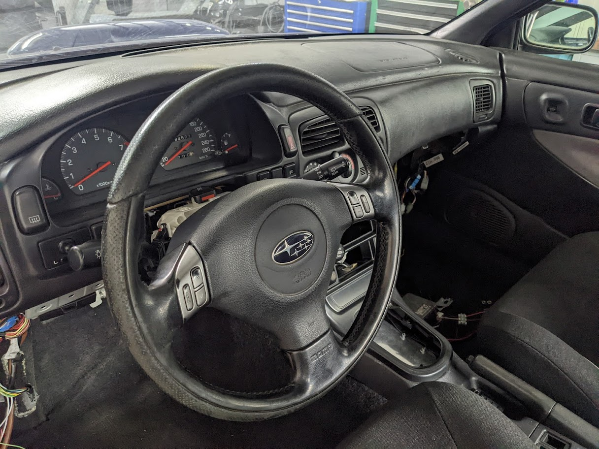

I've build another EPAS that has support of can bus controlled driving. The EPAS is out of a 2018 Toyota Yaris:
I now have a steering wheel from a way newer Subaru that has the cruise control buttons and also radio control buttons.
Also it has the steering angle sensor, that is needed for comma.ai This EPAS control unit is out of a 2018 Toyota Corolla and it is compatible comma.ai I also bought the radar sensor that will go in the front of the car and is compatible with comma.ai, too:

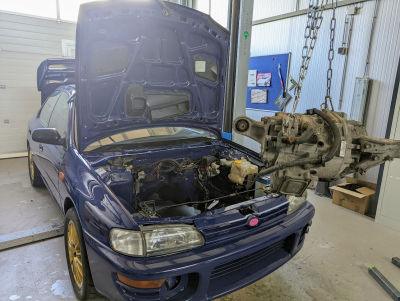

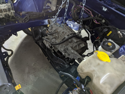

I'm test fitting to front motor. In the next few days it should be finally in the car.

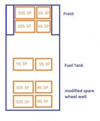

I realized that it would be very difficult to put all 96 cells in the car (actually there are 98 in the Kona but the version of the Orion BMS i have can only handle 96 cells).
i can easily fit 86 cells like this:
That would result in:
Kona OEM 98 Cells /// 86Cells
KWh: 64 /// 56
Kg: 333 /// 292
Volt: 294 - 401 /// 258 - 352
Johannes told me that i have to derate KW linear by the amount of cells i'm taking out.
86/98 = 88% of the original capacity.
That would mean the Kona had 160Kw and i could only pull 140 Kw.
The maximum of charge power the Kona sees is 78 Kw so that would be 68 Kw.
What do you think, could i still pull 160Kw out of the 86 cells?
70Kw charge power would be alright for me, so that's not gonna be an issue.
I'm determining at the moment how i solve the battery-puzzle. I need some opinions here:I realized that it would be very difficult to put all 96 cells in the car (actually there are 98 in the Kona but the version of the Orion BMS i have can only handle 96 cells).

The maximum peak amperage per cell is the same. So if you lower the voltage then Kw peak will be lower. So it depends on the margin/ amperage of the cells.

Power Density gravimetric 1.08 kW/kg volumetric 2.55 kW/l
That means that 86 cells are well capable of still delivering the 160Kw, of course not continuously
