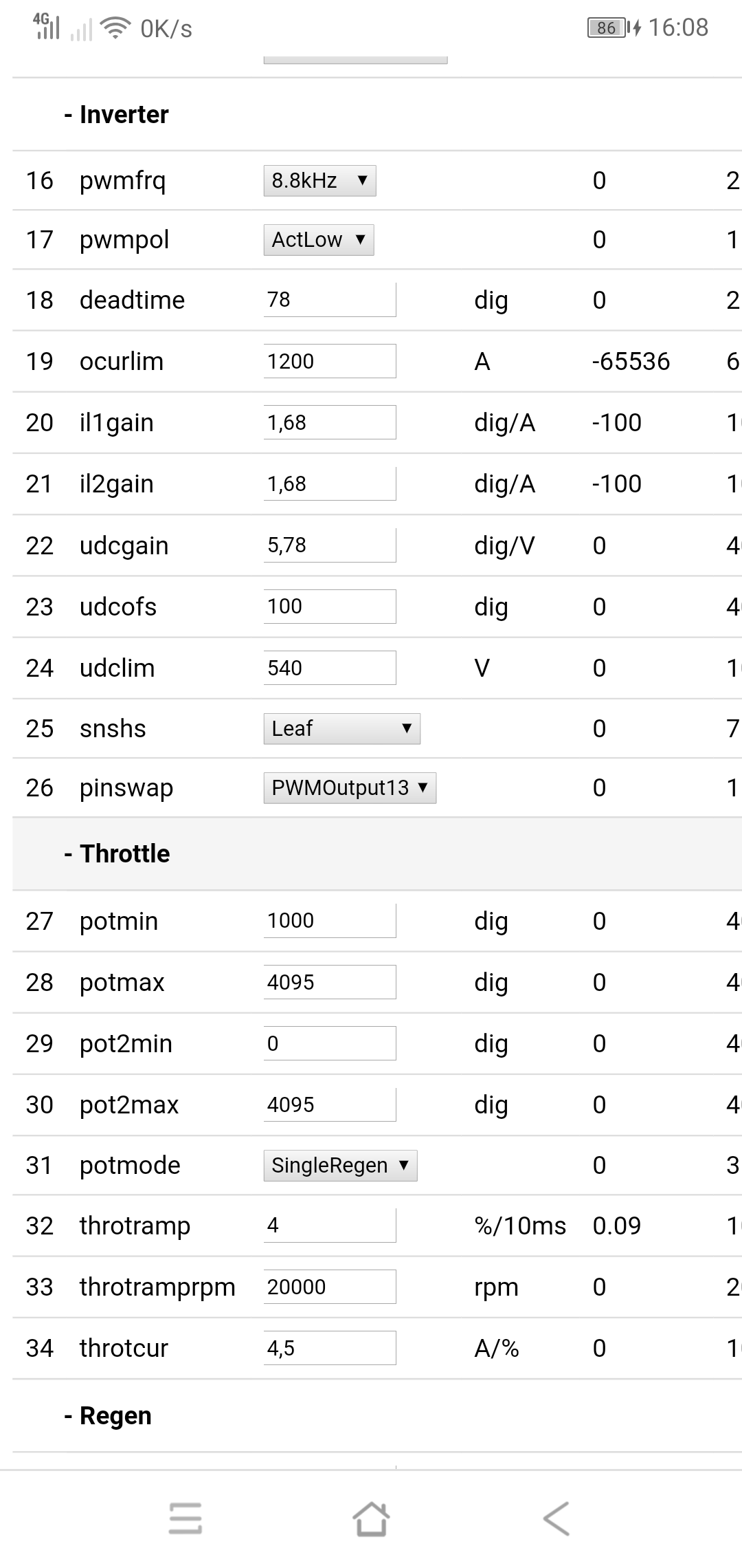

You can increase idlethrotlim
Any voltage should give you full standstill torque. What is your throtcur? I run throtcur=5.5 and idlethrotlim=60 and it holds even on steep hills

johu wrote: Mon May 30, 2022 4:56 pm What is your throtcur? I run throtcur=5.5 and idlethrotlim=60 and it holds even on steep hills
