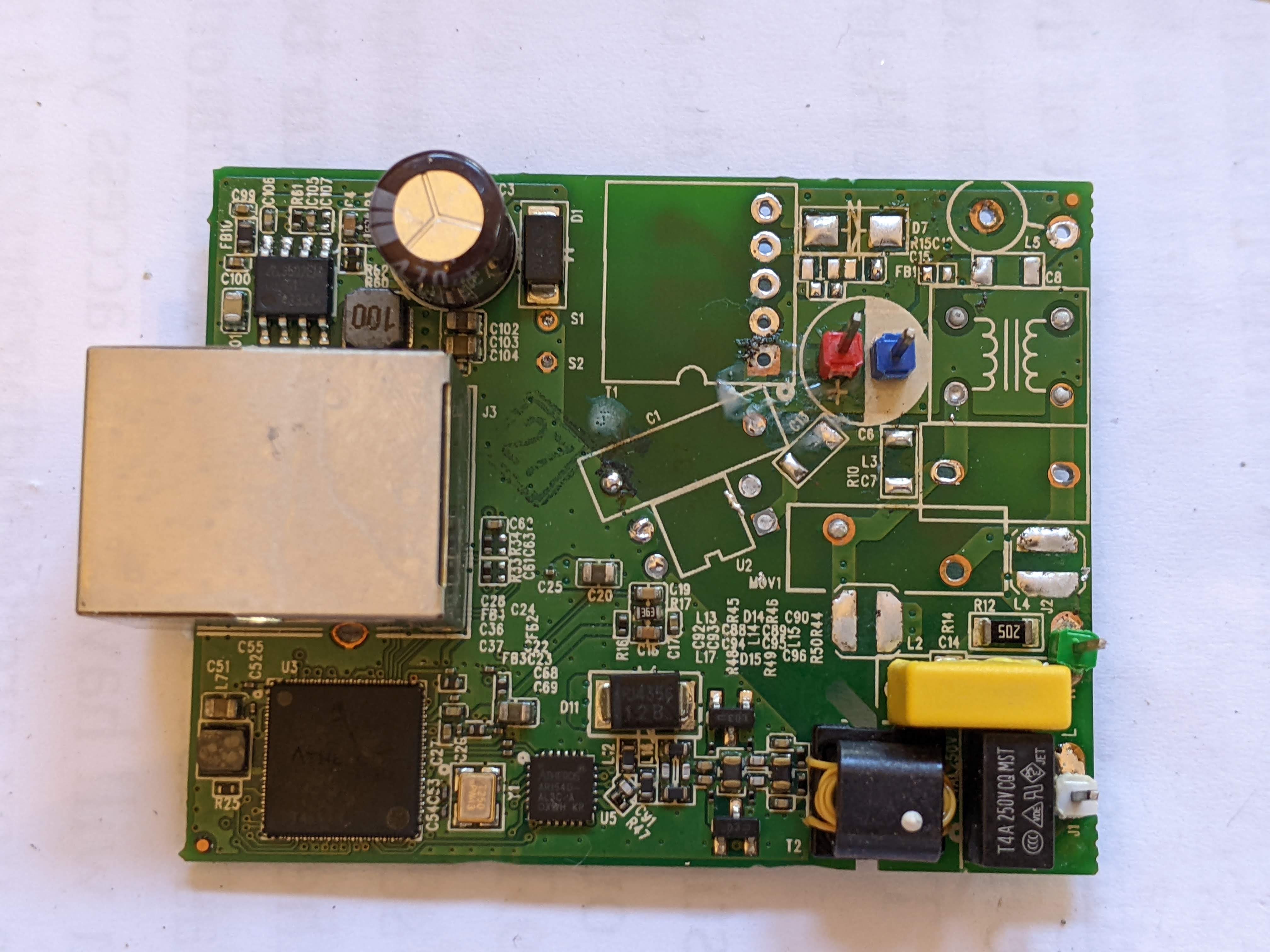

I found this article, which shows how to easily modify a TL-PA4010 to remove its AC power supply, power it from 12v, and wire its data lines to DC: http://www.helicopting.de/
I've ordered a couple of these, which I will modify accordingly. This will allow me to verify communication with a CCS charger. I have also ordered a powerline adapter with a QCA7500, to see if this chip supports the EVSE side.
In the meantime, I'll start reading up on the higher level protocols, but step one will just be to see if I can connect to, and ping, an EVSE. I don't know if it's worth trying to buy these chips, but I'll be happy putting a modded TL-PA4010 in a box with a rPi.

I've now modified a TP-Link TL-PA4010. The device now runs on DC, and the data lines are exposed directly. This modification appears to work, and should now be ready to hook up the the CP and PE lines of a charger.

This project looks promising. I've ordered my own set of TL-PA4010's, see if I can replicate your progress.
catphish
Posts: 966
Location: Dorset, UK
Has thanked: 99 times
Been thanked: 197 times
Post by catphish »
stracky wrote: Tue May 24, 2022 7:34 pm This project looks promising. I've ordered my own set of TL-PA4010's, see if I can replicate your progress.
Fantastic. There's a guide here to modifying them which shows a version slightly different to mine. http://www.helicopting.de/
My progress is pretty minimal so far. The next step is to learn EXI, which is required to encode requests.
