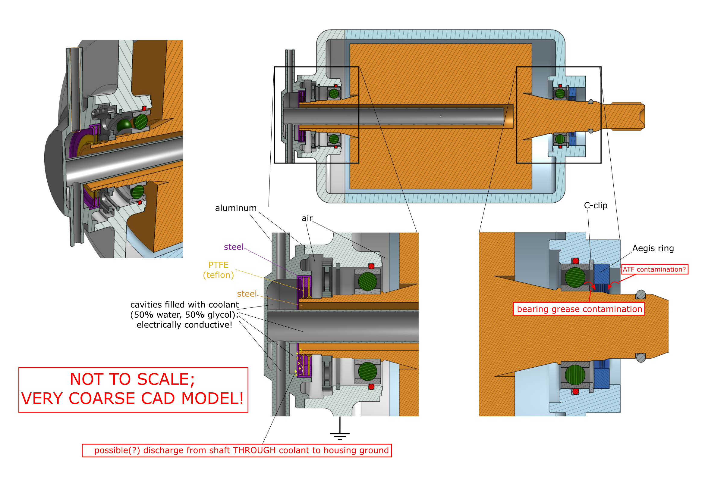

Being an "outsider", it is extremely tough to find Tesla's suppliers. My next guess after SKF is the giant Saint-Gobain because they mention Tesla here and there on their website and they are large enough to serve Tesla in the long term. See also this presentation showing a Model 3 on the cover page. I called them and they referred me to Tesla for the purchase of seals
. I think that a seal of their OmniLip product line is a good candidate for being the original. See here and here for some very brief test data.
However my fear is that rotor eccentricity and -runout at high RPM and sharp turns, caused by gyroscopic effects and impacts due to e.g. road bumps, will cause any replacement seal to leak quickly because PTFE (low friction; needed for high RPM) is far more prone to creep compared to elastomers (like rubbers), so it does not "follow" the shaft movements as well as elastomers. Small rotor movements (w.r.t. the housing) in radial direction are possible because there is (or seems to be) an elastomer O-ring between the rotor bearings' outer race and the housing (why?). See also the attachment. I said "small", but my guess is that this play is large enough for leaks, see also Figure 2-24 in Parker's Rotary Seal Design Guide for a coarse idea about acceptable misalignment (yes, this is yet another seal manufacturer). Can anybody show that this should not be a concern?
Good post - very informative. Thanks for contributing.
From my limited experience I don’t feel the eccentricity and gyroscopic concern of the shaft would be an issue providing the bearings are in good health. What’s likely to be more of an issue is the shaft finish where it contacts the seal. If you zoom in on my earlier pictures in this thread of the seal to shaft contact area, you’ll see the pitting is so bad it looks like the surface of the moon, which is likely to be the biggest variable.
Regarding the Saint-Gobain company, it’s highly plausible they’re the OE supplier.
In terms of longevity and the report that LDU experience issues at 60k miles, I suspect bad maintenance is a big factor. IE change coolant frequently, check for bearing wear and inspect for leaks.
I think you should try to contact them or browse the catalogs of available oil seals on third-party sites.

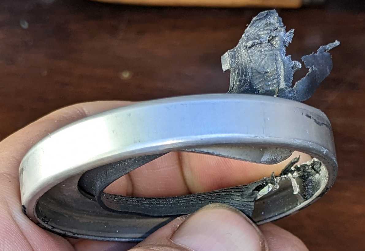

Another data point: I just removed the leaky PTFE seal with brute force from my rev. G Tesla drive unit:
Note the cuts in circumferential direction around the hole: These reduce the effective PTFE bending stiffness. Consequently, (maybe) there is less pressure from the seal on the shaft as compared to a seal without cuts. I say "maybe" because PTFE is known for its creep, reducing stresses in the long term, partially depending on the additives. I have never seen this feature in any catalogue (but I am a novice so that sais nothing). The Ceimin seals that I purchased (a brand owned by the factory Chenming in Ningbo, China) do not have cuts. So the presence of these cuts may be unique way to identify the manufacturer.
See also for the painful details: Removing rotor and leaking seal from Tesla LDU
@Boxter EV: do you have a photo of your old seal?

what you call cuts is a kind of thread. There are these seals with a twist to improve the sealing effect.Thay then have a given direction of rotation. This causes problems for the people who let the motor run backwards!Johan wrote: ↑Thu Jul 07, 2022 5:02 am Another data point: I just removed the leaky PTFE seal with brute force from my rev. G Tesla drive unit:
@muehlpower: Thanks, it could indeed be a thread/helix/spiral to "drag" the fluid back to where it came from. I took some measurements (click to enlarge):
So I think that the cuts are concentric, primarily for structural instead of hydrodynamic purposes. It would be nice if someone would repeat this measurement on his own seal to verify. Note that I bought another seal from Ceimin (separates rotor cavity from gear box) with helix/spiral protrusions in both directions for forward and reverse driving:
Note that the latter seal is from Chenming and looks a lot like Tesla's original seal. After less than 42k miles, this Tesla Seal failed too, allowing Dexron VI (from gear box) into the rotor cavity AND subsequently into the inverter
