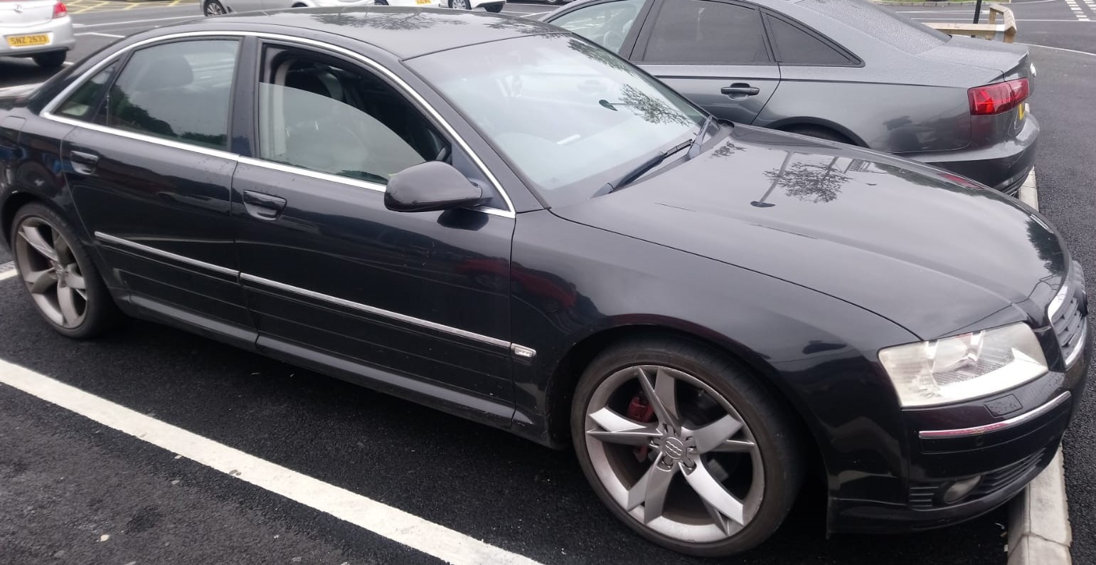

Car is a 2005 Audi A8 D3. Attraction to me is aluminium body so lighter and less prone to corrosion as well as a nice spec. Cost to me was cheap because it had an oil pressure issue. Was able to solve this by changing the oil as the stuff in it must have been wrong grade (was like water). Was also lucky that the car was not far away from where I live. It drives nice and is first one I've had with CVT which is quite impressive. Almost seems a shame to take it apart but would not miss 25mpg...

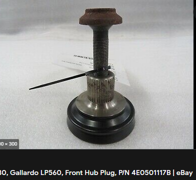

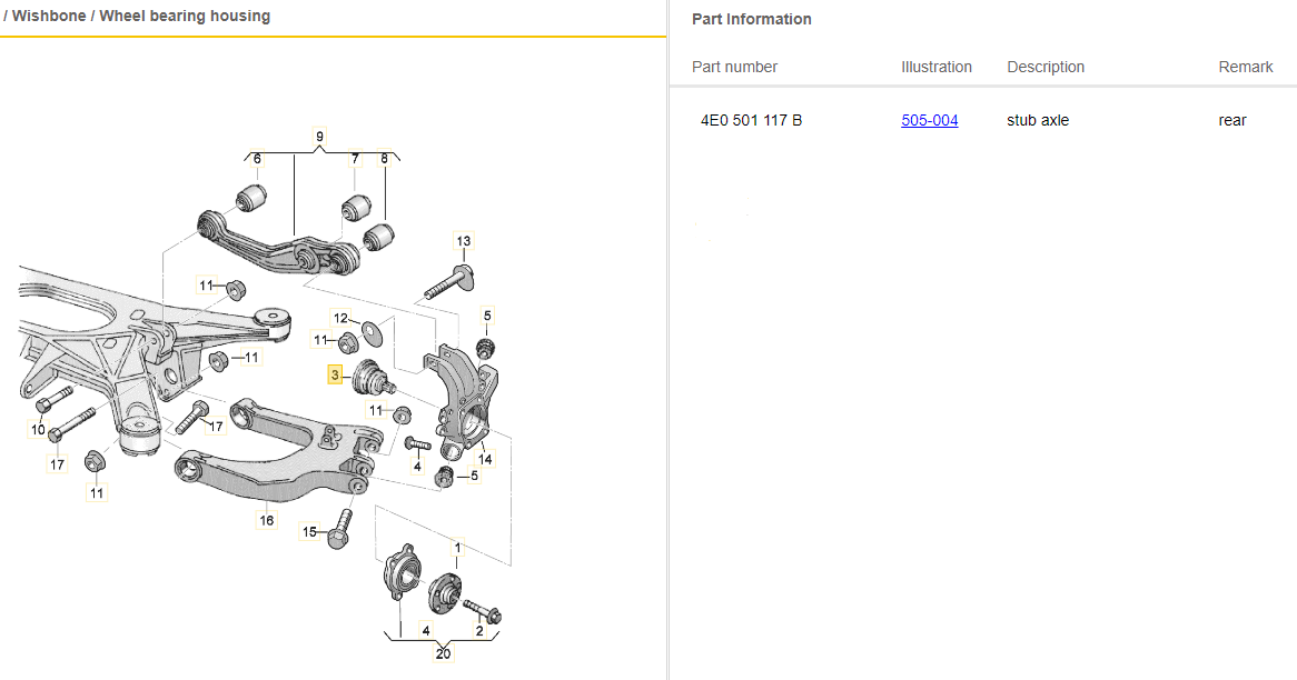

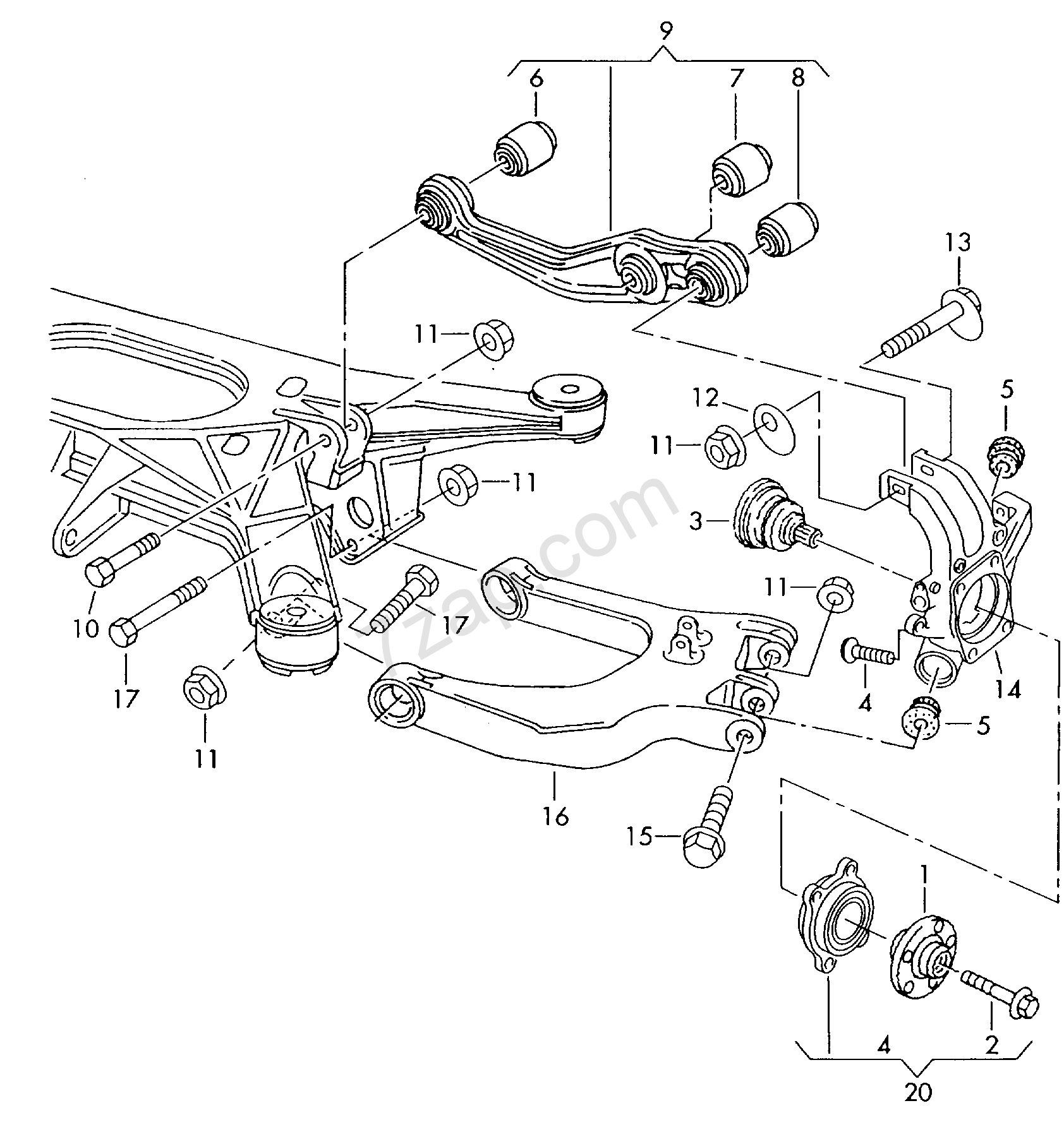

One thing I was surprised by is that this one is FWD only (not quattro despite the badges). Having looked through ETKA and the audi technical manuals though I am relieved that it might not be too big an issue to fix as the rear subframe and hubs are the same. Aim will be to buy a suitable diff, mounts and driveshafts to bolt in. Should then end up with a pair of stub axles which I can then swap to the front - we will see. Plan is for car to be RWD at the end.

You can just bolt on rear bearings from a Quattro which will accept the rear drive shafts.

GS450H motor. According to part numbers from 7 zap, the hubs and bearings are same on quattro. Hoping the stub axles fit the front - Car is air suspension and is driven by an electric pump behind the front bumper. It also seems to hold air when parked.

Ah yes - that's correct - even easier - just bolt in the driveshaft.GS450H motor. According to part numbers from 7 zap, the hubs and bearings are same on quattro. Hoping the stub axles fit the front -
They would usually have a blanked off the wheel bearing with no hole - but instead are using a plug - shared with the Gallardo no less!!

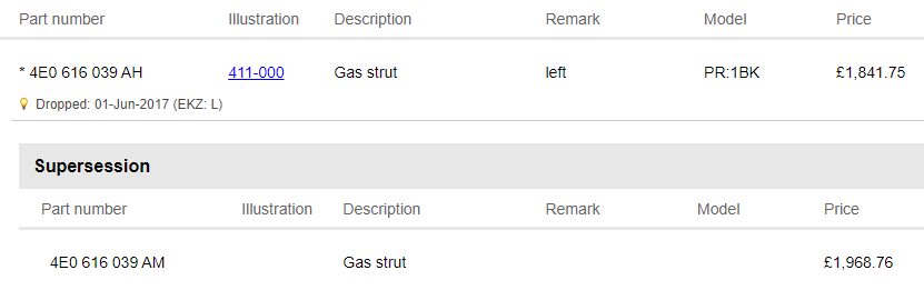

Just looked at the price of new front strut! Looks like you have hydraulic steeringSuperV8 wrote: ↑Fri Jun 17, 2022 7:25 amAh yes - that's correct - even easier - just bolt in the driveshaft.GS450H motor. According to part numbers from 7 zap, the hubs and bearings are same on quattro. Hoping the stub axles fit the front -
