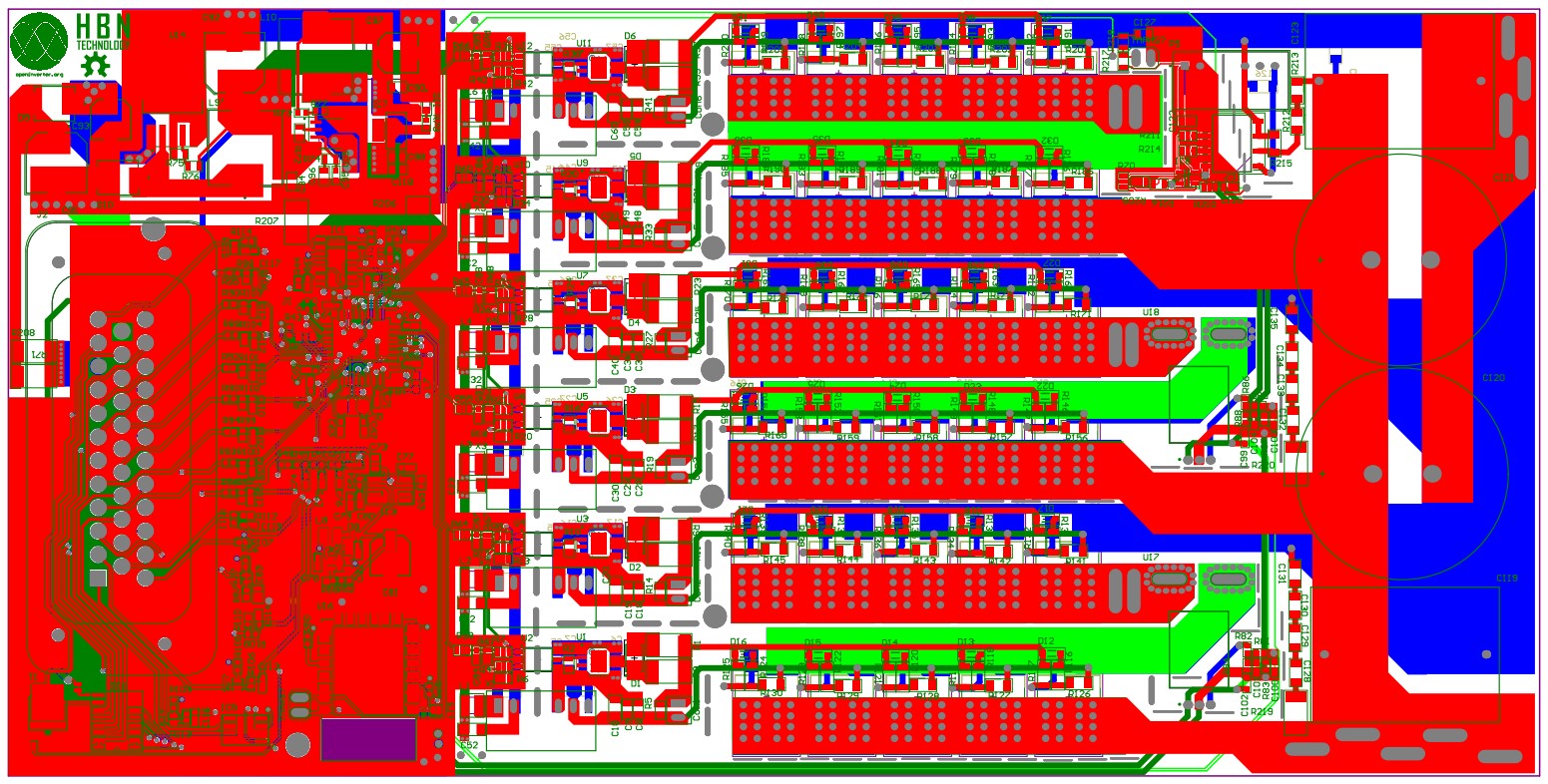

Hello friends I am Halil
I have designed all in one board for open inverter project which is shown below. I follow version 3.4 controller board design and i made few changes.I am waiting your feedbacks and suggestions.
This board designed for 48v systems but it can be adapted up to 400 volt.
I will upload all files to github

Layout
Layout

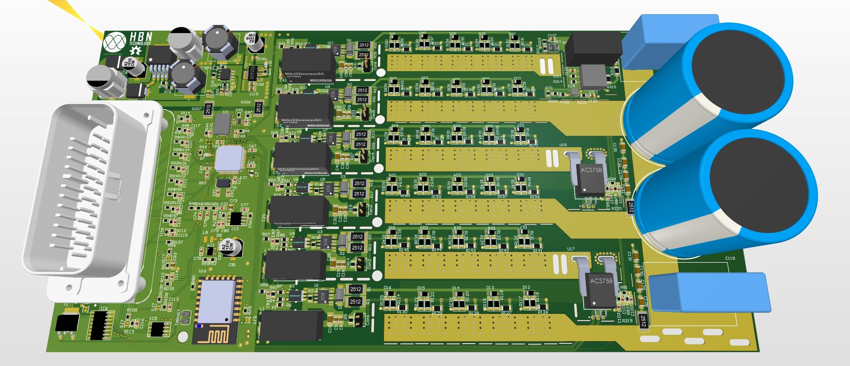

3D View of layout
3D View of layout

johu wrote: Mon Apr 25, 2022 7:16 am Oh cool, always wanted to do something similar but then OEM inverters came along.
What ratings do you expect and what file format / editor is it?
Hello johannes
Control and power section fully isolated it can work on 400 volt but need to make test about it, fets are a bit close to each other. It is same with current also 100 amper will not be issue theoretically but current pads need to fill with solder properly.
The program is altium designer

Re: all in one board for open inverter project
Post by yaroslav »
Нi. You can use such a design, but with such an arrangement of power transistors, there will be uneven heating. I have experience of scaling for large currents, the problem is that currents 10 times higher than the phase ones are walking along the minus and plus buses. Perhaps in your case, the imposition of thick copper tires on the board will help
Post by haliltepedelen »
yaroslav wrote: Mon May 09, 2022 7:25 pm Нi. You can use such a design, but with such an arrangement of power transistors, there will be uneven heating. I have experience of scaling for large currents, the problem is that currents 10 times higher than the phase ones are walking along the minus and plus buses. Perhaps in your case, the imposition of thick copper tires on the board will help
Hi thanks for your feedback. I am aware that current and heat dissipation limit of the board. Discreet MOSFET paralleling has better heat and cooling performance, with proper liquid cooling system heat problem can be fix. For PCB traces i am planning to cut metal blocks for high current paths like Curtis controllers have. But before all of that the board need to be tested
Maybe someone in forum willing to help in test process feel free to contact me

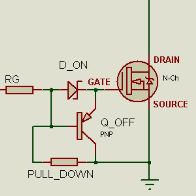

do you think locking drivers will be needed for heavy-gate transistors? When I did without them, the mosfet did not close for a long time and there was heating. I started using a locking driver and everything started working fine.
Post by Romale »
In this case, the pull-up resistor is made by several kilohms and RG is calculated as before. When a positive pulse is applied, it passes directly through the diode D_ON and charges the Gate of the mosfet. When the output stage of the main driver is closed, then through the pull-up resistor PULL_DOWN opens Q_OFF and instantly discharges the Gate charge through itself, which leads to the instantclosure of the mosfet!
Romale wrote: Fri Jun 17, 2022 10:07 am do you think locking drivers will be needed for heavy-gate transistors? When I did without them, the mosfet did not close for a long time and there was heating. I started using a locking driver and everything started working fine.
Hi
We can try this solution but we are also using neagative gate voltage for fast turn of.
if you have good combination of gate circuit with turn of transitor please sent it
