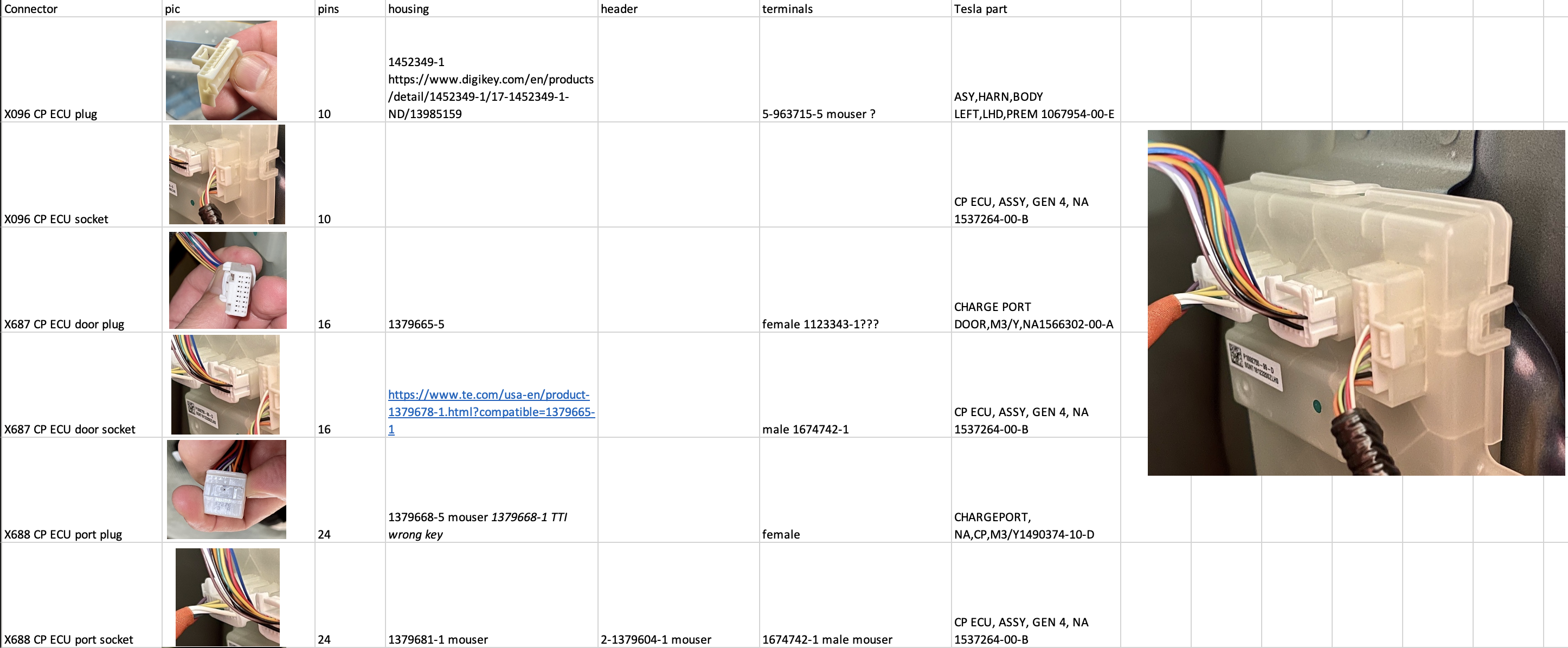

Hello all. I am wondering if anyone has identified the manufacturer and maybe part number of the first two connectors on the CP ECU.
I know the 3rd 10-pin connector is TE MQS (suspiciously not in their MQS catalog) https://www.mouser.com/ProductDetail/TE ... 6cTjbpY%3D
I'm working on a...chargeport project... and would love to plug and play cleanly with the real connectors if possible instead of splicing in.
And maybe soon diving into HV CAN too.

JWardell
Posts: 3
Joined: Fri Jun 18, 2021 4:35 am
Re: Tesla Model 3 Charge Port Controller Standalone Development
Post by JWardell »
I mean the first two of three connectors on the actual CP ECU. They look sumitomo-ish.

Forgot about this thread, but I spent months prying with TE to figure out chargeport ECU connectors.
In the end we determined some of the sockets literally don't exist and we needed to use the actual Tesla molded housing with stuffed pins with our own PCB inside. But if anyone else needs this information, this is what I ended up with.
