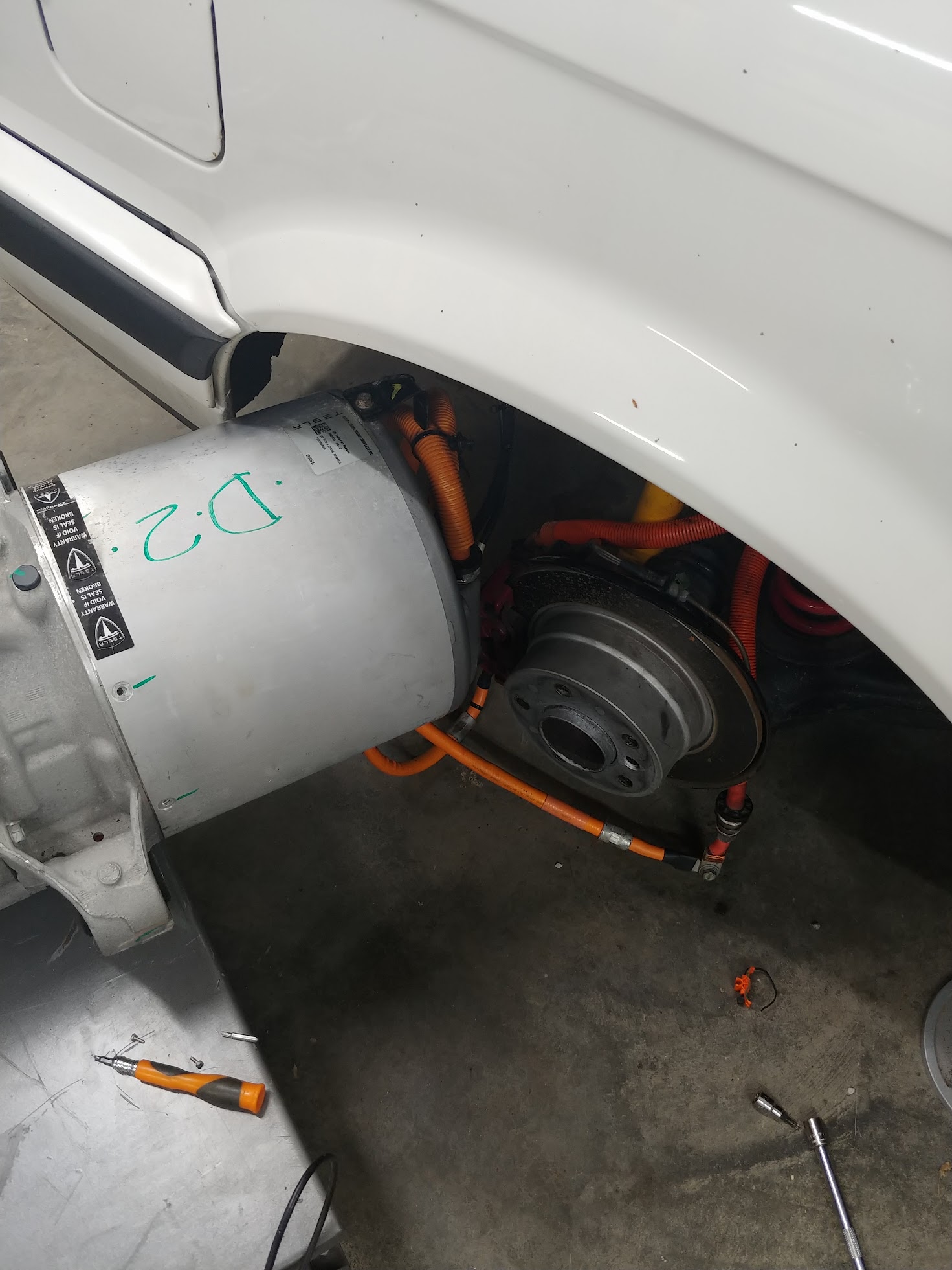

I can’t see any visual issues with the IGBT on that phase.
What do you mean by “manually closing the contactors”?
So UDC shows no voltage. Are you sure you have HV at the inverter?
Can you post a list of your parameters and what setting for udcmin? Also advise what firmware you’re running.

Sounds like damaged igbts. Did you measure the fases?
About UDC being low, that might be a second issue.

Thanks for the replies.
EV Builder - I will be measuring the phases tomorrow. If the IGBT's are damaged, can they be replaced? How difficult is this?
I am hoping the issue is just the Open Inverter board. I am concerned that the inverter is damaged and the whole motor/inverter will need replacement.
Boxster EV - When I say "manually closing the Contactors", I mean I have three 12V switches in the cab connected to the respective contactors (Main, Ign, Pre-Charge) that I manually switch on to close the individual contactors. This was the set up of the person I bought the motor and batteries from. It was set up this way to ensure contactors were closing in the right sequence.
I have full voltage coming out of the main 700A fuse going to the buss bars on the Inverter. Running firmware 4.85R. UDCMIN is 0. What other major parameters would affect this?

I have no clue how difficult it is since that's quite a personal opinion. I think it's doable if you have patience and can obtain the parts. Saying that I think it's easier on the LDU to swap a broken phase. Maybe someone has some spares laying around. The LDU has a separate board if I recall correctly for the UDC measurement. That one might be toasted too.

I’m not sure what to suggest with the feedback you’ve given.canadasconvert wrote: ↑Tue May 10, 2022 6:19 pm Thanks for the replies.
1) I don’t know why you have three switches to control contactors. Perhaps a moot point for now, but regarding your contactor wiring, have you done this according to Damien’s wiring diagram (page 1 of this thread)?
2) That’s pretty old firmware. It’s worth upgrading to eliminate any issues there. Once you’ve done this, perhaps try loading a known good fresh parameter set.

The Open Inverter board can and should be used to control the contactors, that's how you prevent damage to the inverter from failing to precharge.
I don't know if anyone has successfully replaced just the IGBTs on a Tesla inverter, though I was hoping to try some time next year. Several people have replace the entire damaged power stage.

Thanks to everyone who contributed to this. Looks like the problem was operator error. The 12V battery was only putting out 10V. This is why the pre-charge contactor didn't close and why the UDC was not displaying full battery pack voltage through wifi. I connected a fully charged battery and got the motor spinning again. I will continue to test the motor to ensure there are no other problems. A firmware upgrade will be coming soon and I will also look at adopting the Open Inverter starting sequence.
