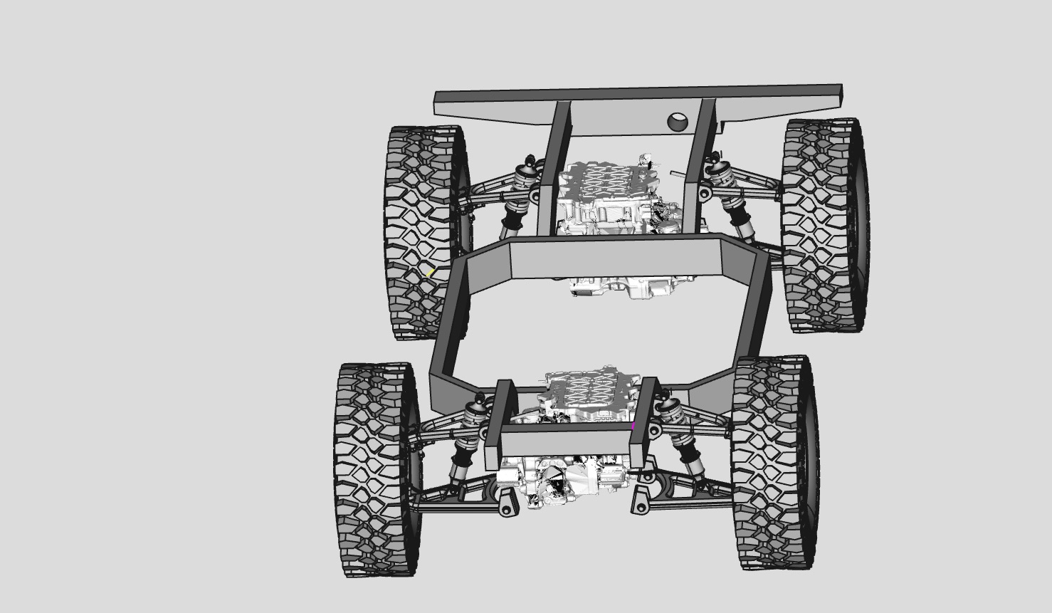

I’m in the midst of designing a skateboard chassis for my Series 2 Land Rover using 2 Leaf motors similar to the Zero Labs offering and I was wondering what the best way to control/sync the 2 motors is. Can this be done with one controller and has anyone successfully done this before?

ChrisW wrote: Mon Jun 20, 2022 3:51 pm I’m in the midst of designing a skateboard chassis for my Series 2 Land Rover using 2 Leaf motors similar to the Zero Labs offering and I was wondering what the best way to control/sync the 2 motors is. Can this be done with one controller and has anyone successfully done this before?
are you looking to controller the stock inverter over CAN? or use a OI replacement board in each inverter? ether way its just throttle mapping over can to each inverter.

Ideally I would want something that would have a few different modes -RWD, FWD, and Off Road. Probably the zombieVerter? But I wasn’t sure if the board can handle multiple motors/modes?

ChrisW wrote: Mon Jun 20, 2022 10:30 pm Ideally I would want something that would have a few different modes -RWD, FWD, and Off Road. Probably the zombieVerter? But I wasn’t sure if the board can handle multiple motors/modes?
Right now it can't but I'll be implementing that for Zapateros Subaru build https://openinverter.org/forum/viewtopic.php?t=2292
Hm... You could use a master slave configuration. Say FWD motor is master. Your VCU will provide CAN bus telegrams for it and you can drive as you would a normal Leaf. Then you put a CAN Man in the middle (a filter if you will) between front and rear motor. Now you can select either FWD and 4X4 mode :). If only FWD then MitM module blocks CAN signals to RWD motor. If 4x4 you drive them together.
But both motors will do the same thing which would not be desirable in all cases...
I know it is simple to use one throttle and two ebike controllers/inverters to drive two motors in an ebike so I would think it would be similar in a car. Just buy a second controller and inverter and feed the same throttle signal to both.
You could easily switch one or the other off if desired.

From what everyone says it sounds like it shouldn’t be too hard to accomplish. Great, now I can move on and work on my suspension 🤔
