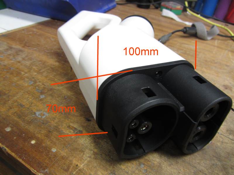

Does somebody have acces to the actual plug?
Can you share some pictures and dimensions?
What i need is a small sketch of the debt/height of the part that tries to enter the old Filler spot but on sport cars its not allot of room there...
p.s. I bought the socket from an ID3 including the wiring etc

This is a Duosida plug - it's possible that others (e.g. liquid cooled) might be bigger

I found this one!
So i guess the standard is 100x70mm...
it' s the DUOSIDA
Damien can you confirm these dimensions? i saw one in one of your movies...
it' s the DUOSIDA
