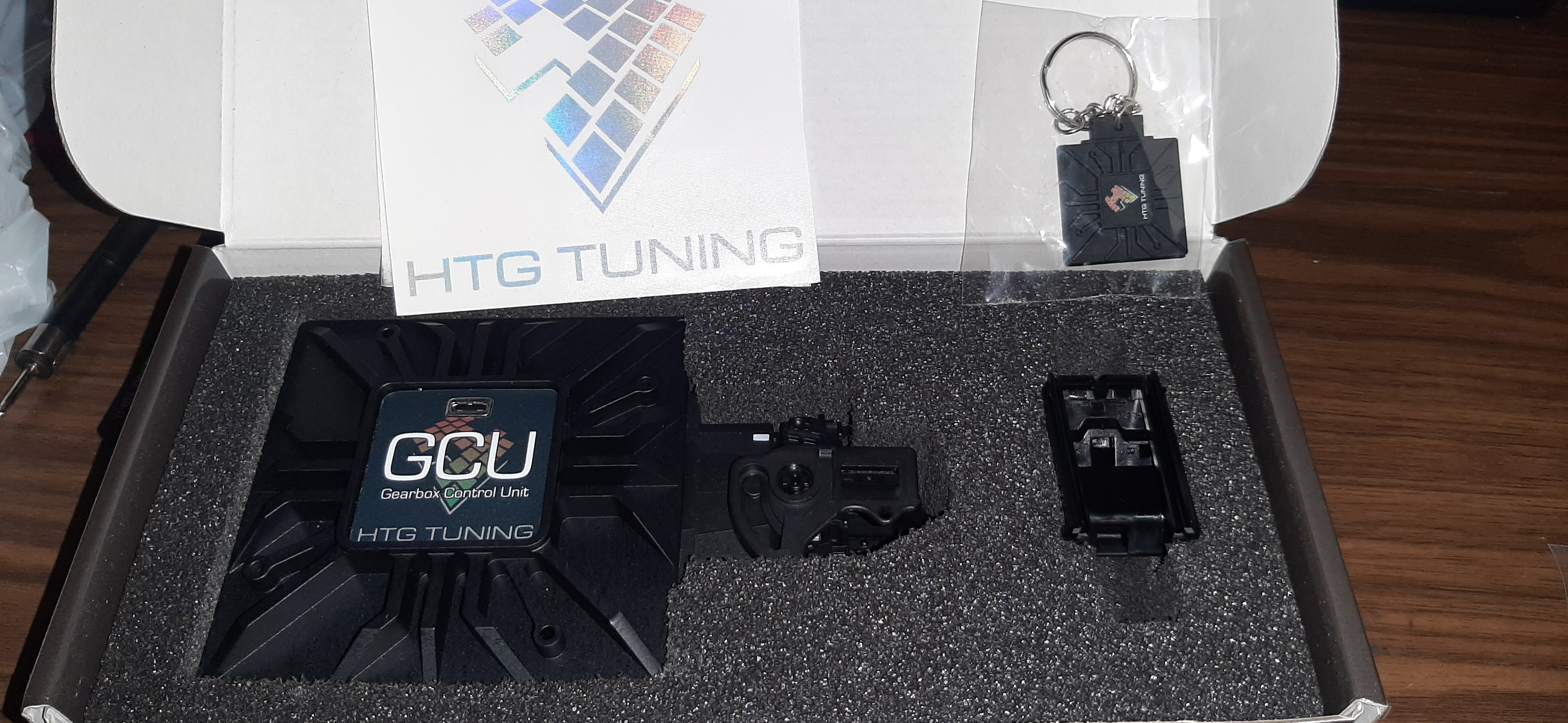

The transmission has proven to be another full project. Since I'm not using the factory TCU, it needs to be removed from the mechatronics unit and then jumper wires soldered in place. Fortunately this is a fairly common transmission swap for the non-hybrid versions so there is a PCB that can be soldered in place. Once that was done and confirmed continuity and no shorts, the GCU had to be wired up and a valve test performed - more fun graphs!
Current state of affairs is that I'm waiting for the Prius board and working with HTG to provide a baseline map for the transmission. Their input requirements are RPM, Pedal Position, and Throttle Position (may be able to duplicate pedal position here), and they said torque calculation would help. They raised an eyebrow when I said it wasn't going into any car specifically at the moment.
CAN communication is still very new to me but the GCU does have that ability and I know the Zombie does as well. I would like to eventually have the Zombie talk to the GCU over CAN and send the necessary information.

I recently purchased a 330e Hybrid Transmission and I would like to put it in my 99 BMW 328i as a functioning hybrid. Along with the transmission, I purchased a Prius Gen 3 inverter, an HTG GCU to control the gear changes (I'm too much of a noob to reverse engineer the messaging for the OE shifting), and a Zombieverter.
I seem to have gotten it in my head somehow that the Zombie could run an unknown motor, silly me. So I've ordered a Prius board from Damien and am currently waiting on the mail.
In the meantime I was able to have the components placed onto the Zombie but managed to swap a LIN transceiver with a CAN transceiver and fried the LIN. The exact replacement was not available so I used an alternate. Not sure that I'll ever need it in my project but it's there.
Once I got everything sorted I was able to confirm that the Zombie is doing what it's supposed to do. Lot's of fun watching the throttle plot a graph on both channels. Managed to do the same with the GCU as it has it's own live data stream. Also got the ISA shunt initialized and reading udc where it's supposed to.
Thanks to funds going to other areas, I do not have a test battery or a bench power supply. Instead, I'm using a bridge rectifier to take the 110v ac from the wall and convert to dc. This measures 112v dc at the contactor and then jumps to 168v once the contactor closes. I'm using an OMRON G9EJ-1 for the pre-charge relay which directs current through a 120v 100w bulb and then through a 25ohm 50w resistor. I'm also using a Tyco Kilovac EV200 contactor on the positive side. The shunt is connected to the negative side going back into the rectifier.
I also managed to damage the motor temp sensor when I was checking resistance values (overheated) so I found that it's a very common BMW coolant temperature sensor, part number 13627580635. If anyone has a datasheet that would be helpful as well.
Another challenge down the road is going to be the auxiliary oil pump that is unique to the hybrid transmissions. It gets power and ground from a connection on the case and there is 1 wire going into the pump for communication. Not sure if it's 1-wire CAN but that seems to be the most likely scenario. I found the pad on the mechatronics that has continuity but it is not included in the PCB used for the GCU. Fortunately it's an auxiliary pump and the main pump is chain driven by the electric motor so I should be able to push that problem down the road.
Once I have all those little hurdles conquered I'll need to figure out how the separator clutch is operated. I have a hunch that it's controlled by the TCC solenoid but won't be able to test any of that until later on either. The GCU has a clutch by wire feature and I'd like to operate the separator clutch in this manner.
I would certainly appreciate any input you all may have along the way as most of you are MUCH smarter than I. I am admittedly new to EV's and have jumped into the deep end of the pool but I'm the type that learns by doing.

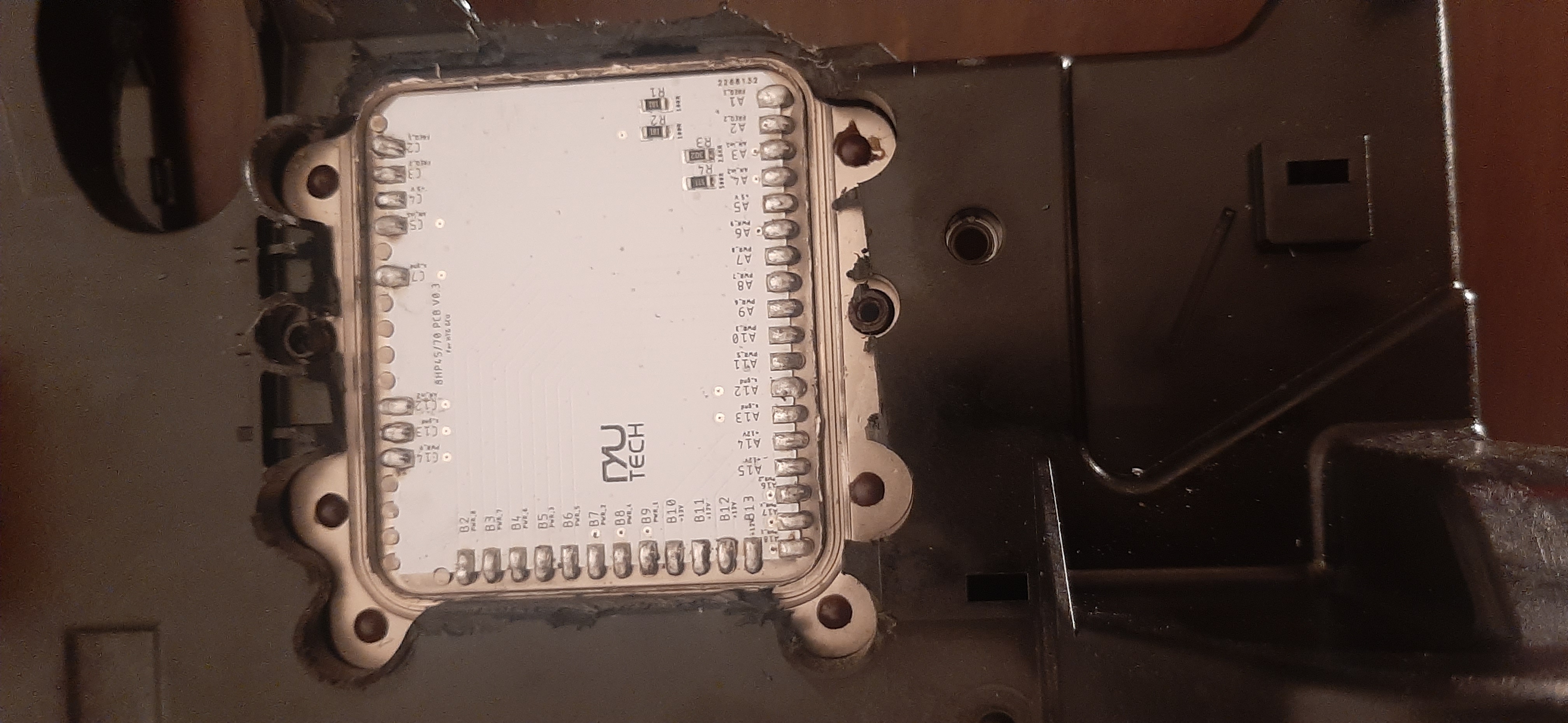

And we have blinking lights! I love blinking lights! Thank you Damien for the Prius board and for all the work you do.

It works!!!
No pictures tonight but I got it to turn. Got my new Prius board from Damien and realized some mistakes I made last time around.
Followed all the steps for the first run, hit enter, and then there was a loud clunk and the output shaft started to turn. It ran for about 3 seconds and then blew my breaker. I don't have a HV battery or a bench power supply so I ran an extension cord through a rectifier and the wall outlet is on a 10 amp breaker.
Since I knew it worked, I swapped over to the 220v (100 amp breaker) through the rectifier and have about 334v at the inverter. Followed the same process and I get a much smaller click and then an overcurrent error. I'm using a Zombieverter to control precharge.
Any suggestions to address the overcurrent error? Figured I'd move on to FOC tuning and see what else I can break.
