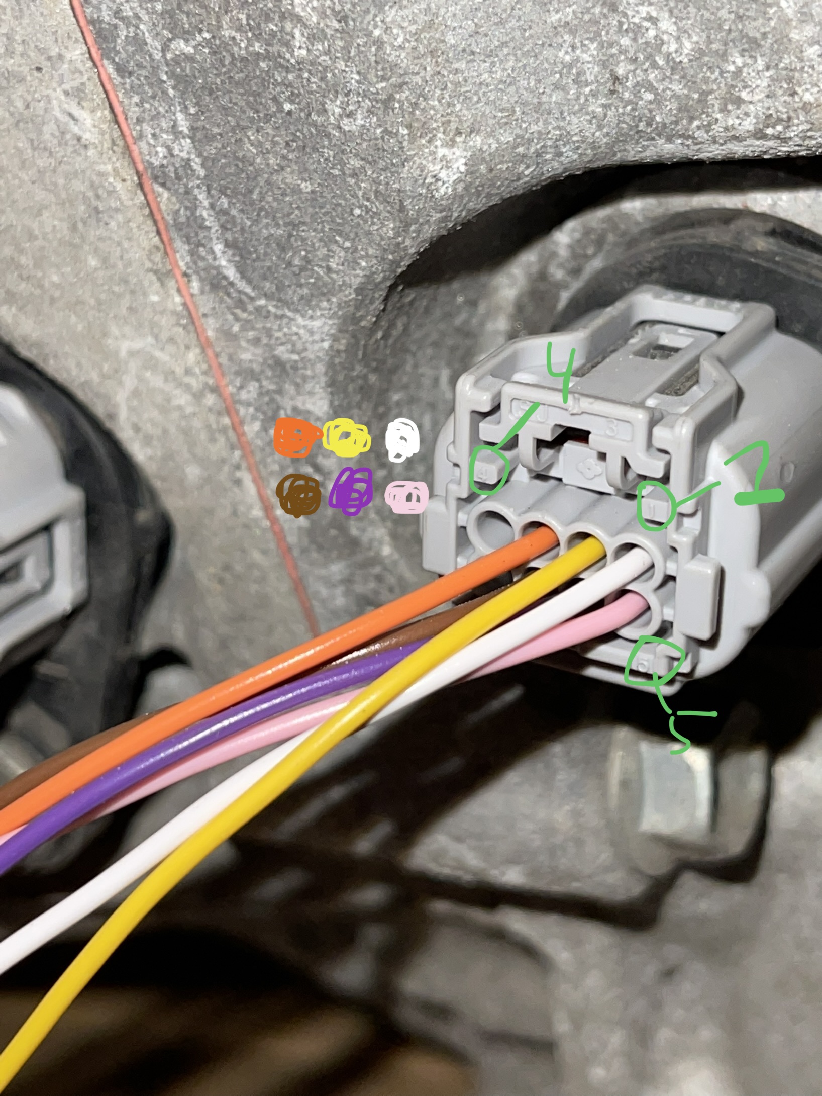

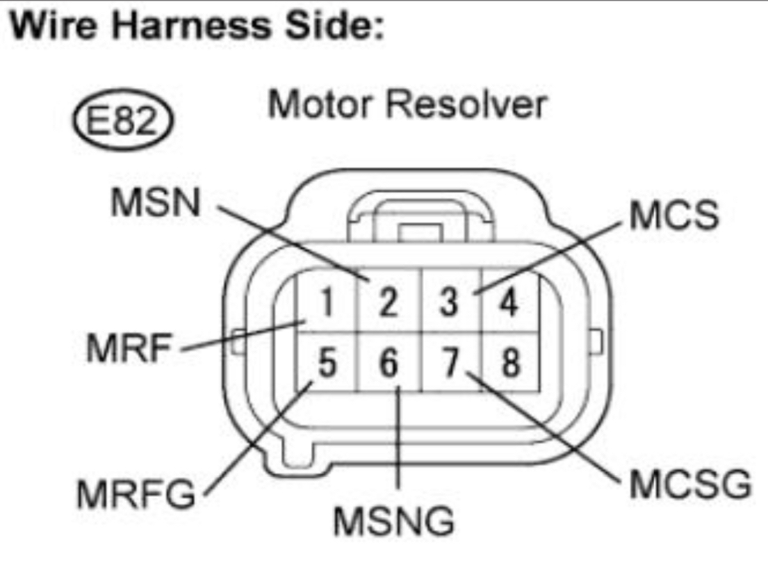

Now I have precharge working but can't get any comms with the inverter (Prius gen3) and L210 (IS300h) gearbox to Zombie. My suspicion at the moment is the inverter isn't 'turning on' as precharge occurs and the inverter relay closes so 12v is getting to inverter, but no high pitched whine or spinning.
I have the MTH, HTM, REQ and CLK +'s and -'s connected up between inverter and Zombie using the original Prius connector and pinout I used a few messages above. I have nothing else between Zombie and inverter. on the Zombie itself I have IC12 and IC17 missing which I believe both are unused for my application.
I have MG1 and MG2 (MG1 I plugged into front connector and MG2 the rear connector on gearbox) resolvers connected up between inverter and gearbox using this pinout:
That pinout I took from the GS450h forum thread / wiki and they're the same connector so I'm assuming they're the same pinout (unless they aren't?), here's how I've wired it:
Ive assumed MRF goes to EX+ and MRFG goes to EX- (from Prius inverter pinout) as a guess as I don't know where else to put them. The other 4 (MSN and MCS with they're respective grounds with the G added at the end) I've wired up to the inverter as they're self explanatory. and that's all I have wired between inverter and gearbox. (I've left the temp sensors out for now)
Other than that I have the 2 inverter grounds permanently grounded (and 12v + on the relay) and that's all of my inverter wiring.
Can anyone spot anything I might be missing to gain inverter turning on, or is there a way I can check inverter comms with zombie? The only idea I can think of at the moment is that I've wired the mg1 and mg2 resolvers the wrong way around.

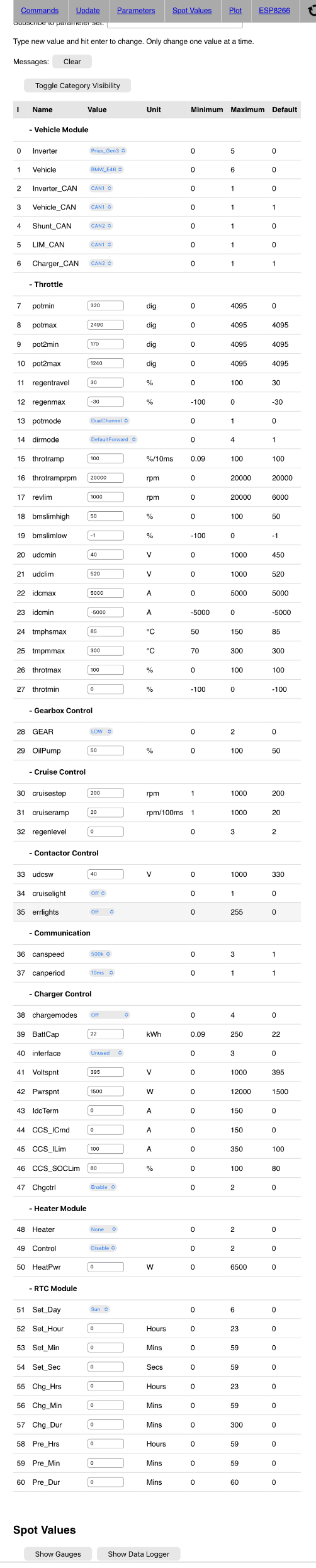

Don’t seem to get that. I apply ignition T15 (second key turn in the BMW) and T15 stat goes on, INVstat says off, likewise with after pushing key against spring (‘cranking engine’) causing precharge and relay to close powering inverter (and my contactors as they’re on the same relay as inverter power) INVstat stays offnkiernan wrote: ↑Sun Jul 24, 2022 9:33 amSounds like familiar symptoms I'm seeing (GS450H inverter). If you refresh the web interface after applying 'ignition on' signal but before applying 'start' signal, do you see InvStat change from 'off' to 'on'? Then after applying 'start' signal, and updating the web interface, InvStat has changed back from 'on' to 'off'?Domt177 wrote: ↑Sat Jul 23, 2022 5:39 pm Now I have precharge working but can't get any comms with the inverter (Prius gen3) and L210 (IS300h) gearbox to Zombie. My suspicion at the moment is the inverter isn't 'turning on' as precharge occurs and the inverter relay closes so 12v is getting to inverter, but no high pitched whine or spinning.

I’ve now wired up MG1 and 2 temp sensors and checked my wiring, still nothing. Not even any inverter whine. I can see it’s getting 12v and goes into run mode etc.
Basically my questions are:
Is there a way to check inverter comms?
Is all that’s needed to run a Prius gen3 with zombie the 4 signals (HTM MTH CLK and REQ) ? From reading other threads I think that’s all that’s needed but ready to be corrected.
There’s an ILKI and ILKO labelled interlock, I doubt it but could that be what’s stopping it from running?
