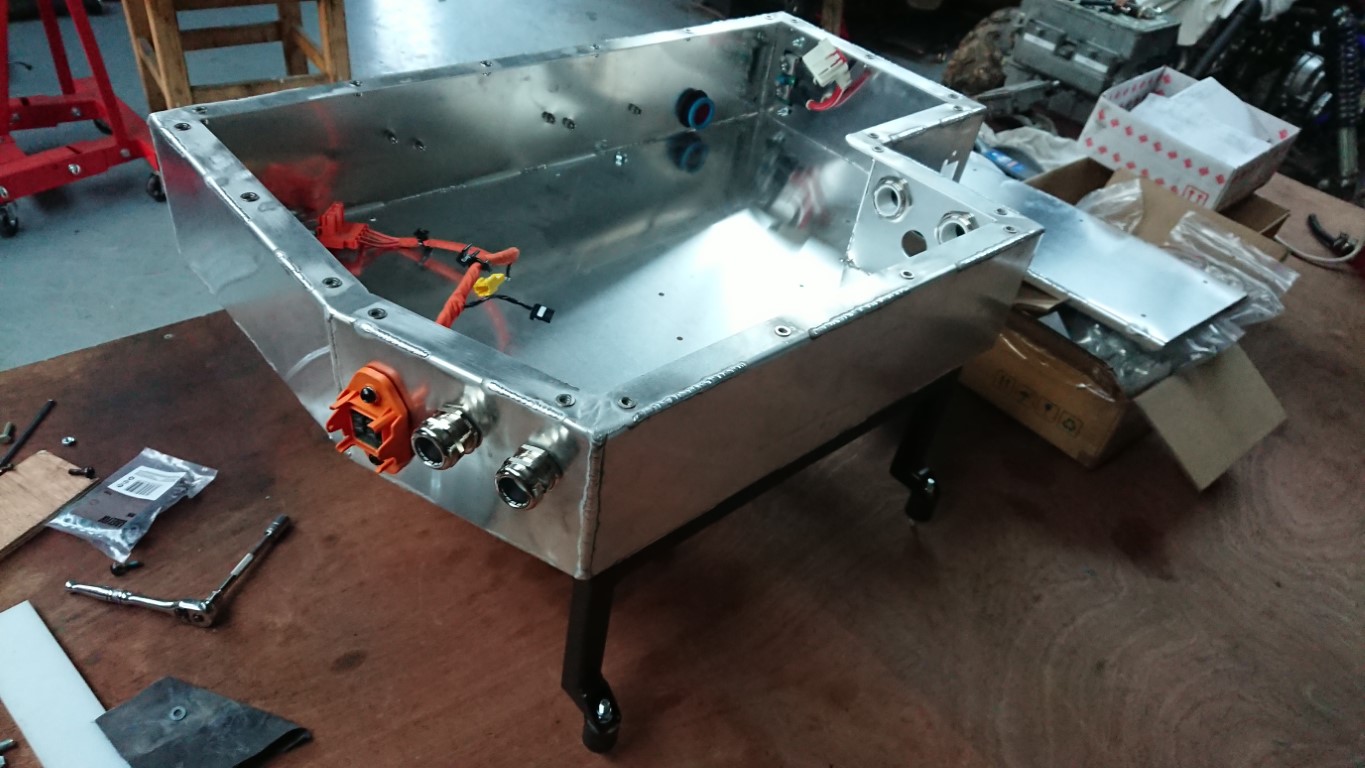

HVJB:
Quick layer of foam tape before mounting the aluminium enclosure
Multi pin connector, 12V terminals from the PCS and coolant bulkheads fit
Test fitting more of the Tesla Model 3 penthouse connectors
PCS roughly mounted in place
Next up is finalising the layout for the contactors and fuses

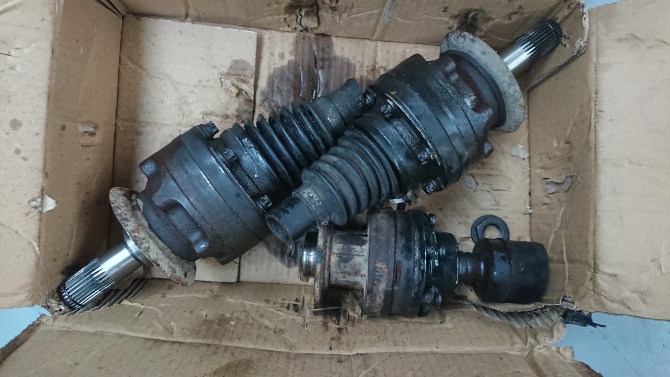

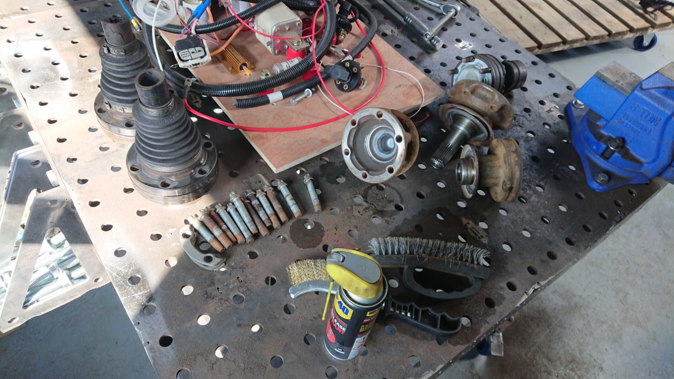

Driveline:
Have been looking at the connection between the GS450H gearbox output and the RR transfer case input. Ideally I'd hard mount both similar to how the original RR gearbox and transfer case were mounted, but with the location of the front differential and axle, the GS450H gearbox sits slightly offset from the transfer case axis.
This will require a short (approx. 320mm) driveshaft which can accommodate the center axes being slightly offset. For now I'm going to fabricate this to test how it will fit and run, and once I'm happy with it, I can see about getting an equivalent suitable for the torque.
After a lot of searching, found some scrap Range Rover rear diff CV's and axle/prop stubs
CV cups will be fabricated to the GS450H gearbox output and RR transfer case input shafts
Approx length of the required drive shaft

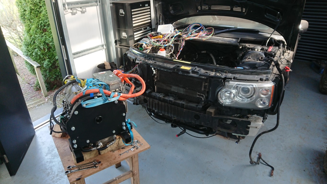

Driveline:

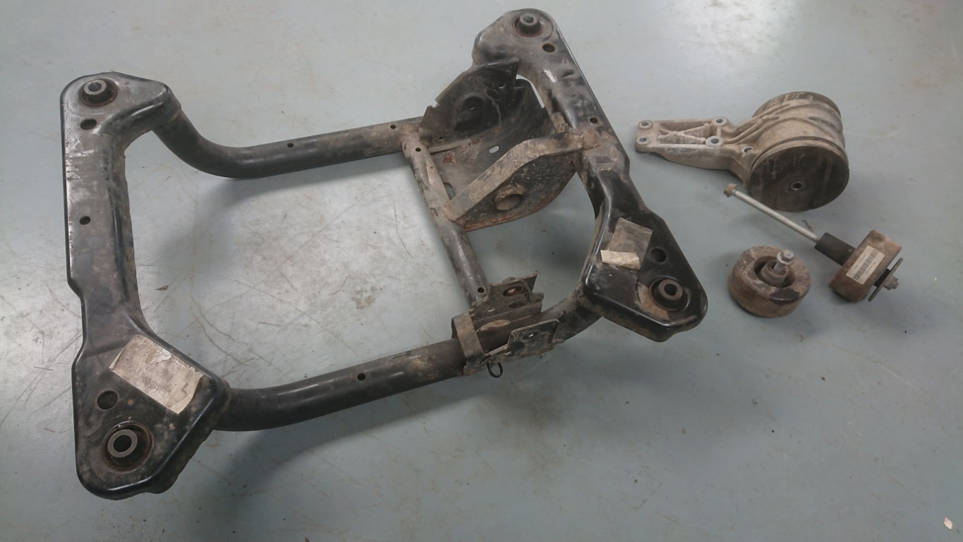

Time to weigh the drive motor sub-assembly! This assembly sits on four anti-vibration mounts on the chassis, and includes the GS450H gearbox, the GS450H inverter, the gearbox oil pump controller, gearbox oil cooler, the RR front differential and the RR RHS axle bearing support tube
All in, 208.65Kg wet. The engine, including the front diff was approx. 320Kg
Ready to drop into its new home!
But first, will connect up the Zombieverter and looms to make sure the accelerator and brake pedal inputs are working and the gearbox can still be controlled. originally I was using the GS450H EVBMW VCU. Once everything is confirmed working, the loom tidying process can begin

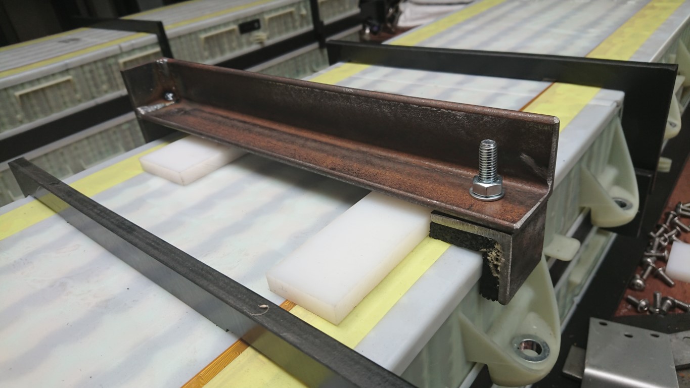

Batteries:
These TM3 batteries are awkward to handle without a second pair of hands, even being the shorter length, so its been easy to let them sit there on the bench and put off any work on them! Now the BMS has arrived though, its time to make it easier to move them as they'll be in and out of the battery boxes while I tidy up some support plastics, wiring and coolant lines, so decided to make a lifting frame.
One side of each module has handy repeating ledges that held them in place so a solid frame to pick up on these made sense. The opposite side of each module had different layouts for tabs or bolt down lugs so looking at a flexible cable to wrap around these as needed to tighten the frame to the modules.
One side of the frame slides between the module and the inside of the battery box, and a locking clamp will bolt onto the opposite side
Coated steel wire will be fixed to the clamp end to wrap round the bolt lugs on the modules to hold the frame in place and will add some isolation rubber to protect the modules and any of those BMS wires

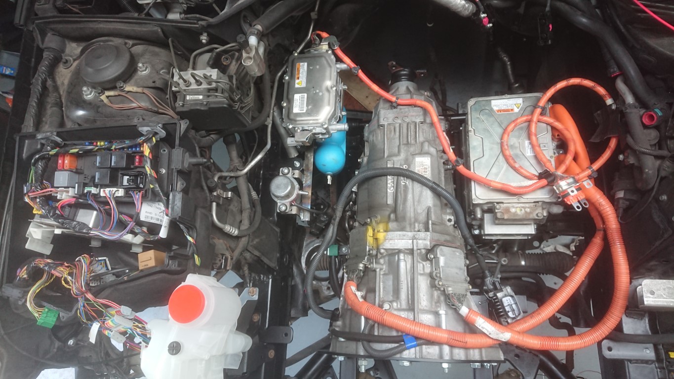

Ancillaries: Cabin heating and Brake vacuum
Seems like a major milestone getting the drive line figured out and motors running and then you realise how many other parts and systems are required! And they all need a home, so a little head scratching to figure out how and where to put some of them
A simple cage to hole the Outlander water heater that will look after cabin heating
Where best to add that to the 'multi purpose' mounting frame I've been figuring out
This frame also holds the electric brake vacuum pump and the Audi A8 brake accumulator
And this tucks these parts away neatly to the side of the GS450H drive

Recently I've been disassembling the dry build to tidy and paint up brackets and mounts, and figuring out final locations for remaining parts.
Decided to add the Outlander A/C compressor to the main drive mounting frame assembly which works well for A/C hose routing to the cabin and radiator
Hoping that's the last modification to this unit and its ready to drop in once I get the motors spinning. Because of the extra welding, the full loom was removed which meant I could sense check all the wiring and connections again to do some more zombie testing

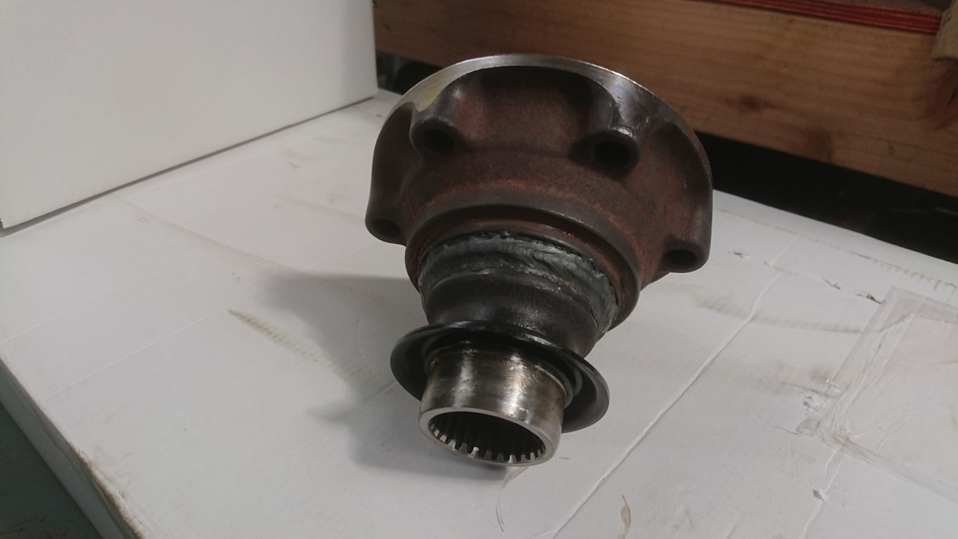

Drive Shafts:
Eagerly awaiting delivery of my modified prop shafts and new motor to transfer case drive shaft and stubs. Drive Shaft Services in Dublin sent some progress photos today and looking fantastic, can't wait to get a look at them, get them installed, and see if we can get some wheels spinning soon 8-) (Just hoping my measurements were correct :oops: )
New GS450H output coupler on the left, transfer case input coupler on the right
