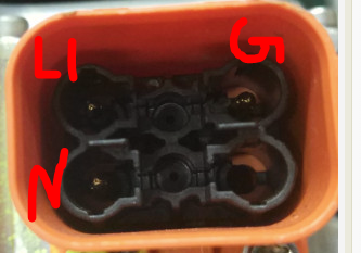

So, I successfully charged by truck yesterday using this charger and an AVC from Modular EV Power for J1772. On my North American 120V outlet I got 3.7A, which is about 1300W. I charged my pack up to about 370V, then decided to drive around and test out a public charger. Alas, all 10 I went to were taken, or have the DC combo plug that won't fit into my inlet. So I decided to come back home and test out my 240V Juice Box EVSE I use for my Model Y. As soon I plugged it into the truck, it tripped the 50A breaker in my panel.
What I can assume right now is that I have the AC lines going into the charger mixed up. I'm not sure why exactly it worked the first time, but i'll be looking into it. I can' unplug the AC connection on the charger and successfully get AC through the J1772, but if I plug it into the charger I either trip the breaker, or send the EVSE into a fault.
AVC.2 wiring
http://modularevpower.com/Images/avc1/A ... %201_4.pdf
vwbrady
Posts: 248
Location: Seattle, WA
Has thanked: 5 times
Been thanked: 18 times
Re: Chevy Volt Gen 2 charger 24281923
Post by vwbrady »
I figured it out. I bought a Volt charge inlet off ebay which came with the wiring. Come to find out it was the same exact Aptiv connector, but wired completely differently to the J1772 inlet.
This is the proper wiring. Somehow with me having the G and L1 swapped it still worked - presumably based on my house circuit at the time.

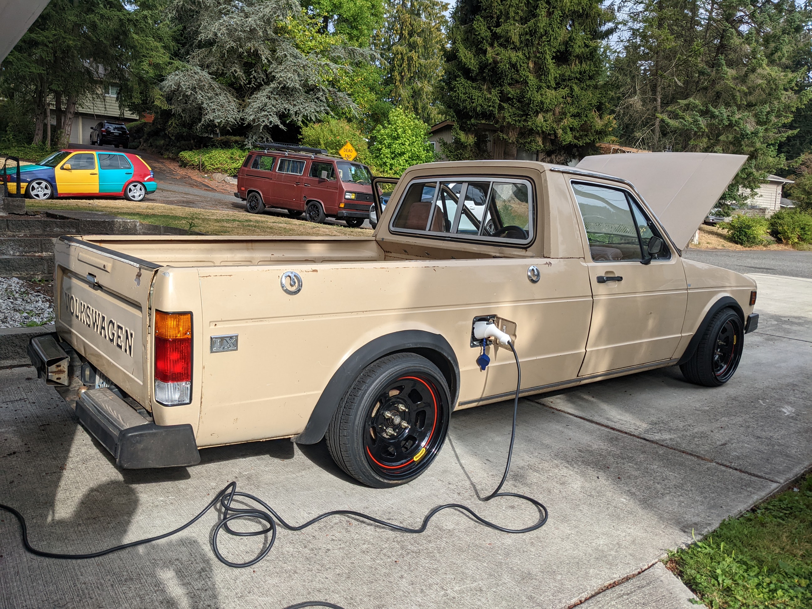

here it is charging in my truck via J1772 using one of these https://a.co/d/bJvEidr
Posts: 3796
Been thanked: 413 times
Nicely done!

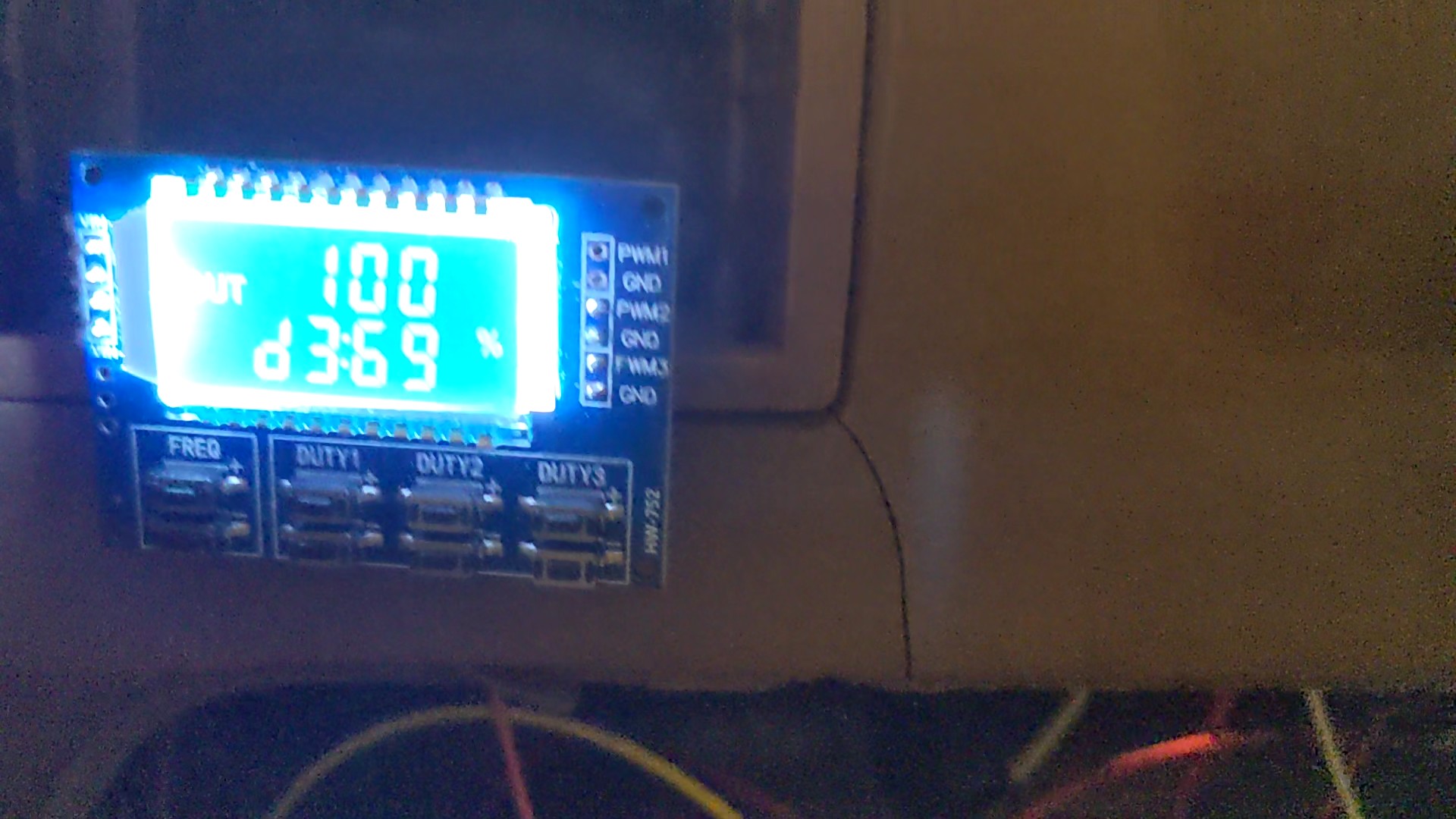

Can you share what PWM duty you are pushing to run charger at 10A 355Vdc?
The short time i had this charger at home i thought duty would follow the voltage from 75% to 90%. It seemed logical i would push 90% duty for bulk charge and then when voltage would reach setpoint i would reduce duty as a coarse CV control to taper current and keep voltage at 100%.

12v, 100hz, 69%.
I've read on diyev that the output is 3.6kW.
i understand this is confusing, considering 69% is way off tests others have done. perhaps when I get some more time charging i'll to some testing with that. I will say that as I increased the duty cycle, the charger jumped to life around 30%. 75% may be where I stopped, but I think i did that because it wasn't really making any more of a difference.
More experimentation is needed.

vwbrady wrote: Wed Aug 31, 2022 7:39 pm 12v, 100hz, 69%.
Tnx
Yes i noticed with Volt battery 96S i got as high as 90% duty when it stopped responding. Could be that i tried from the wrong side of duty signal. Correct from 75% upwards was the same value up to 90%.
