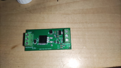

My vacuum switch died. I hooked up everything on the Bench and it was working fine.
I disconnected 12V from the board while the pump was cycling and I saw a small spark on that 1117 component.
Now the 5V terminal is outputting only 1V.

Oh, then the turnoff spike had nowhere to go. Is the version with TVS diode protecting the 1117? If in doubt post a pic

I bought it like a month ago. I'm pretty sure it has the diode in there.
If I try this again I should switch power from the pump directly, right?
Sorry for the blurry pic

ok, that one should survive most mistreatment. Can you check R6? Should be 10 Ohm

I think R6 is dead, the resistance started at 6Mohm and it just keeps climbing up to 11Mohm and beyond the longer I measure it.
I'll try with a through hole resistor that I have and report back.

ok, just replace it. Acted as a fuse so to speak
