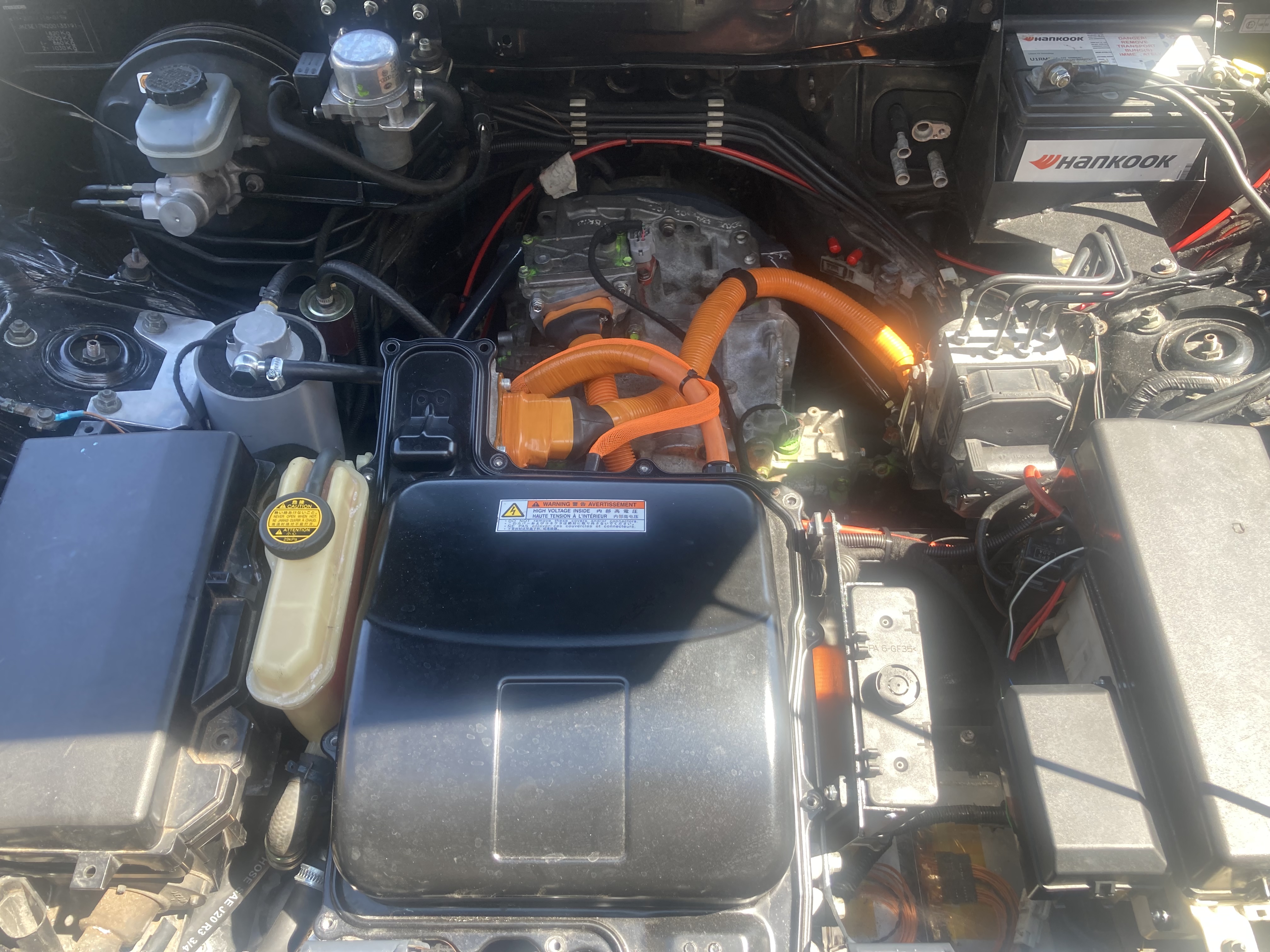

Mg1 tuning commenced today, syncof similar to mg2, was having issues with unwanted acceleration until I lowered syncadv to 6.
Mg1 performance not anywhere like as impressive as mg2 and so far I’ve not drawn more than about 30amps from an 80s pack, seems low end torque is pretty low, have driven round the block with both motors, it’s not bad but I’m not pushing the inverter very hard so hopefully there is more to come unless I’m just lacking on voltage

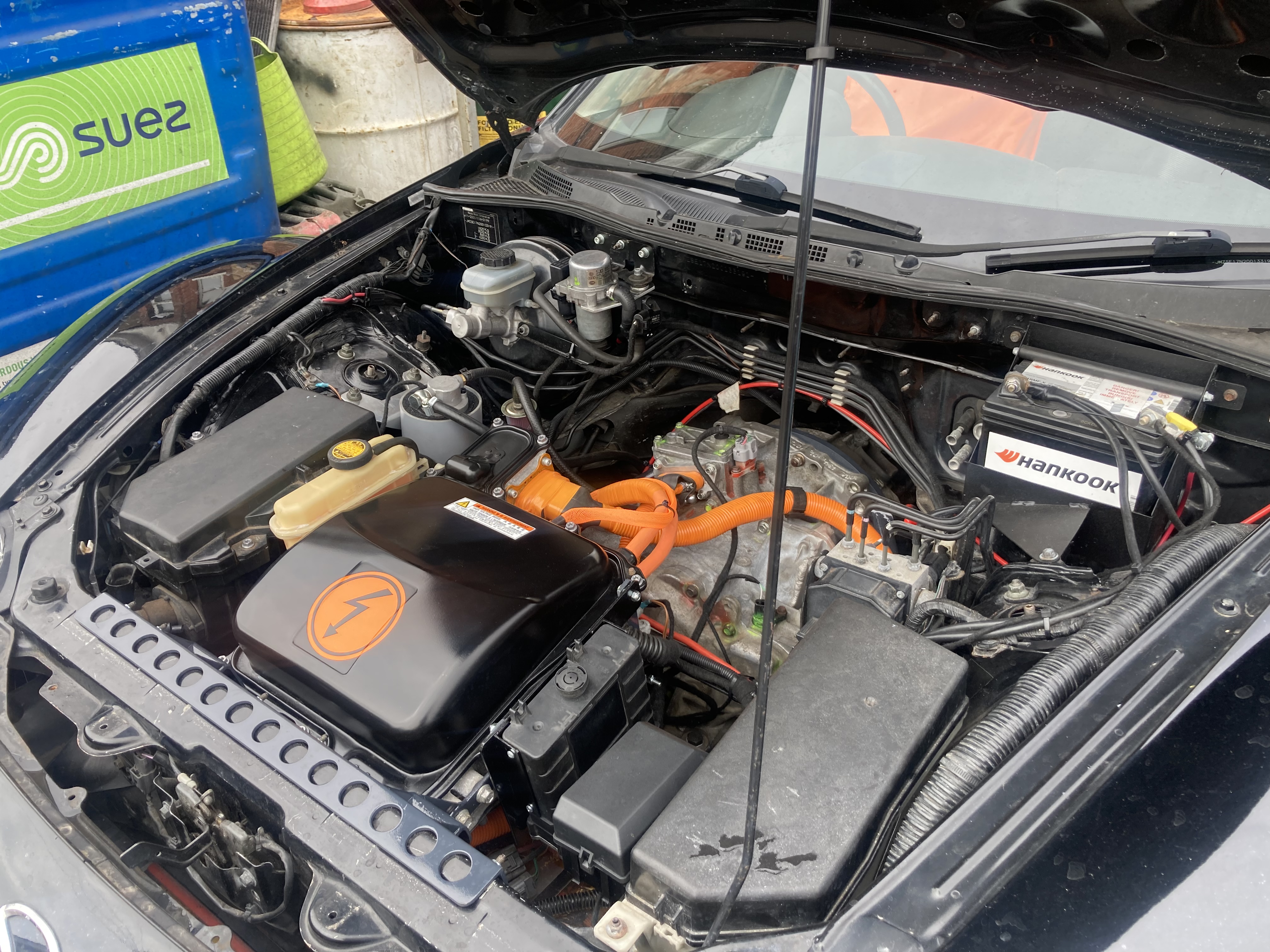

Well with a mostly drivable tune, the wiring tided up and finally finding the right can messages to convince the abs the engine ecu is still there I’m about ready for a fresh mot and some real testing.

Very professional looking project, can't wait to see how much power you can get out of it.
Re: Project RX8 , Prius gen2, Lexus transaxle to rwd
Thanks, I do a fair bit of custom fabrication as part of my job, it’s probably when im at my happiness,
Currently it’s drivable but lacking in power over about 2500 rpm, basically the first upgrade in the pipeline is to up battery voltage

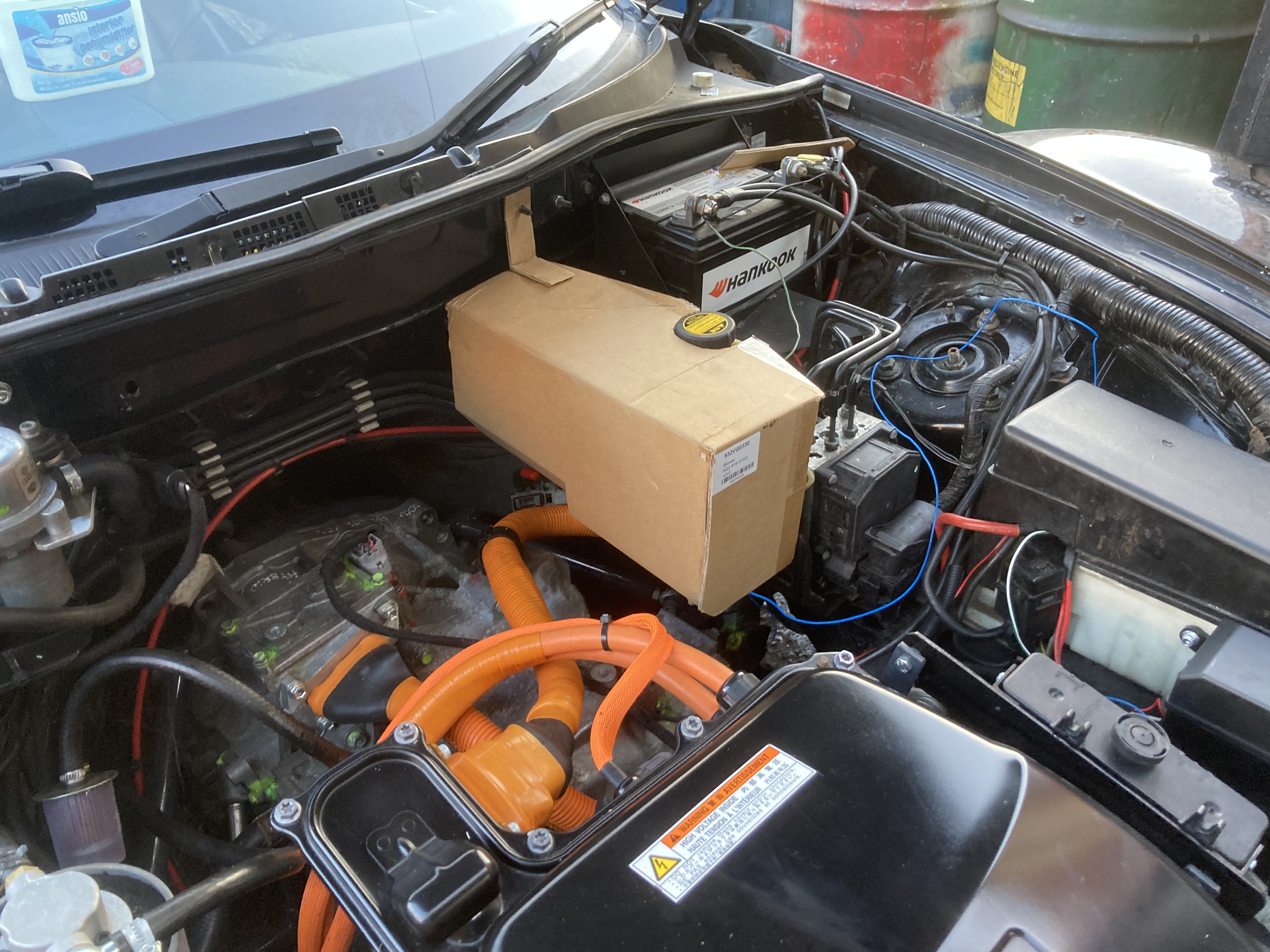

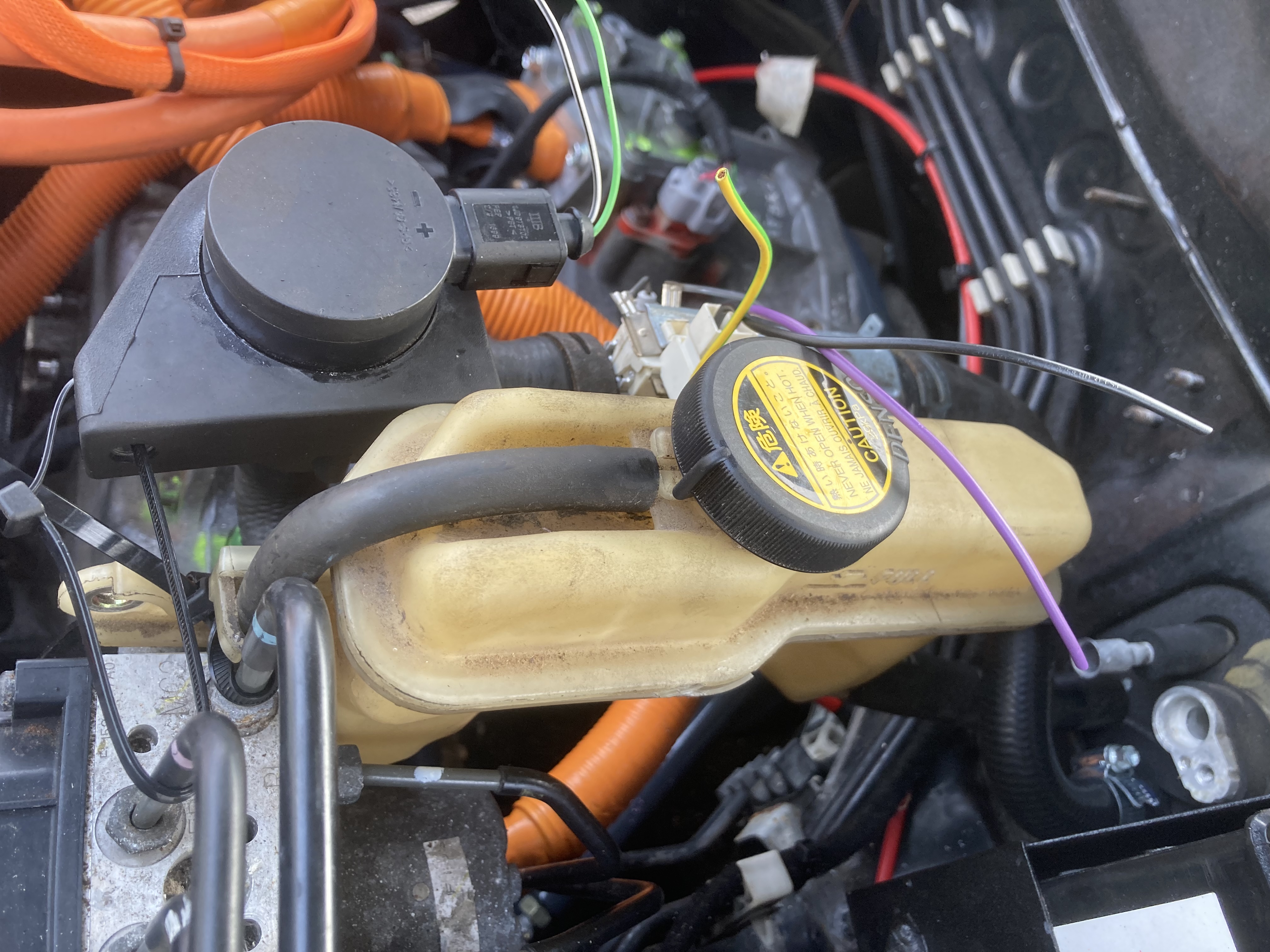

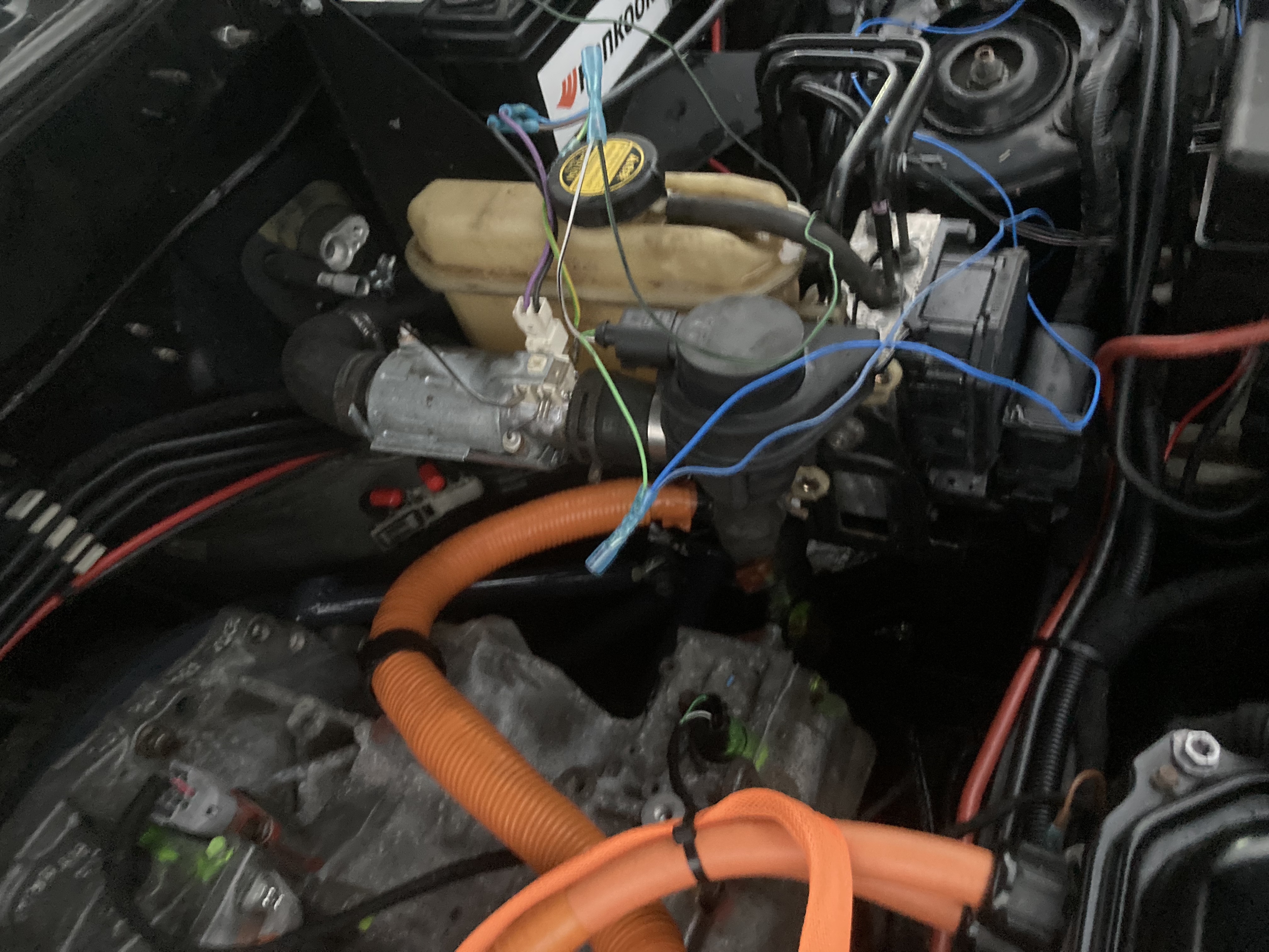

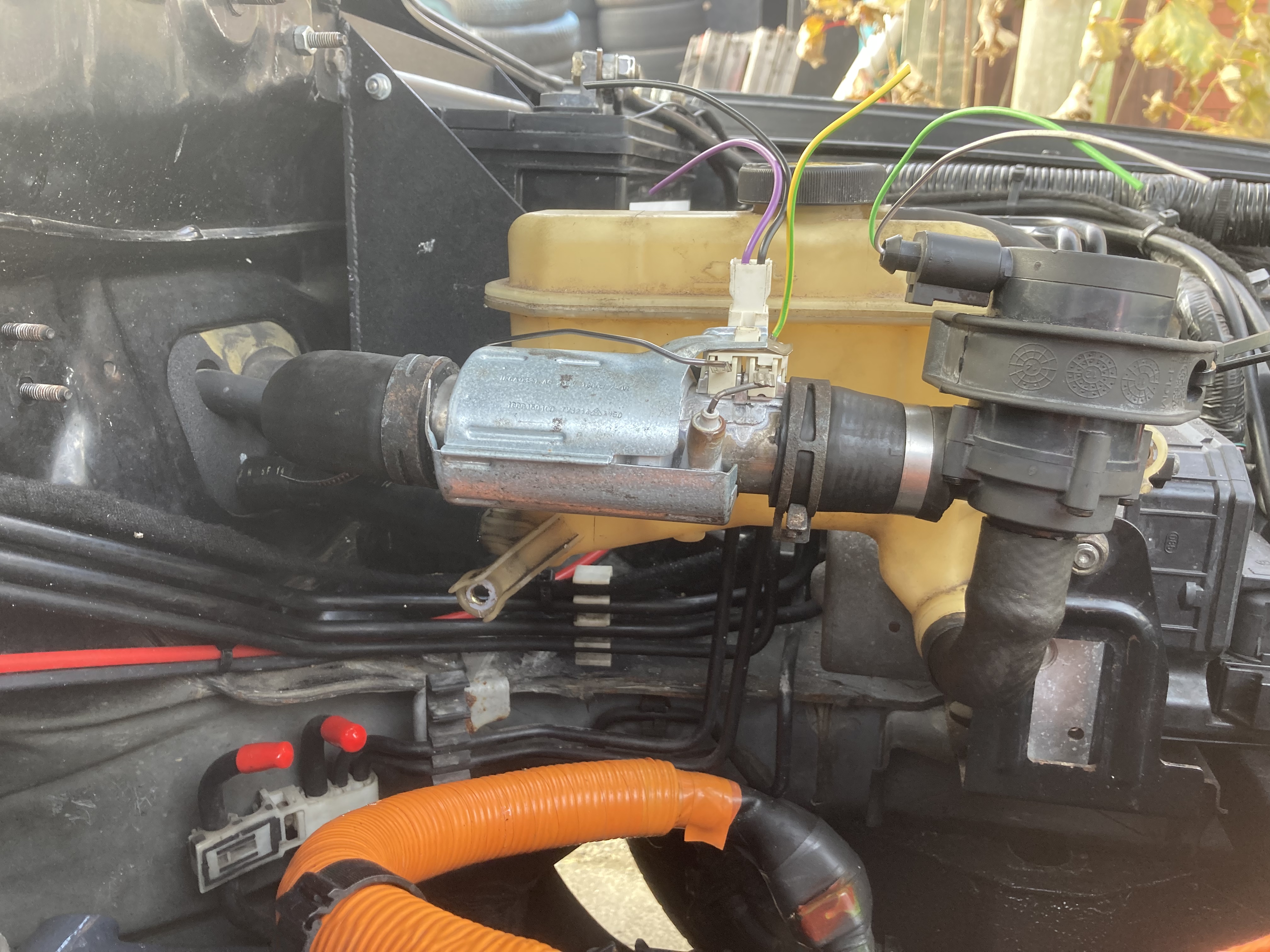

Awfully clean project!! I'm going back to clean mine up before posting anything. Do you have a vacuum reservoir with your brake boost setup? You got cooling all plumbed in too?
Nice going
Nice going

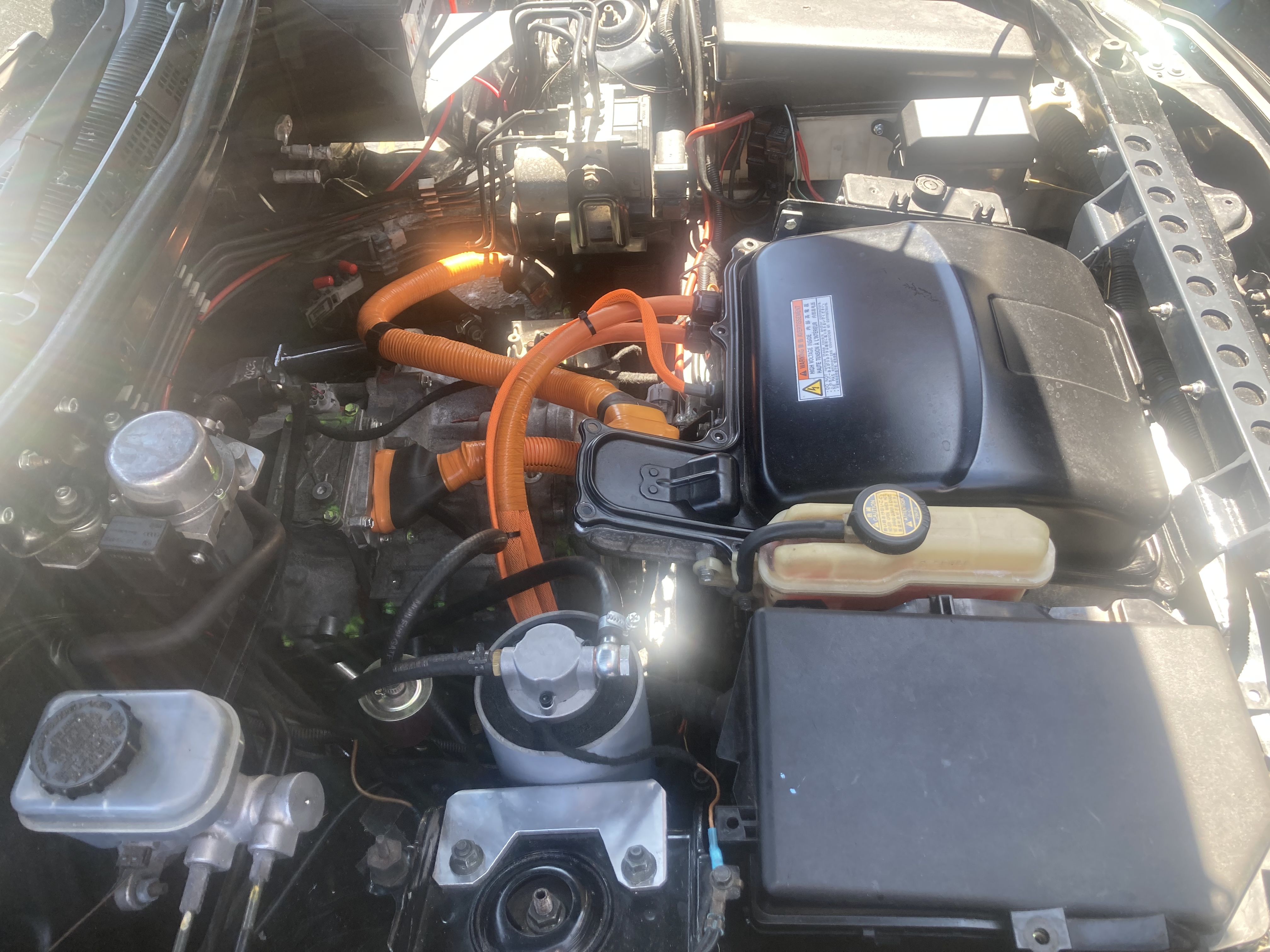

Nope no vacuum reservoir, I did on the previous setup that used a Saab pump and switch it needed one because of the lack of hysteresis, but the Audi pump and johu’s board works well without a reservoir,
Cooling is all plumbed into a fiat cinquecento rad behind the bumper,
And the auxiliary oil cooling pump which runs when the motor is turning has an oil cooler radiator beside the left fog light

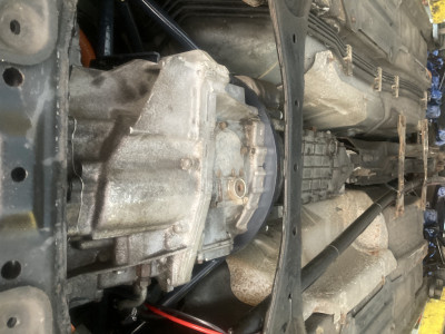

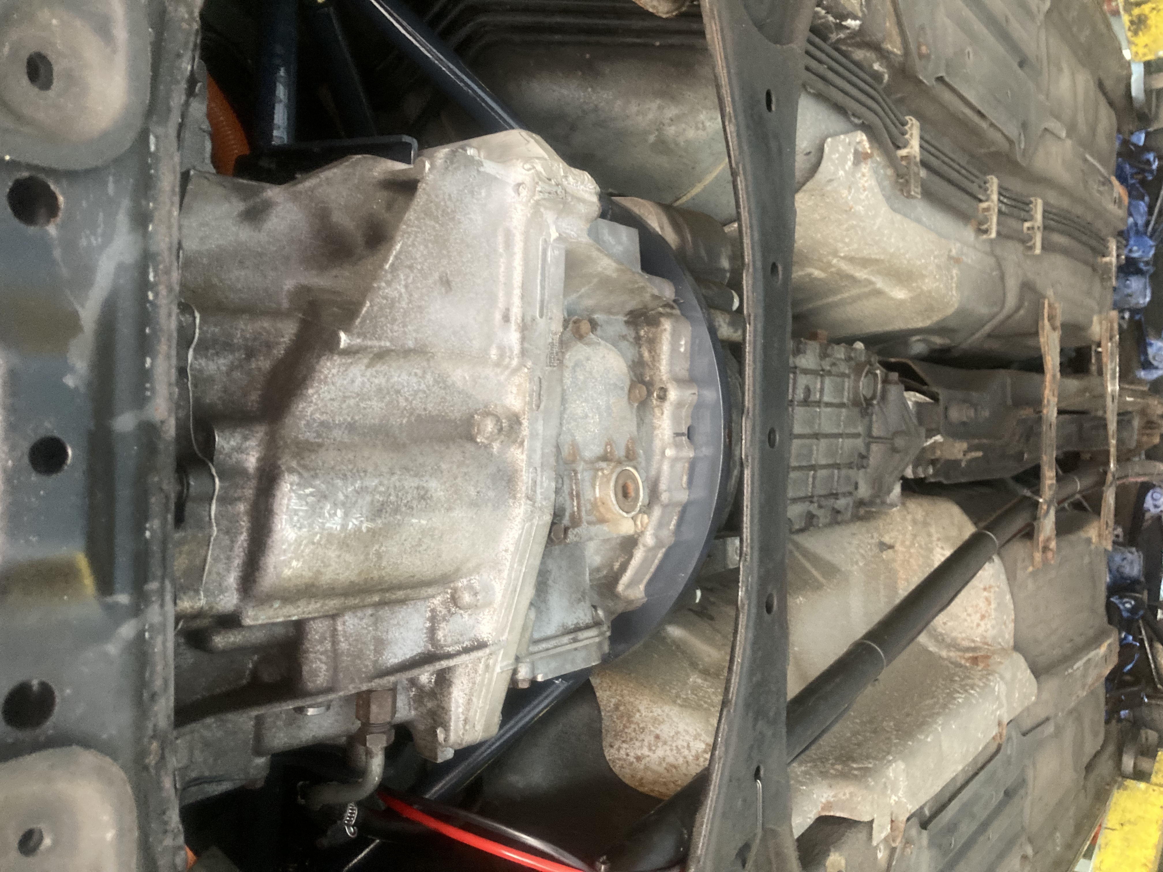

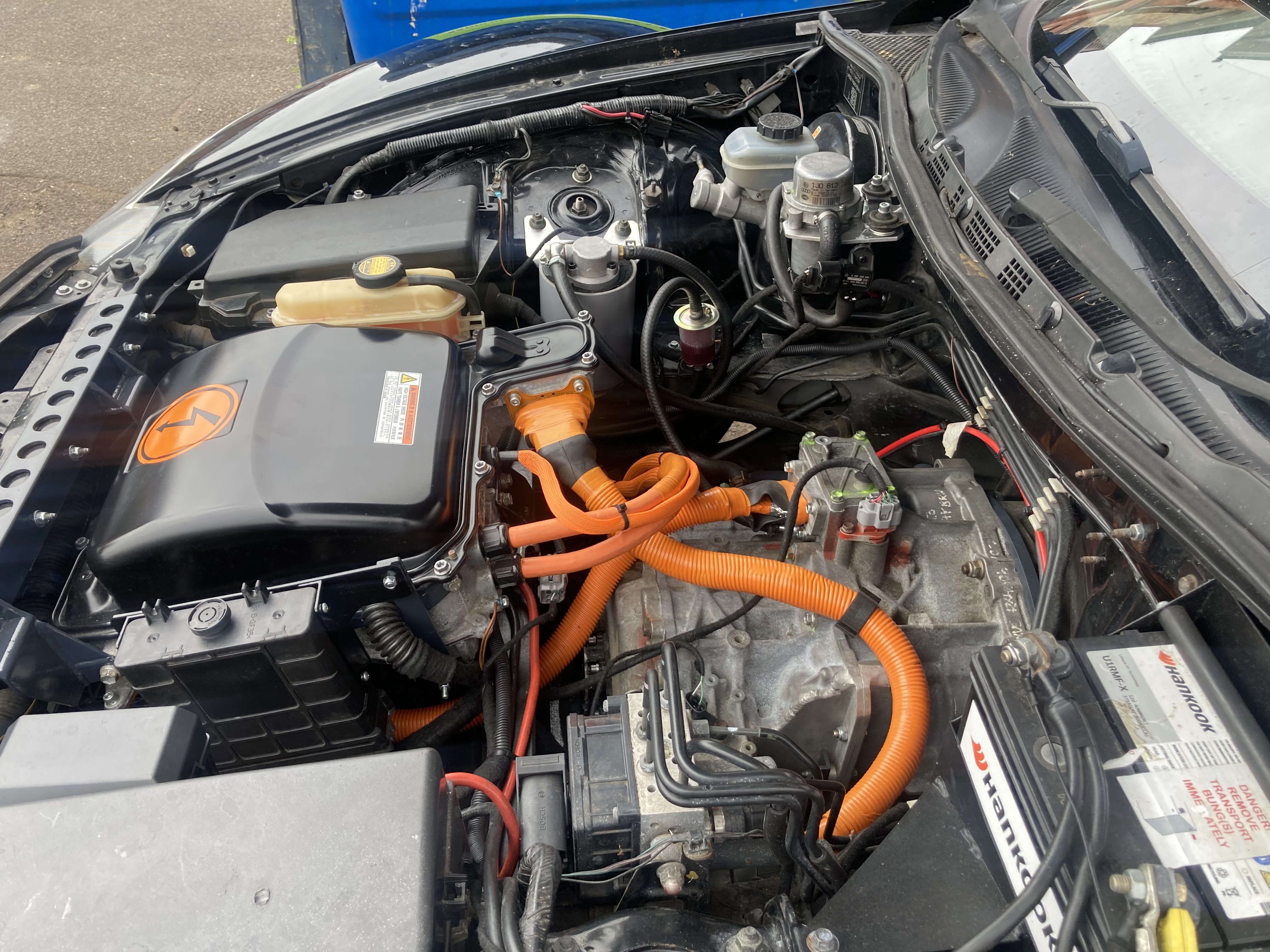

Well it’s been a year off the road and a complete re engineer of the drive system, almost to the point I’ve basically converted 2 cars now, but I’m back on the road Mot passed and drove home, some interesting slow speed drivability kinks to sort out so lots of software tuning to do, but I’m happy to have made this milestone

Ok 1 week on the road and 40ish miles of to and from work, ( I live in 2.5 miles from work so every day is a test drive, not an efficient one either!) I have been playing with syncadv a lot slowly increasing it, I’m up to 14 now with no Ill effects, increasing it certainly helps maintain power higher into the revs,
I like others have experienced am getting strong regen when lifting off the throttle when over 4000rpm which will persist until revs lower significantly then returns to normal with a jolt, I need to test if this is the case with regen turned off or not? If so maybe some kind of regen disable above a certain rpm may help, I only run 5% off throttle regen as I prefer it this way.
Happy with the progress so far,

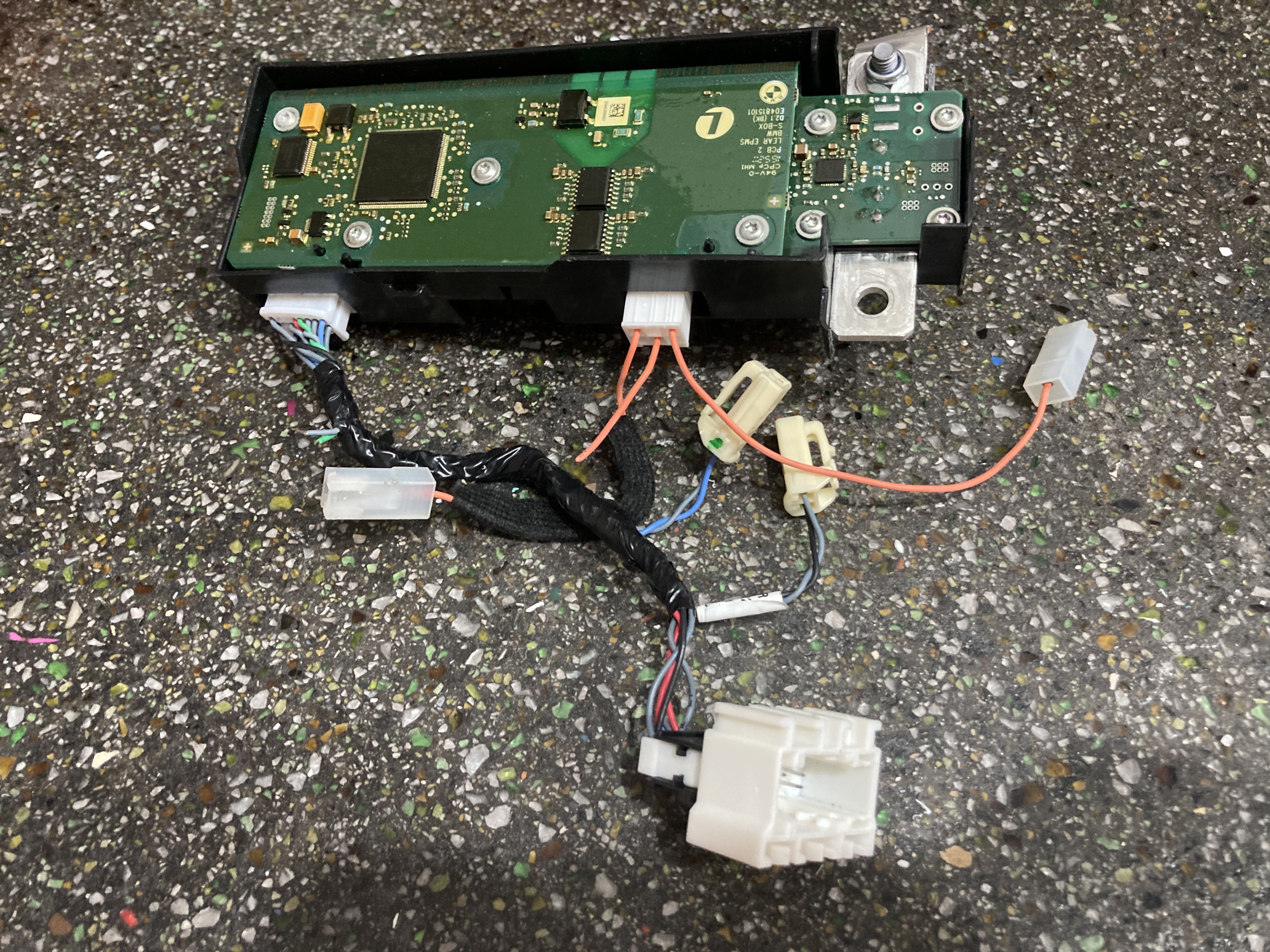

Not much of an update as I haven’t had much time lately, no work done on the chademo although I now have an isa shunt to use, will help me use existing code, otherwise I’ve just been playing with lots of inverter software versions trying to tune things better.

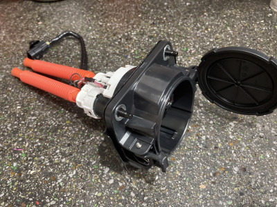

So I guess my project thread is overdue an update, no real hardware changes but I’m hoping to get chademo installed by Christmas….. mostly I’ve been doing lots of driving, tuning, testing firmware…. I’ve done 700miles and still finding small gains or improvement In drivability, those who have been following the IPM control thread or Johu’s a2 Prius build will know how these motors love high voltages so although I’m hoping to pick up some more modules and increase the battery voltage I’m quite happy that I’ve managed to squeeze 100kw out of the pair with just an 80s pack so that’s about half the rated power of the Lexus motors at half the voltage! The torque is pretty impressive

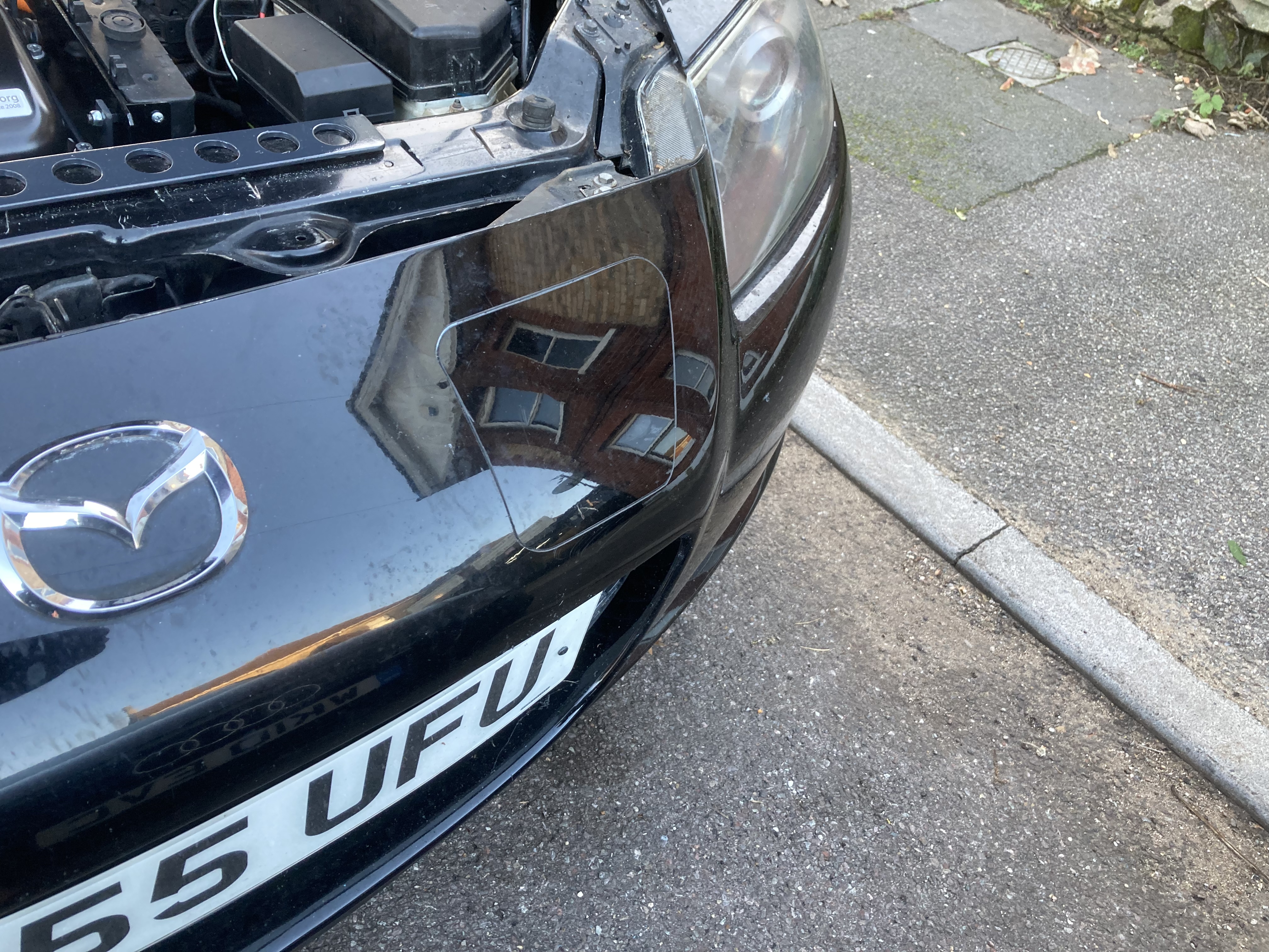

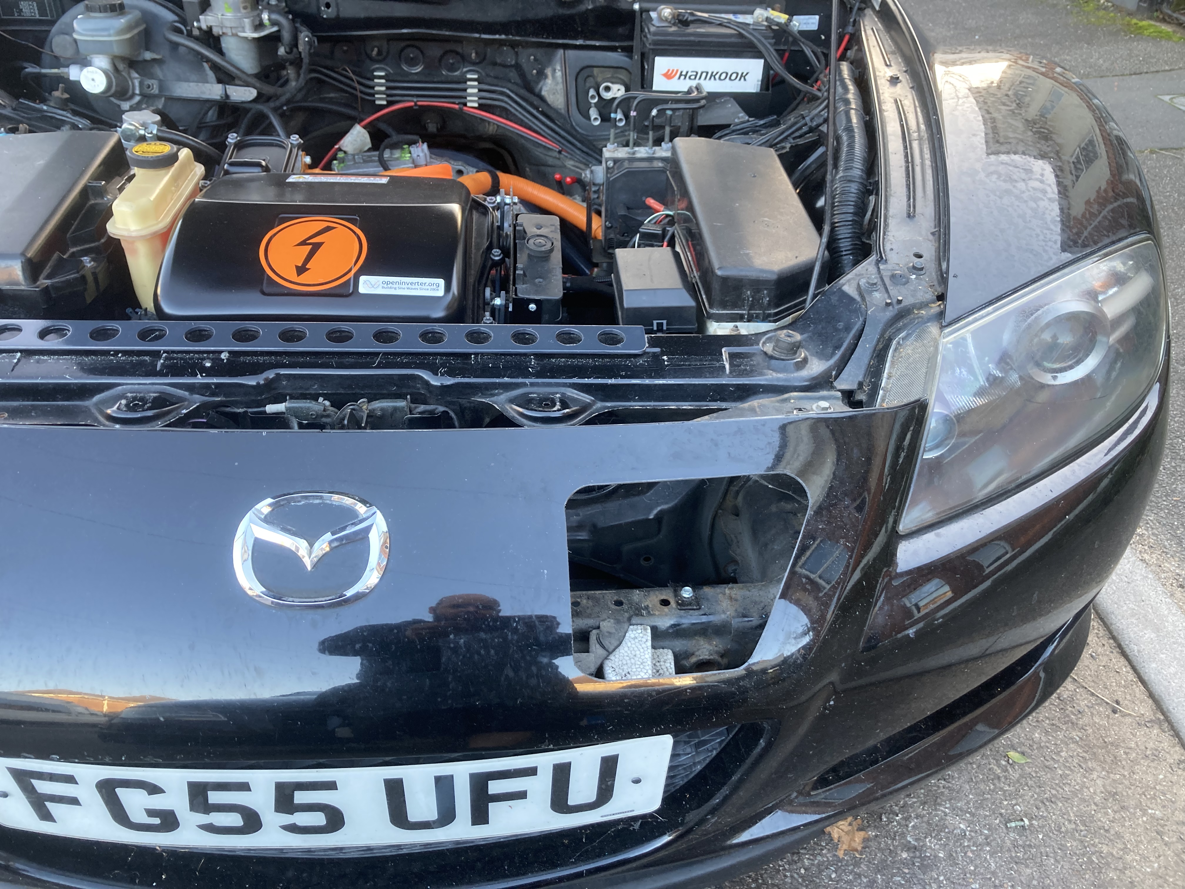

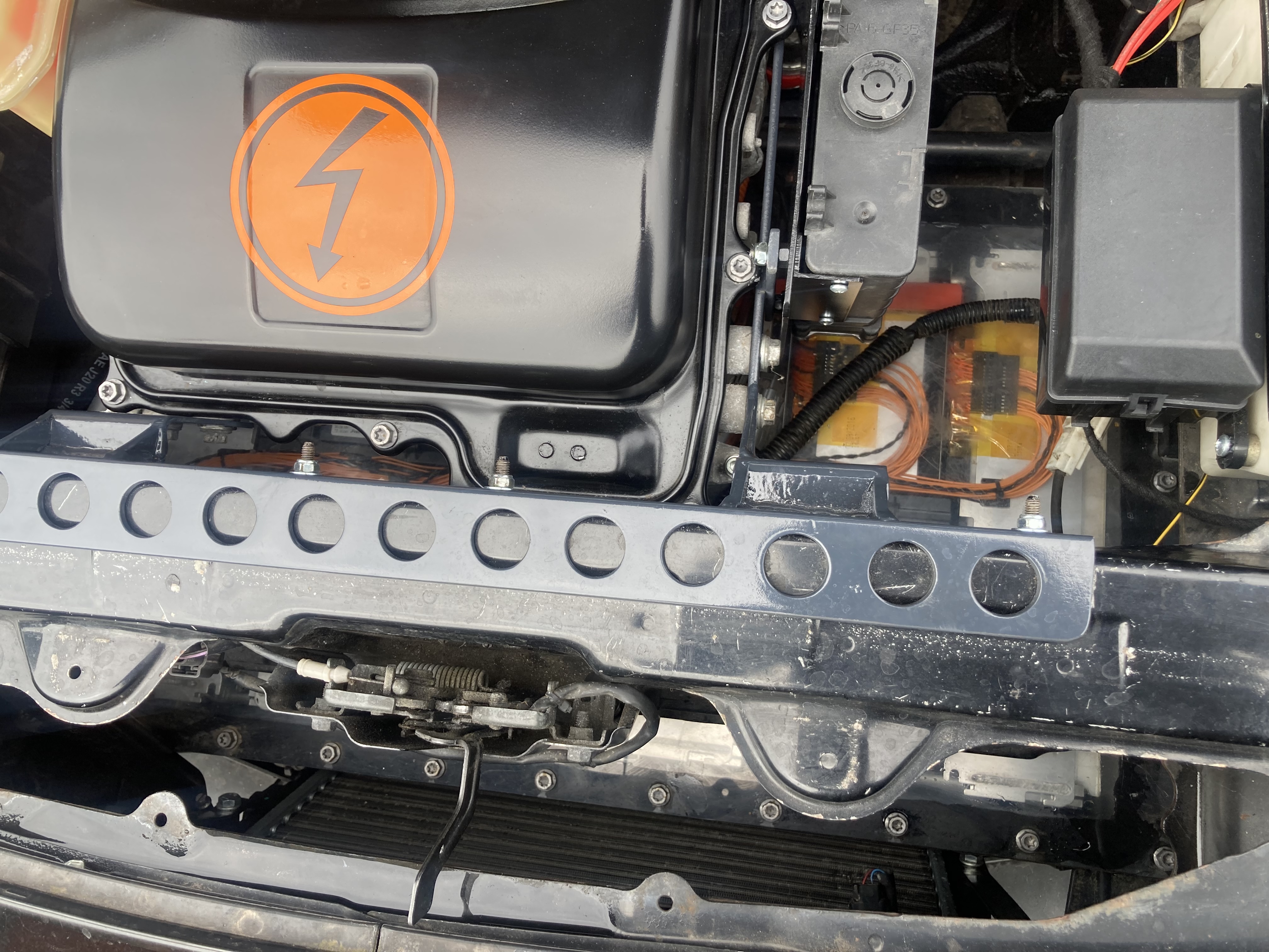

Ok so with the uk weather suddenly turning into 3c in only a couple of days things have changed priorities, I had started project chademo by cutting a hole in my bumper to make a flap to cover the charge port.
But now it’s cold and this car is my daily transport so it suddenly beacame a case of I need a heater quick to de mist my windscreen, what can I cobble together out of stuff I have laying around?
Please excuse the crudeness this is currently just wired to a 240v plug as I have been putting the car on charge for an hr before leaving in the morning to warm the batteries a bit, so I will just plug this in at the same time to dry and pre warm the cabin, mid term I will wiring the dishwasher heater into the battery, repurpose the thermoswitch to turn a contactor on and off, and maybe try and put a box around it and mount it better than zip tied to the abs pump!
How on earth did you cut such a neat hole?
That was my first reaction too. Must be high accuracy laser cutting for sure
EV8 I would like to know how you are heating your batteries? Do you have coolant circulating through them and you heat that coolant with some sort of coolant heater?
To cut the hole I used a fine toothed fretsaw blade, snapped the end of it off and heated it with a blow torch on the end to melt through the bumper to get started, I had masked it all up and drawn it out neatly so I had something to follow,
As for battery heat currently I have nothing other than the warmth they create giving them a charge for a bit, but the front modules are actually sat on heated seat mats in their box but these aren’t wired in yet, rear batteries are inside the boot a stay a couple of degrees warmer,
I really hadn’t counted on the weather going from 10-12c to 3-4c

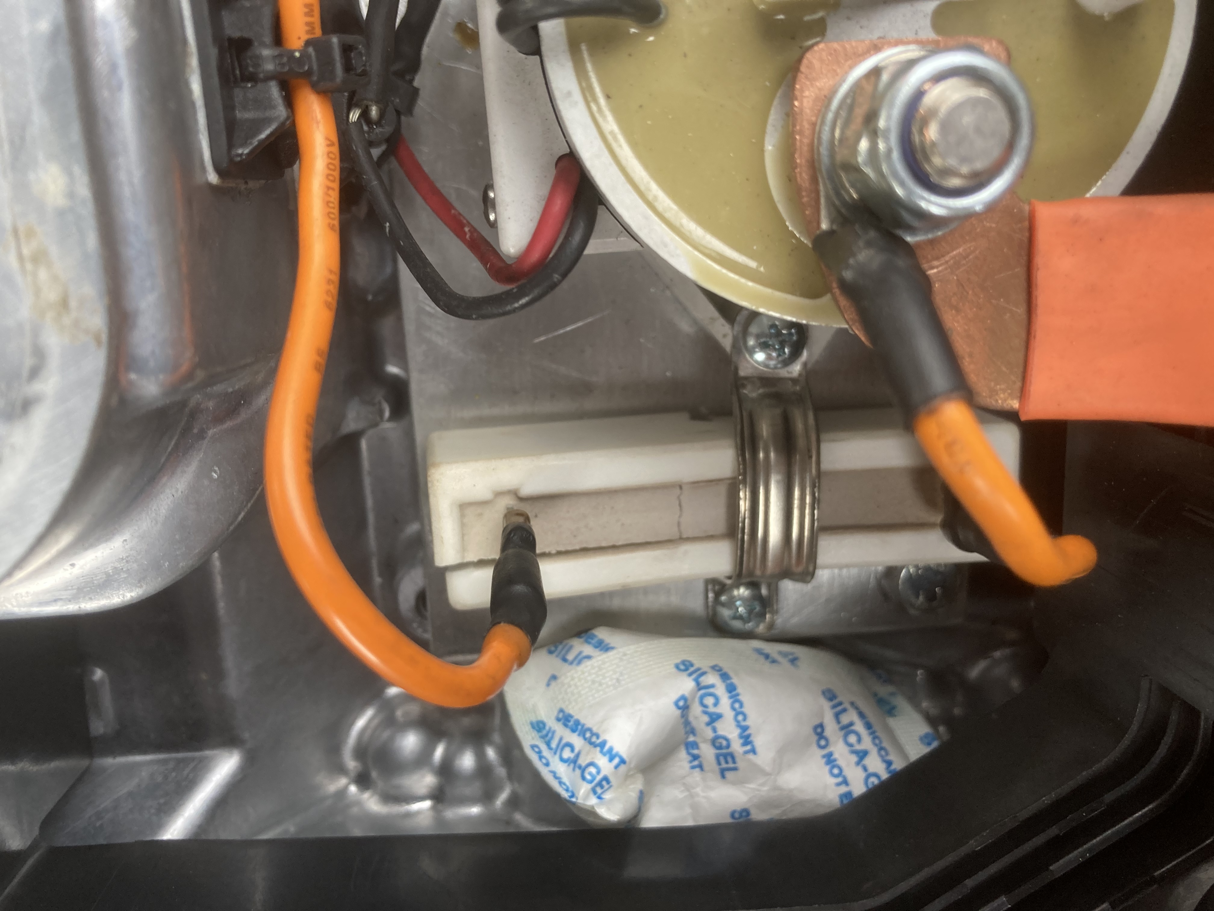

Precharge resistor completely split open but somehow still working!
I'm guessing that moisture has caused that.
The porous ceramic package has soaked up a bit of moisture from humid air and then when the precharge has happened the core of the resistor has got hot enough to vaporise the water and the rapid increase in volume/pressure splits the package. Not too surprising that it is still working as that failure mode wouldn't stress the resistive element too much. You can get similar effect if electronic ICs that have been stored in humid conditions are reflowed without baking.
See you have a silica gel package in there but it is surprising how quickly they get saturated and stop doing much and with the cold weather recently it wouldn't be surprising if it was slightly damp in there.
Well I’ve just replaced with an aluminium bodied 100w 15r resistor hopefully this will be less prone to this kind of failure, I have some silica packages here that are self indicating so I’ll get them in there
