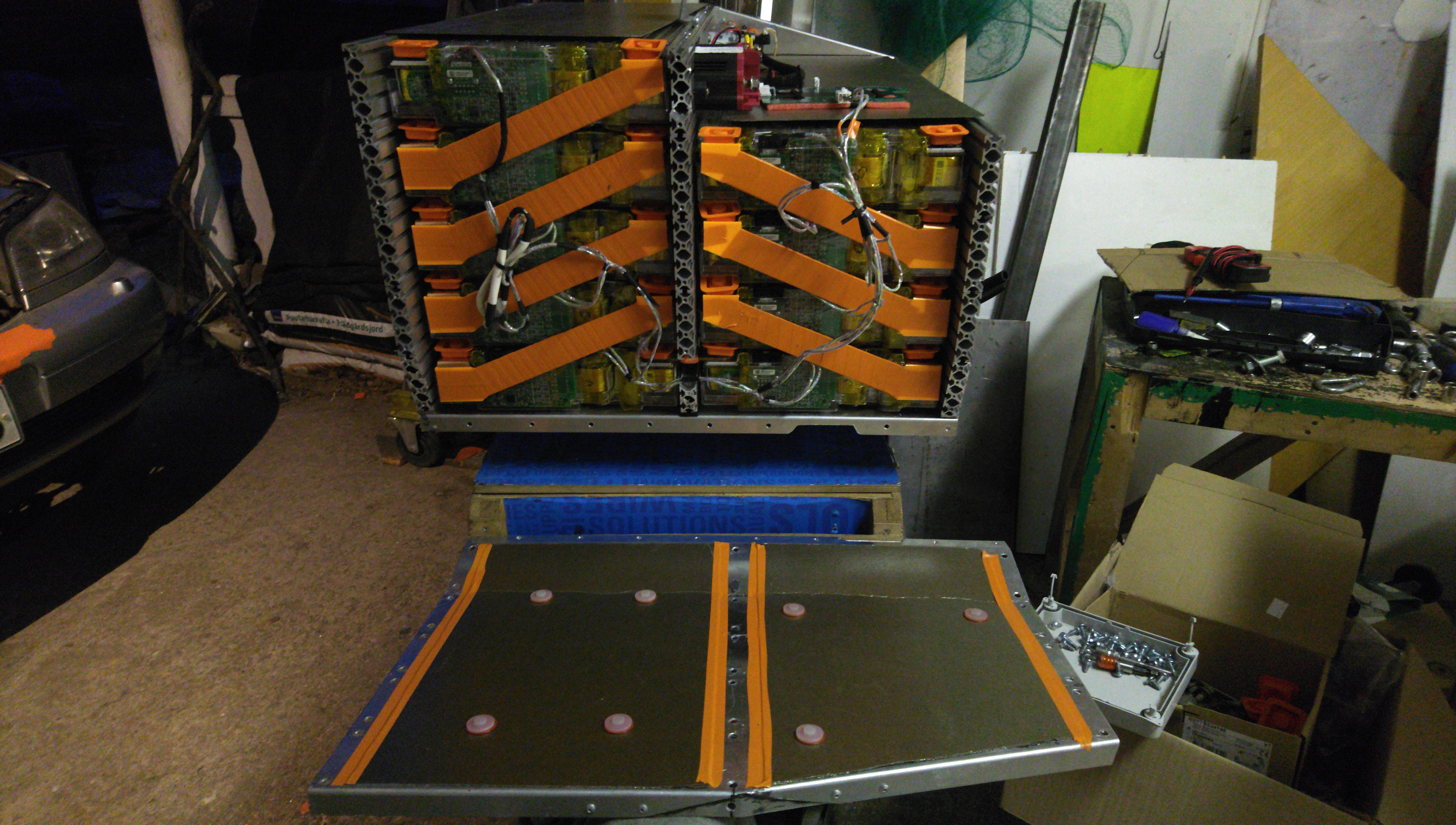

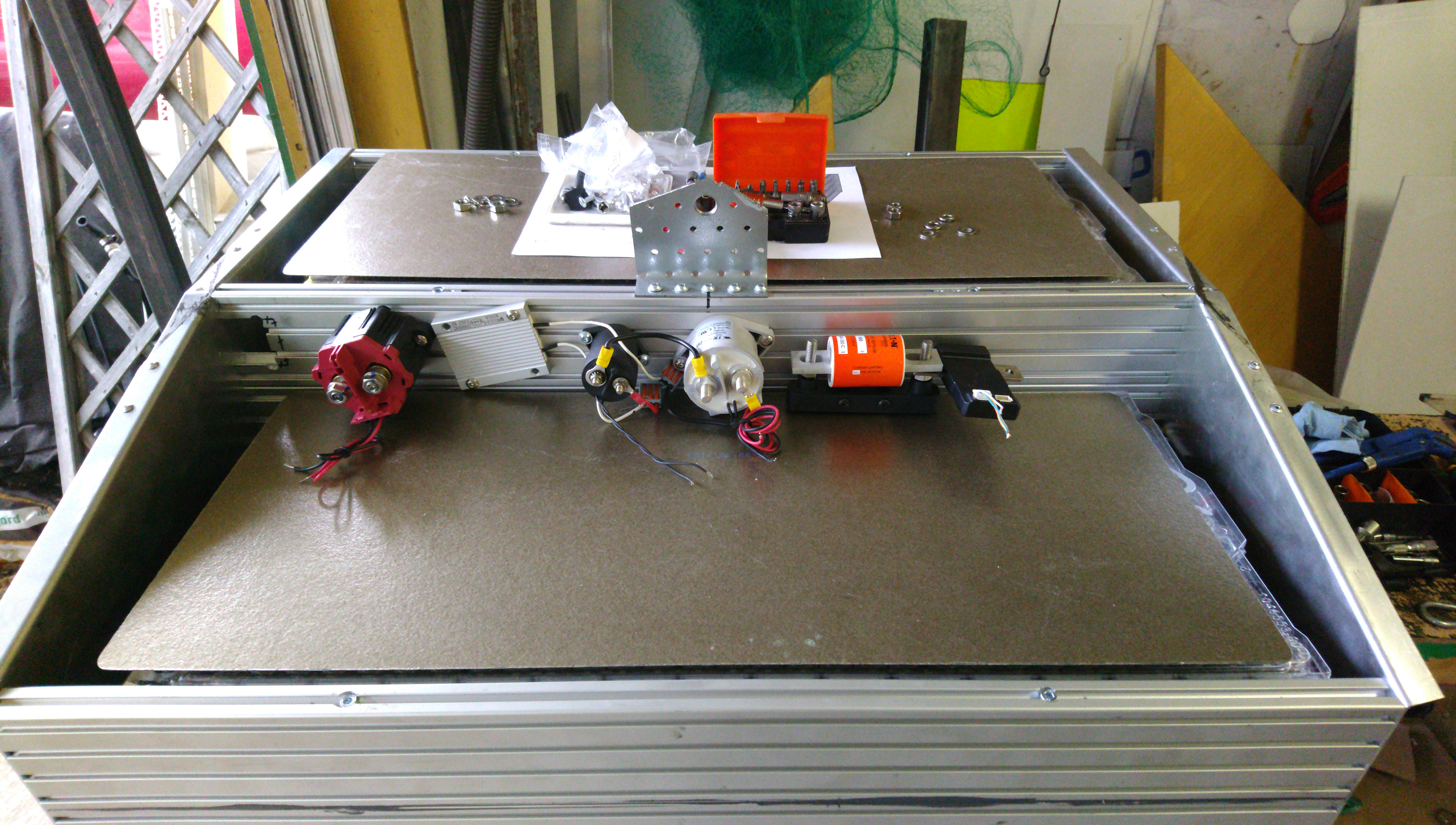

How do you like the look of very expensive? The not very expensive option is to the left.

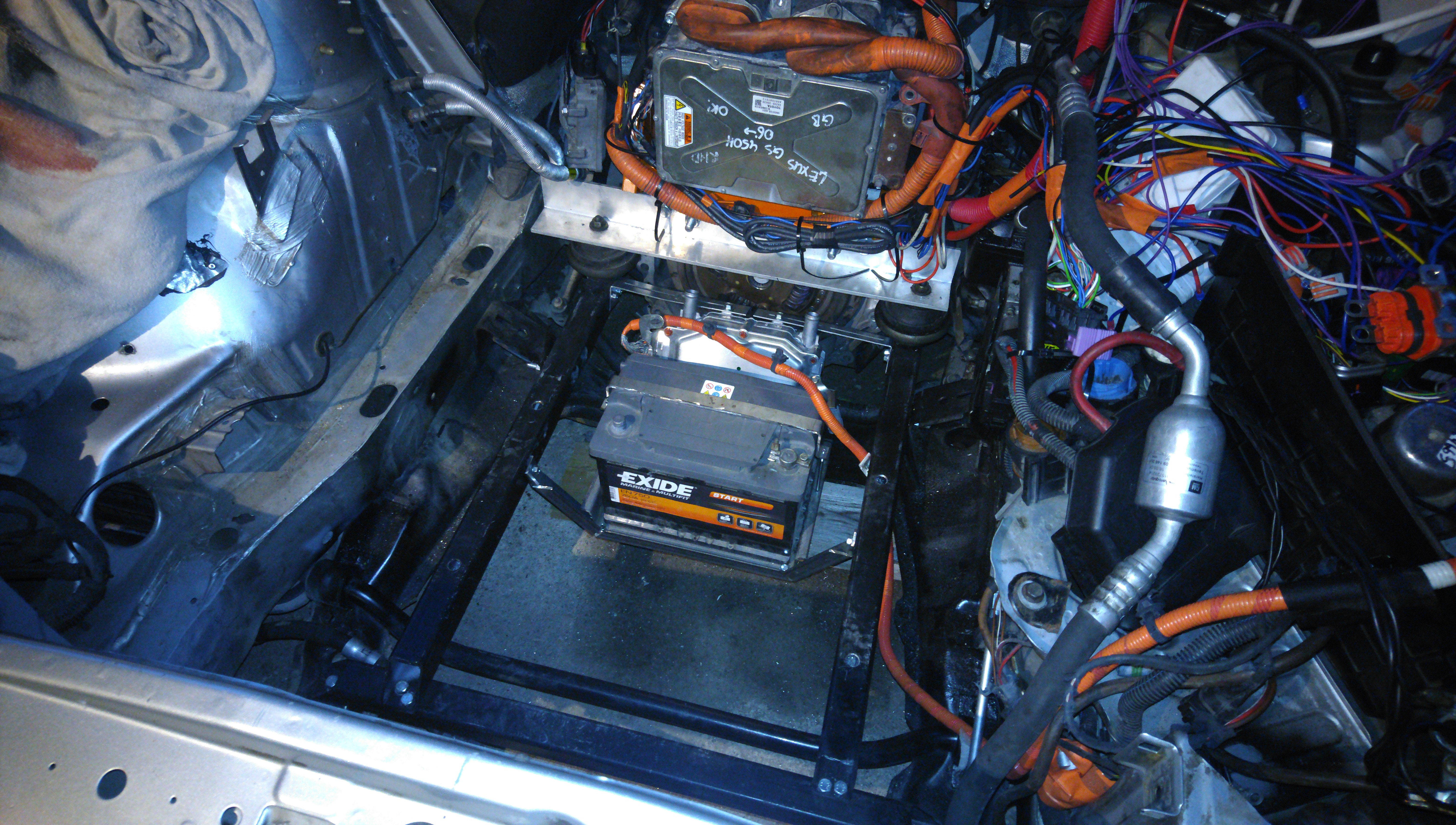

I have to house the HV junction box at the original 12V battery location. As the 12V battery isn't really a service item and I didn't want to run super thick 12V cables to the rear, I placed it underneath the front battery box, next to the cabin heater. These are both mounted now to my satisfaction, and, as I type this, the steel parts are getting accustomed to their new coat of paint.

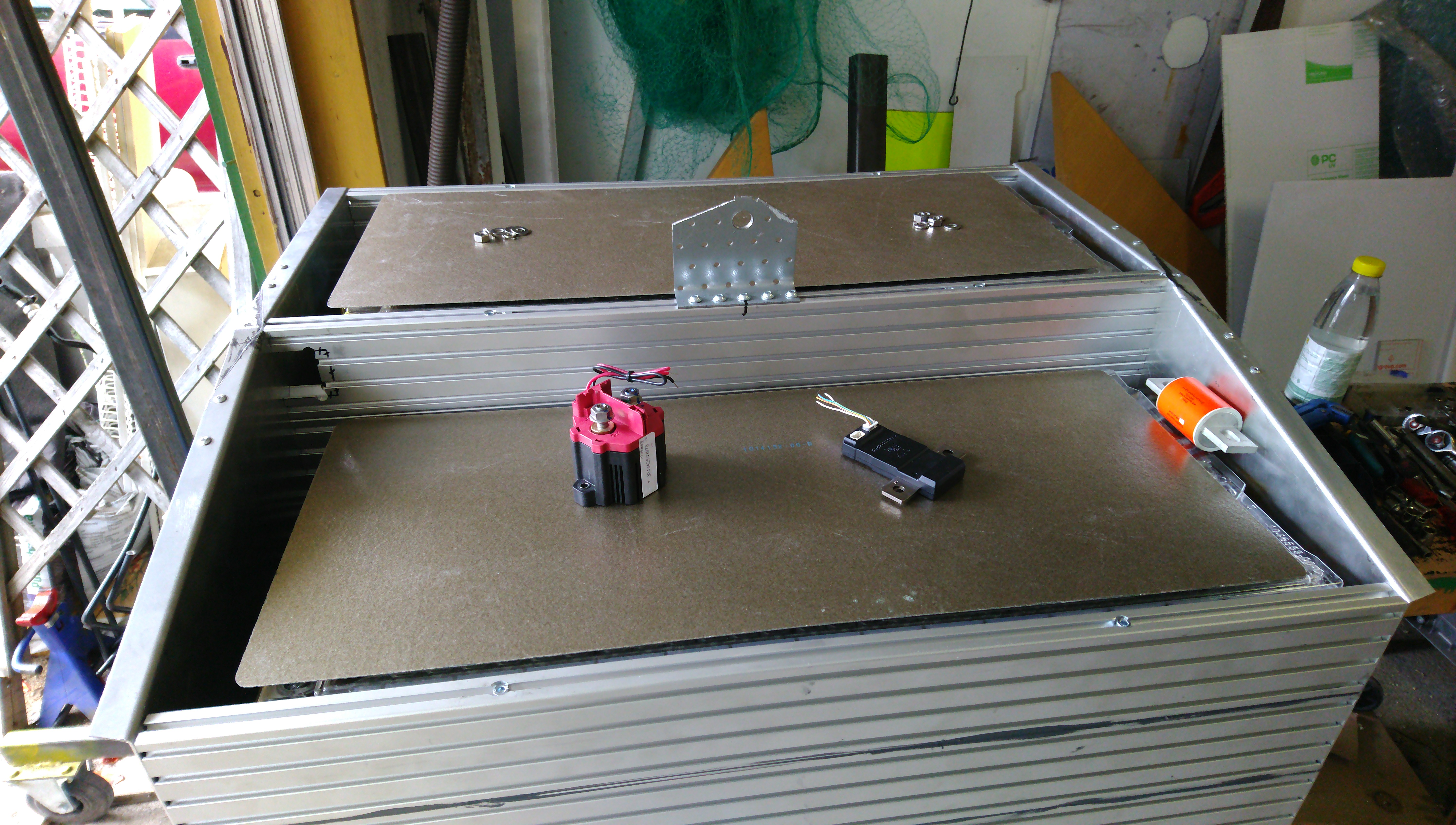

I like your battery box, looks much lighter than steel one that I build, which also took ages to build. What size and type of aluminum bar you are using?

Interesting. Any specific reason you built it from segmented alu fins instead of bending from full alu sheet?

Those are 20x80 profiles. I use them because they match the module side profile quite usefully, and I need those sides to be extra rigid because the box has to be 2mm thick at the ends due to space constraints. Also I have had time constraints when designing it, and I wasn't sure if I could find a place to bend sheet metal. Well, as you can see I did find one, but that was after I made the design. This design could have been made caveman style if I had to.

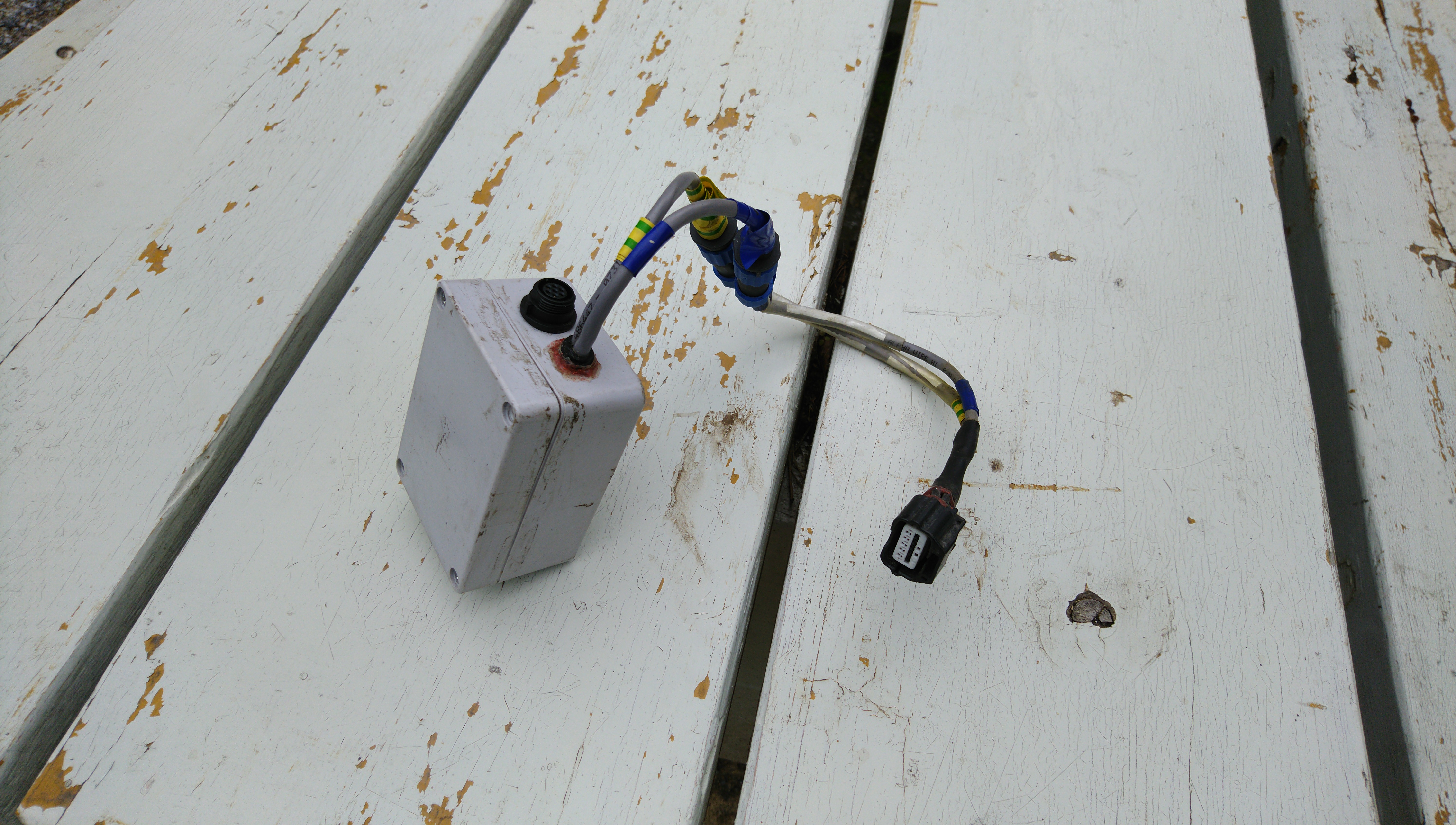

Work dumb, not hard. I was getting a headache from thinking about installing the charger to the rear, so I... installed it to the front. By the blessing of some kind of Automotive Jebus it fit there just fine. I also managed to do a lot of plumbing and wiring. I spent too much time tidying up harnesses though - that could be done much, much later.

At the front there were originally three fans, two pushers and one puller. I installed one of the pusher fans in its original location and zip tied a small radiator in front of it, to cool the electronics. I'm still waiting for a second radiator into which I'll route the battery loop. It should fit in front of that same fan.
Mounting the GS450H oil pump controller took way too much time, and the bracket I did that with happened to be stainless steel so I even destroyed a 10mm drill bit in the process. I'd prefer having a rusty bracket in exchange for my drill bit.
I also installed the power steering pump with its return line and electrical connections. Works ok. See it? It's already installed in the photo!
Some day I need to come back to the physical mounting but I'm not expecting it to fall off so it's fine for now.

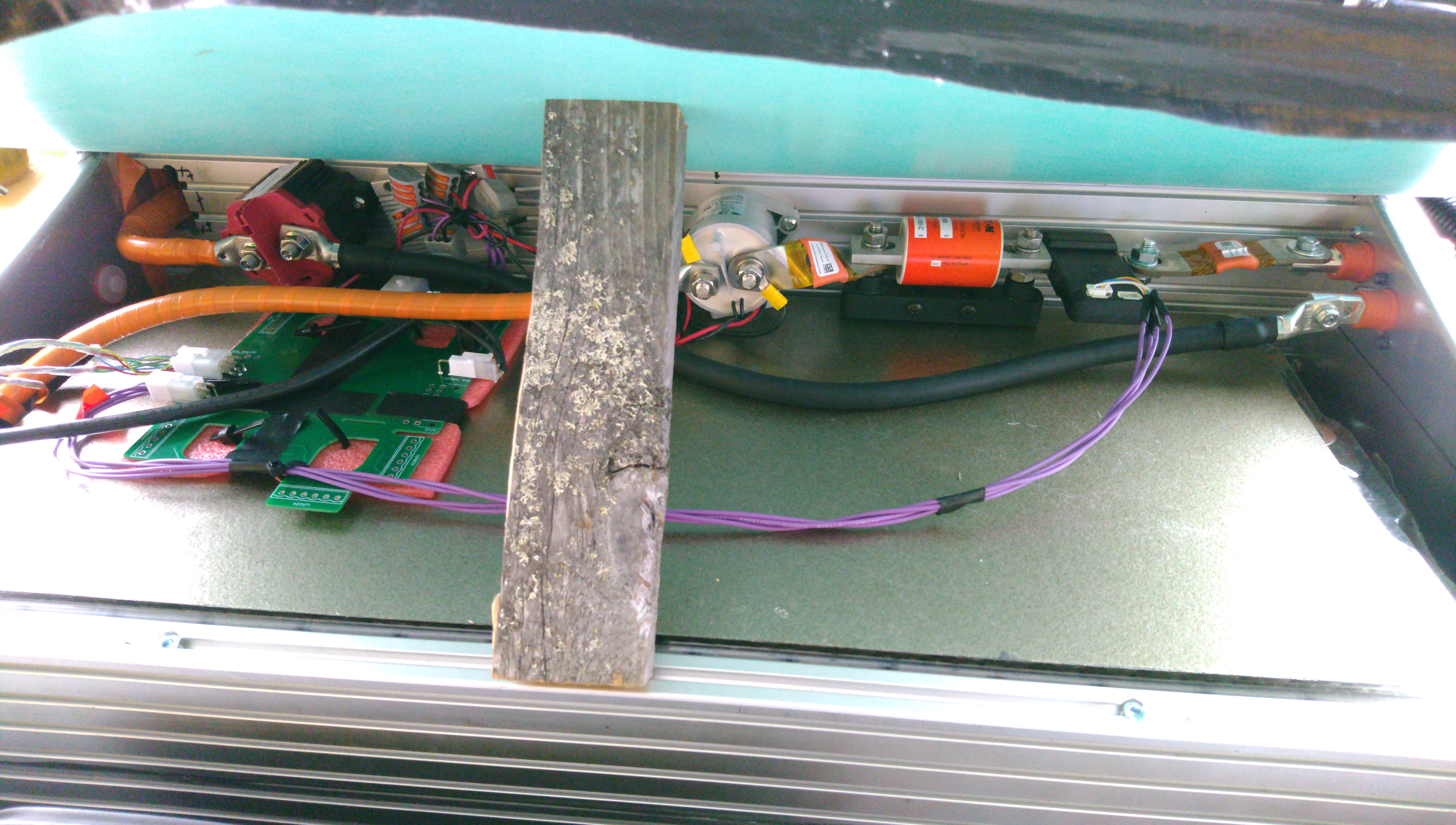

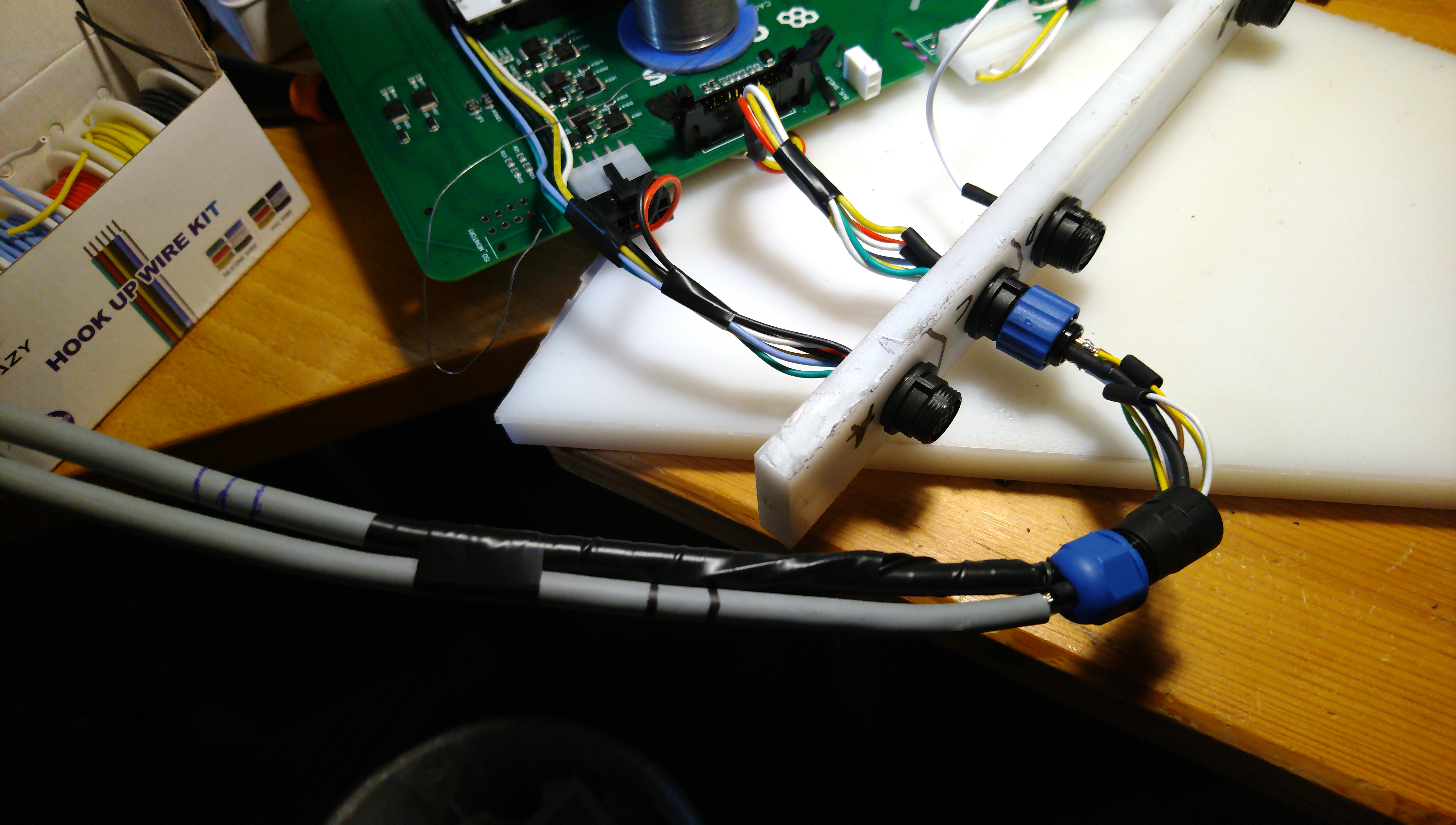

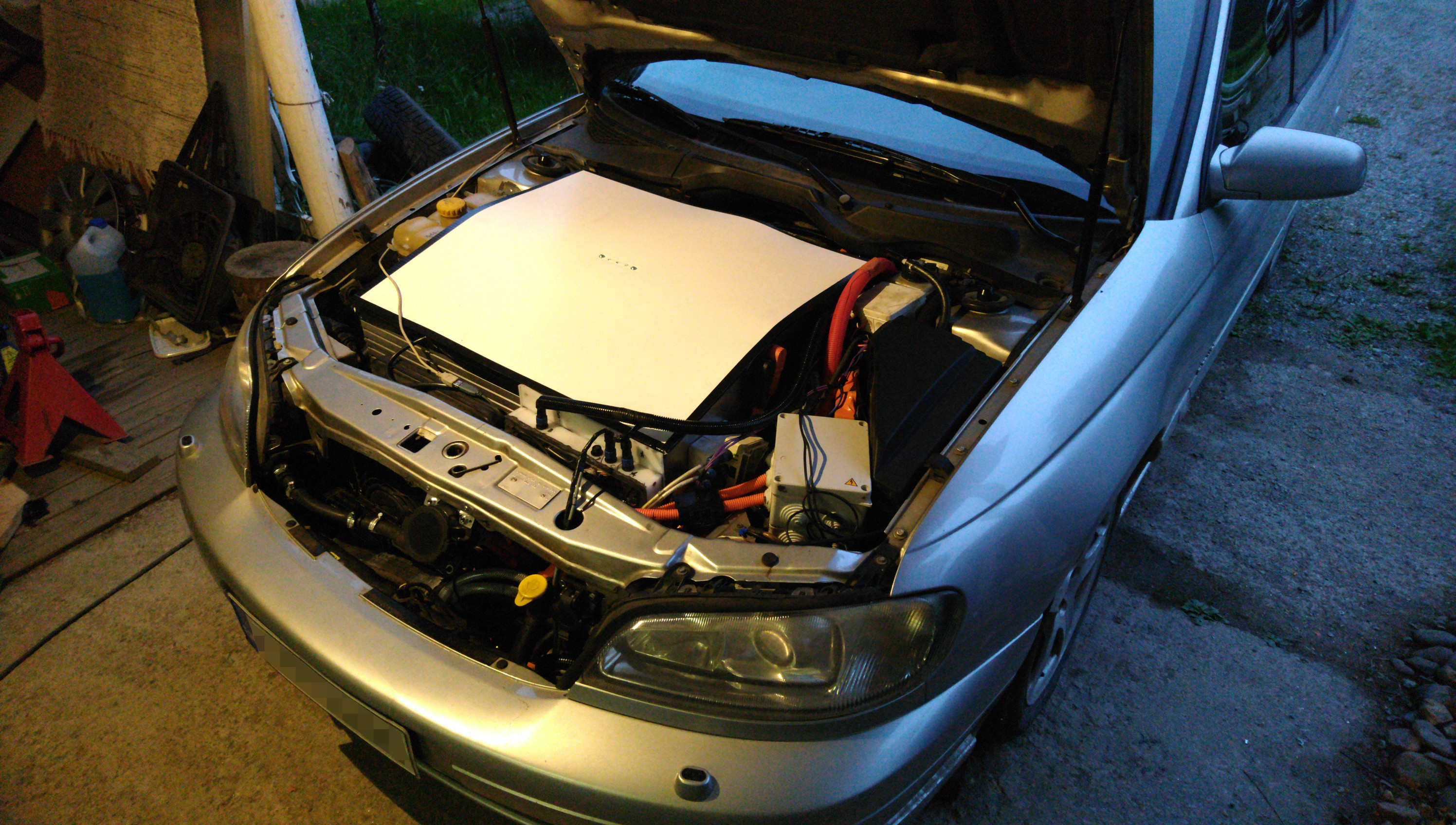

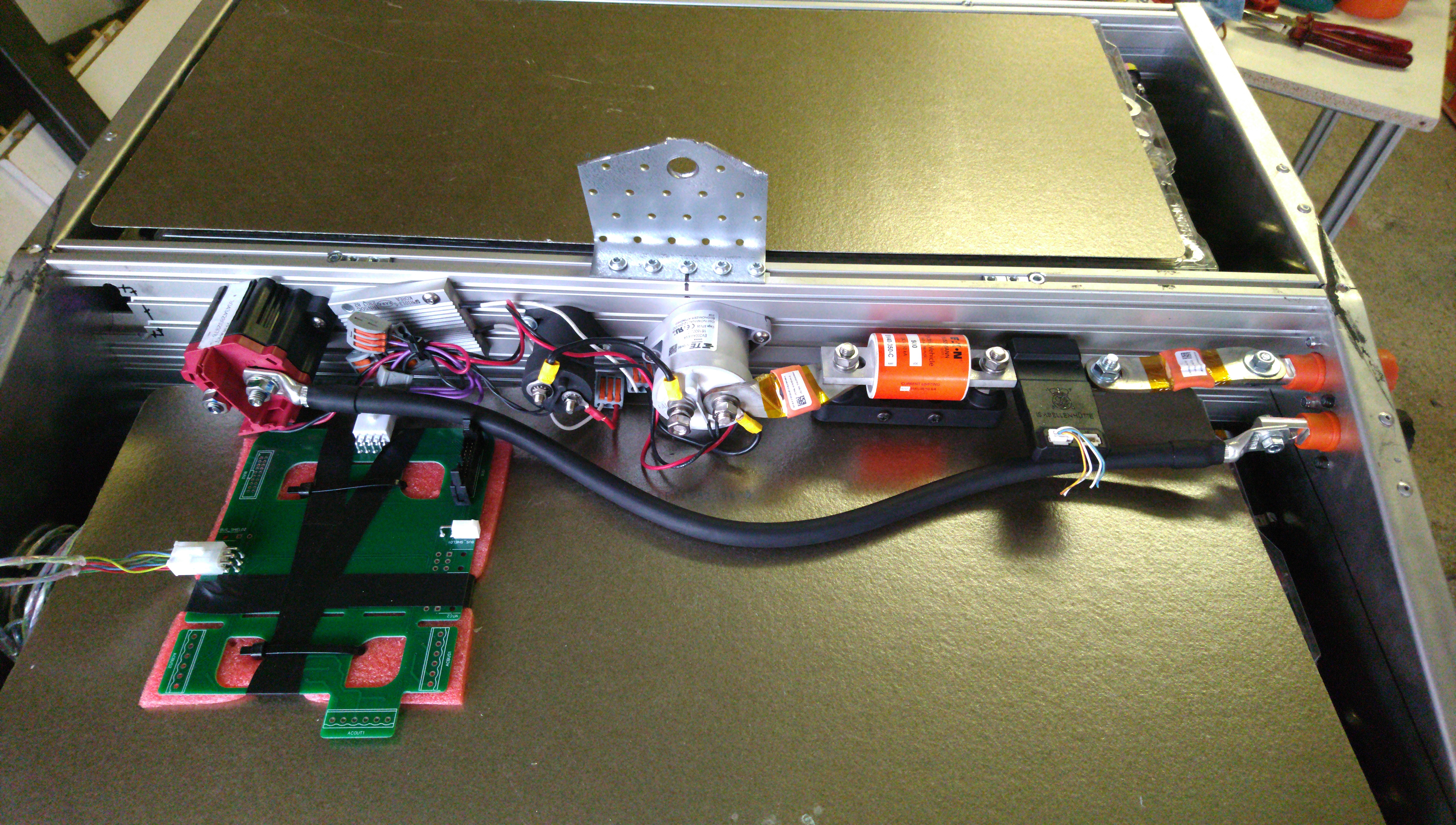

Installed HV stuff in the small space on top of the front battery box. The expensive alu profiles show an added benefit here, as I happened to have some of the appropriate cage nuts to go with them. How many? Only 1 left now. I'm that efficient. Also crimped two internal 50mm2 wires but didn't install yet.

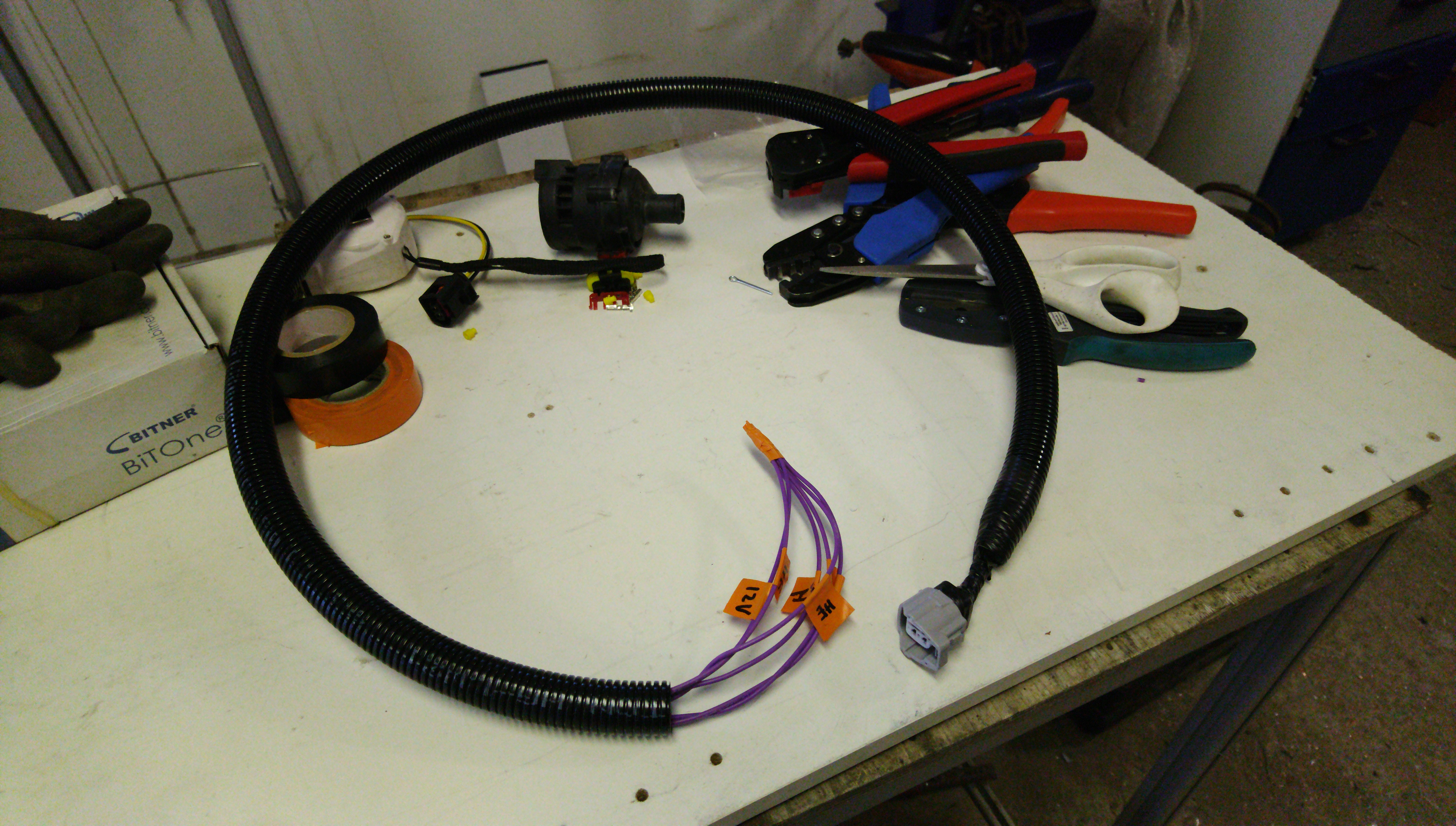

Then I quickly modified the original Tesla harness into something I can use and wired up the BMS to see if everything worked. Had to modify the code a bit to get it going. Then noticed one of the modules looked like it had a broken sense wire, inspected it, and found two detached wires on the bottom (as they always are).

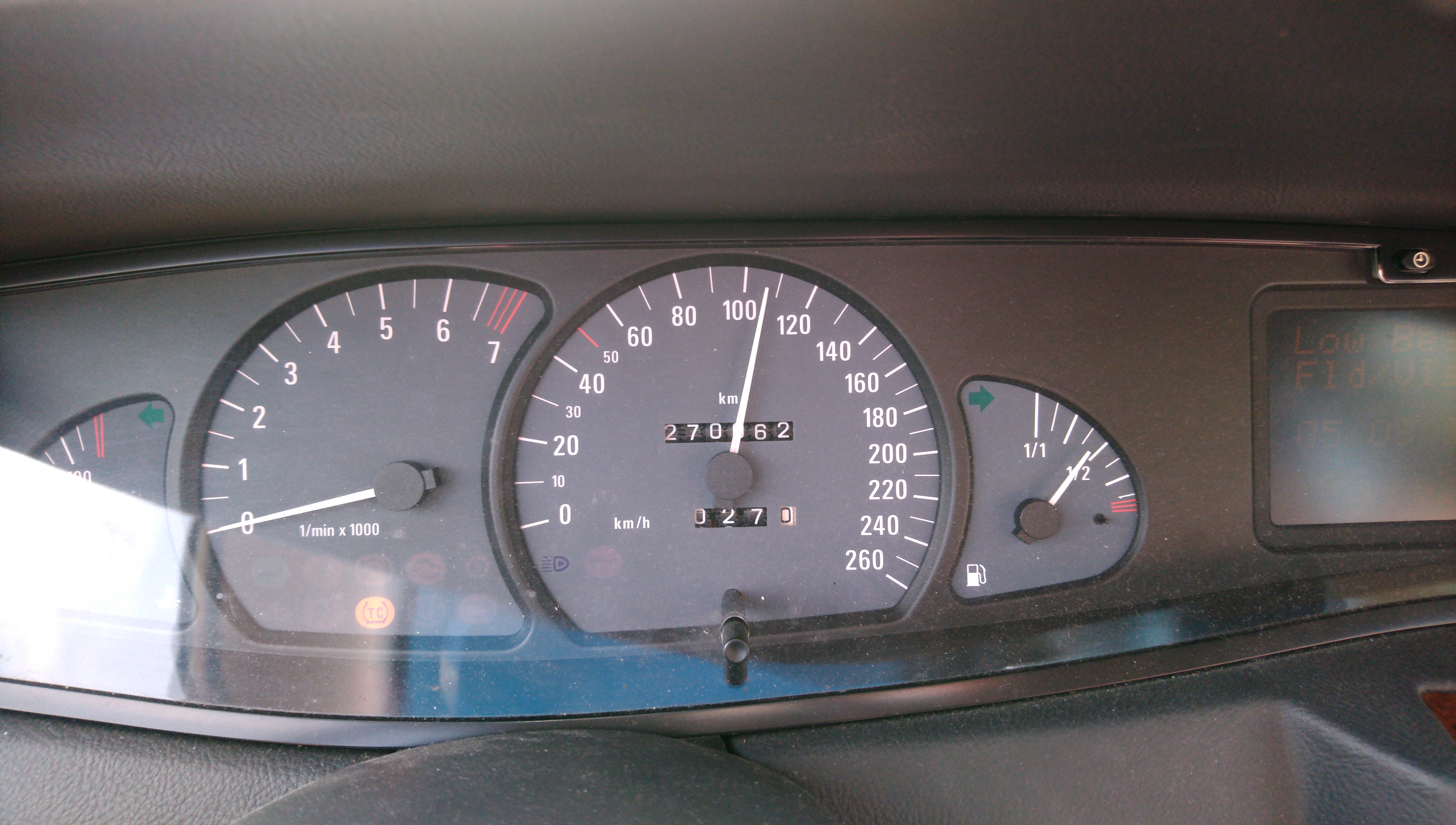

Works for me. Literally. I've driven more than 60 000 km with a similar fix so far in the Previa. This does require trickery, though. That's an aluminium plate with some kind of coating.
While I'm waiting for some high power connectors (the cheapest I could find), let's see what's on the other side...

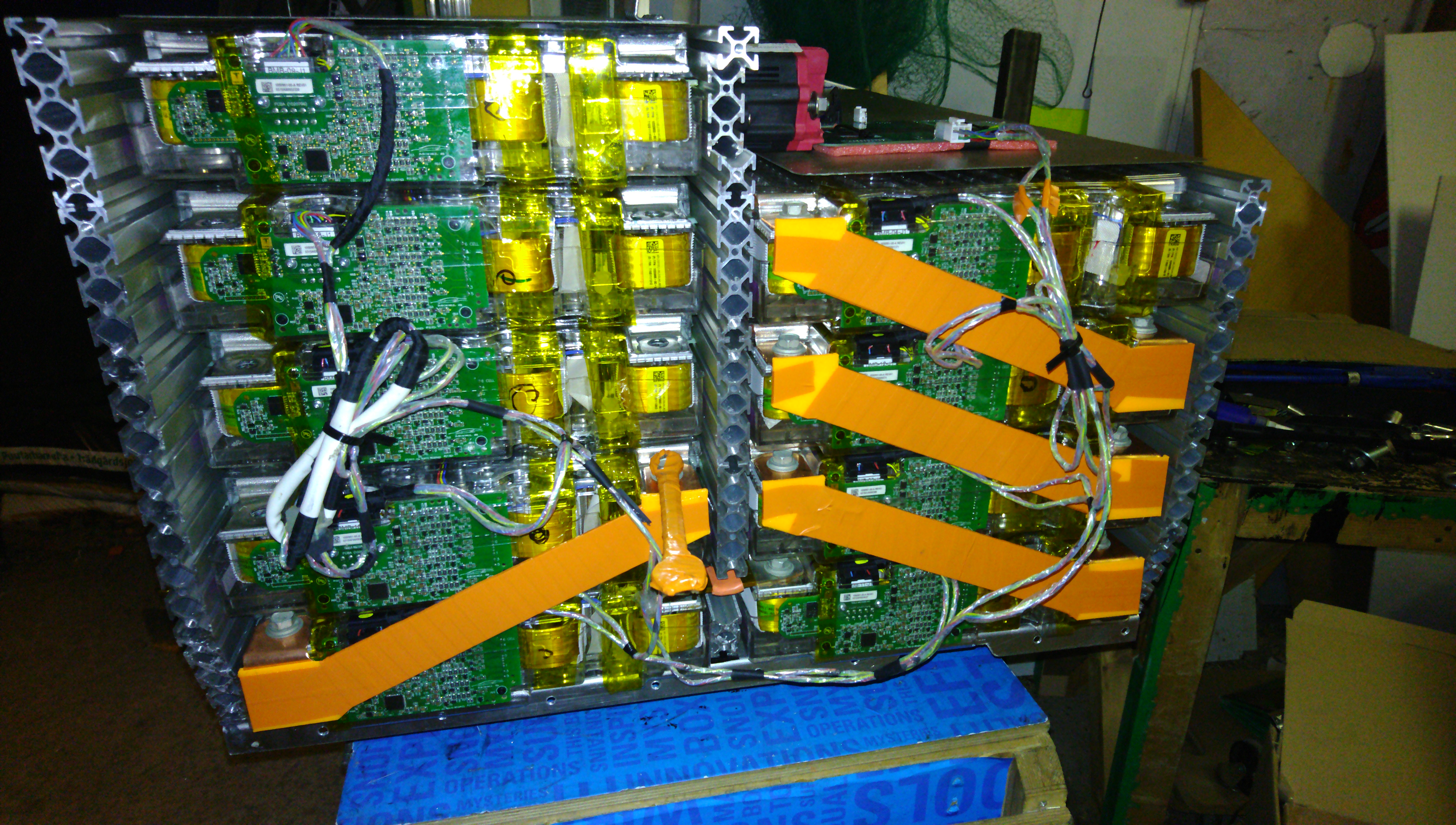

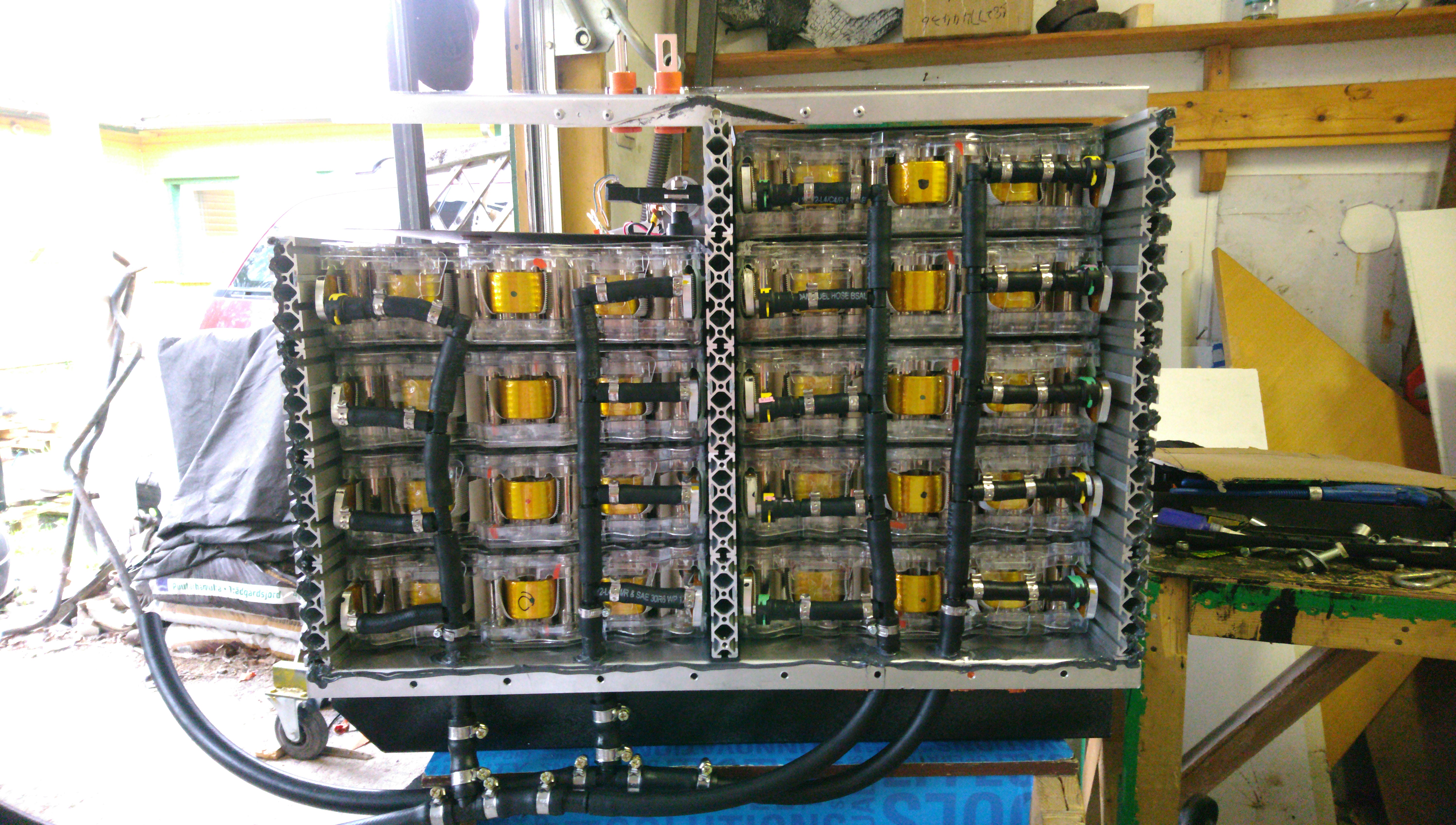

I was wondering how I'm going to get air out of the cooling loop, so I grabbed some Tesla hose connectors and... just went on with that idea. I had the space for these available and they were easier to reuse than trying to get the hoses on the non-nipples.
3D printed spacers to block the modules from sliding on the rails are also visible, and some adhesive sealant. The side plate is going on, with HV connectors. Those are Amphenol's cheapest 350A offering at the time of browsing Mouser, or something like that. I even managed to get them keyed, but didn't manage to find matching colors. Also, no HVIL. Might 3D print something later.
Turn the box around, and we have the scary side. Installing the module interconnects in this box is NOT enjoyable at all. There's very conductive very sharp alu profile very close to everything, the terminals are stacked on top of each other, the plumbing on the other end of the modules prevents pulling the modules forward much at all. Basically you just try to maintain focus and hope you'll die some other day for some other reason. And add lots of electrical tape on your spanner. And work with only one hand wherever possible.
Ready to provide some juice. 3.98V/cell.
Add some insulating fiber sheet (the Tesla variety) on the aluminium side plate, Add the spacers, add the adhesive sealant, screw on the side plate. Also seen are the final cables from the module terminals prepared with orange tape and a protective sleeve where there are sharp corners.

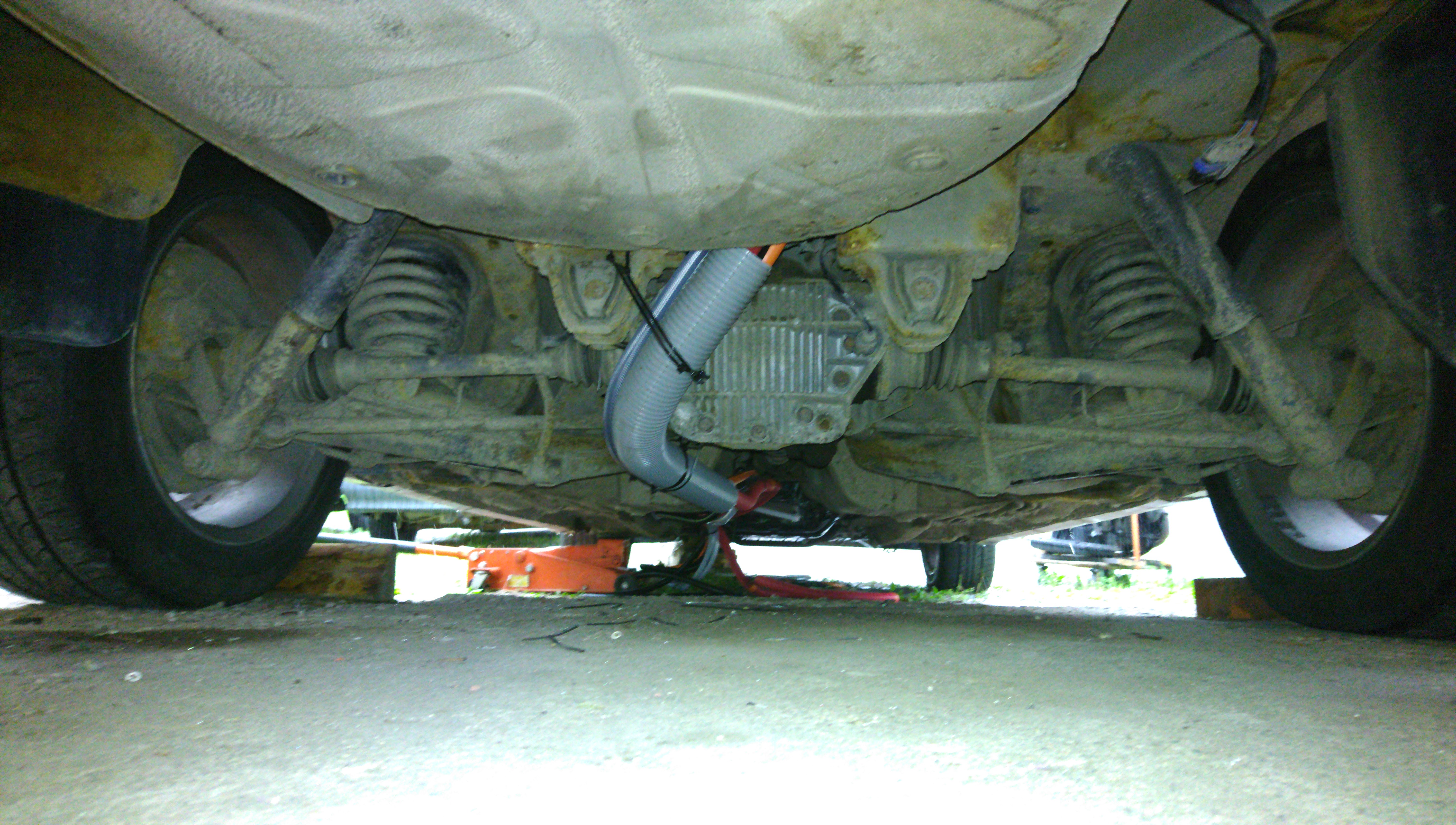

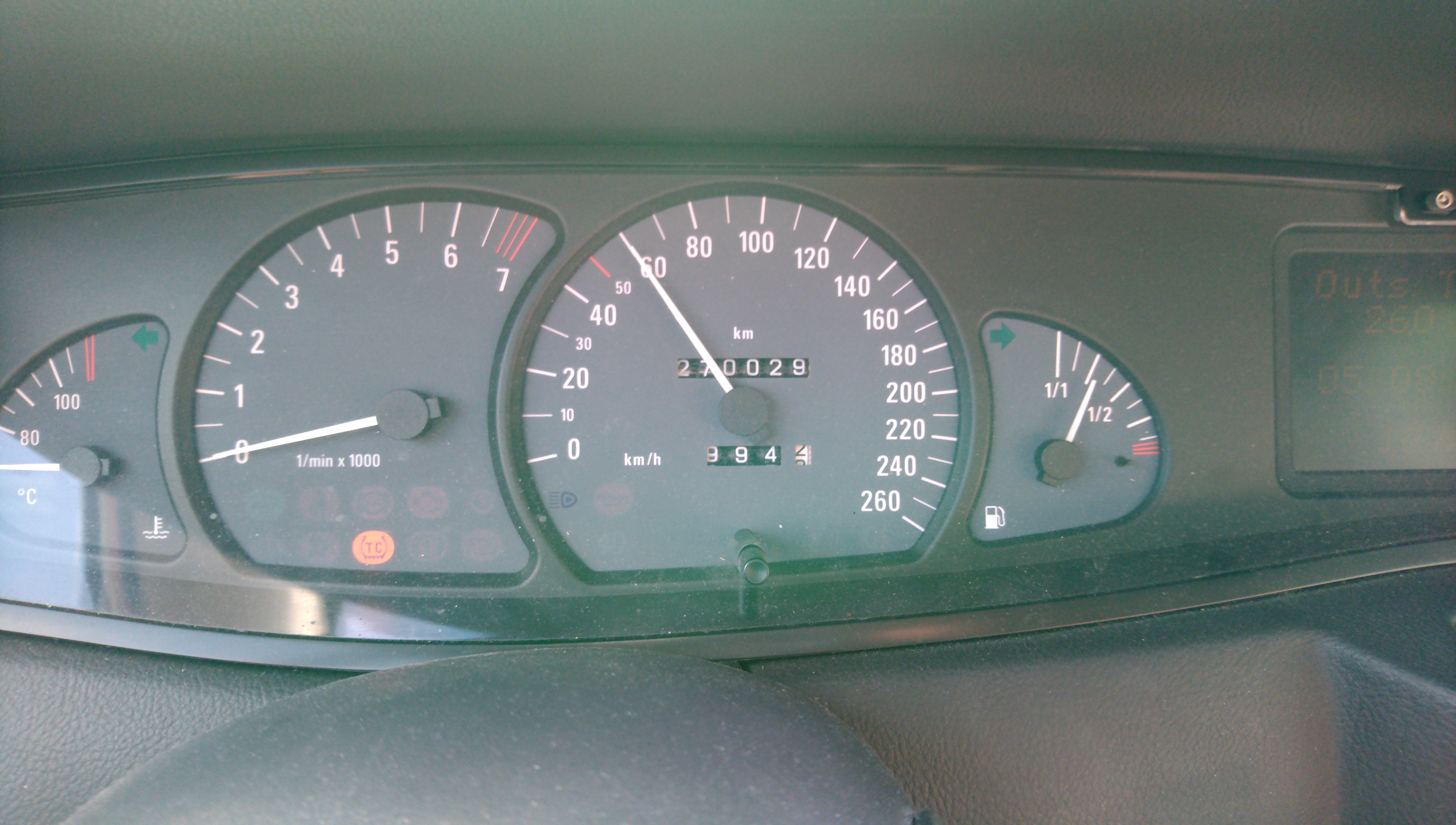

I hoisted the battery in and managed to make the car driveable again. This is a yet another temporary set-up but it's nice to have it on the road for proper testing and tweaking.
The 100kg pack behind the rear axle should balance the stance a bit. But the rear has to be high so that it can be loaded with the amount of cargo that the Omega is capable of carrying.

Double decker HVJB and a quick aero mod.
I hate these IP55 boxes but it was all I could get for now and they're a good size. I'll add lots of sealant to make them waterproof.
I also spent lots of time trying to figure out the original cooling fan circuits. Didn't go quite as planned but in the end I managed to wire it up and now my software is able to turn on the fan whenever I want it todo so. Except that it doesn't work with the ignition key off, I think. Well, that's for the future.

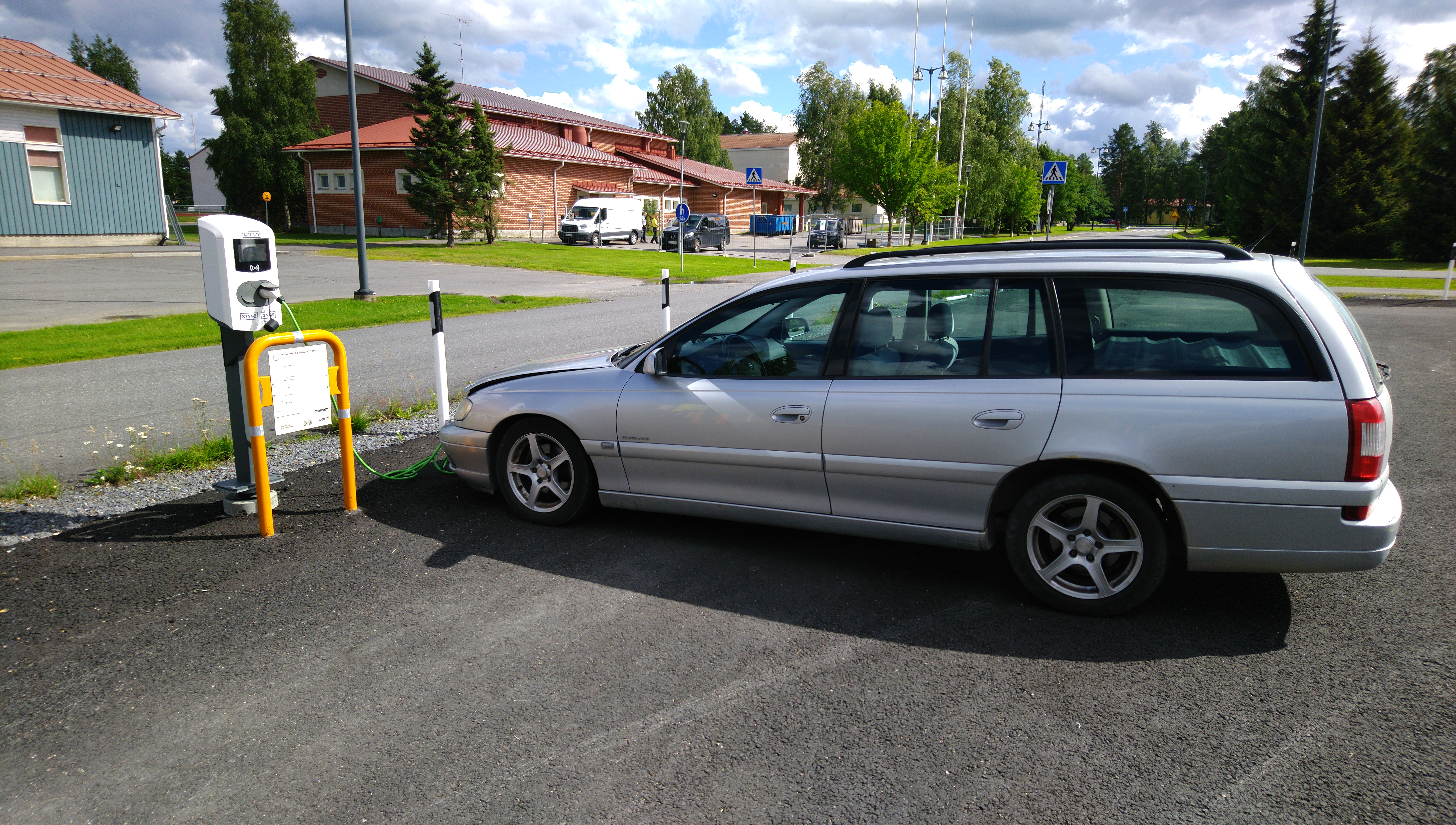

Tested the outlander OBC on a public charging station. Works fine.

Then it was a matter of making this connector, with pins GND, CAN H, CAN L, Contactor output (open drain) and +12V power (looping the CAN cables back and forth to maintain correct bus topology) and fishing it into the necessary locations.
The Chademo code needed some porting and upgrading, which I did. Having a codebase that I have written myself and know very well is critical in getting this to work essentially within a single day.
I also finalized charging while the ignition key is off. This works so that the system stays partly powered up for a while after the car is shut down, and if charging starts, the BMS continues powering the system. The BMS reads the ignition key signal, and powers the rest of the system via a relay. The BMS is internally switched on from a shutdown mode by the ignition key signal. I had to further modify the board-that-i-"borrowed"-from-work-which-is-now-the-BMS to support all this. It has too many hardwired shutdowns of outputs that I had to disable in the case that I want to power those outputs when the ignition key signal is off.
I went to test Chademo on a Tritium Veefil charger and it worked on first try. Nice! No photos, was busy saving diagnostic logs. You've all seen one of those charging a DIY EV anyway.
Access to the Chademo port is based on opening the hood for now. But there's some opportunity here to make it otherwise once I have the time after some weeks.
The shock absorber bearings are making a miserable noise when turning. Both of them. They must have been making it when I bought this car but you couldn't hear them over the ICE. Goes on the list of things with which it might not pass inspection.
The final setup is reasonably clean. Also taped up the BMS cover using black duct tape.
I got the Leaf Chademo port, the same one I already use in the Previa, so I could just take the Chademo controller from the Previa and plug & pray. I wasn't confident in what the first controller showed on my test set-up (based on those measurements I have no idea how it can work on a charger... have to test on the Previa to see whether I broke it or whether it's just weird), so I switched to another one I had made which plugs into the same connectors.

Did Outlander heater wiring, ISA shunt wiring, and here are the charging photos I didn't have last time.

- celeron55
- Posts: 804
- Has thanked: 38 times
- Been thanked: 136 times
Re: Opel Omega B2 + GS450H
1000km road trip in 2 months from engine removal: done!
It seems with these BMS and CAN issues every day I'm closer to having to call the tow truck...
I'm 600km from home now. Wish me luck.

Here's a happy photo of the last charging stop on the trip. That's an ABB charger. Those things always work. In the background is a row of Kempower CCS units. The ABB charger has probably been raised up like that because of snow in the winter.
The next to-dos in the project will be:
- Final rear battery box including enlarging the spare wheel well. Possibly with 5 modules instead of 4, moving 1 from the front to the rear to create more reasonable weight distribution, or alternatively I'll move the 12V battery and the AC charger to the rear. Will have to decide.
- The CANbus is a mess. If I connect the heater to the bus, the thing becomes practically undriveable. So, I need to figure that out.
- Initialization of communication to the rear battery modules doesn't really work. I need to supply 5V from a power bank to the BMS before turning the key. Then it works every time. Why? No idea. But I'll need to figure that out. I might add an auxiliary BMS to the rear and connect that via CANbus
- The propshaft adapter is still shaky at sub 15km/h speeds and the inspector might not like that at all. I need to shim it more precisely to get rid of it trying to swim like a fish.
- Some fast chargers don't detect the car at all. I have no idea why. I follow the standard very precisely so I blame the chargers. However that means I got too close to being stranded on the road trip which wasn't fun. Maybe I'll just order a CCS connector and skip right to that? We'll see.
- Probably something else that I forget
