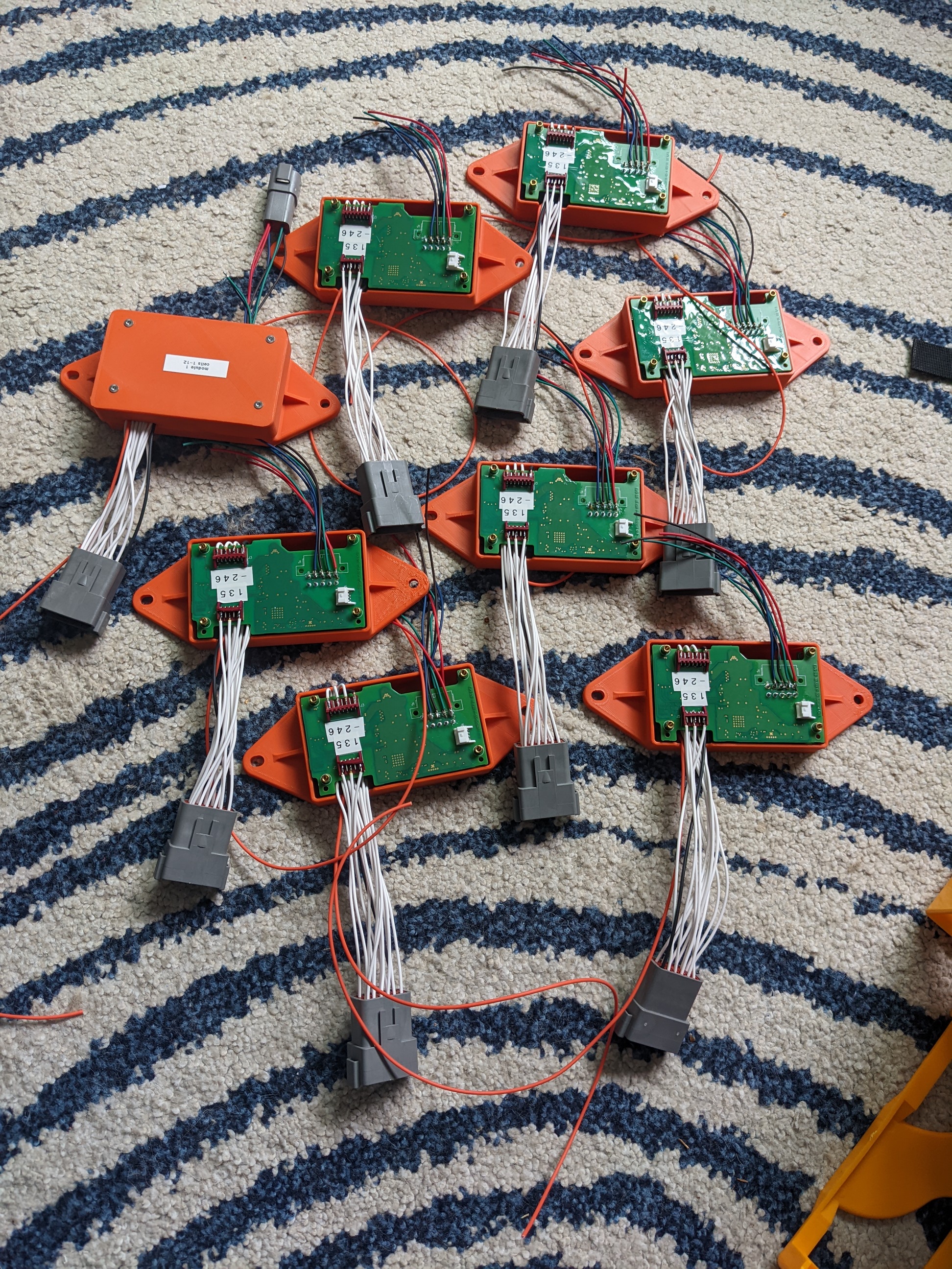

I've just finished wiring up the secondary module boards and am just waiting for more 4p Deutsch connectors (didn't plan well :\)
I hope to take one out to the truck later today and connect to a module to see what happens. I will report back.

I got one 12s module hooked up with 2 Model S bms boards. The error was set because I had the series cell count wrong in the SimpBMS settings.
Now to make a larger wiring harness.

Adding some detail about connecting to the model s/x secondary boards.
Tesla uses a board-to-board JST JL connector (pdf attached) for the cell taps on these gen 3 boards, which means simply buying the connector and wiring it up yourself isn't really a thing. Tesla does this by using a ribbon cable to a small flying PCB with the mating connector mounted to it. I guess you could make small PCBs for the connector then connect to that PCB, but that's a lot of work to make a connection. you could also potentially cram some same-pitch connector in there, but it will require cutting.
A lot of times im attempting to do something that's actually contrary to my goals :P. in this case I stopped trying to source connectors and just jumped straight to cutting and soldering 176joints. This makes the most sense because it's free, and I don't need a connector in this location at all - in fact it's kind of a bad idea considering my implementation; connector to wire to connector to wire to cell all within 10" makes no sense.
my soldering setup which made this relatively easy.
final product:

BMS boards mounted and cell taps connected. Next is power and comm harness. Im currently top balancing all the cells so i'll need to get this thing out on the road soon and burn off some energy to empty the battery a bit and so i can start testing charging.
reminder: 8x Mercedes 12s 875Wh hybrid modules. 2x Model S BMS boards on each.

We have BMS success!
After frustratingly replacing 2 tesla module boards, it's all working :D

BMS notes:
Using 16 model S/X module BMS boards was actually kind of a lot of work. I would say it's only something you should consider if you need a battery form factor that you can't get with a compatible BMS. I'll say this was my case to make myself feel better :)
Here is a summary of the work required:
Batt side: cut out all native BMS content, design and order busbars, sand each cell tab so I could solder a cell tap, then add a 12p connector (leaving main + for a ring terminal). This added up to about 12 hours of my free time over many months.
BMS side: find and order 16 model S/X boards from a source that doesn't want insane money for them. my V3 boards had the weird JST board to board connectors so I went ahead and cut all those off - which caused a blister on my hand!. then cut 4+7x16 = 176wires, strip them, set up a soldering station and add all wires to the BMS boards. Then design and print 3d enclosures for 2x boards for each 12s batt module. add 12p connector to battery cells and HOPE you connected everything correctly. In my case I had a 2 boards that were just not right. one wasn't communicating at all, and the other was reading a cell 700mV low! All this was easily 20-30hours of work.
Finally after running RX/TX and power wires to each module I was "done". Still need to integrate my charger somehow.
I have another 8 of these batteries, so would I do it again? ... maybe.
Costs
batteries: $100/ea + shipping = $900
custom copper busbars: $300
BMS boards: $24/ea = $384
Simp BMS: $500
Wire/Connectors: $80
printer filament: $15
Total $2180 for the complete 350V 7kWh system. :| :oops:
