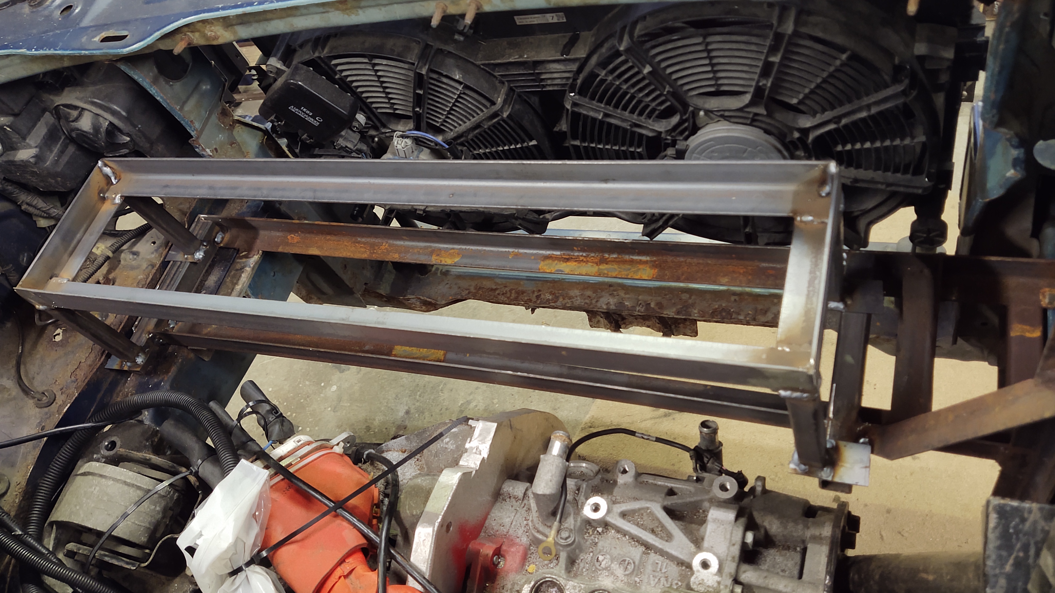

That's a very nice looking box.
My first two are made from 3mm steel angle frame covered in 1.6mm sheet. I haven't made the other two yet and may try to get the remainder of the modules in the boot to avoid having to make a fourth.
This is a box I made to go under the fuel tank but I didn't allow for fuses and/or contactor so this may need adjusted.
And this still has to have a lid made for the upper section but will hold six large modules under the bonnet
I would like to have made mine with aluminium but don't have the welding skills unfortunately.
